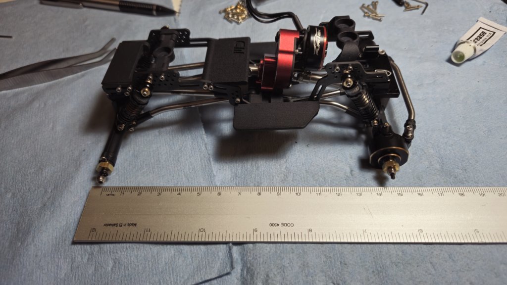

    Measurements. Rounded of course since eyeballed.
    Injora C10/Deadbolt stainless links
    Not installed, just for reference.
    Bolt Rear
    Bottom-60mm
    Top-52mm
    Currently installed
    C10 Rear
    Bottom-70mm
    Top-62mm
    C10 Front
    Bottom-50mm
    Top-39mm
    Bolt front, really short and as of yet unassembled.

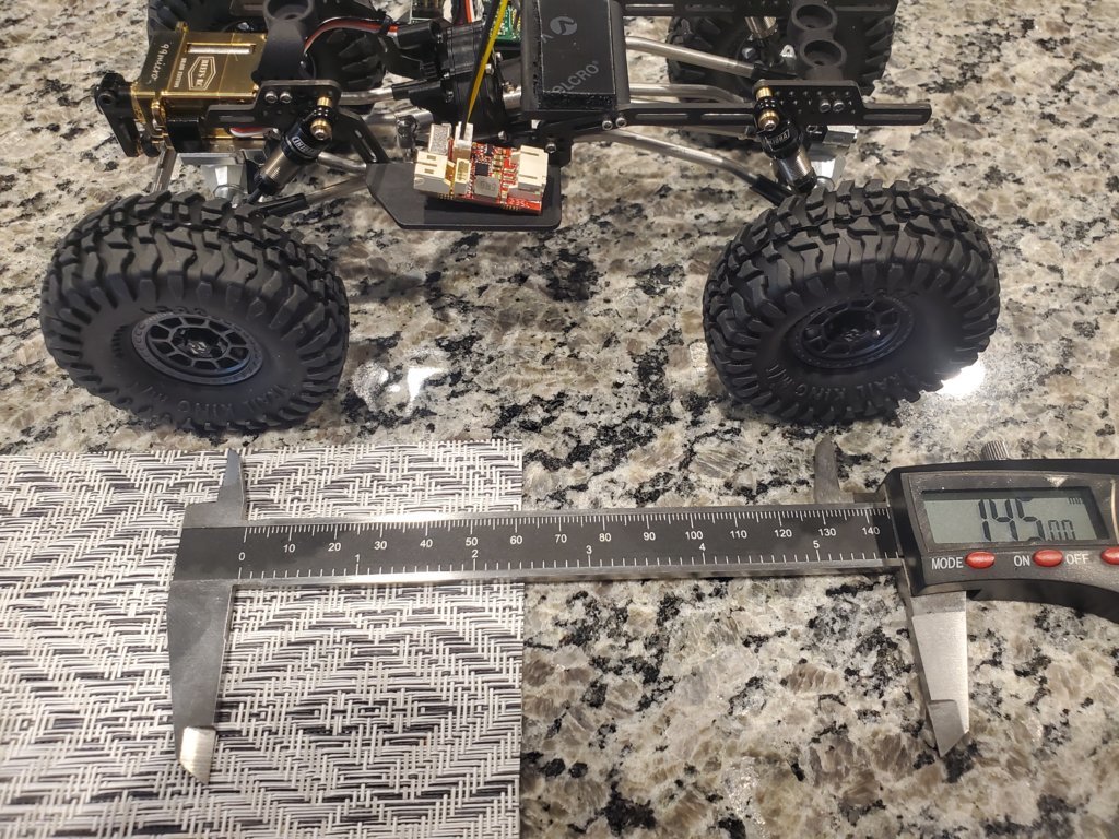

    145mm fully compressed, 141mm fully drooped.

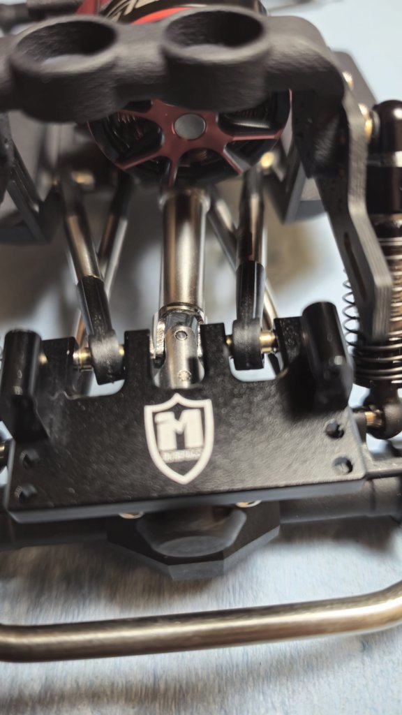

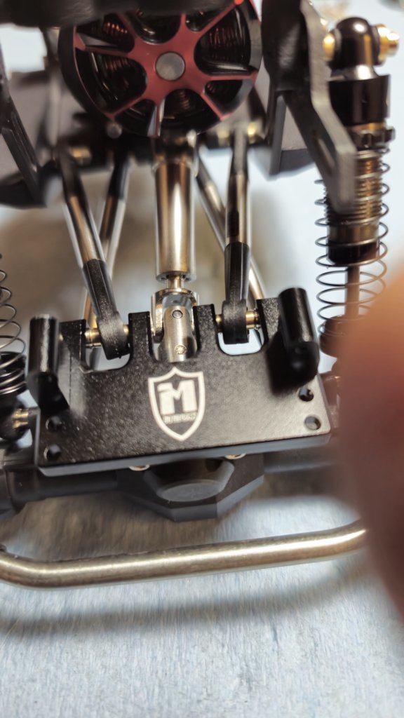

    The 10 degree skid did nothing for the front shaft, still ended up trimming a 1/4" off the ends.
    Might put 15 degree skid back, just to try if nothing else. Driveshaft angles definitely improved.
    In this pic, full compression, and only 1/8" trim.

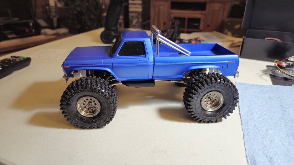

    Done. :cool:

    Awe fuck that looks GOOD!
    Son of a bitch, you kept it from us this whole time :rofl:

    That's just an FMS body I threw on there for grins. :D It does look pretty good, just a tad short in the WB. A little trimming might make it work out.

    Naw that thing looks perfect.

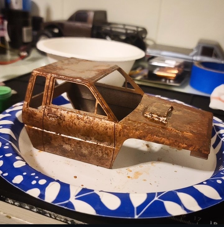

    Work in progress. Gotta keep waiting for shit to dry lol

    Maaaaan, those Sam's Club paper plates come in clutch for all sorts of shit :rofl:
    Even used one to stuff a dead tarantula :anonymous:
    Looks like you're doing it exactly right! I remember one part of the video where the truck looked exactly like yours does now. You gonna do a rusted hood, or door?

    Multipurpose paper plates lol. Happy with how it's looking thus far! Undecided on if I want to leave a full panel exposed or not. At first I was gonna make the hood black but now that I see it like this I don't know...
