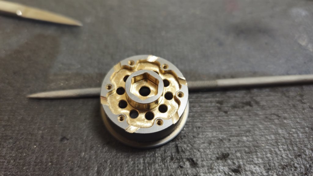

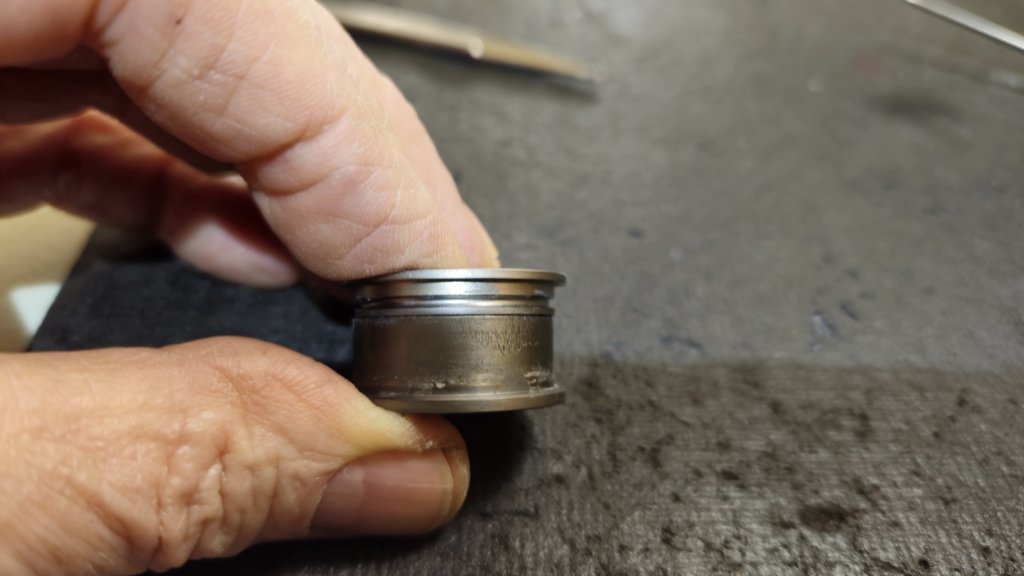

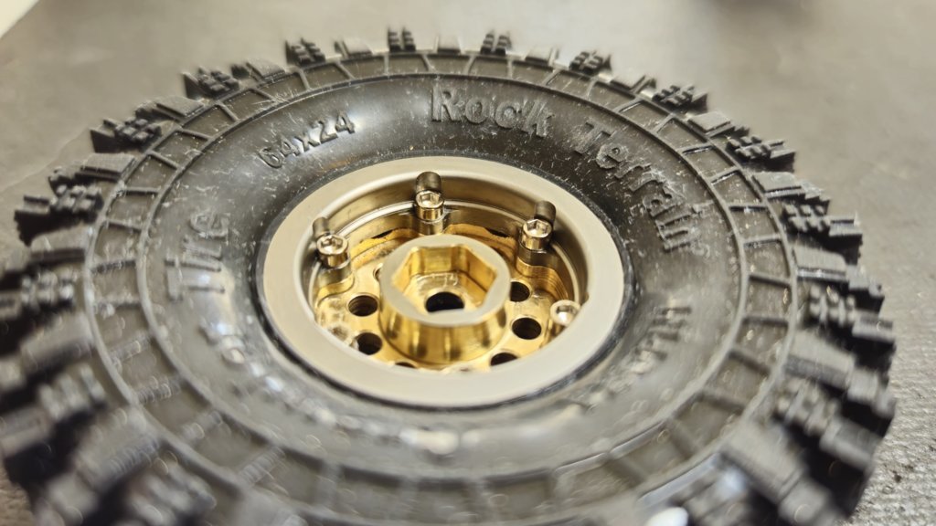

    Today's mission, get those wheels to vent properly.
    They came with one tiny hole, I turned that into 4 larger holes.
    Also cut a slit in the inner silicone ring between every web support. I tried a hot nail, silicone is a bit heat resistant. Tiny scissors ftw.
    That and baby butt powder wasn't enough.
    The brass wheels are machined pretty tight.
    Took 5 minutes and a round file and made those sporty slots.
    That worked, They vent almost like foam now. 3 more to go. :cool:

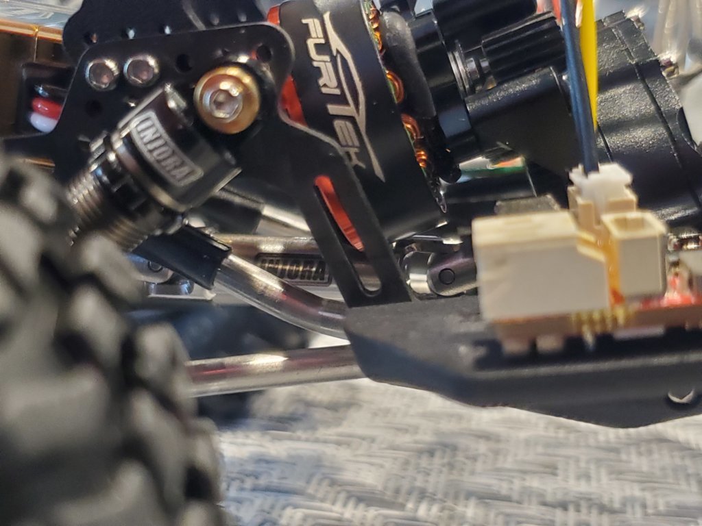

    I think you had asked about front links and issues with the Micro not having clearance?
    The bends provide a lot of clearance!
    The front end being completely tucked (forcefully compressing both shocks) barely makes the Mini kiss the front driveshaft.
    The Micro being only 0.19" longer, but 0.29" skinnier, means I won't have clearance issues at all.
    In fact I'm glad I put this together (just because I was tired of it not moving) because I found that I needed to cut down the driveshaft by less than 0.125"

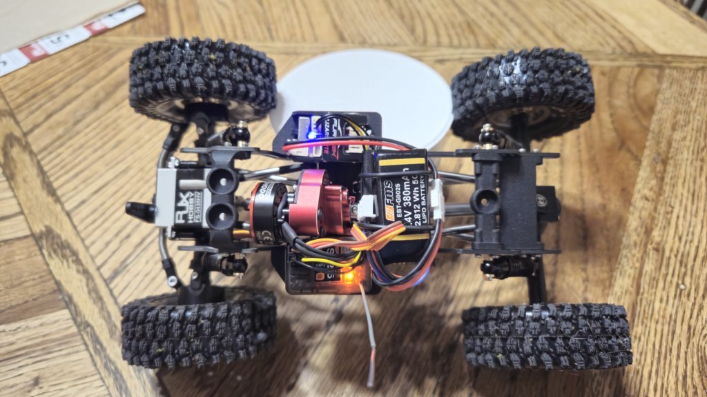

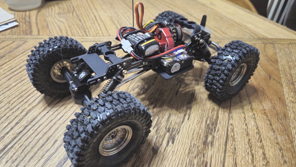

  14. Jan 29, 2025 at 6:16 PM
    Deathbysnusnu
    Deathbysnusnu Work is just a daily detour to happy hour.
    Oct 4, 2013
    #113825
    17,101
    Brett
    Fort Crawlins, CO
    Vintage Tundra
    Dog, camper.

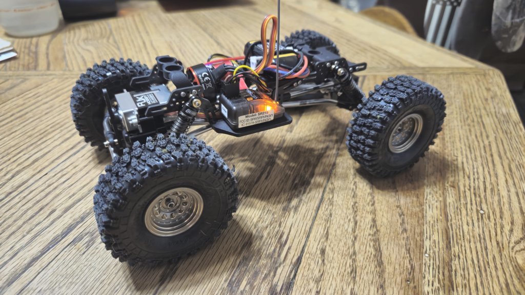

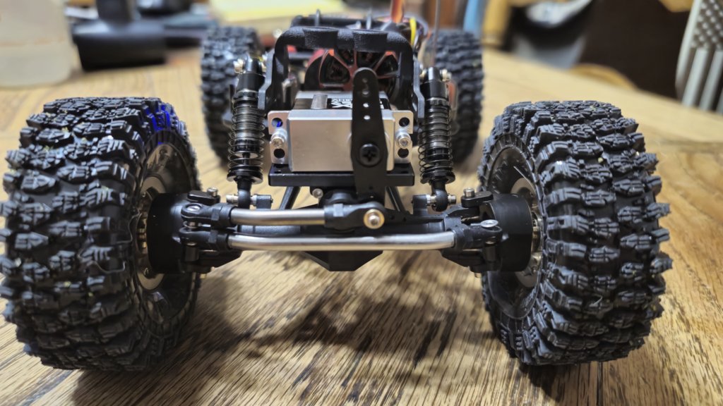

    Preview of the layout. I'll wrap the wire later. Also plan to shorten the servo cable.
    Played with the links and got them nice and smooth. Cleaned and "honed" the shocks with a Q-tip and drill, 6 drops of peanut oil in each. They were a bit notchy out of the bag.
    Reversed that rear plate as I dropped the rear a bit and needed the clearance.
    Will prolly run the 10 degree skid for now, at least until the weekend when I have the motor mount sorted out. Honestly if hadn't been brought to my attention, I'd be running as you see it. It clears, just off center.
    Switched to the RJX servo I wanted to run originally, it's quieter, aside from the digital whine when under torque, and has a better finish on it.
    and this thing is stupid slow. Almost too slow. It runs smooth at all speeds, smooth uphill, but "jerks" on the downhill, like a gear is slipping a cog. Does it both directions, I suspect maybe the worm drives? You can see it in the wheels going downhill.
    Just a little in this video.
    https://www.youtube.com/watch?v=C5Wxmq4wzqs
    Strictlytoyz and Kwikvette like this.

    She crawls sloooow!
    I see now what you mean about the tires - the silicone inserts really don't "smash" as well as foams huh?
    I hear they're super popular for keeping that sidewall stiff, just never ran a set myself.
