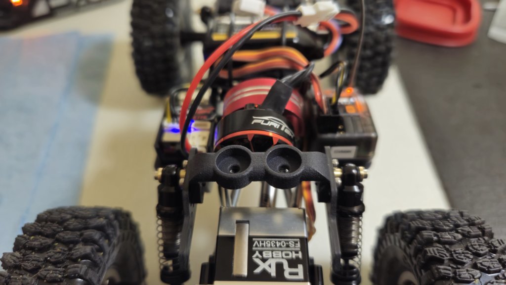

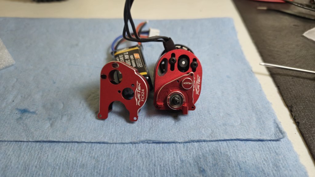

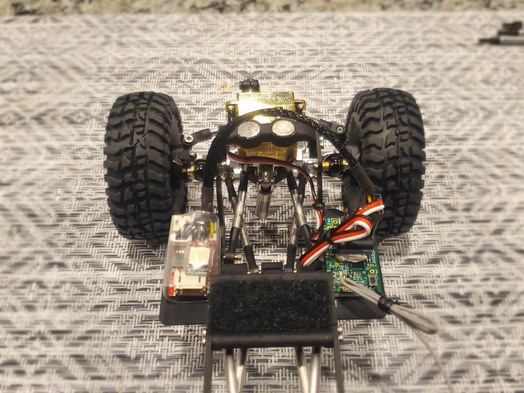

    One transmission, two different motor mounts.
    I was concerned the spur was different. It's not.

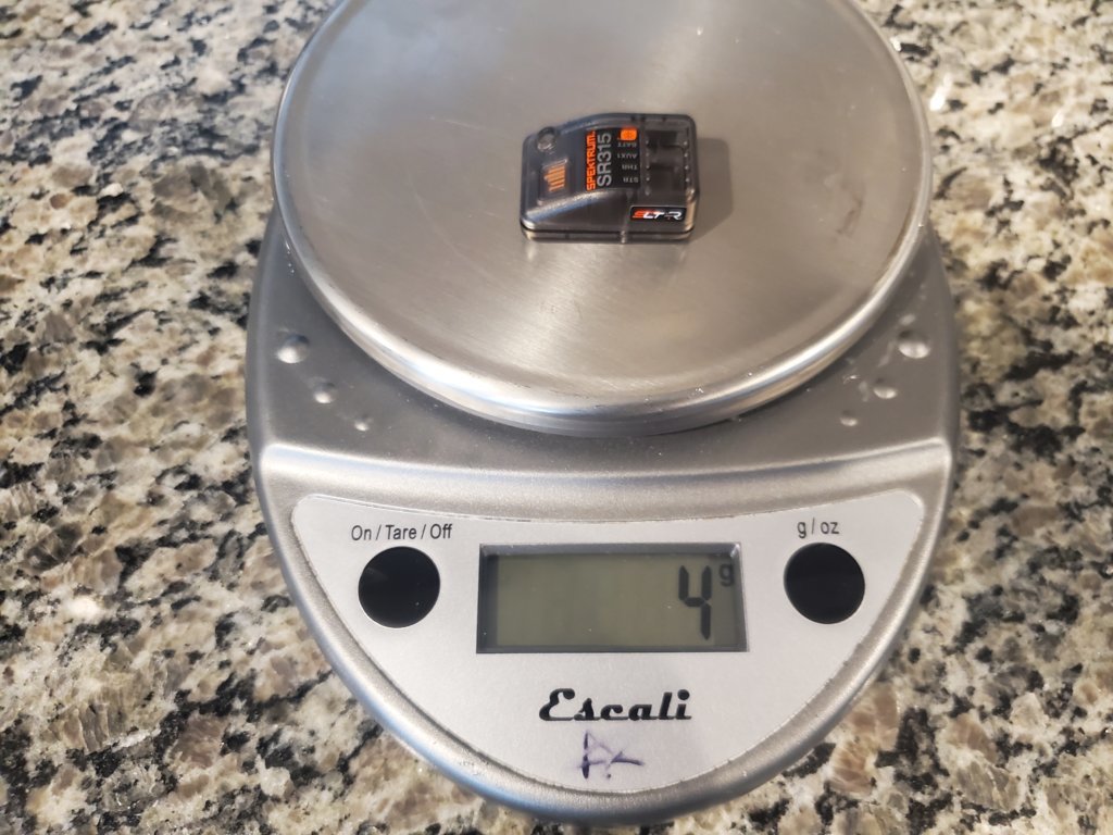

    runs exactly the same, but now my balance is off since it went past center. May have to swap the ESC/RX side to side (ESC is heavier by 4 grams) :rolleyes:

    @Deathbysnusnu you got me checking out the weight of my RX case now :rofl:
    Didn't think a gram or two would matter.
    But I guess it's like backpacking; ounces turn to pounds, and pounds turn to pain :anonymous:

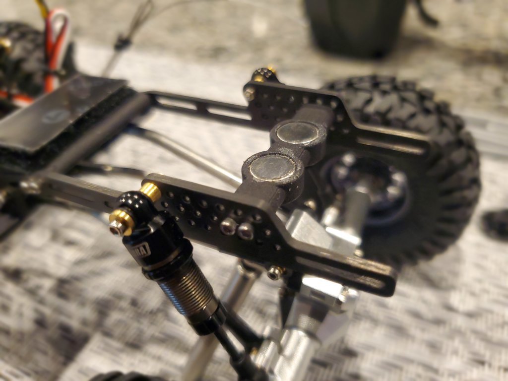

    Man, I know E6000 is recommended for a ton of shit.
    Even for layering decorative signs together where one is wanting to avoid tacking or bolting them together.
    It's worse than shoe goo though in terms of how stringy it gets. At least the magnets are glued on.
    Only reason why I haven't mounted the body is because I want my motor to be installed already.
    Tomorrow the Micro from LGRP arrives, yet the one from AMain is still in limbo.

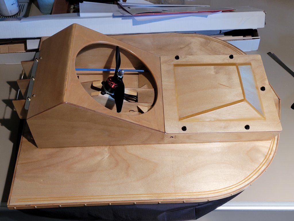

    01 White Tacoma
    Original with factory replacement parts.
    Scratch built over the winter when I gets cabin fever and can't be outside tinkering.

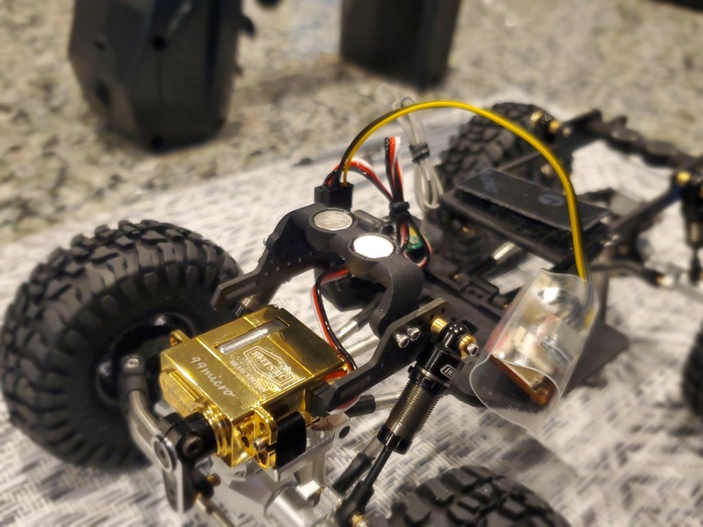

    Couldn't leave shit alone and started trimming into the front grill. The servo horn gets in the way :bananadead:
    Least I dressed up the cable for the ESC.
    It's as tidy as I can get it short of cutting wires down and soldering them for a shorter length.

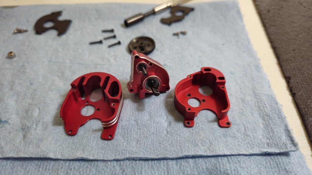

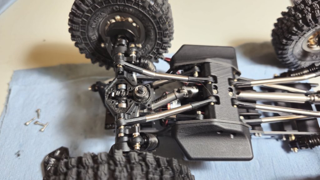

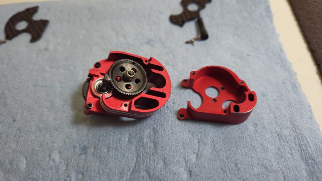

    This may work for the other axles as well, after removing the damn things numerous times to try different worm shimming, I figured out you just need to...
    Remove the upper link mount from the axle, leave the links attached. Servo can stay on the link plate too.
    Remove the driveshaft.
    Rotate the damn thing and get busy.
    Way faster than a complete disassemble.
