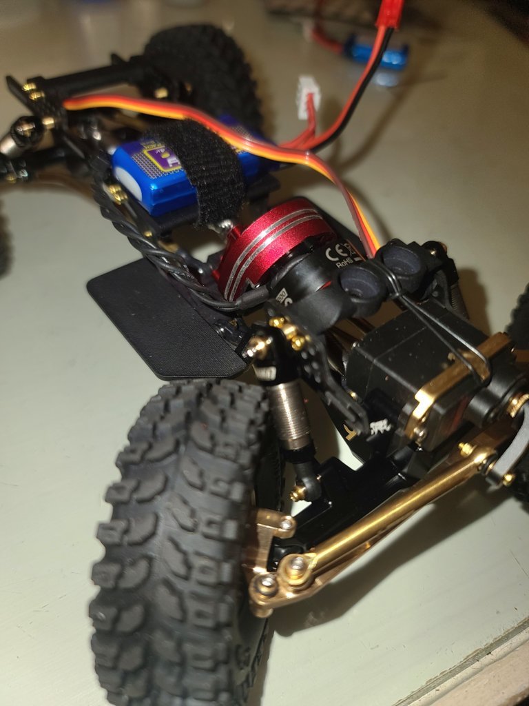

    Also crazy just how well-centered that motor is.
    If you look above, I do have much more clearance with my Micro now not to mention it doesn't hit my front links when tucked.

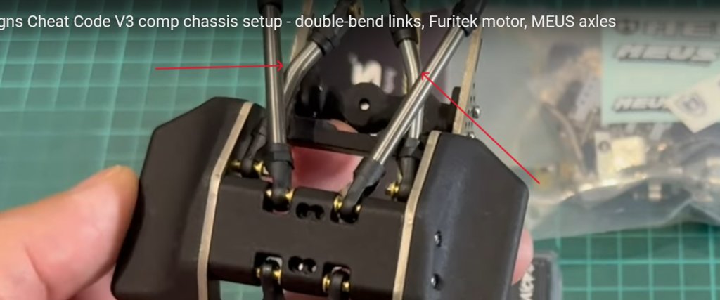

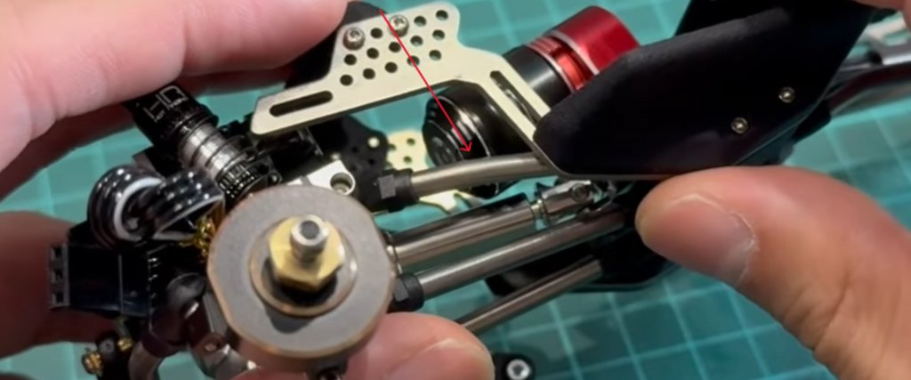

    @Strictlytoyz I think the front link contact that Angerhaus dealt with in his video was totally user error.
    I screenshotted these parts and you can see when he assembled them, rather than placing the bend downward to face the ground, he actually has them facing outward.
    That clearly caused the issue he was dealing with here, forcing him to run the Mini
    Strictlytoyz likes this.

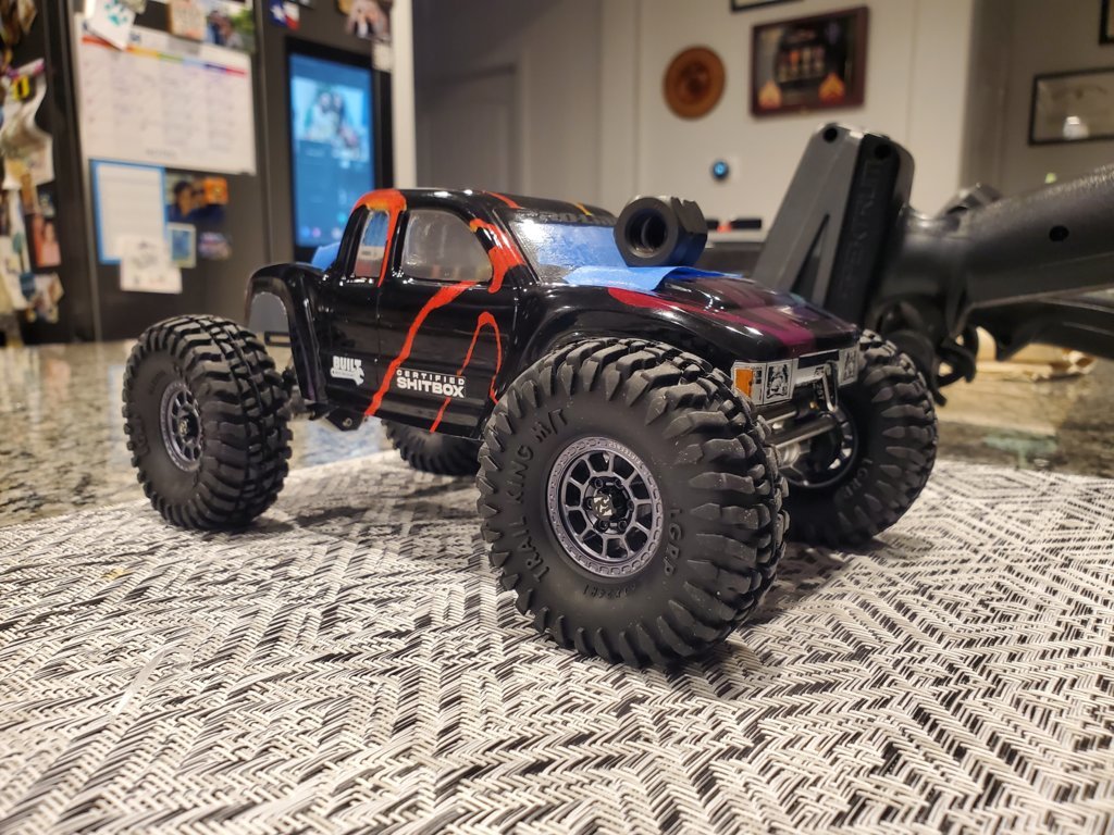

    So the fumes are completely gone so I brought the rig into the house where it's much warmer.
    Hoping it cures well inside.
    I'll definitely have to chop quite a bit off the front to clear the steering horn some more as well as the body for my tires -
    On the plus side, I just learned that I can indeed set my steering end points with the DX.
    When I had everything together, I found my tires turned well enough to hit my shocks and I needed to program some steering end points to prevent that.
    Part of me had me thinking I have to switch TX/RX but nope!

    Those wheels look like a positive or centered offset, might try a spacer to set them out before you trim the body. I think mine are a -3 offset, the hex is almost to the inside edge of the wheel.

    I was trying to look up the specs but this is all they've got on there - https://littleguyracingparts.com/products/fifteen52-traverse-mx-1-0-beadlock-wheel
    I'd take them off but you know, glue curing lol

    Any pictures I've seen of the Cliffhanger running these axles almost always requires trimming farther around the fenders for the tires to fit.
    That steering angle is no joke (and I plan to take advantage of it).

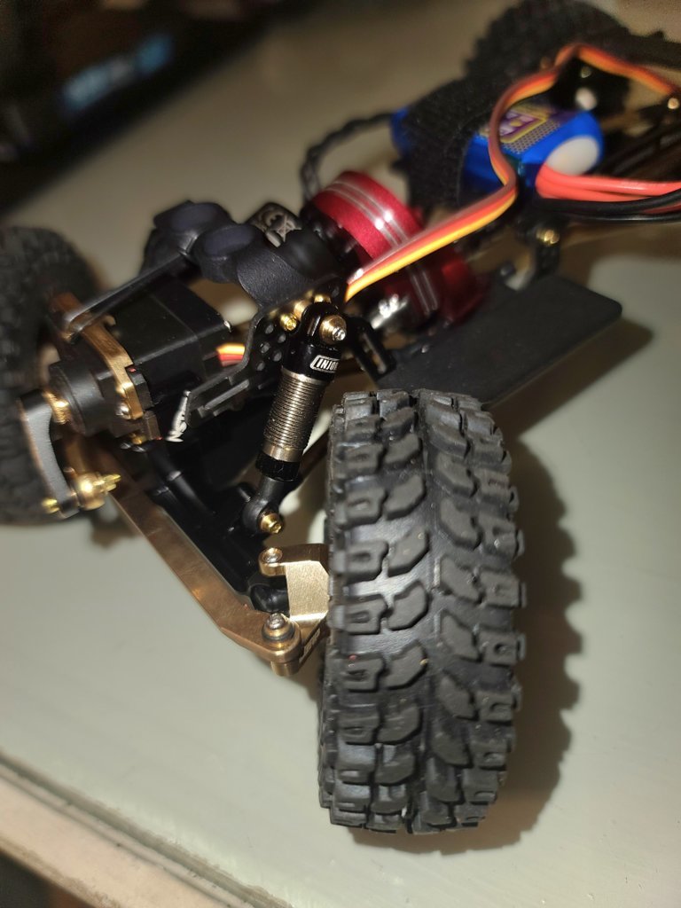

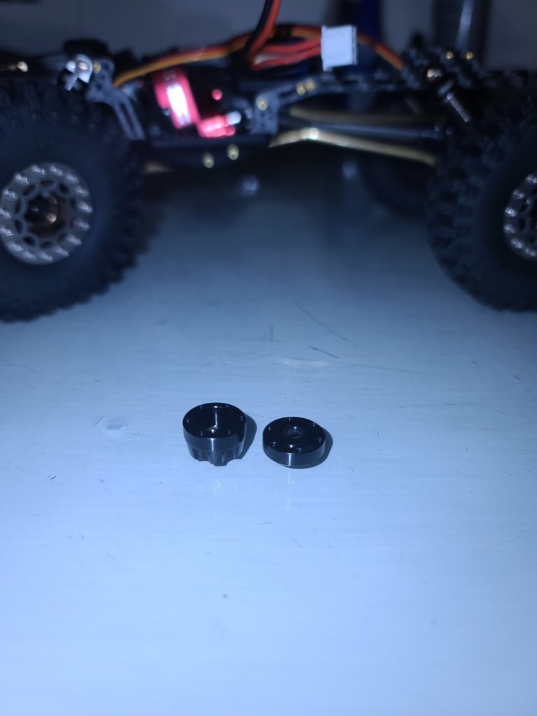

    Had to throw on the extended hubs that came with my wheels because the stock ones put my tires into the shocks at full lock
    Factory
    Extended
    Hub difference
  16. Jan 31, 2025 at 8:31 PM
    Kwikvette
    Feb 27, 2019
    #284735
    80,890
    Fresno County
    4 run, 2 don't
    Shit.
    Now I feel dumb - so remember when I said I had a "binding" issue when I installed my +1 hexes?
    If I recall, I think I had tried to spin the tires by hand and proceeded to put the stock hexes back on. Only to remember we had this whole talk about worm gears just recently.
    Maybe it was the worm gear that kept me from turning it.
    Just more shit to check on tomorrow.
    Strictlytoyz[QUOTED] likes this.
  17. Jan 31, 2025 at 8:33 PM
    Strictlytoyz
    Strictlytoyz Well-Known Member
    Jul 23, 2015
    #160147
    2,825
    Charles
    HA\/\/AII
    07 Shitbox
    I'm betting that's exactly it!

    I'd try to take the lean out of the front shock or flip them to see if they give more clearance upside down. All the steering angle is worth having front shocks be vertical

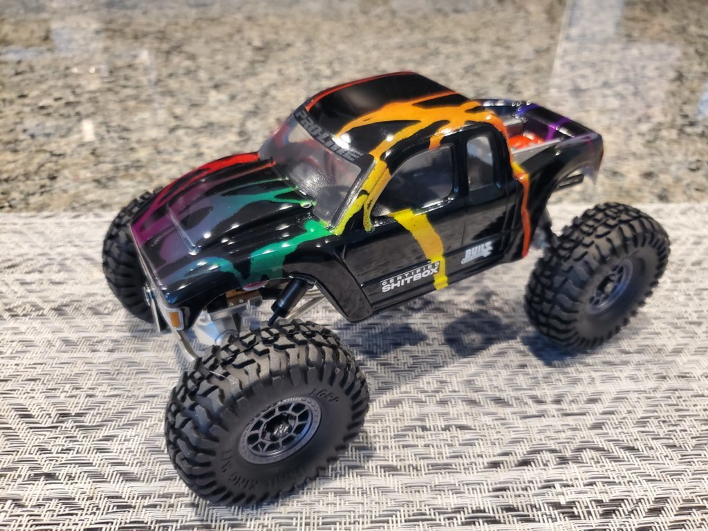

    Well, 22 hours later and she cured pretty well!
    I'm doing the twist method for pulling the body off and it's perfect!
  20. Feb 1, 2025 at 9:38 AM
    Kwikvette
    Feb 27, 2019
    #284735
    80,890
    Fresno County
    4 run, 2 don't
    And I'm gonna have to trim the front grill off :rofl:
    No worries, I kind of expected it.
    Really just need the side markers cut out but it'd look really weird/ugly having the lights hang (I'll try it out).
    The front wheels when turned and locked rub the front corners of the lexan body even after setting my steering end points.
