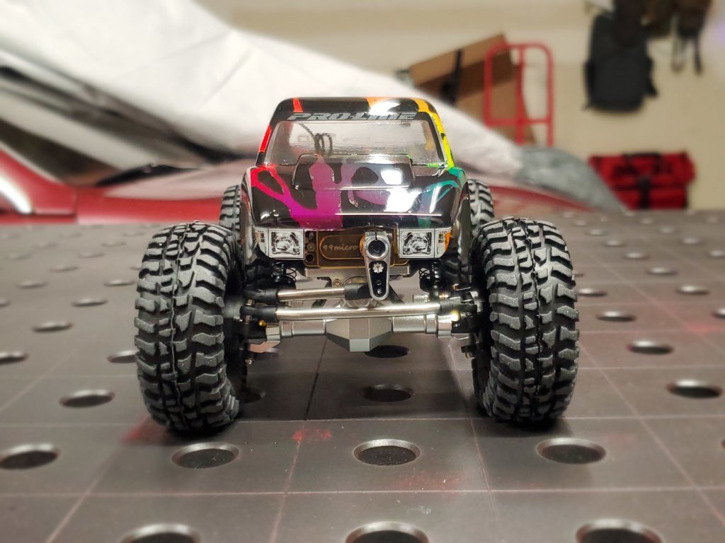

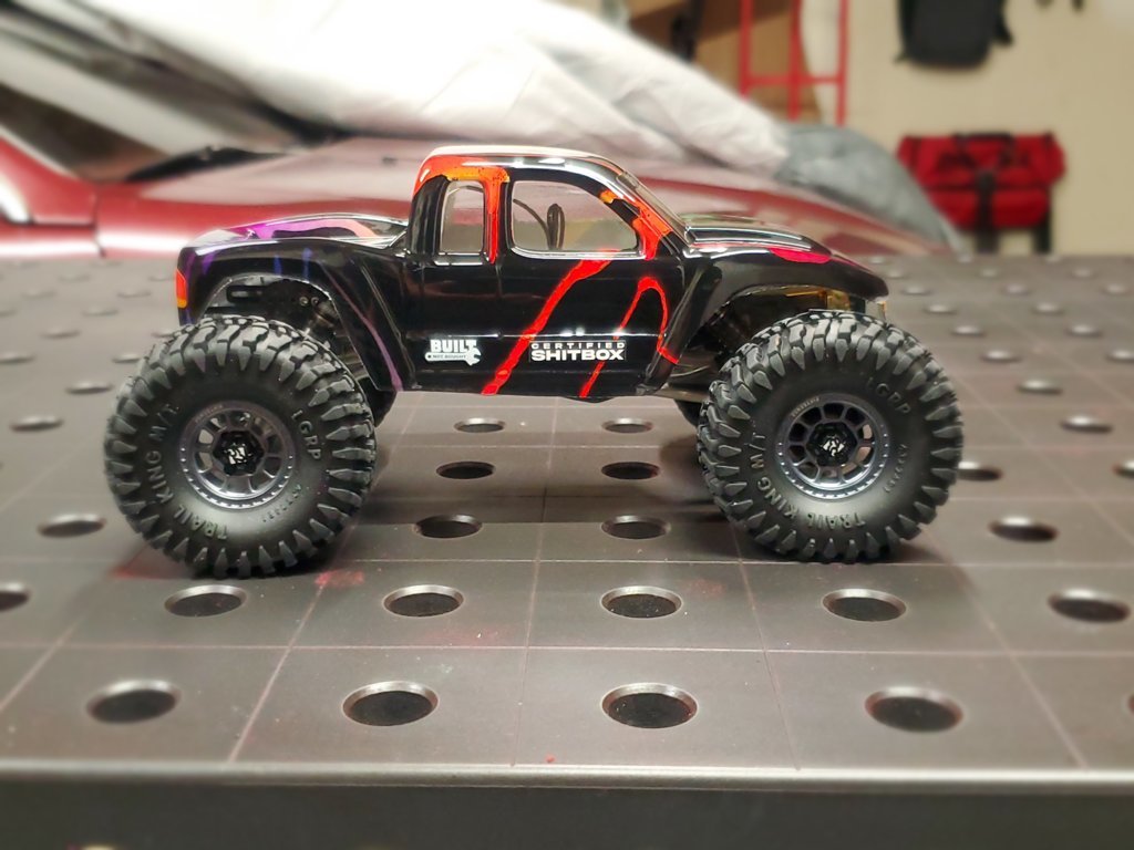

    Thanks!

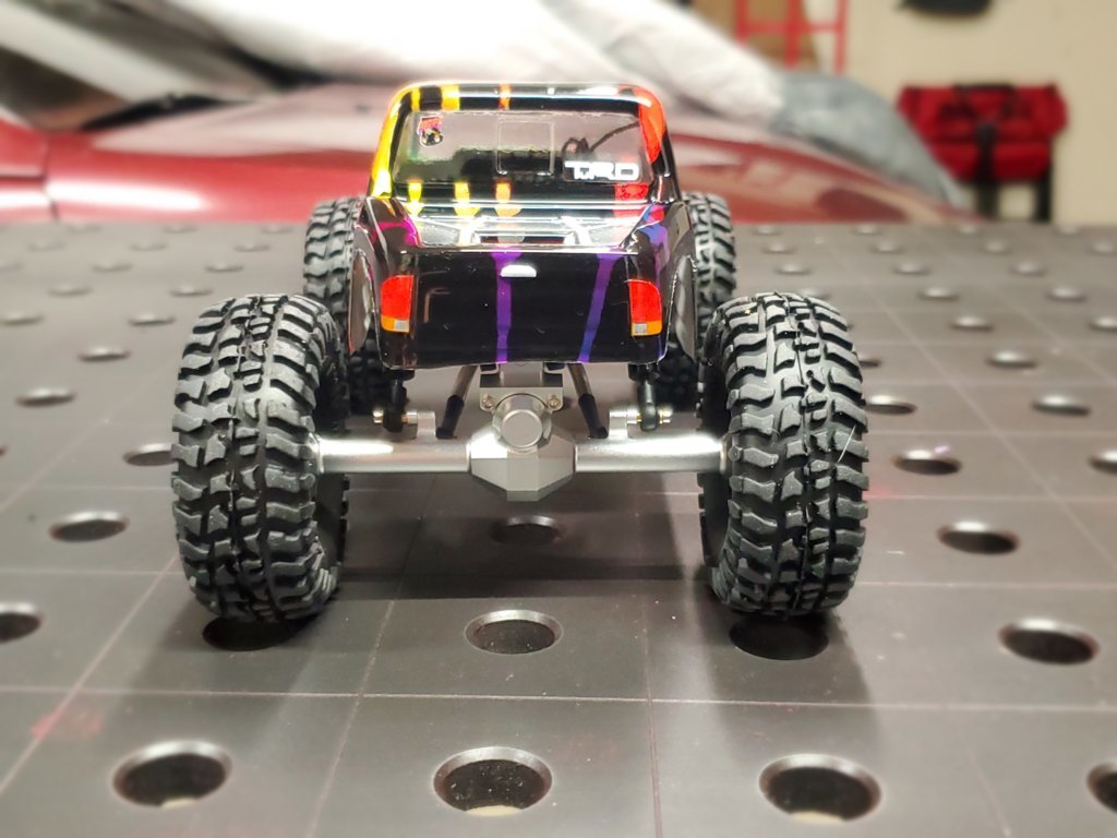

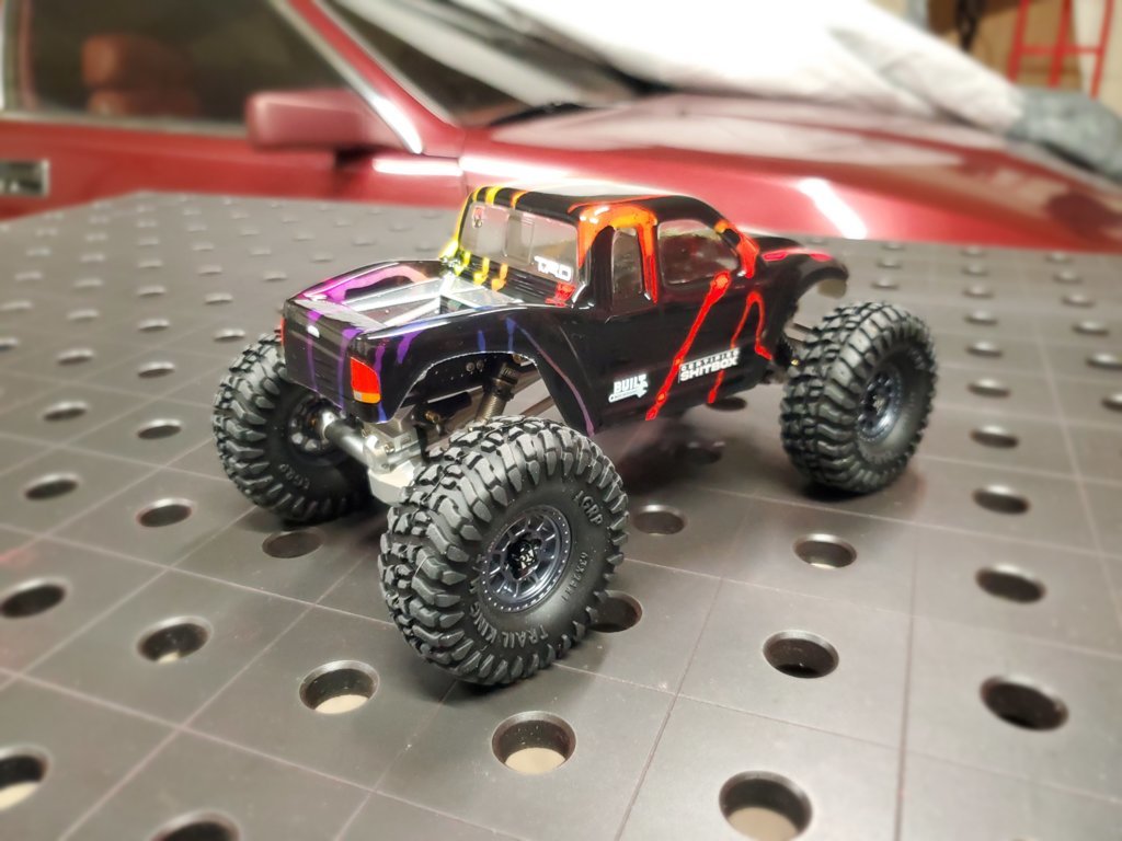

    Well, she's officially (unofficially, in case of more trimming) done!
    Not perfect but, she's going to get banged up anyway right?
    Just hope she performs well for me! Thinking I might go tomorrow to my hobby shop if they don't have comps on Sundays.

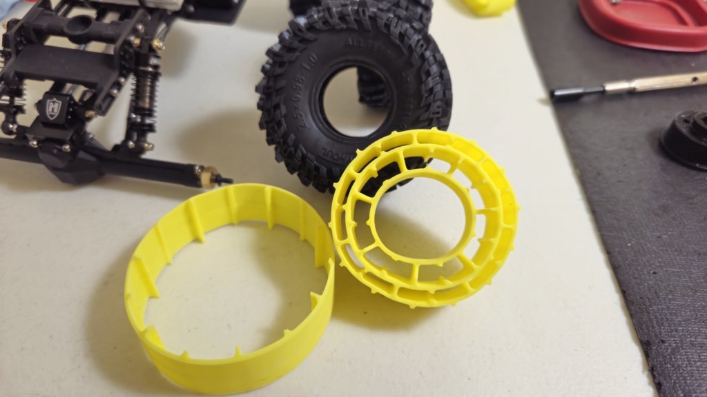

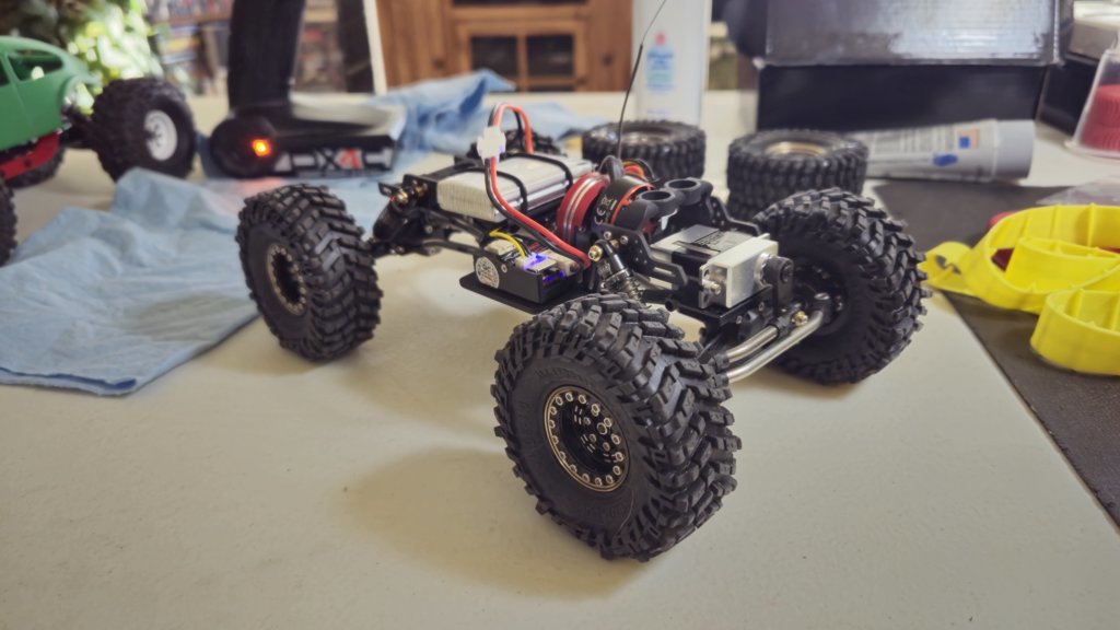

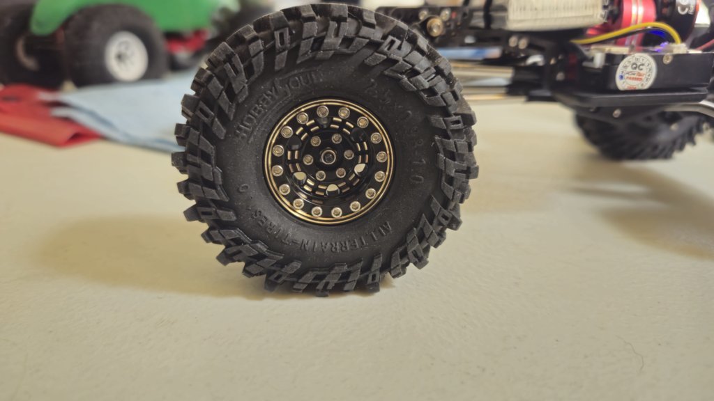

    went up 10 grams per wheel. It no longer lifts a leg going uphill backwards.
    Same size dia, 5mm wider, no difference in grip on the plywood ramp.
    The Injora's flex much better, but seems to make no difference on the incline.
    I ended up removing the entire outer ring, as well as trimming the remaining webbing.
    The outer diameter of the tires is the same, but the new ones have taller lugs, so the inner carcass is smaller. I do like the look better.

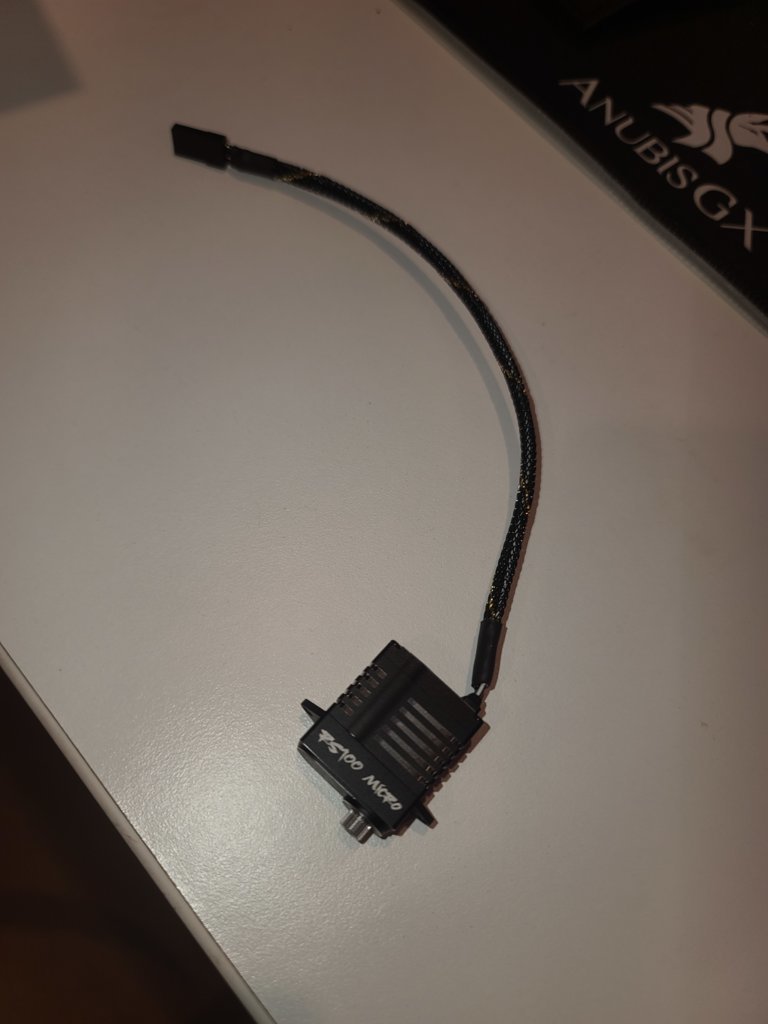

    Was it as "difficult" as some make it seem?
    I can't imagine it being so I mean, there's some metal gears, wiring, and that's it?
    Probably an issue for those not mechanically inclined.

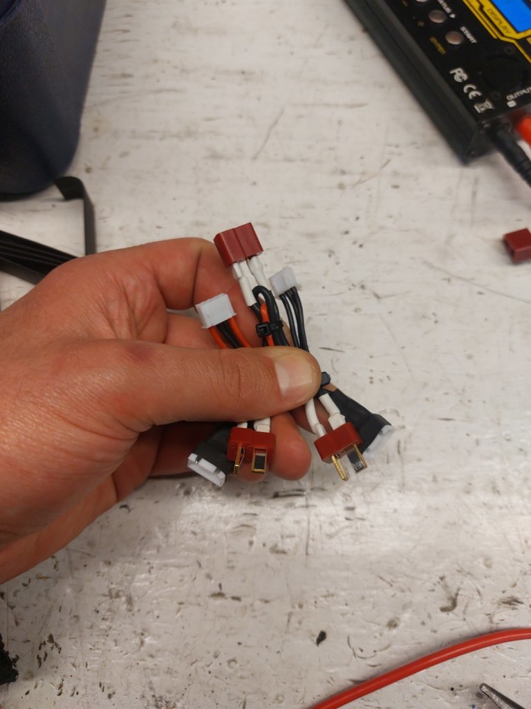

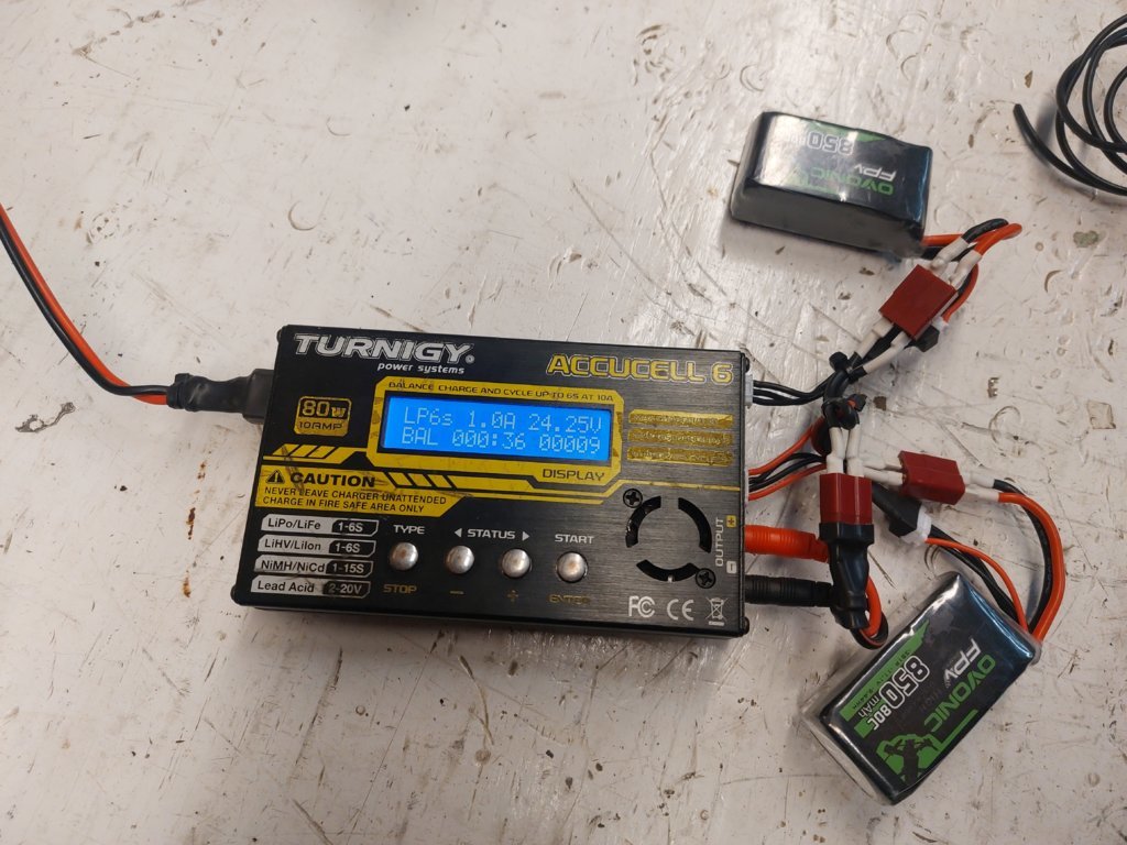

    I have had my accucell 6 for a long time, love the charger it hasn't skipped a beat. For the smaller crawler batts it would be nice to charge them both at once.
    Finally got around to making this lil harness that makes my 2 3s crawler lipos become a single 6s so I can charge both of them (assuming similar charged state) at the same time. Makes it to where I can set n forget and get 2 charged batts vs getting one and forgetting to charge the second. Unfortunately I didn't have a 7 pin jst plug so I had to do a 3 and 4 pin and use two different balance ports on the charger side (they all connect the same 7 pins but gotta pay attention when plugging in the 4 pin with one bump cut off as it could be plugged in multiple spots and short stuff out)

    Super simple process. Only "difficult" part is getting the rubber grommet into the new back plate
