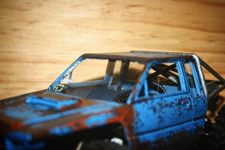

    Gave it a windshield and cab glass. Thinking of putting cargo net style windows in the front and rear panel

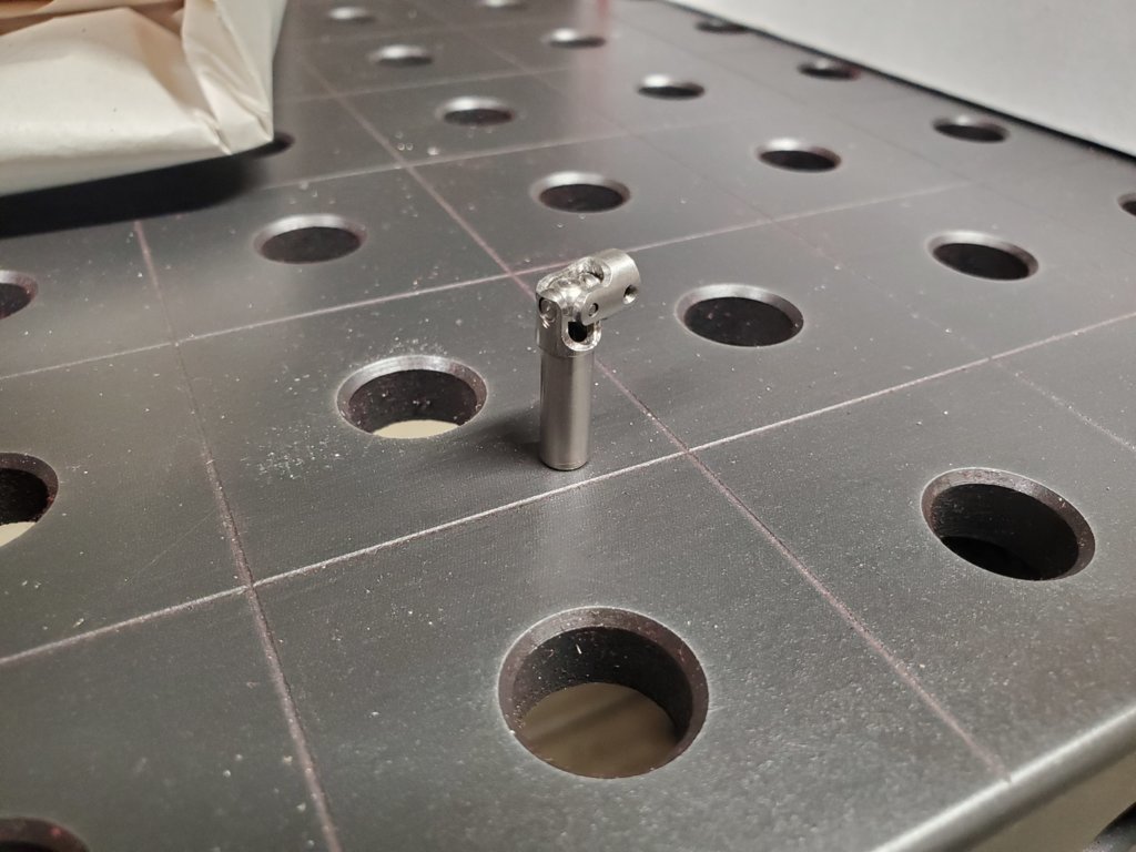

    I was messing with my crawler and doing the really slow up and down crawl to see how bad the stutter was.
    Thing is, when I flip it upside down and throttle forward slowly, I can see a tiny bit of side to side wiggle. I think it may be my driveshaft because the end of it isn't completely square when I cut it down :bananadead:
    I'll have to chuck it on the drill press and try to file it down evenly or something.
    And yeah before anyone asks, my driveshafts are phased :rofl:

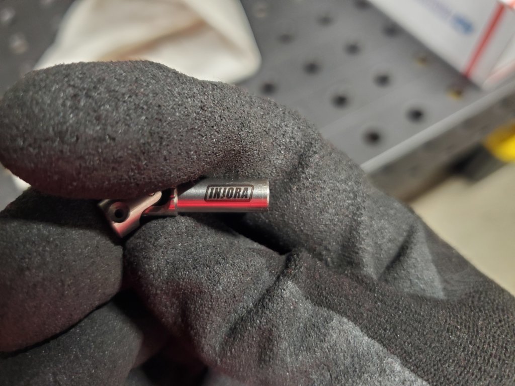

    Well, let's test it out.
    Added a bevel to the edge, mainly to clean up the slight burrs and make it look good.
    She's as square and flat as she can be.

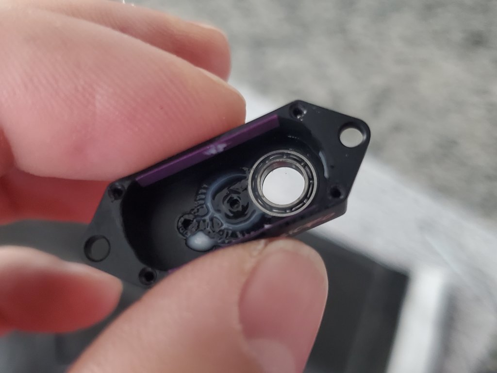

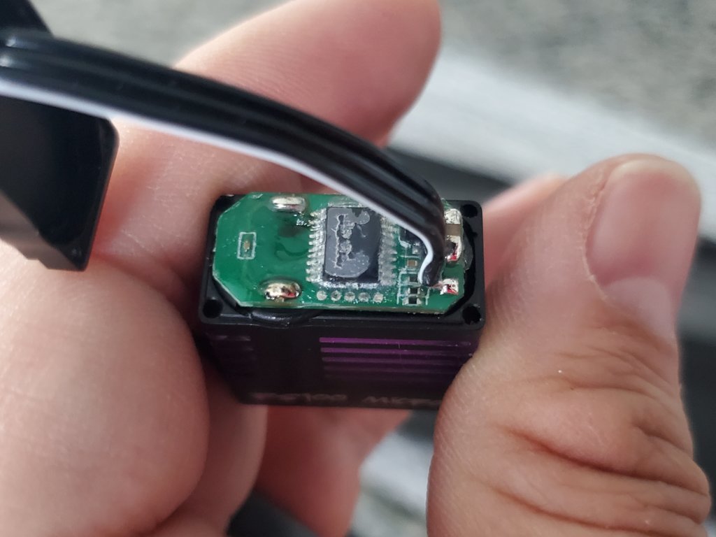

    Regarding the NSDRC servo, they want me to ship it back.
    Was really hoping they'd just have me open it up. I'll have to remove the rear plate just in case I don't get it back.

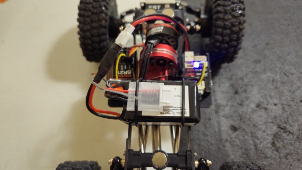

    3s battery showed up.
    fit better than I expected.
    Weight 26.4 grams. The 2s I was using is 22.7 grams.
    Ran it full tilt for about 30 seconds on the carpet, then did a hill climb. Low speed control is the same, just comes on a bit sooner on the trigger. High speed was a bit better, not by too much, but was faster.
    ESC and motor did run hotter than with 2s, just going by touch. This was just after a couple minutes of run time. Wasn't bad, but maybe check now and then and see if it levels out in a safe range if you decide to try one.
    https://www.motionrc.com/products/a...3?syclid=bea4b634-ffad-419f-a506-71c40d4c571e
    Did not notice any difference in torque or anything like that. I'll run it with both batteries for awhile and see what they do for performance and run time. I doubt there will really be much difference other than wheel spin.

    Also, I meant to ship the servo back today but I ran out of damn ink to print my label :annoyed:
    It's just a servo but FYI, shipping will be on your dime if you ever have to send them anything. Just sucks because the black and purple looked so damn cool.
