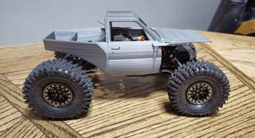

    Dude that looks sick.
    After today I totally asked myself if I want to bother with making another body; it toppled over several times so it's all scratched :bananadead:

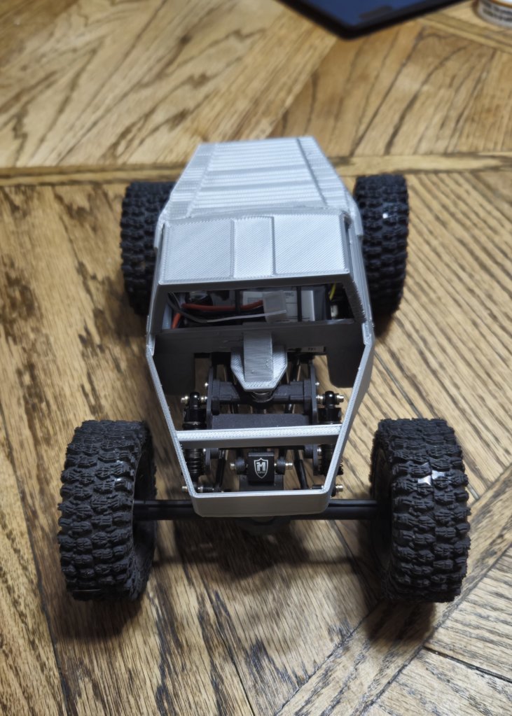

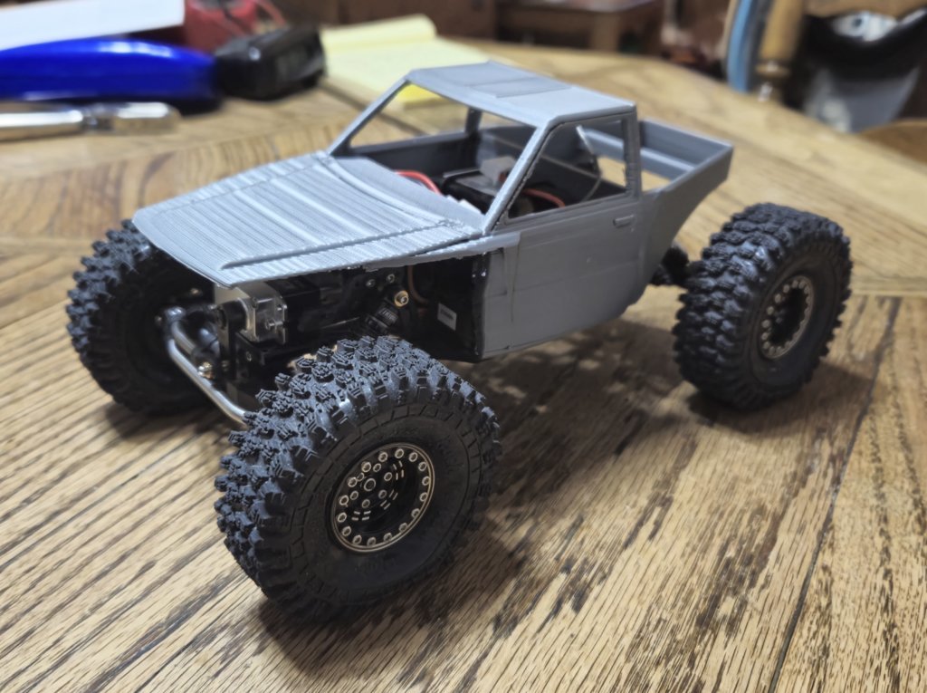

    I'm thinking the bug might be for display and the Yota for play. It can easily be reprinted. Even though it's heavier, it's all down low on the Yota. The bug has the weight at the very top with that roll cage, which could be removed or cut down, but I hesitate to do that just yet.

    Yeah, if I had a 3D printer I'd probably print bodies so they can get beat up as you can easily replace them.
