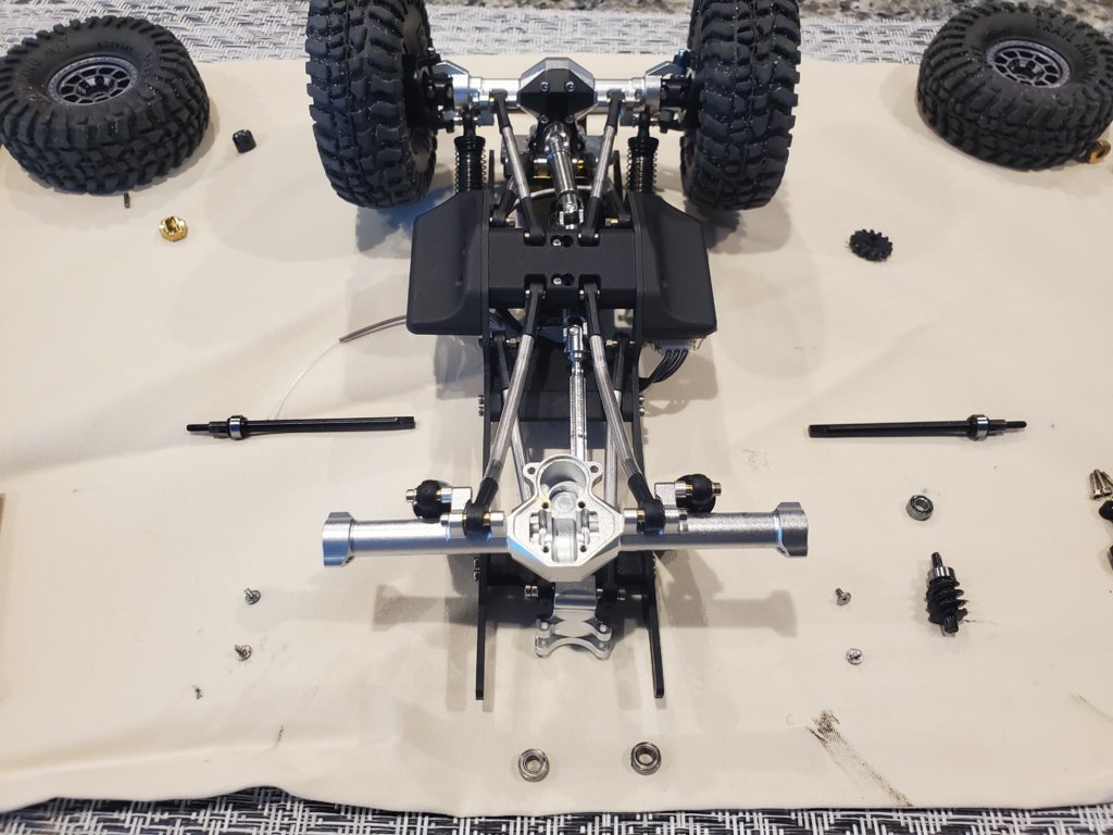

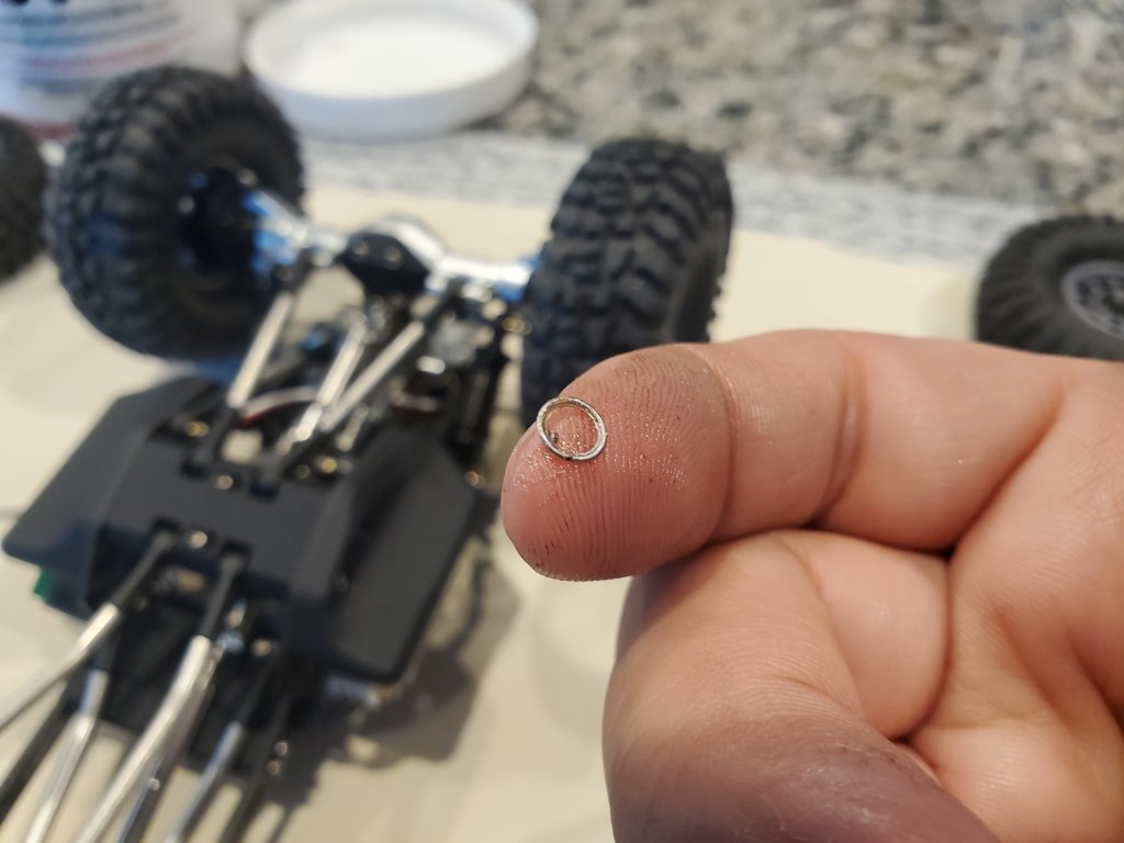

    About to put things back together. Had cleaned everything out trying to figure out the issue until I found this...
    This was spinning inside the diff.
    Swapped out to the underdrive gear set, pulled off the rear springs, and threw some CV-2 grease in it.
    Fortunately all the bearings spin but I'll need to buy some replacements now that the ball bearings are exposed on one. I placed that inside the diff housing facing towards the housing itself as a temp fix.
    Putting it back together hoping that was the odd noise I heard.
    lowmower and Deathbysnusnu like this.

    Ignore the background noise and makeshift ramp lol but it's the steepest thing I've got in the house. The silicone mat I use for rolling dough provides tons of grip.
    Noise, as well as any lurching, is gone -
