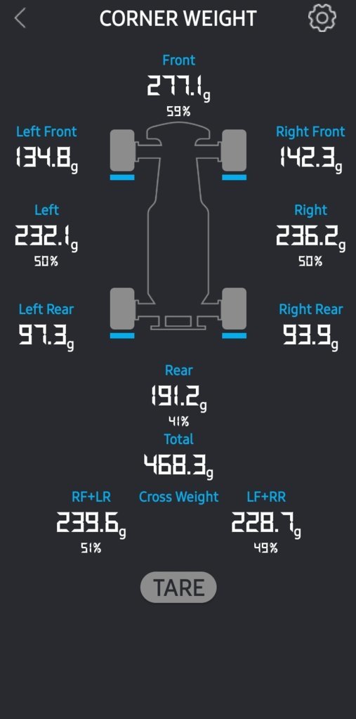

  11. Feb 7, 2025 at 8:59 AM
    Kwikvette
    Feb 27, 2019
    #284735
    82,925
    Fresno County
    4 run, 2 don't
    Roody, lowmower and Strictlytoyz like this.

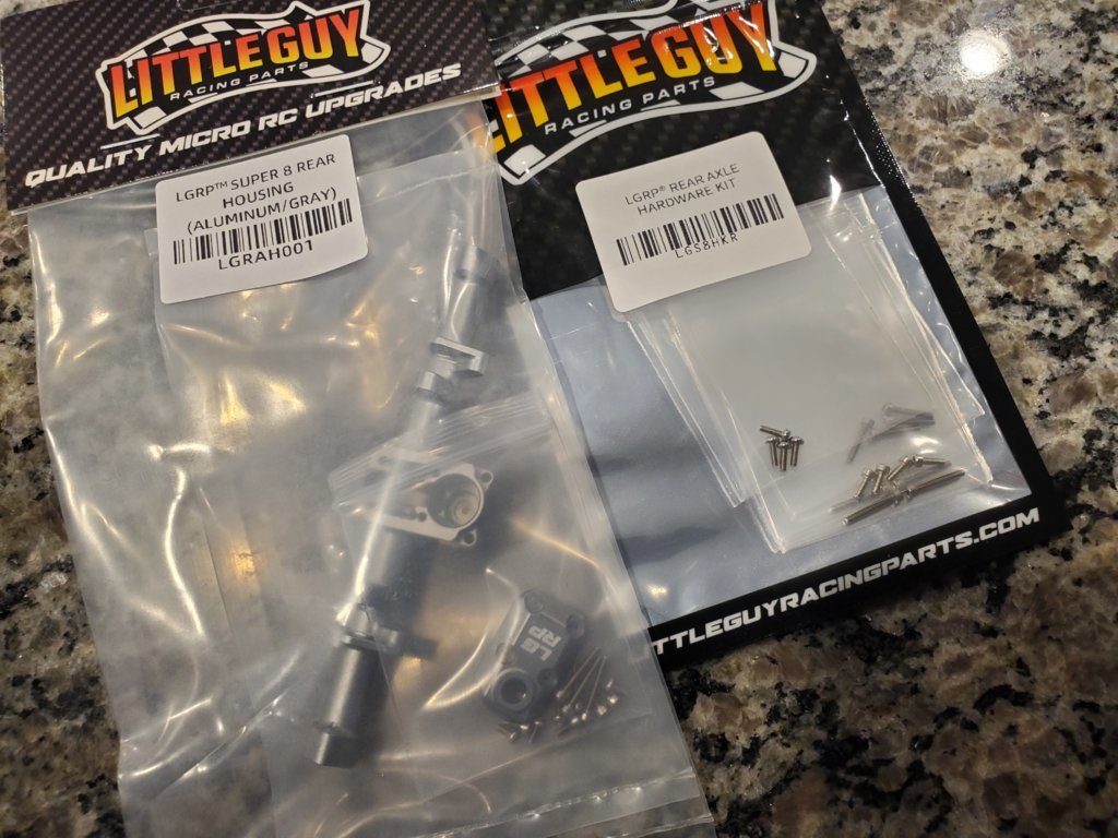

  12. Feb 7, 2025 at 9:10 AM
    Strictlytoyz
    Strictlytoyz Well-Known Member
    Jul 23, 2015
    #160147
    2,850
    Charles
    HA\/\/AII
    07 Shitbox
    Ouuuuu, is that a rear axle you're setting up?
    Kwikvette[QUOTED] likes this.

  14. Feb 7, 2025 at 9:15 AM
    Kwikvette
    Feb 27, 2019
    #284735
    82,925
    Fresno County
    4 run, 2 don't
    Yes sir. I bought it to have as a back up to my main rig.
    But interestingly enough, I guess the hardware kit wasn't needed?
    I know bolts are mostly interchangeable as they're all the same pitch, just different lengths.
    I guess the only important ones are gonna be the 4 short ones for the diff cover, with the shortest bolts of all used to hold the axle shafts.
    Strictlytoyz[QUOTED] likes this.

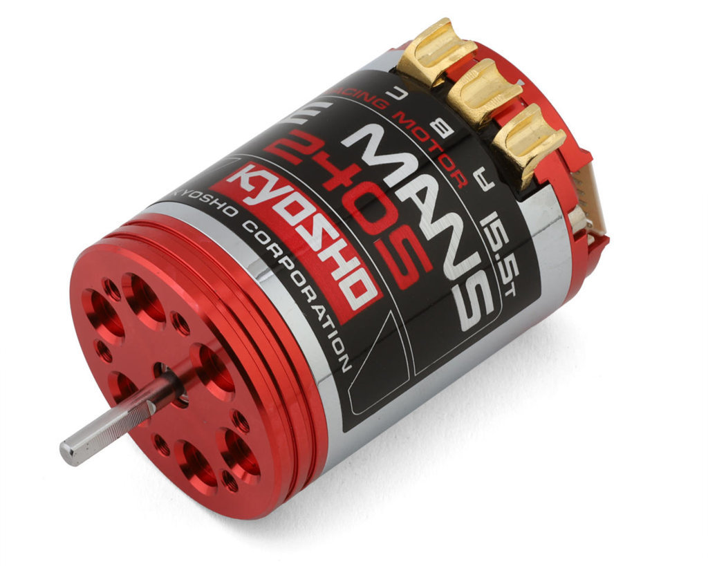

  16. Feb 7, 2025 at 9:18 AM
    grambo911
    grambo911 Well-Known Member
    Oct 9, 2023
    #435127
    518
    SF Bay Area, Kommiefornya
    2023 Lunar Rock Trail Edition
    AWE Exhaust, KARTBOY exhaust hangers, custom 1/0 exhaust grounding, lots of Titanium hardware from my old builds, silly JDM bits from my old Subaru builds, Uniden Bearcat Off Road CB, Firestik 2 w/custom CF mount, custom KARTBOY plate frame with Rigid Industries Spot on ball head mount, Yakima Mega Warrior w/custom CF cross brace. ARP extended studs (not installed yet), Optima Red Top, Siless Insulation in cab. Diode Dynamics LEDs throughout... More titanium fasteners. K&N intake snorkus delete. Greddy hose clamps throughout. DBA 4000XS Brake Rotors. TRD PRO fogs. Dakine Tail Gate Pad. Body Armor Sliders. Icon Stage 4 Lift. Eibach 1" Lift Blocks. Overland Taylor Tune. Rough Country Spare Tire Bed Mount. 67 Designs stuff on the dash. Uniden Radar Detector Hardwired. Spod Lighting Controls. RC Black Series Bumper Lamps RC Black Series Grill Lamp. Body Armor Stealth Front Bumper. Extended Brake Lines. Greddy Shift Knob. More to come of course.
    It finally landed. Now I need to build it.
  17. Feb 7, 2025 at 9:19 AM
    Kwikvette
    Feb 27, 2019
    #284735
    82,925
    Fresno County
    4 run, 2 don't
    @Deathbysnusnu
    @Strictlytoyz
    Rig minus battery
    My 180mah battery is 15g and my 350mah battery is 25g so total weights are 468 and 478g respectively.

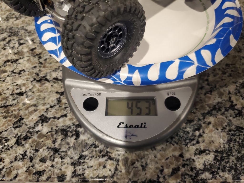

  18. Feb 7, 2025 at 9:59 AM
    Deathbysnusnu
    Deathbysnusnu Work is just a daily detour to happy hour.
    Oct 4, 2013
    #113825
    17,368
    Brett
    Fort Crawlins, CO
    Vintage Tundra
    Dog, camper.
    552g, no battery or body. Battery brings it up another 25g. Might go back to the lighter wheels as mine is struggling too. It'll still be above 500g though. Talking with the hobby shop guy this morning, he said to recalibrate the TX to the ESC, I'll try but don't have high hopes for that.
    How in the hell is mine so much heavier with hybrid axles and a shorter frame?
