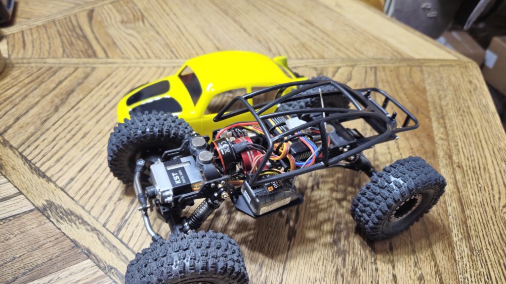

    Starting to have doubts about the Furitec hype. Replaced all the bearings in the transmission. One was notchy. What led to that was the trans getting hot during operation. Hotter than the motor.
    It did not make any difference. Motor still runs like shit at slow speed under a load. Just cruising flat, it's fine at all speeds. High speed is fine, scoots over obstacles and hill climbs.
    Not sure if it's the motor, ESC or both. Not sure if I want to use the same brand or try something else with less hype and more honest reviews.

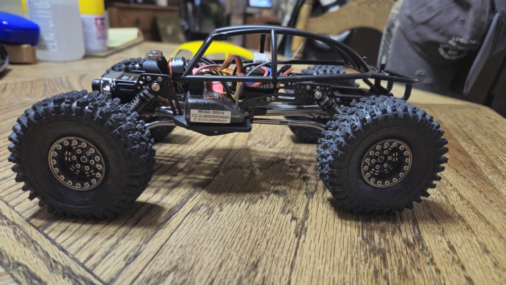

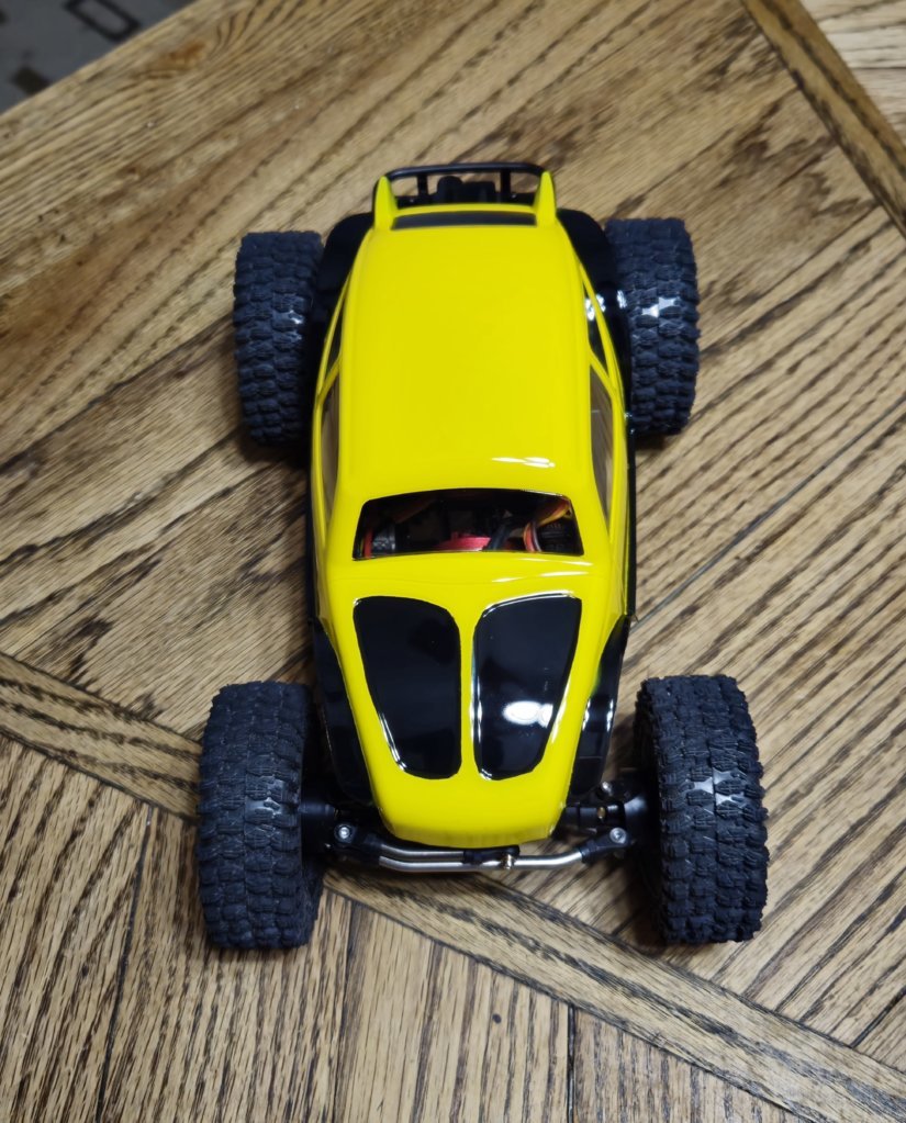

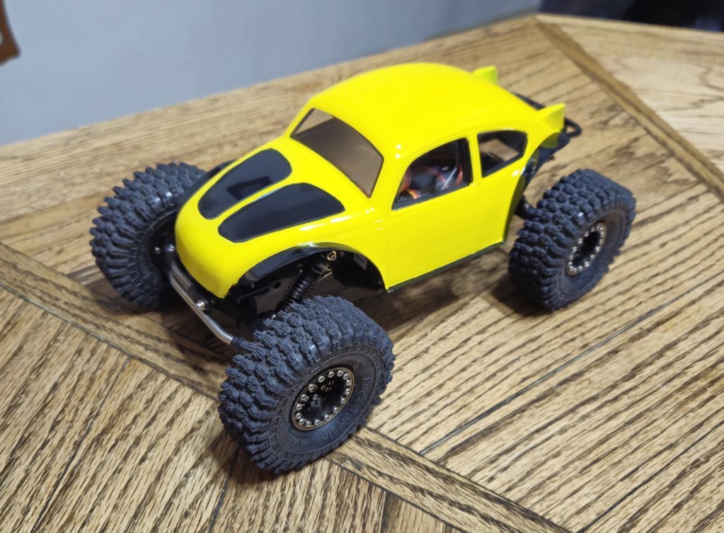

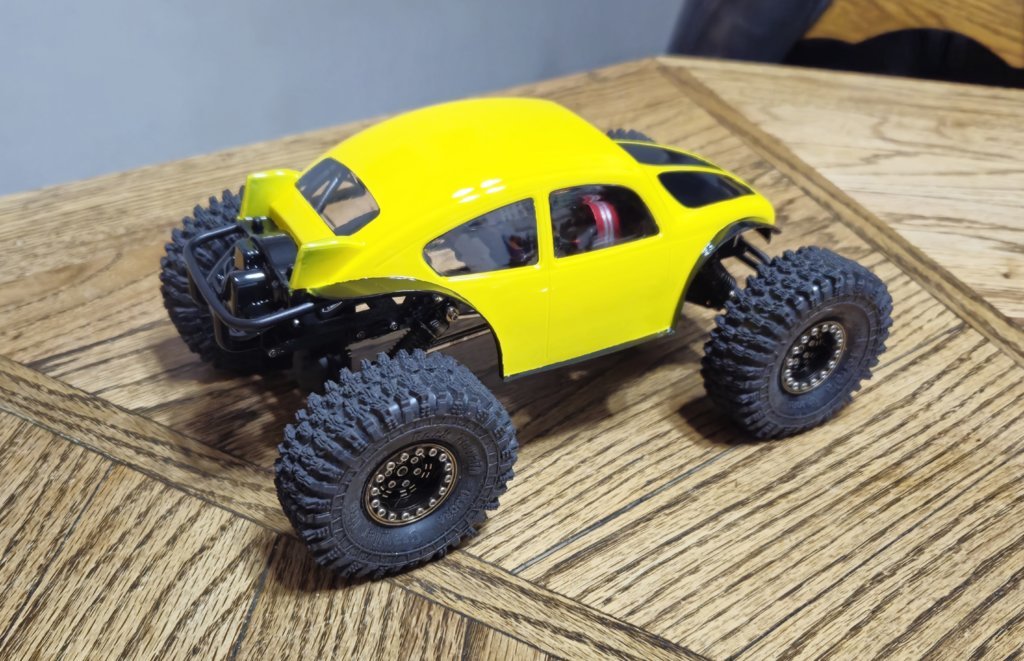

    Body is advertised as 132mm wb, car is 145mm center to center wheel base.
    I was concerned the body was gonna be short on it, appears to be about perfect. :p
    Cage only. removed front lower bar for motor clearance. It didn't hit the motor bell, but was a couple mm from doing so.
    Removed the Mazz rear plate and the hinge from the Injora body and printed the entire thing with less overall weight and easier to deal with.
