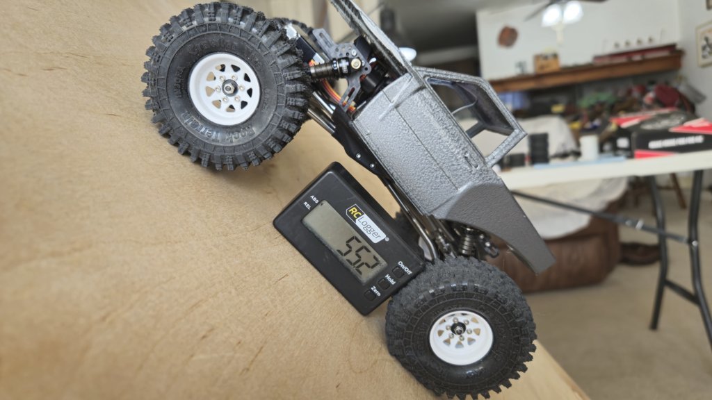

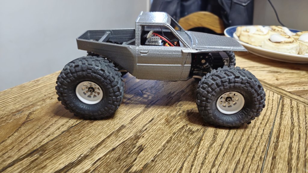

    Dropped 109g by just switching wheels and tires. These are 68mm. Total vehicle weight of 506g.
    Did pretty good considering these are not as sticky as the other tires. Still managed a 52 degree slope.
    Prolly gonna order some aluminum wheels, and use the existing brass inserts if needed.
    The motor was definitely less burdened. I believe there has been some damage done to it at this point as it's simply just not the same as when new.
    For today, I'll switch the sticky tires on to these wheels and see how they perform.

    Swapped over to the stamped steel white spokes. Kept the inner brass ring. Side note, it's 2mm wider than the aluminum ring and the wheel halves clamped down just fine.
    Went from 72.6g per tire /wheel to 48g
    went from 290g of rolling mass to 191.7g.
    Total weight with body and 25g 3s battery is........521.9g :benchpress:
    and it does better in every respect.
    I was lifting a wheel on this before, due to the added torque of being over weight, the solution was to add more weight of course. :rolleyes:
    4 wheels stayed planted full climb. Tires exhibited better grip and less slip. I think it may go steeper before it rolls over instead of wheel spinning out first.
    Side hill improved immensely. I was exceeding the grip in the tires.
    This is the new look, less show and more go.
    Motor seems much happier. I'll run it for a bit more.

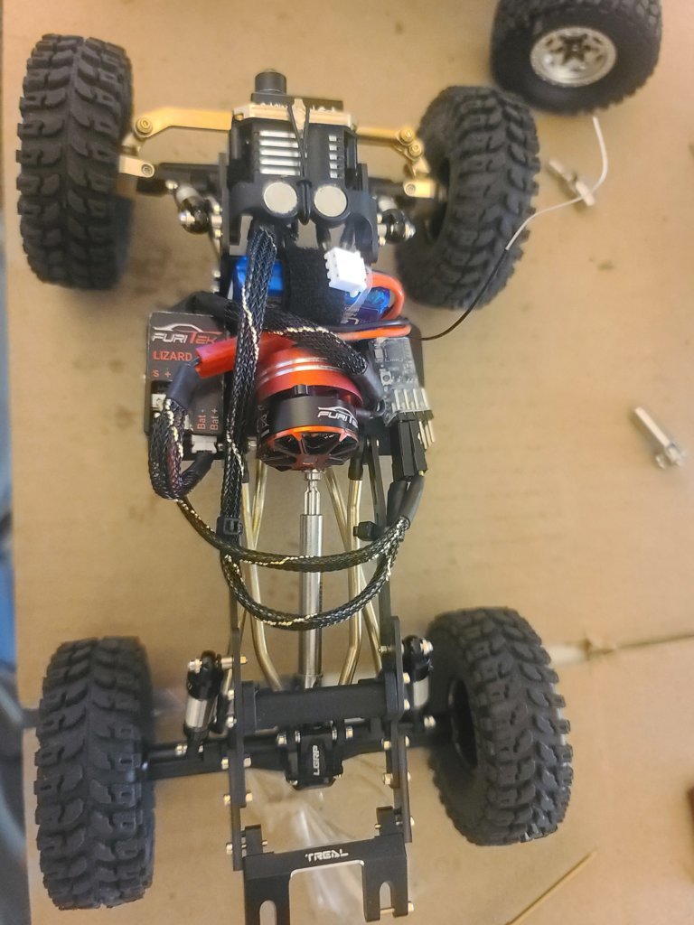

    Messing with the idea of rear facing motor with battery up front too in case I need a bigger motor
    Deathbysnusnu[QUOTED] likes this.

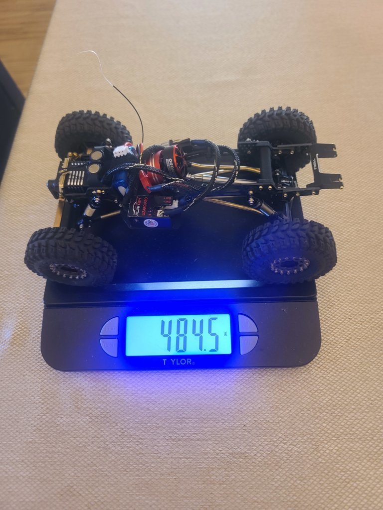

    Weight fully loaded without body.
    Gonna see if I can get close to 400 before the body goes on

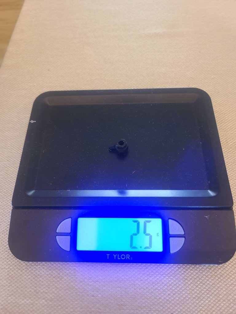

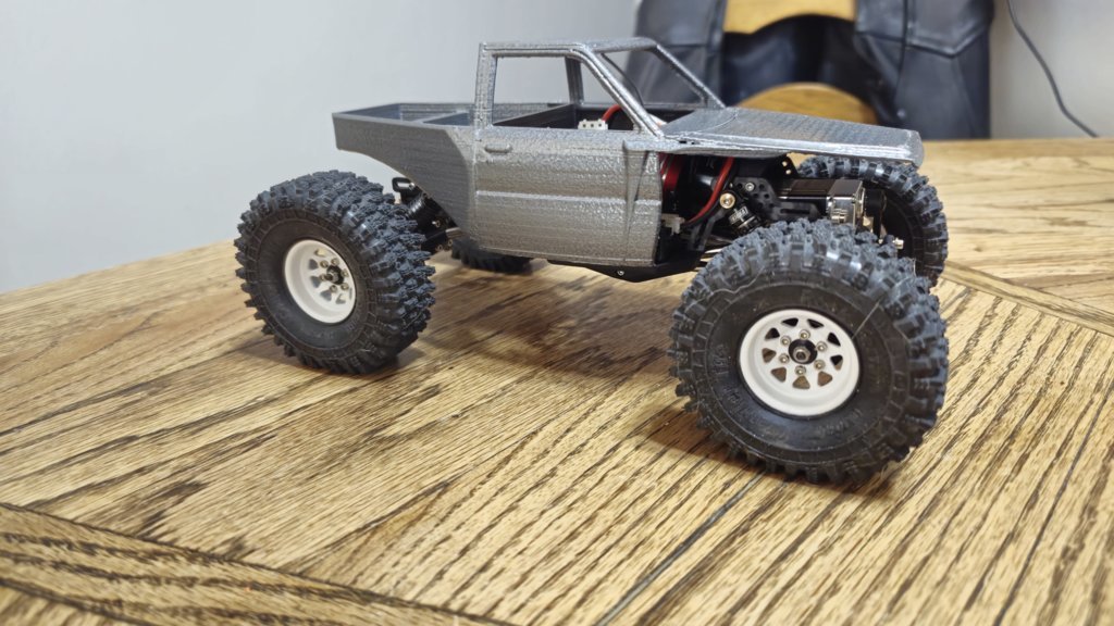

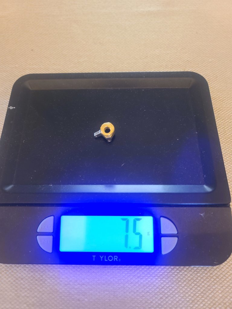

    @Deathbysnusnu

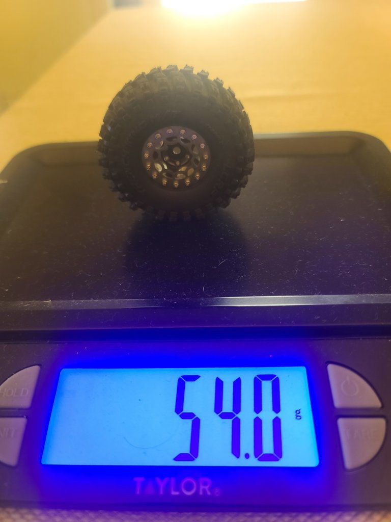

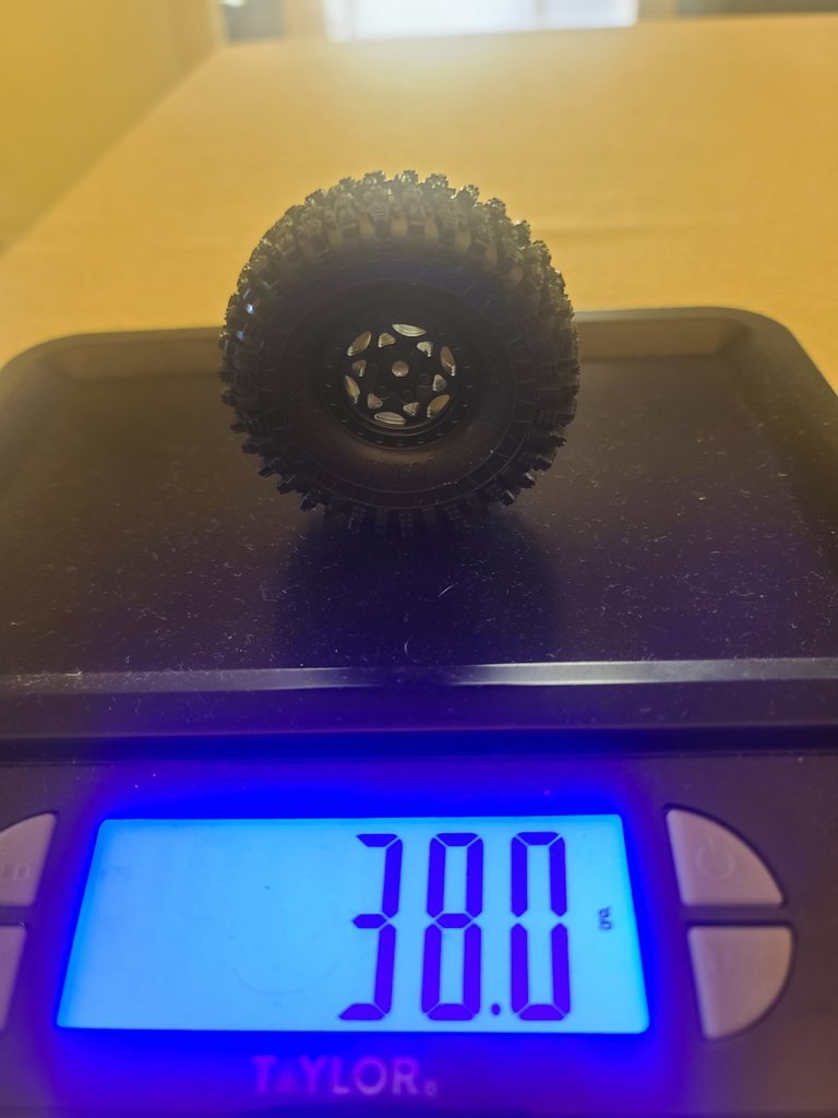

    Current Setup with 63mm trench kings
    New setup with 64mm rock terrains
    Current brass knuckles
    Factory knuckles
    Deathbysnusnu likes this.
