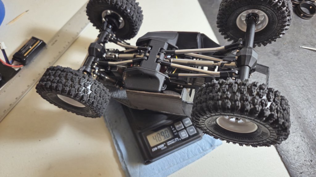

    You're 10g lighter per wheel now than I am. I could prolly get there swapping the brass rings for aluminum...
    I still can't get over how much lighter the two of you are with the full metal axles.

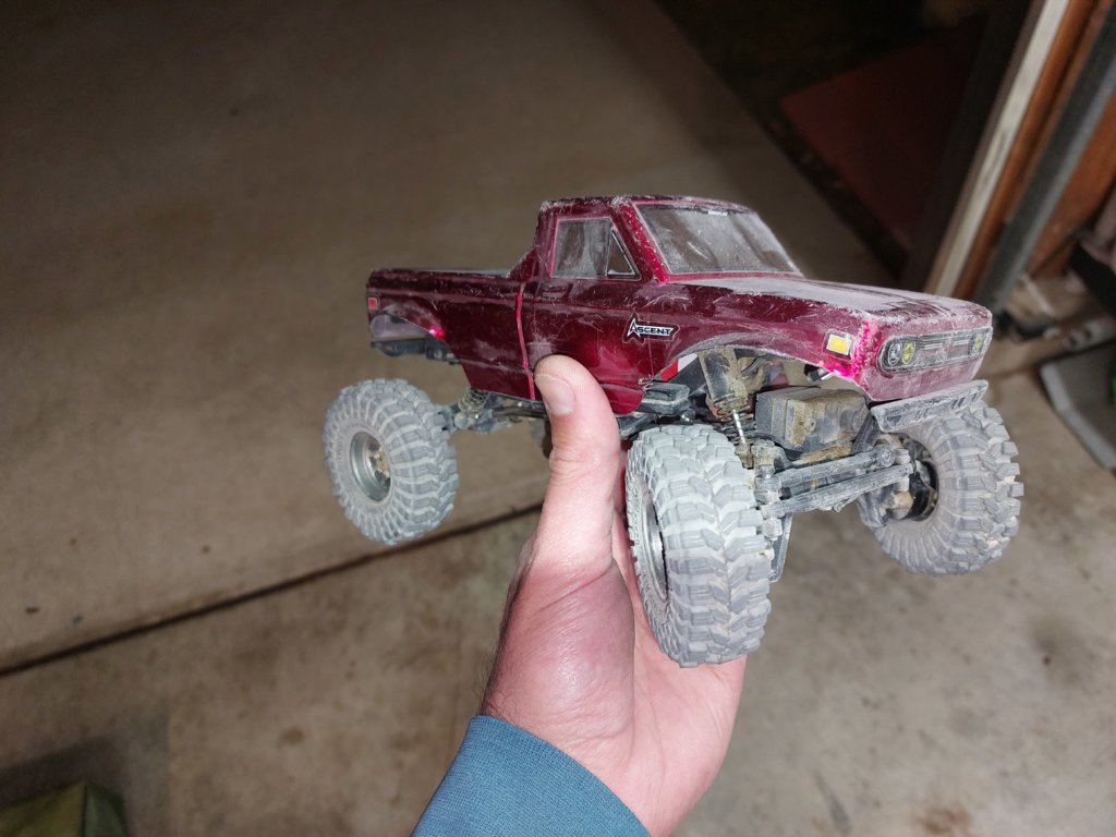

    @Deathbysnusnu
    Motor still whines after the weight loss just not as bad but atleast now it keeps the tires spinning. Will probably still end up swapping to a stronger motor because like you stated earlier the damage could possibly already be done. Kind of like the back mount motor setup as it allows the battery to sit up front adding a little more front bias. Need to trim the body a little with these 64mm tires.

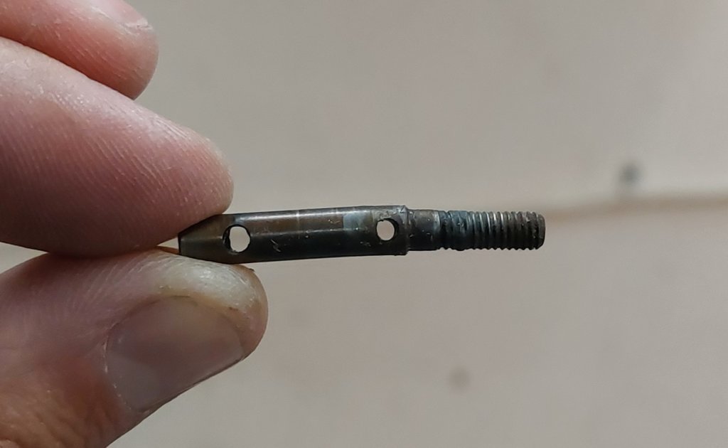

    Removed the brass rings. First time full build on scale, 3s battery.
    still does a 57 degree incline and everything else I ask of it.
    :frusty:
    If I had only known, could have saved around $100 or more. Motor is much happier now and might be ok, although maybe weakened. If I can determine it's the motor itself, I'll go ahead and replace it since it fits so well.

    Still 21g heavier than me, fatass :luvya:

    I remember reading that it isn't so much about adding weight, but lowering the existing weight as much as possible.
    You do this after trimming whatever unnecessary weight you can.

    Bigger battery.

    There isn't much more to remove. :rofl:
    Silicone inserts could be changed for foams, that might knock another 20g off.
    I suppose full aluminum light weight wheels to replace the steel stamped. Maybe another 10g?
    Smaller battery, arbitrary weight at this time that can be relocated.
    Everything else is as it came out off the packages.

    True, and removing weight in something like the wheels helps with rotating mass but takes away from that beneficial weight as it sits below the axles.
    Guess that's why a lot of people have fun with this aspect of the hobby: tuning.
    I'll be curious to see how much my second set of wheels weighs as they're just raw aluminum with the same wheel weights.
    @Strictlytoyz and I both ordered Slymeballz too so I know my total weight will go up once I install them.

    I like that you can see the rear facing motor. Is that still with the 15 degree skid?
  17. Feb 9, 2025 at 4:05 PM
    Strictlytoyz
    Strictlytoyz Well-Known Member
    Jul 23, 2015
    #160147
    2,838
    Charles
    HA\/\/AII
    07 Shitbox
    Yeah still using the 15⁰ skid

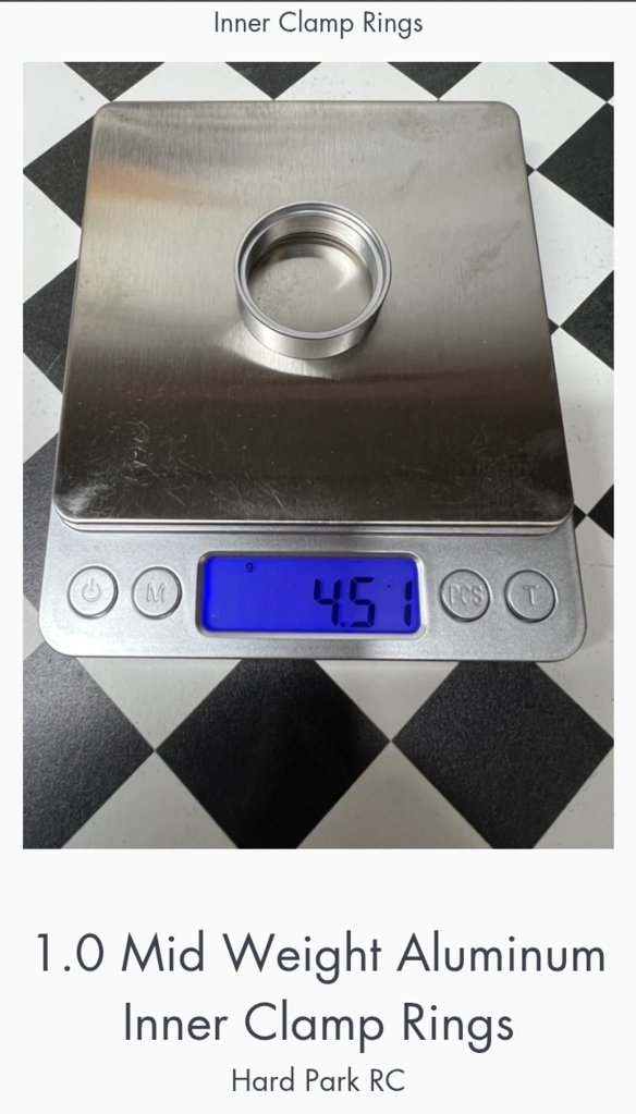

    Gonna pick up a set of these wheel rings from hardpark when they're back in stock
    They also have a 1.74g light weight and 14.54g heavy weight version. They're made to fit the treal type b wheels I originally had on the truck. This will allow me to still use the slymballz I had spec'd for these wheels and tires
