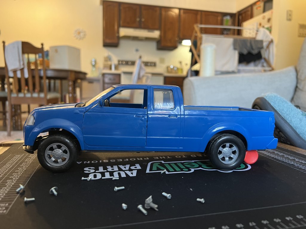

    Found a body for my Ascent at Goodwill over the weekend. I wanted something that would be a bit of a project, so I settled on this "F-150." Ignore the squat, I took it apart before taking the picture and didn't feel like screwing it all back together.

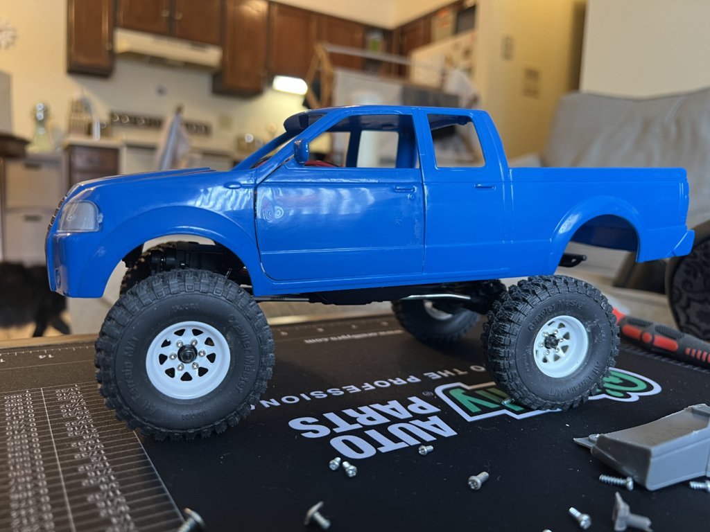

    It was way too long for the Ascent, which I knew going into it.

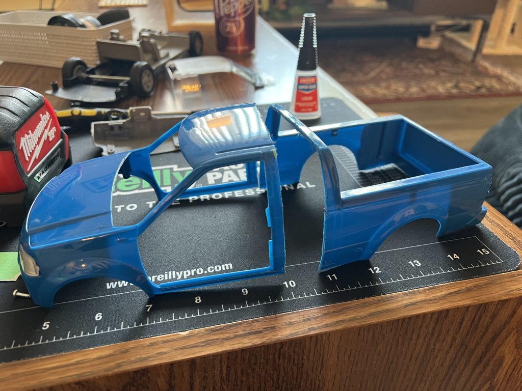

    So I chopped out the rear door

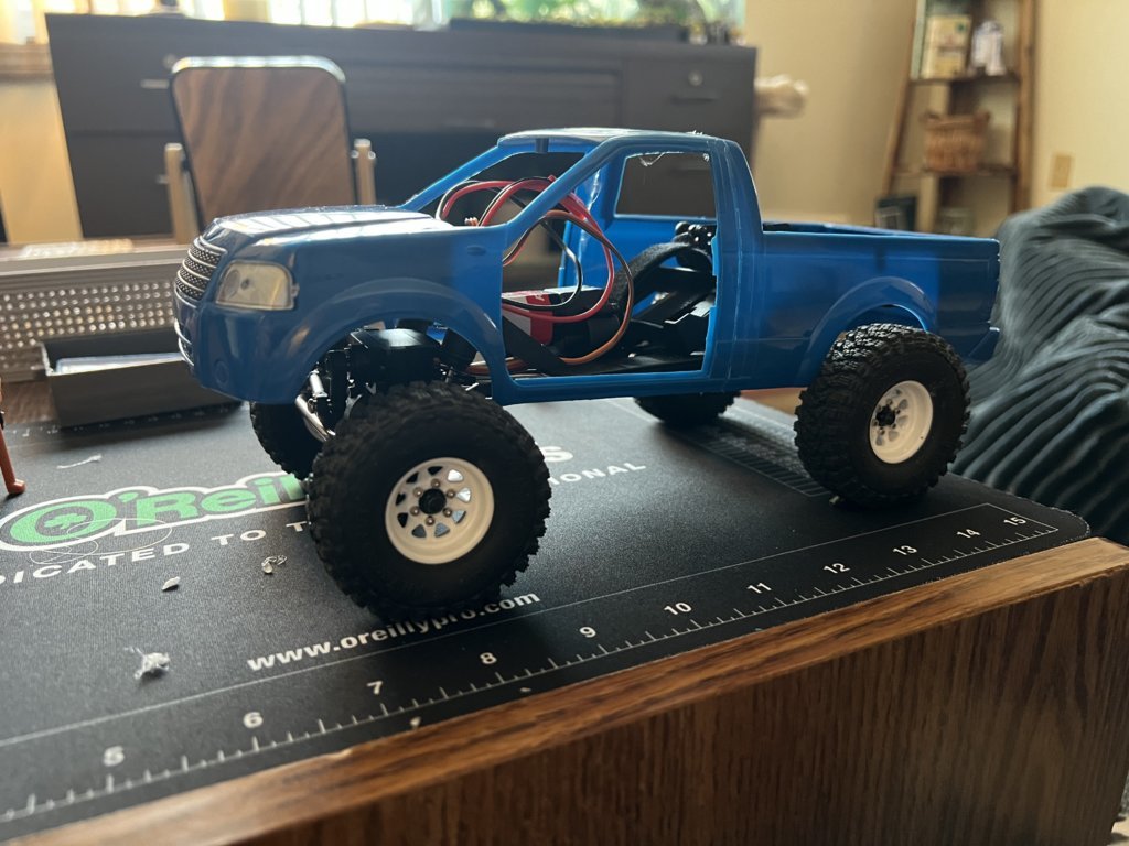

    I used hot glue to put it together. We'll see how it holds up, but I figure that because of the small size it won't be too much of an issue. On a 1/10 it would definitely need more reinforcement. I'll probably add a bit of superglue and sand it down to make the seam a little less obvious. I also cut down the interior pieces to fit the new single cab setup. Finished day 1 happy with what I accomplished.
    Next up is smoothing out the cut line as best I can then painting everything. Should get to it Tuesday. Paint also should get here today for my 1/10 Tacoma, and I picked up another small 1/64 project that I'll probably get to next weekend.

    When I pinch a body I use bondene or plastruct (MEK) to weld the plastic, then reinforce with a strip of styrene and super glue on the inside where it won't be seen. Tamiya putty works to fill in like bondo and sand smooth before paint

    I would do something more secure but right now I'm challenging myself to keep it as low cost as possible - so far I'm in $2.99 for the body and that's it.

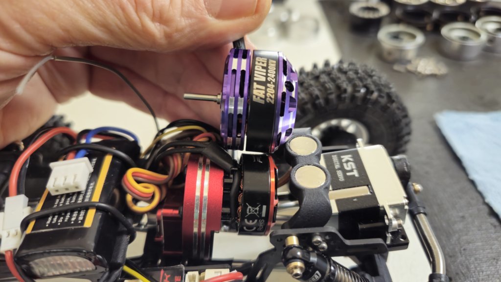

    Fat Viper. It will fit, with either moving the body support forward, or the 15 degree skid, or running it toward the rear.
    It runs fine on the Furitec ESC, just about as slow of rotation, much higher top end. Saving it for the UTB build.

    The Furitec Lite doesn't have motor settings afik. It's programmed with a card and just has rotation, LVC, BEC and drag brake settings. I just plugged it in and it worked. :notsure:

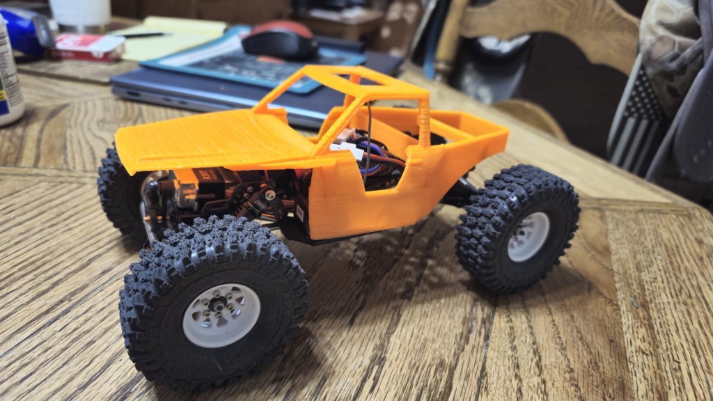

    :spy:
    down to 34 grams from 43.
