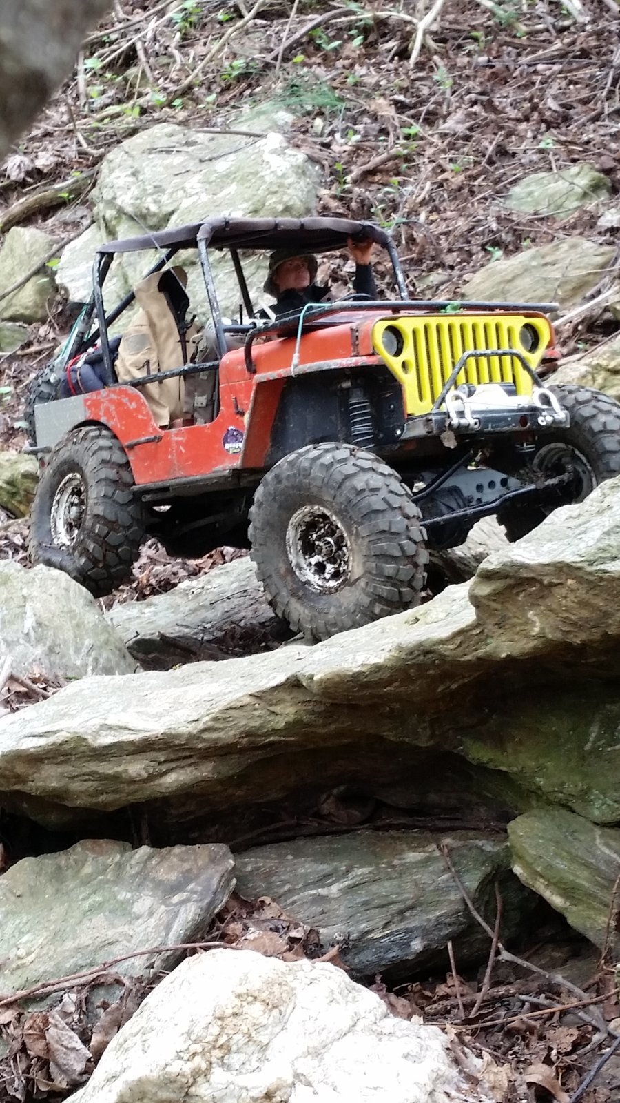

    I can't remember if I've shared this before, a Hasbro 1/6th scale Willy Jeep push toy converted to RC. At one point, there was 6 of these in a group. One guy had a ravine running down one side of a property line, it was like a scale sized Rubicon trail. Last week, somehow I found myself on the old RCCrawler site and I found my old build thread. Good grief, I built this rig 15 years ago! It doesn't get used anymore, it's been a least 2 years since I powered it up.
    35 turn Holmes Hobby Torque Master running through a bone stock AX10 trans under the hood, down to an underdrive disruptor (rc4wd), to narrowed AR60 axles. Solid SS links w/ Revo rod ends for the axle links, SCX10 coil overs. Pin drive rc4wd steelies. Lots of 'old school' stuff that probably isn't available anymore.
    GI Joe has a ball socket for a shoulder on his right arm, his hand is glued to the steering wheel which is "Y'd" into the steering servo, so when the wheels turn left or right, the drivers hand turns left or right.

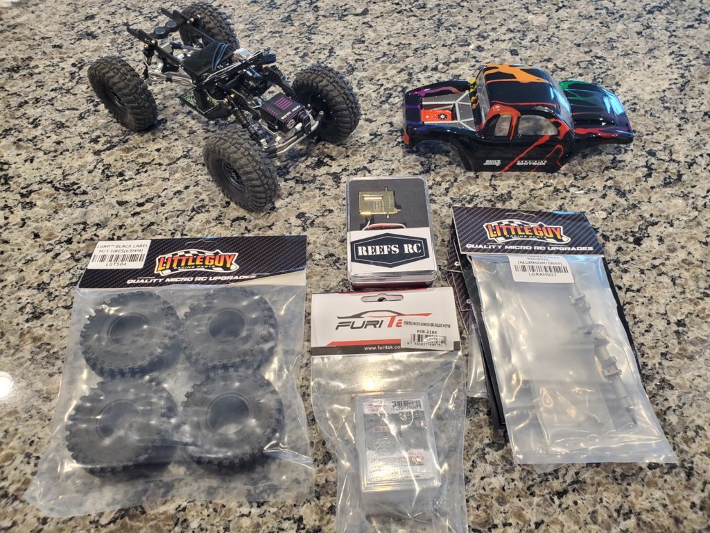

    Maybe on another build? Im looking at my extra parts for the next build and I'm like, what the heck am I gonna use this Mini for?
    So the extra Micro will definitely be used.
    The LGRP wheels arrive tomorrow so all I'll need to finish the next build are -
    RX, ESC, front axle, driveshafts, body, and shocks.
    I got chassis and links coming from that Mazz order.

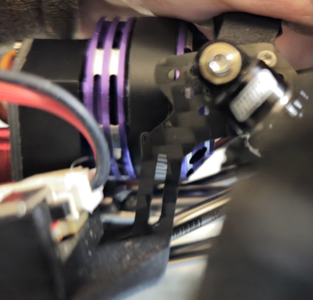

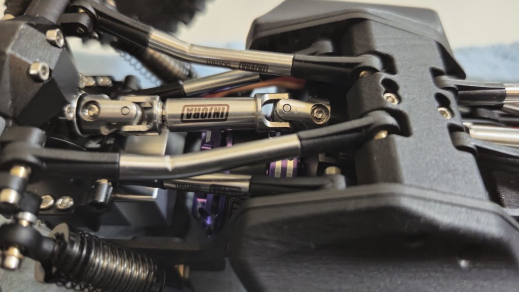

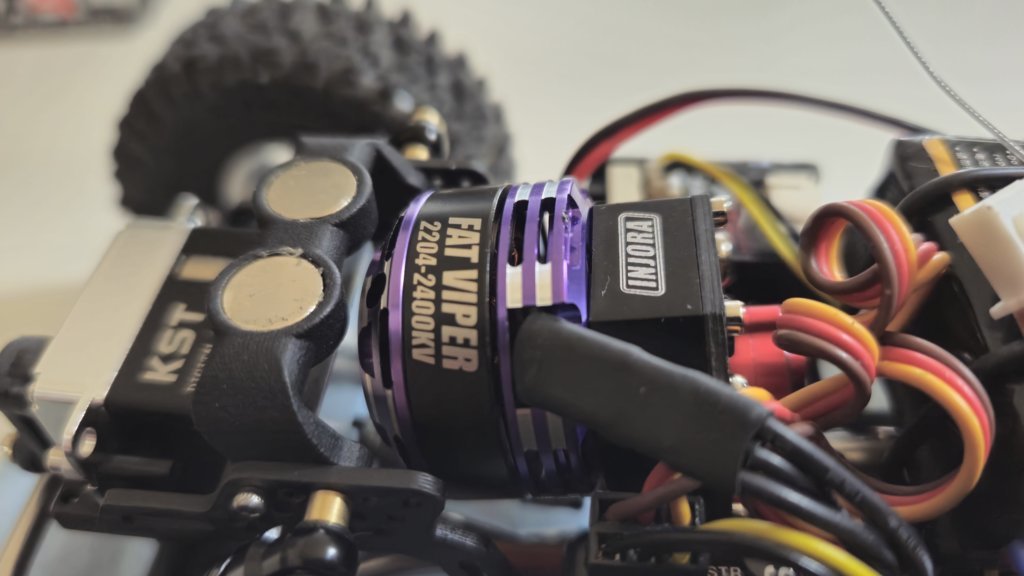

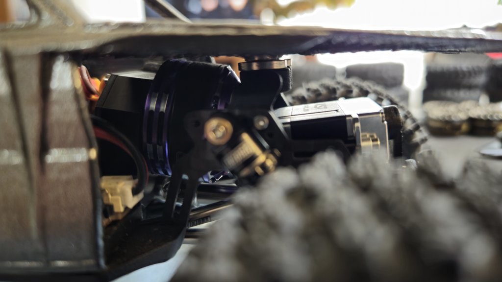

    The Viper fits.
    Started by installing the 15 degree skid, not gonna happen with front facing motor, the fat bastard slams right into everything.
    So the 10 went back in, and it's close but clears.
    Just a couple mm from the driveshaft.
    To make it fit, just had to move the body mount forward one hole. And then for now a couple of thin shim magnets to get it to clear the hood. I may be able to clearance the hood, or print another with a functional scoop...
    The motor came with a coarse tooth spur/pinion. I was able to reuse the Furitek stuff as it has finer teeth. As a result, I didn't really lose any slow speed.
    https://www.youtube.com/watch?v=JUAnNl1aFzc
    And the torque is waaaaaaaaay better! No more scritchy motor sounds.
    Although it is about double the weight. But with the added torque, I'll start fattening up her butt again as needed
    I did this just to see how it would do. It's permanent now and just ordered another for the UTB build.:cool:
