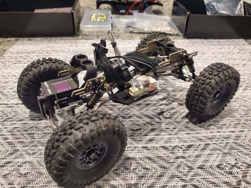

    Think I should just swap everything over from the XL chassis to the standard titanium chassis that just arrived.
    Mainly because the XL chassis serves as a better platform for the long link length IE the Dementor links I've got on the way from Hard Park.

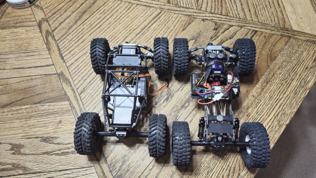

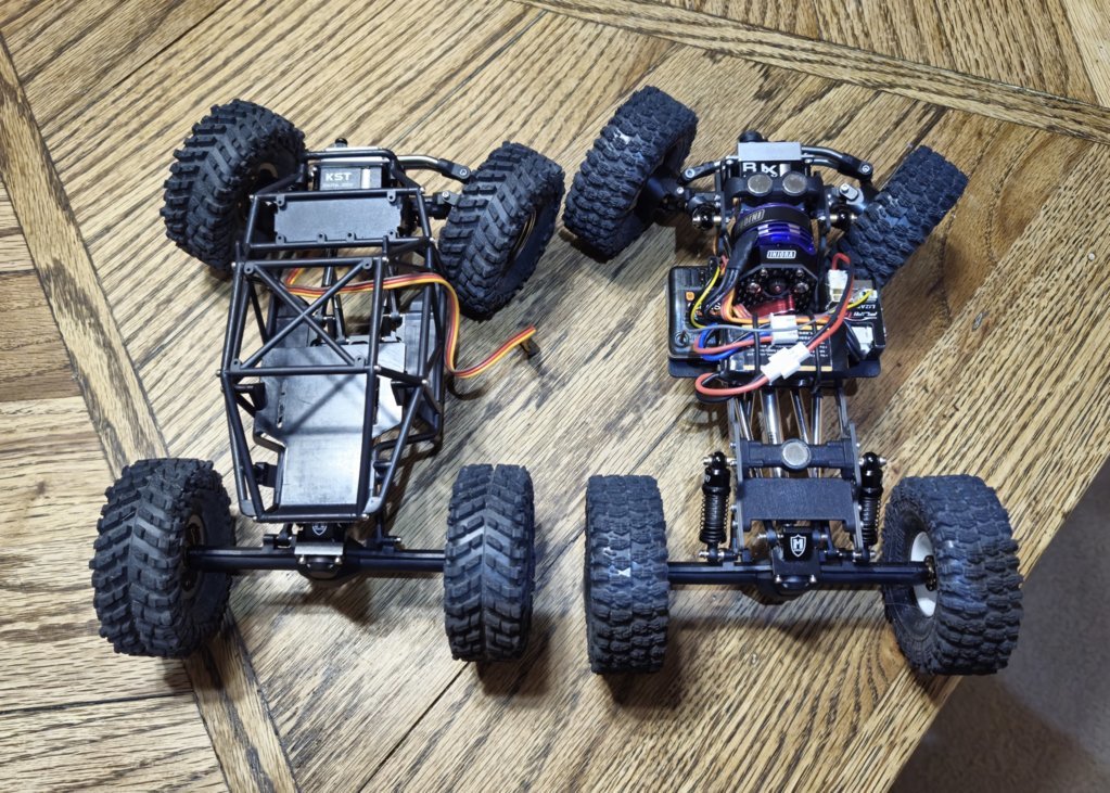

    Transfer complete, not without multiple interruptions, cooking food, etc in between but it's done.
    Have to say, it is much less forgiving for sure.
    For starters, I'll need a new body.
    Fortunately I can just pair my old body to the XL chassis so I'll have something to use for the second build, but the standard chassis needs a new one.
    I'll have to play with shock placement as well, quite a bit more than the XL. Mainly because the C-Bolt length really makes you use the full length of your shocks.
    On the plus side, I just kept motor and skid assembly intact meaning I didn't go unbolting and bolting things back up to my skid. This leaves me with a new untouched skid for the second build, and the extra Joey sent.
    Only difference between the Standard chassis and XL is the added bracing on the XL, as well as the dual magnet design in the rear body mount.

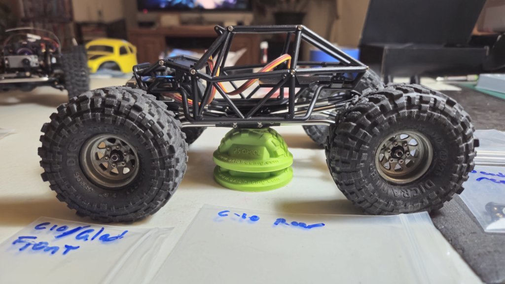

    I have no idea what I'm doing. I was hoping for more bottom weight with it. As far as hanging up, it's a real smooth bottom. Pretty sure this will be a SWB rig...
    I bought Gladiator and Dbolt links. The Glad fronts are the same as the C10, just wanted the extra length rears for something else.
    Laying it out, the C10 links looked like the best balance. And I think they are.
    Sitting on 68's, no shocks yet, so approximate ride height.
    Everything fits well, except, there is shit for turn radius. Travel looked really good though.
    68mm on left, 64mm on right. Barely as much as a stock axle.
    So I stretched it. Used C10 rear links up front and Dbolt rear links out back.
    Didn't look all that bad, a stretch buggy.
    64's get damn near full turn, will prolly hit the shock first anyway as they stand up.
    but the castor went to hell using rears as fronts and having ZERO adjustment in the front...
    You can see it comparing the servo angles.
    So this build is taking a different direction. Gonna go back to C10 links f/r, possibly 39mm shocks over 40's just for the smaller diameter, and stay with the 64's and see how it does. Those particular tires suck balls for grip, so I have no problem downsizing a bit and getting better rubber if it comes to it.

    I think it was meant for the C10 wb. Castor restored.
    Radius isn't that bad and will get better once it's sitting on the shocks.,
