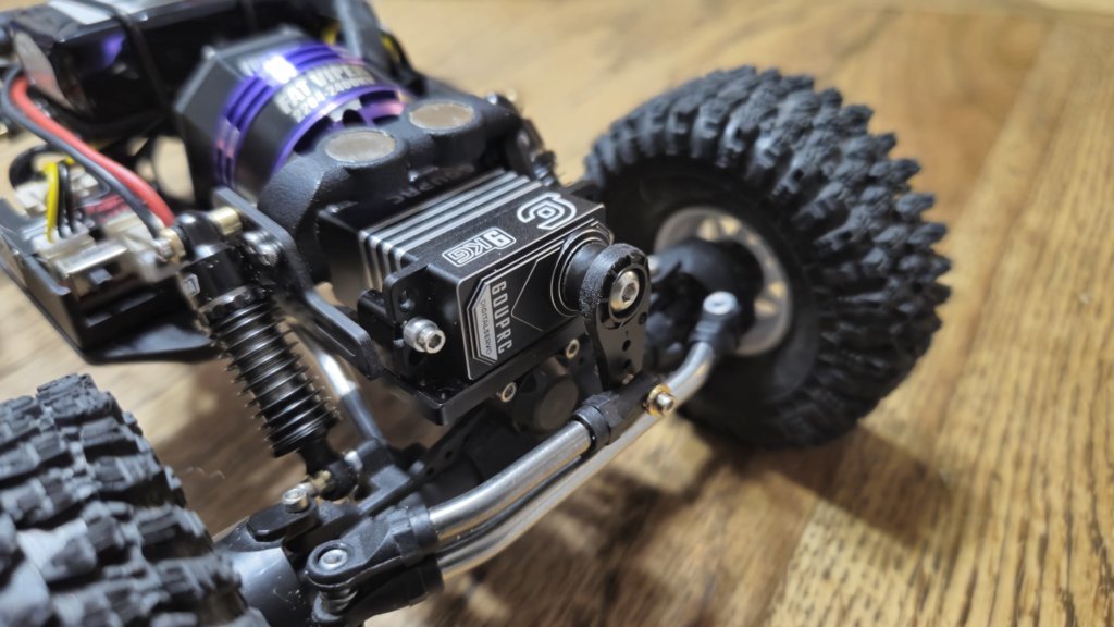

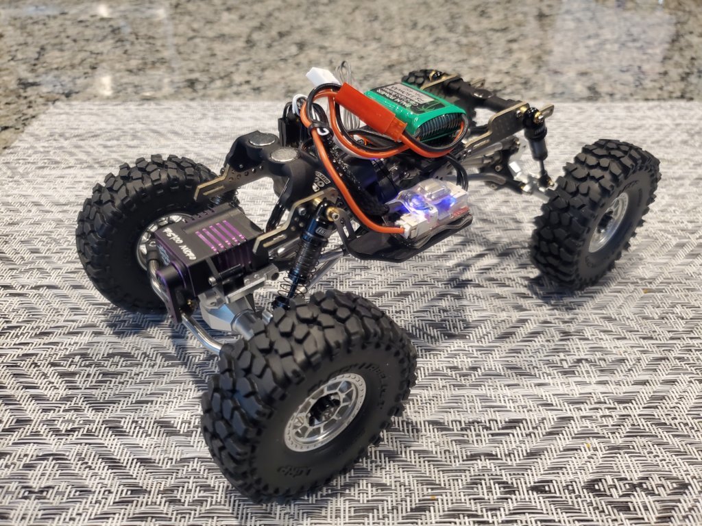

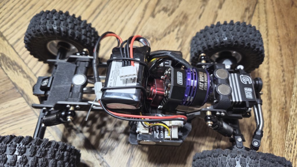

    Broke down and replaced the servo. It's soooooo quiet now, no more whining.
    I think it was meant for 1/18. has 25 splines and uses big boi horns. The one I was using was way too small. It did come with a nice aluminum horn, that is the perfect length, but drilled too large for the drag link.
    And redid the wire again. Last printed body was down to 30g. Green was too dark, so trying a shade of red. I've been thru 4 batteries so far, average about 45 minutes per. Fat Viper hasn't skipped a beat, doesn't ever get warm, would recommend.

    Whatcha using the rear tray for?
    Was gonna ask about your layout since I'm now running the same chassis as you.

    Nothing more than adding rigidity to the frame. Plus a bit of rear weight. Maybe an alternate battery mount. It does seem nose heavy now. Servo was 3 grams more, amazing how the slightest shift in weight can be noticed.

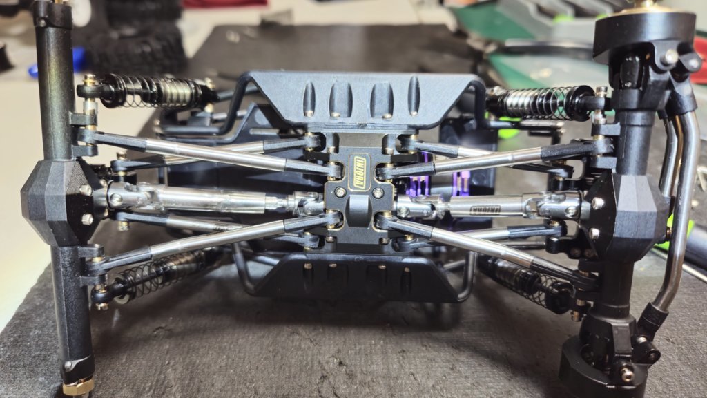

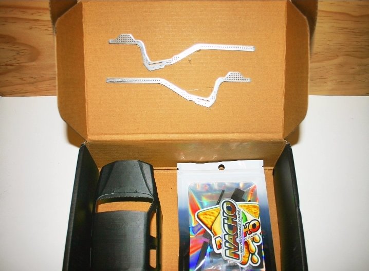

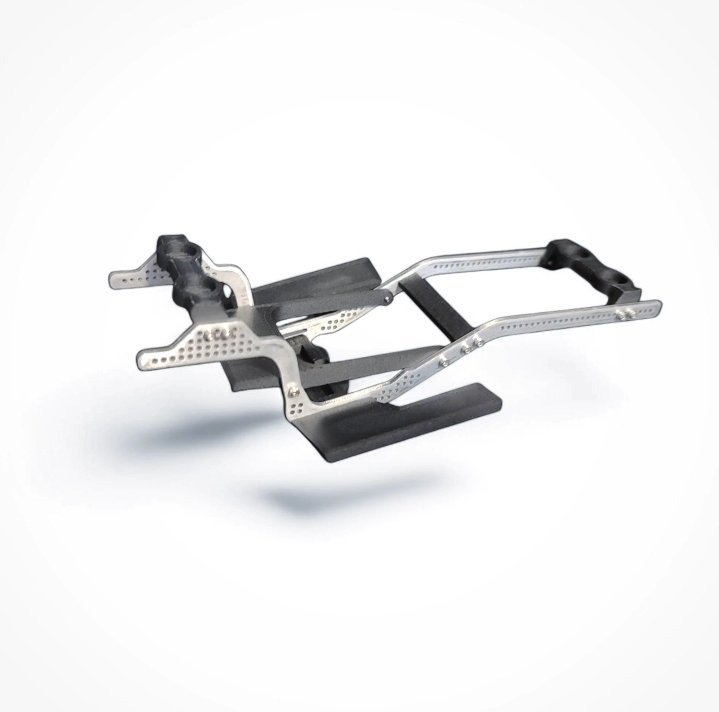

    Got my nacho_crawlers chassis and body today. This will be the next build. Settled on going spider 9's on this one

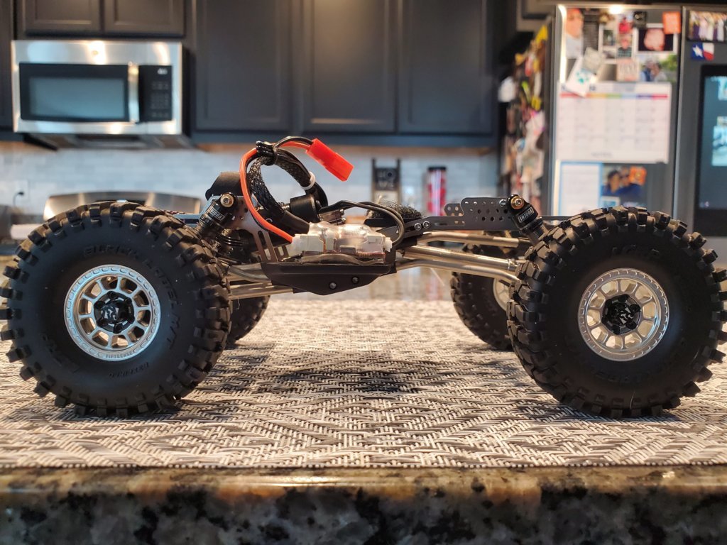

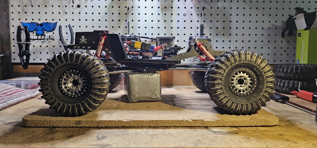

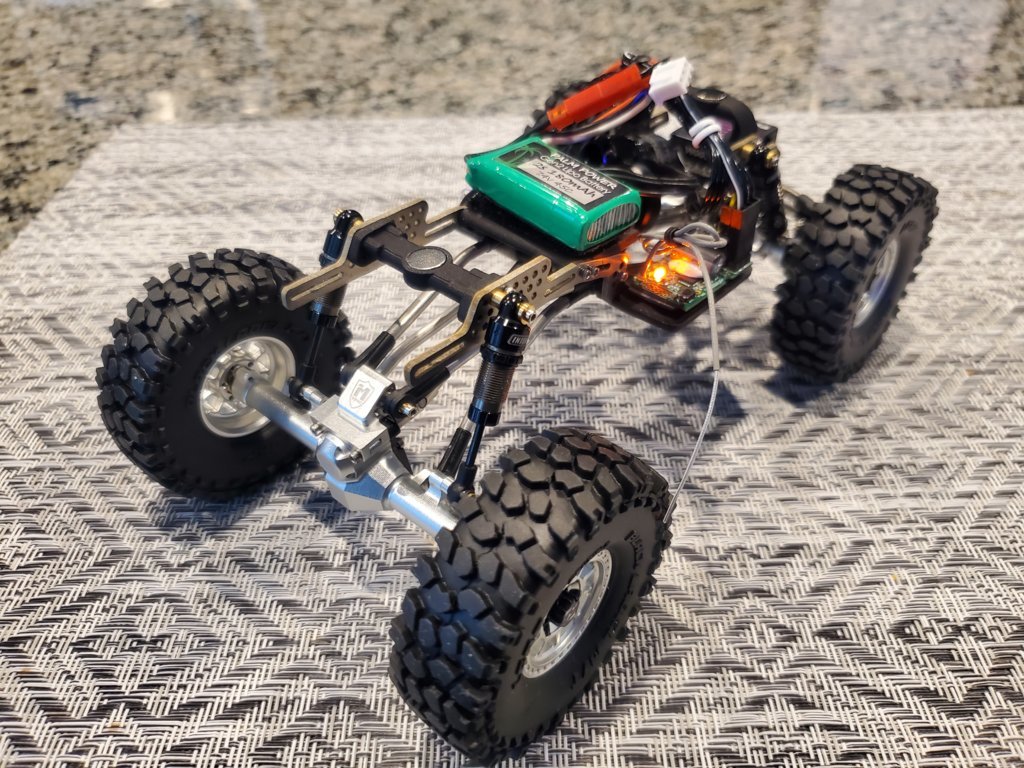

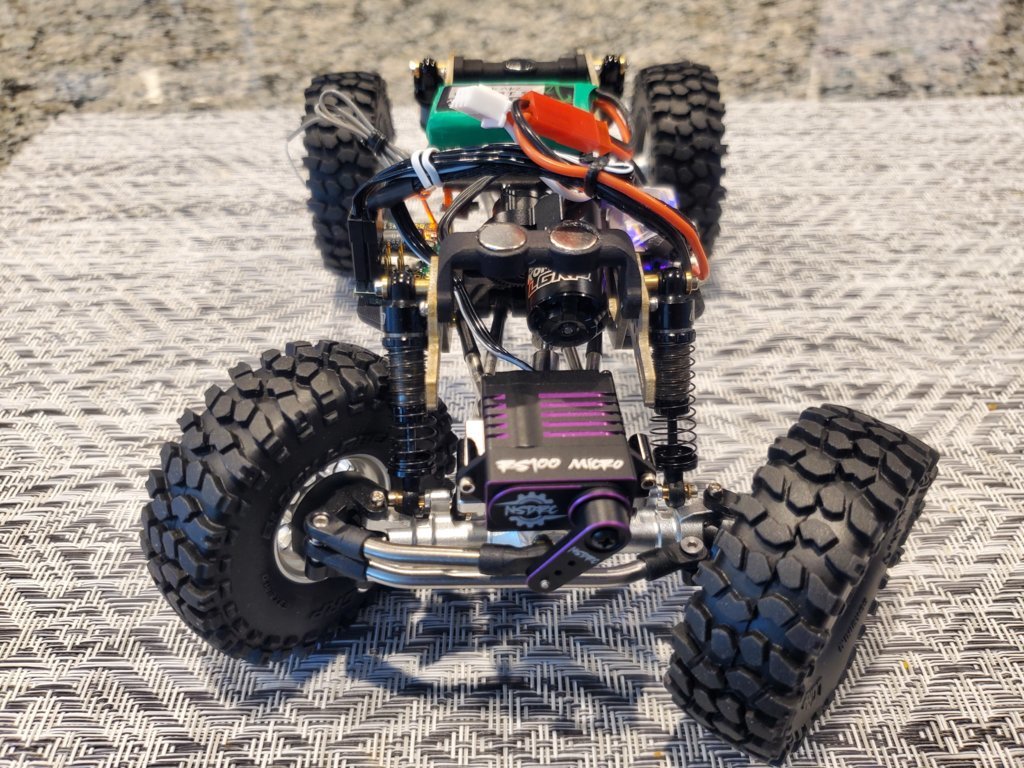

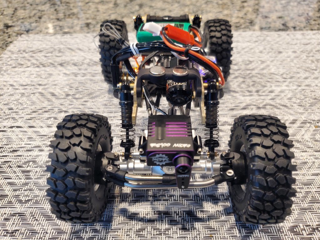

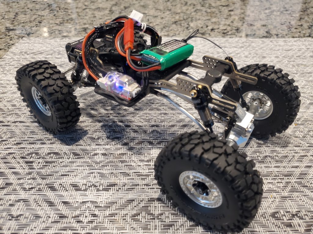

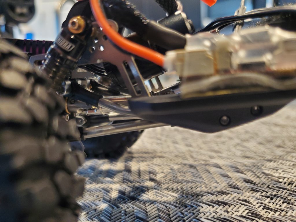

    I didn't like my rig being completely down, so I swapped to the Black Labels.
    I got a bit more steering back, since they're slightly narrower than the Trail Kings.
    Originally I was going to use these wheels with the HP axle but they match the Meus really well.
    Having changed shock positions too, I can really get it to tuck.

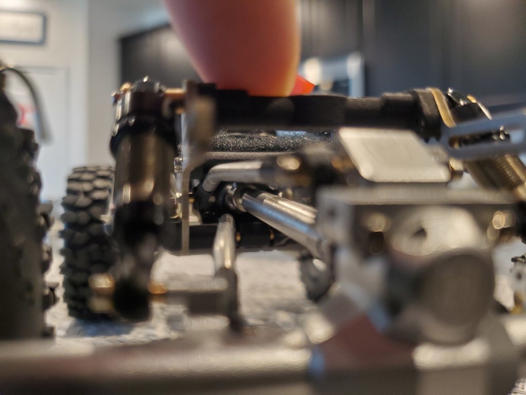

    Here's the upper rear links just a hair away from hitting the battery tray.
    But Tyler's bent links up front still provide tons of room for the motor.
    And the driveshaft, well that sits above the lower link so I've still got my clearance in the back.
    Thanks for letting me know @Deathbysnusnu that you too run these same shocks. Made me play with mounting points.
    Contemplating just buying another Cliffhanger body and doing a similar paint scheme for this one.

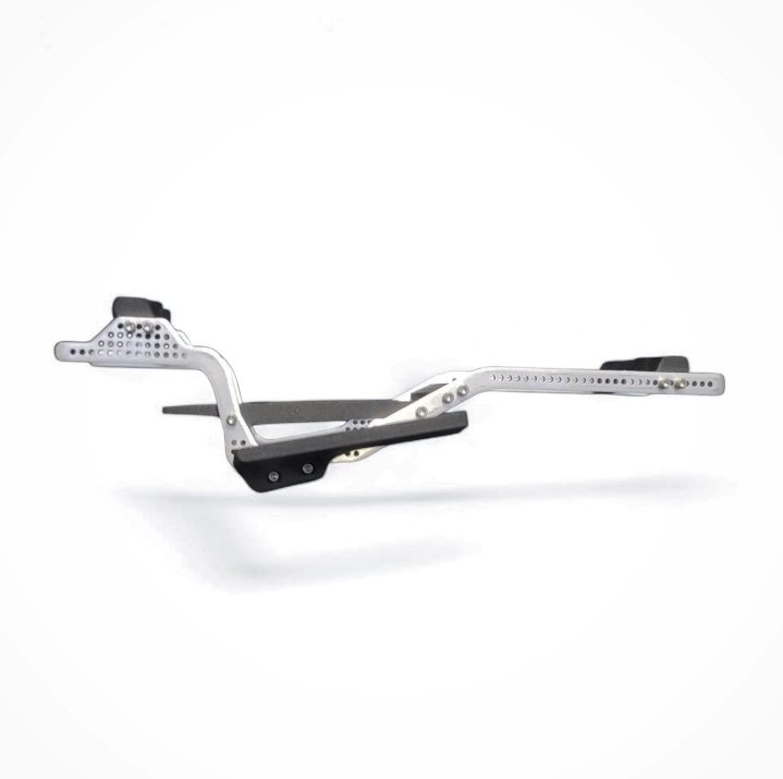

    This one's gonna be mint :cool:
    Screenshot_20250215_110407_Instagram.jpg Screenshot_20250215_110415_Instagram.jpg

    That chassis would have me going carrier bearing. That rear is begging you to run high clearance!

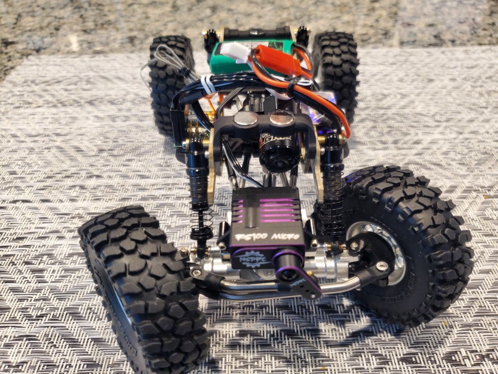

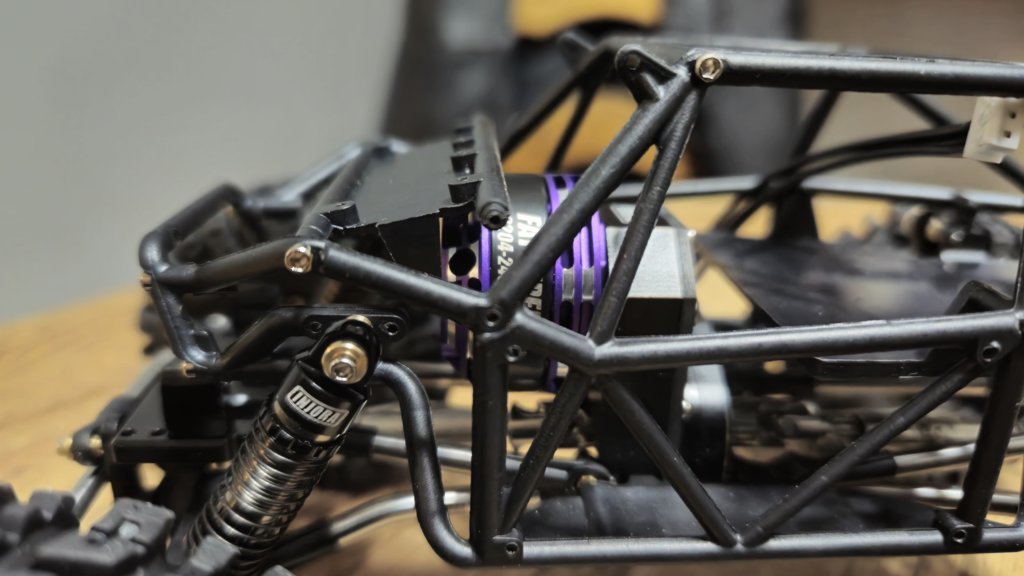

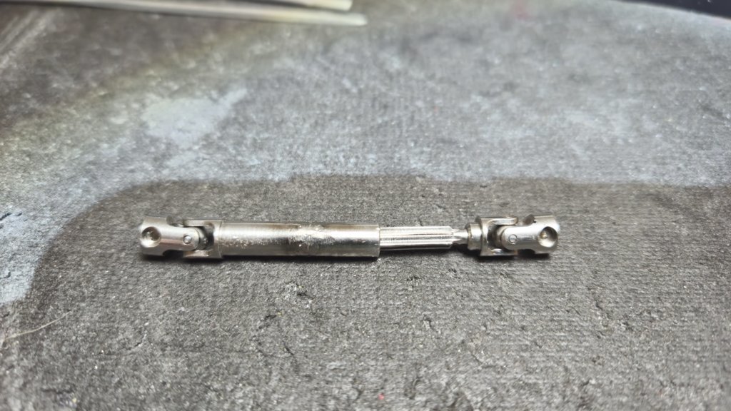

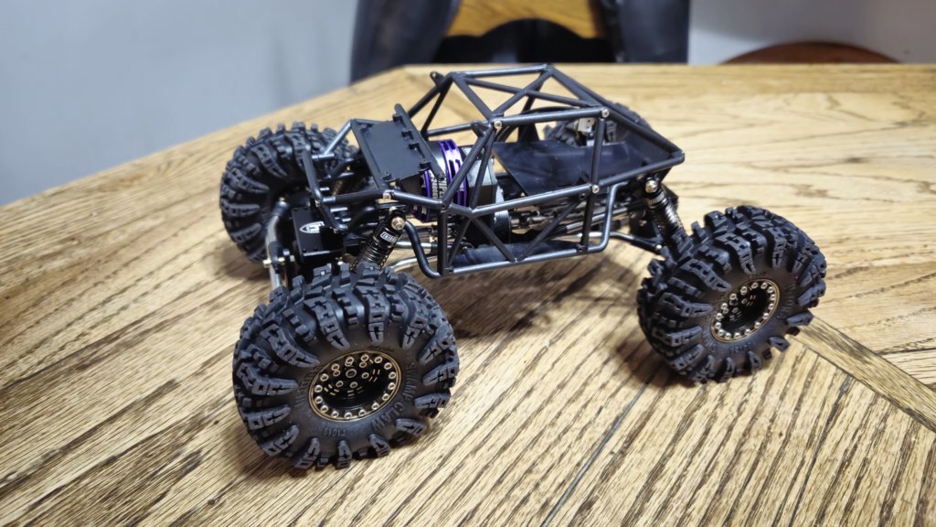

    Everything showed up a day early, even with a snow storm happening. :D
    Had to shorten the rear driveshaft by 1/2". Turns out the internal splines stop at that exact distance. :annoyed:
    No biggie, whacked another 1/2" off and welded the splined piece back on. It's in phase and almost straight. :p
    new tires, S5 Injora Swamp Claws. Back on the heavy brass with foam and aluminum rings. 54 grams each, not too bad.
    Motor sits high, there will be trimming of the front plate. Totally stoked to show off the spinning can.
