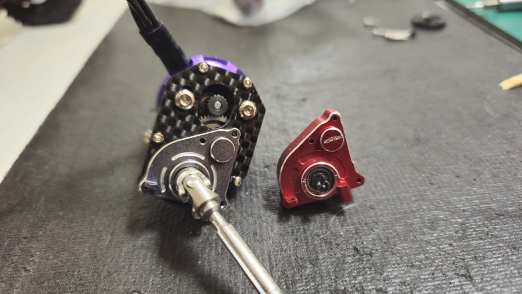

    Swapped the Furitec trans in the Cheat Code for another Injora. They are identical, but the Injora gears are a bit rougher machined, lapping them in for a few minutes in both directions with a drill took care of that. It's just as smooth now.
    Thinking of putting the Mini Komodo and trans in something else, really light weight.
    On a side note, when you order the Injora, it's offered in two different colors, it's just the motor mount. The trans is that light gray color for both.

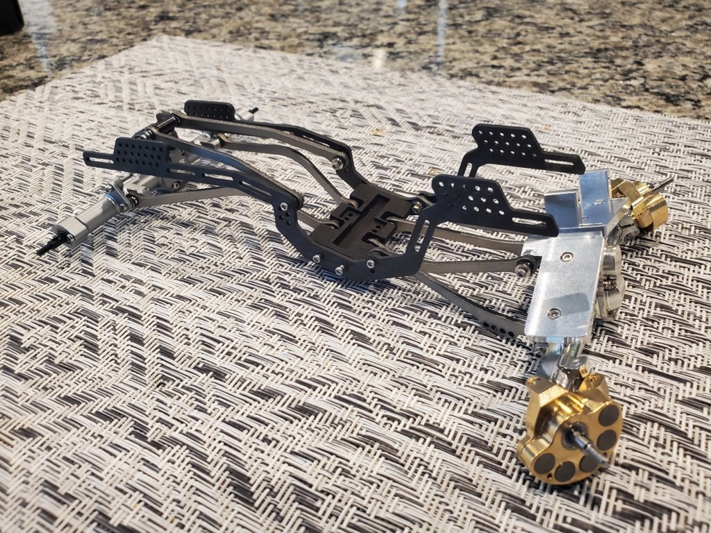

    Ok I can answer this question for anyone considering it.
    Due to the width/spacing of the link mounting points on the skid, the Dementors are nearly maxed out as far as how far outboard they can travel.
    Because of this, it severely limits vertical travel as it begins to bind.
    Which is a small issue considering the frame extends too far over the front axle anyway.

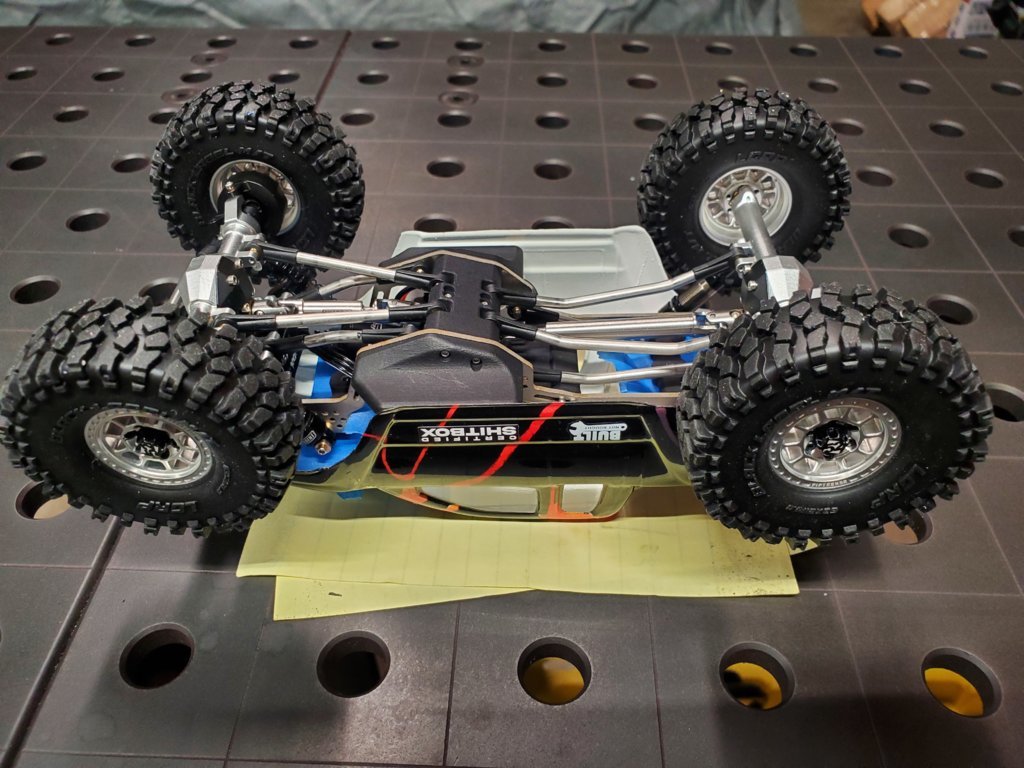

  17. Feb 19, 2025 at 12:47 AM
    Strictlytoyz
    Strictlytoyz Well-Known Member
    Jul 23, 2015
    #160147
    2,850
    Charles
    HA\/\/AII
    07 Shitbox

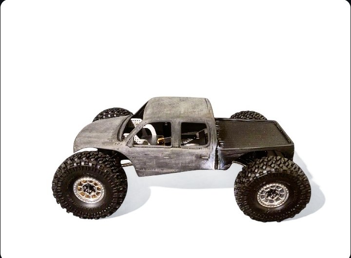

    Threw on some links, shocks, axle housings with just the shafts, wheels and tires for a mockup to see where the body will end up and if adjustments to wheel base are needed. Really digging the look so far. Slowly but surely. Once spider 9's are in stock I'll have everything for this build purchased.

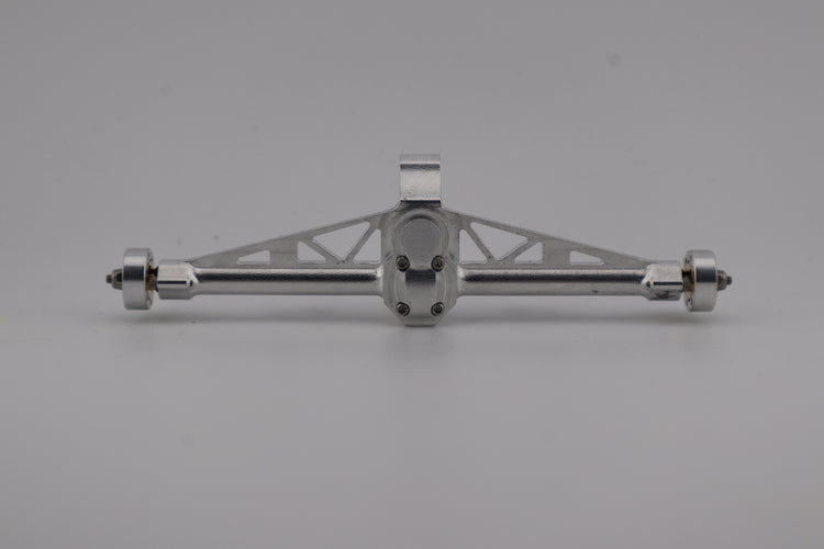

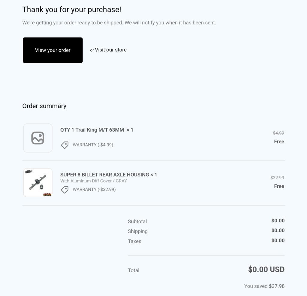

  20. Feb 19, 2025 at 8:34 AM
    Kwikvette
    Feb 27, 2019
    #284735
    82,938
    Fresno County
    4 run, 2 don't
    @Strictlytoyz

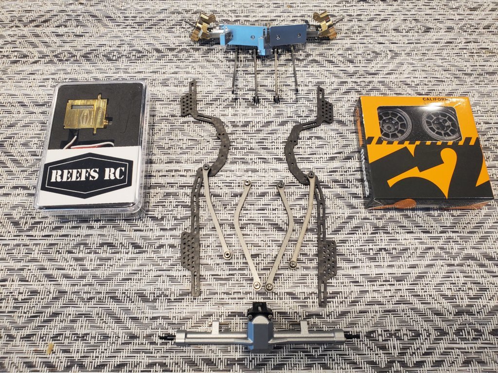

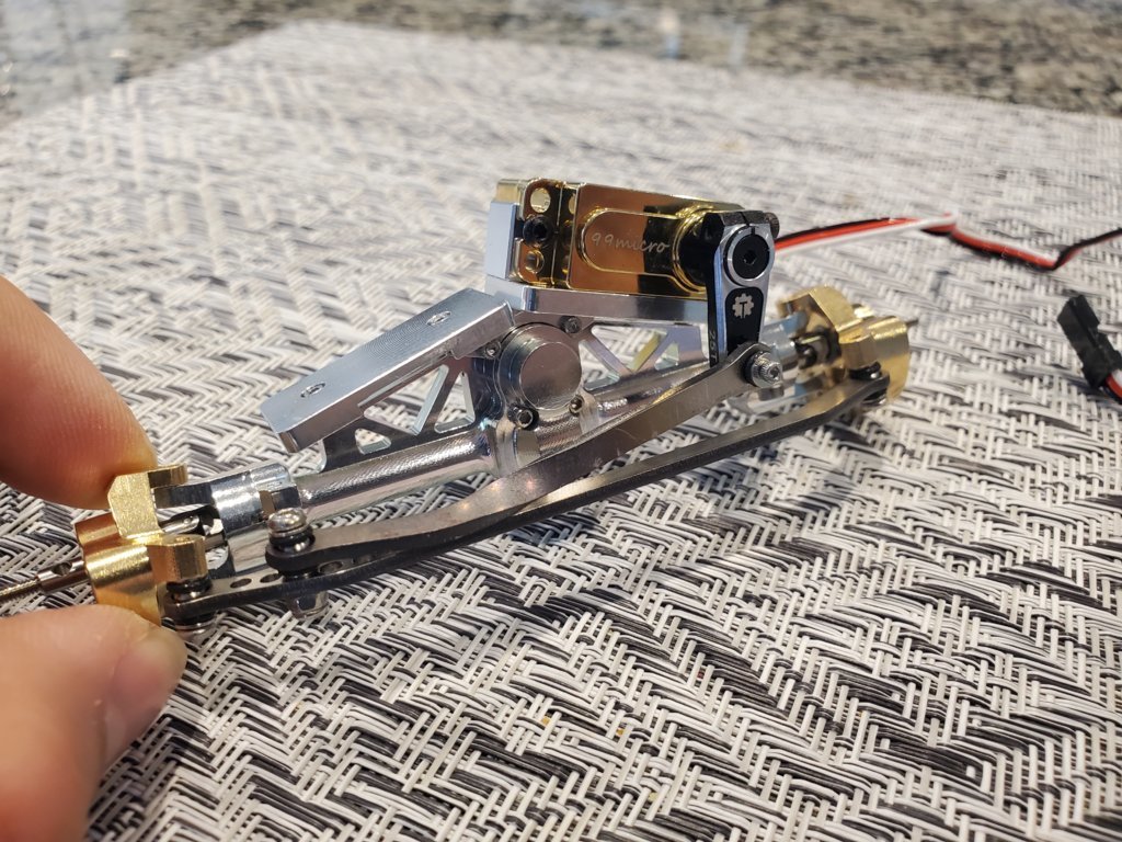

    Got an email notification from LGRP
    They're sending me a new Trail King tire (since I had that one tire tear in the middle) along with another rear housing
    Even though I initially declined the replacement housing (since it's perfectly ok), I guess they decided to send a new one anyway
    Also, ordered this
    What I actually wanted to purchase to try 4WS with was their Valkyrie kit, but they've been sold out for a bit
    So figured I'd give this chassis a try
