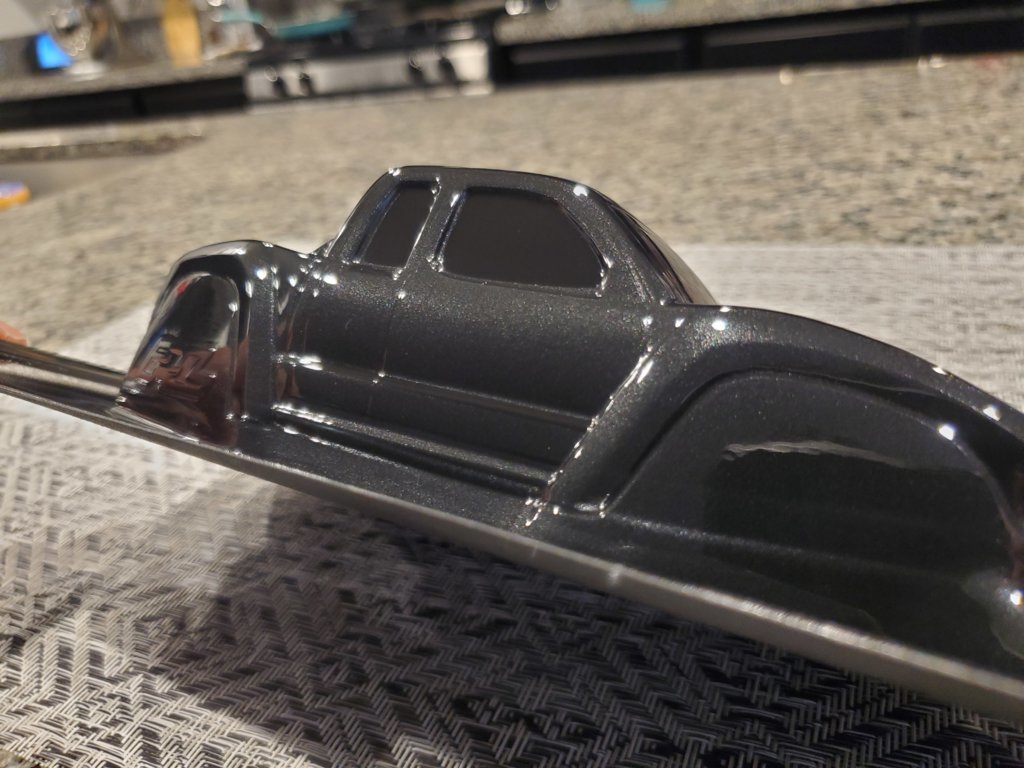

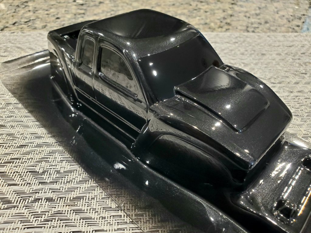

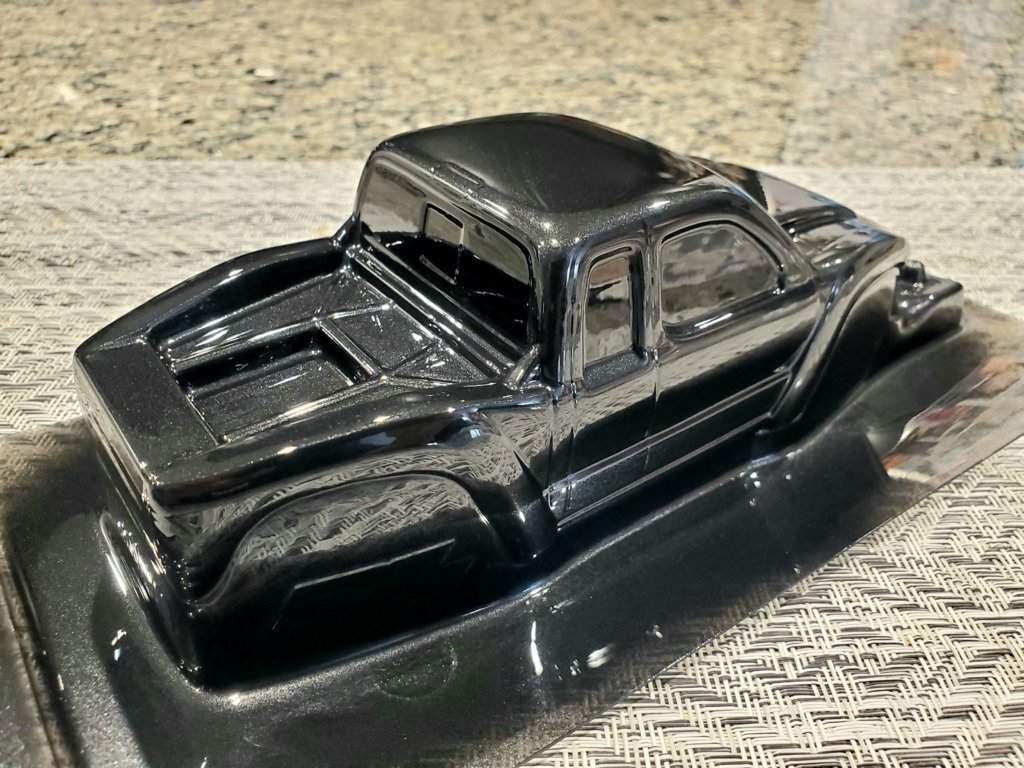

    Ooooh man, it came out better than I expected
    And really, no one will notice this but I wanted to see how it'd look
    I taped off the "mold" on the two doors and painted that a solid black as well
    Looks way better in person, I don't even wanna run it :rofl:

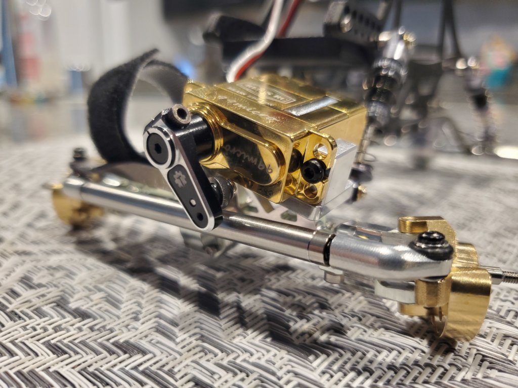

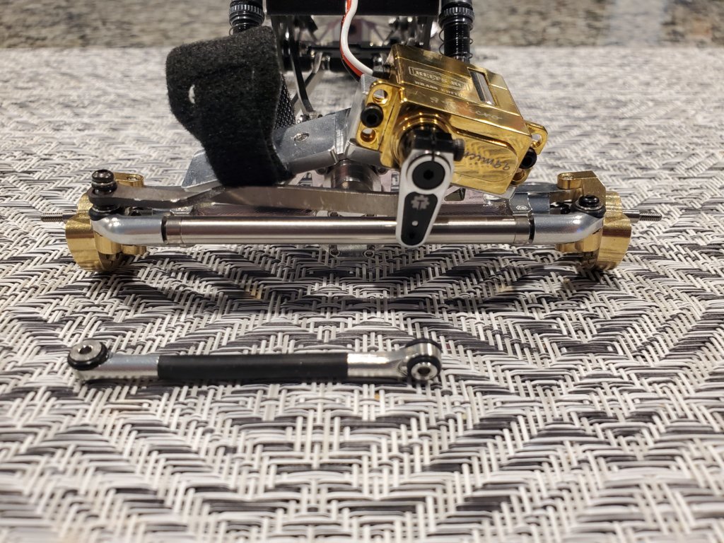

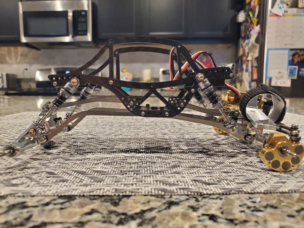

    3Flow9 tie rod and drag link setup looks good, but I think I need to get rid of my Reefs RC servo.
    Turning left, my steering is limited due to the hardware hitting the raised face on the servo.
    This occurs with either the Hard Park drag link, or 3Flow9 included link.
    Unless I just stack an o-ring in hopes that it offsets it enough where the servo horn sits...

    I noticed you have your servo horn in front of the drag links on your builds, which of course moves weight forward, this is good.
    But, most servo's at that angle are gonna be limited with the drag link behind it, hitting the top of the case.
    Maybe better to move the servo back and attach to the front of the horn?

    The shocks allow enough compression to allow maximum tuck.
    If I move the servo back, it'll hit the front tray on compression. I only know this because your suggestion did occur lol apparently the 3Flow9 is a bit smaller and would be perfect for this install.
    But I hate having parts go to waste :annoyed:

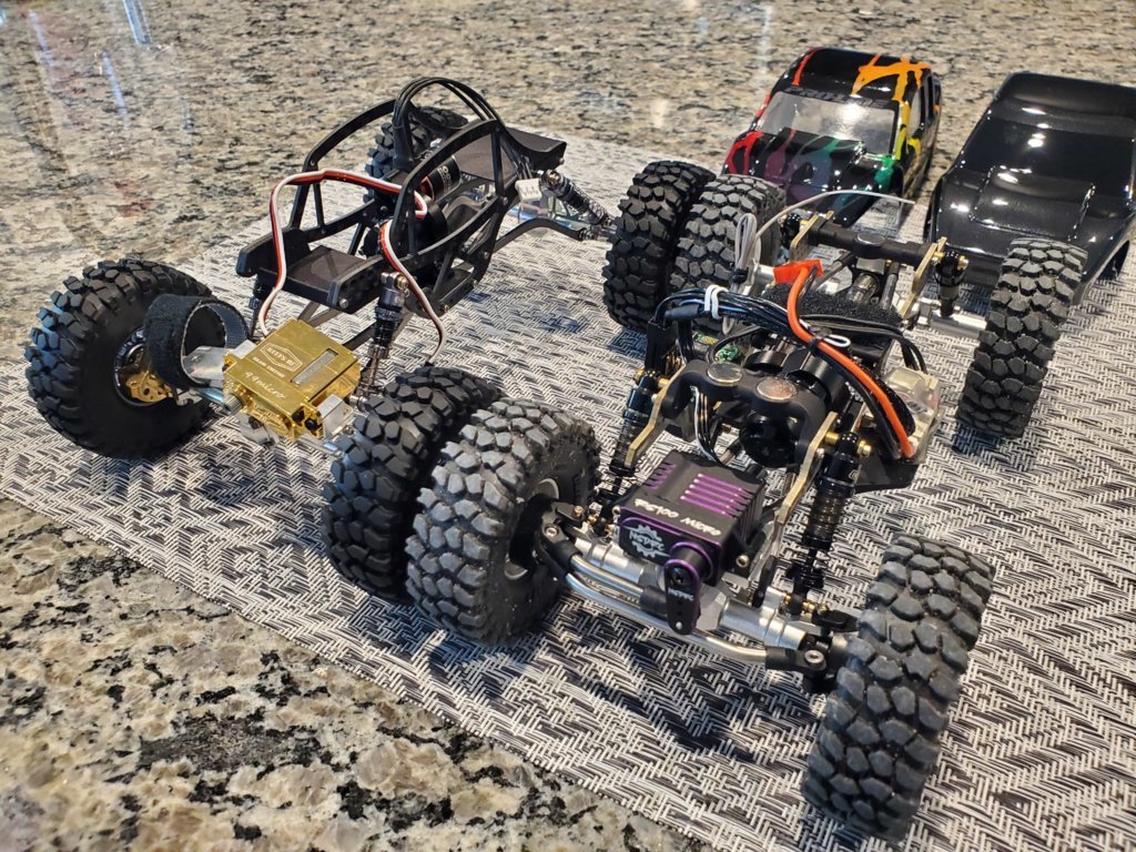

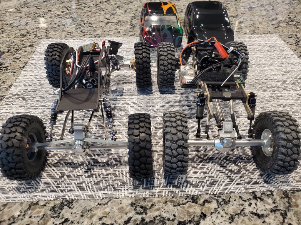

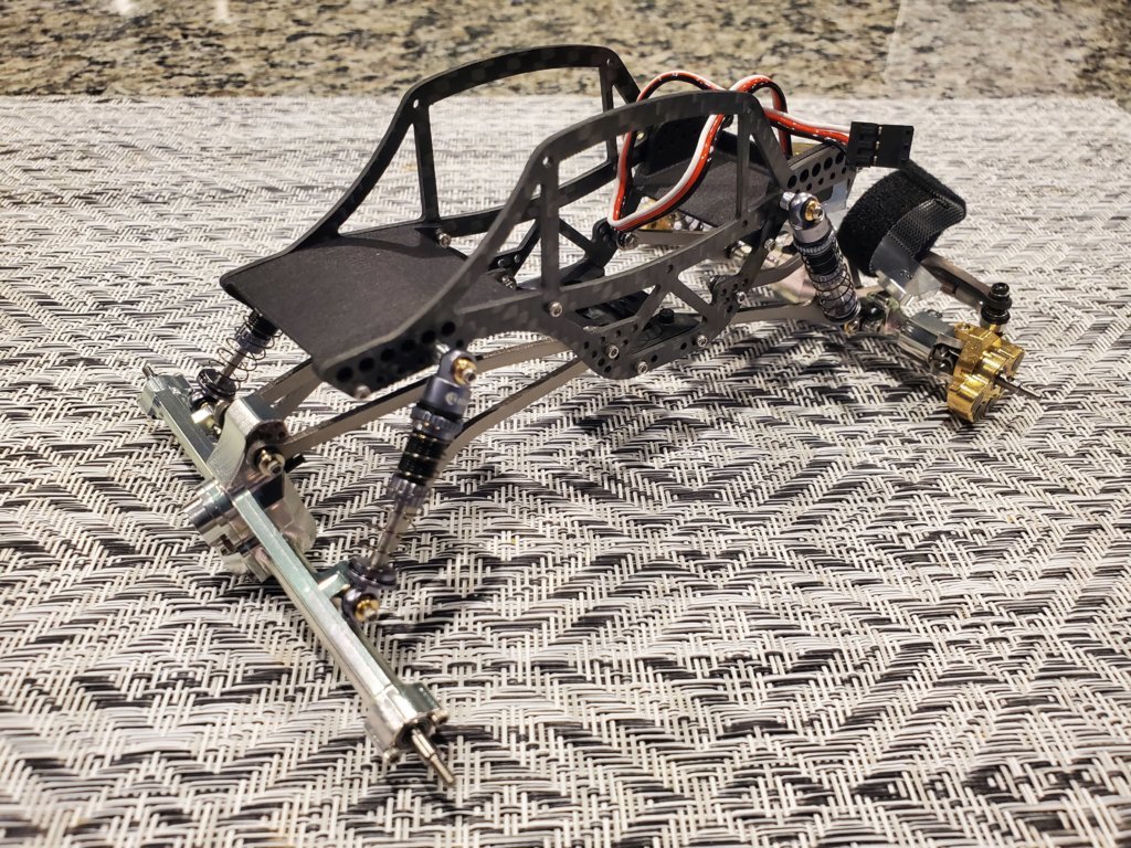

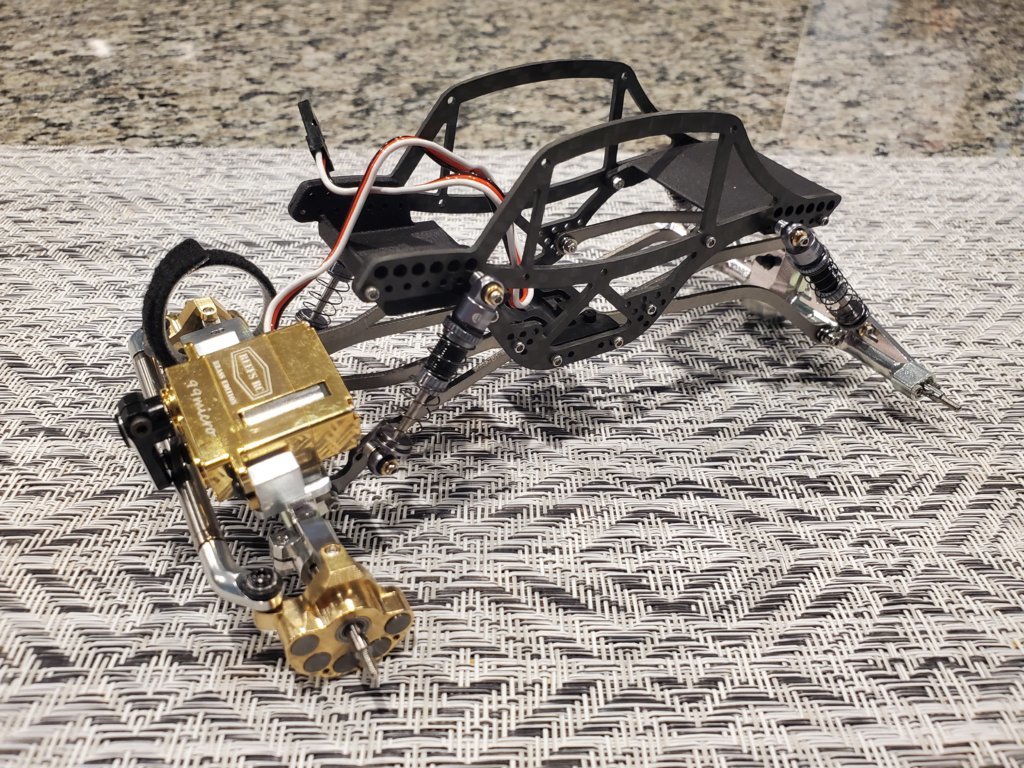

    Had taken these yesterday.
    Shocks extended
    Shocks compressed
    They actually give me more range of movement than the big bore shocks on the other rig!

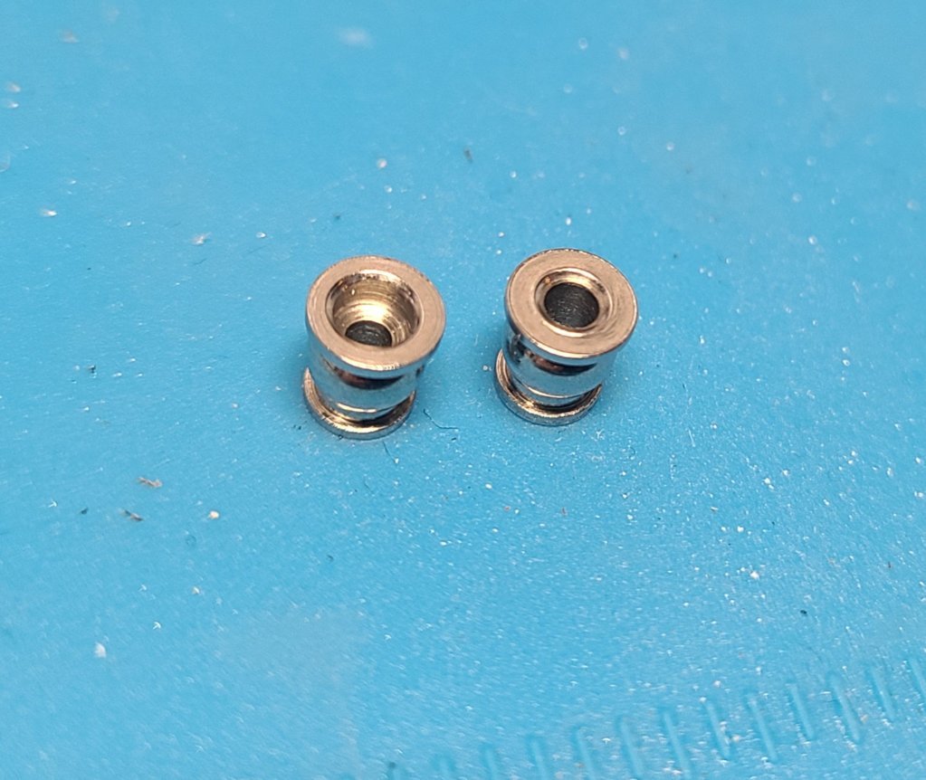

    So, I placed an order on the 3Flow9 torrent servo :rofl:

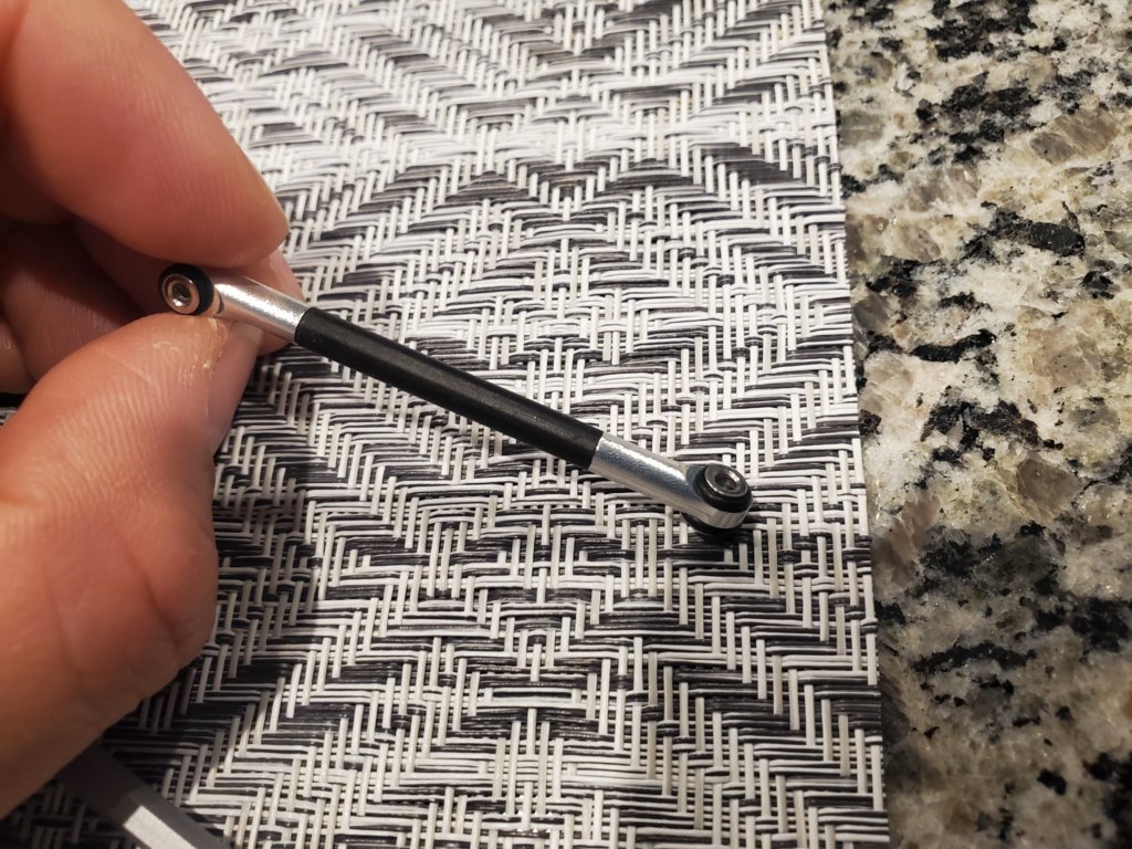

    Only to get an email reply from 3Flow9 confirming that yes, my order for their tie rod and drag link setup was indeed for a M1.4 pivot ball.
    So why do I bring this up?
    Well apparently, the M1.4 pivot ball is recessed to allow the bolt head to sit inside the pivot ball as shown.
    M1.4 on the left, M2 on the right -
    My drag link accidentally included M2 on both ends -
    Simple mistake is all!
    So I'll be getting an M1.4 pivot ball for my drag link and now I'll have an extra servo with horn :rofl:
    Might as well keep it for the Valkyrie build and go 4WS :anonymous:

    But the reason that prompted me to ask is because I specifically use an M1.4 threaded servo horn. I did this on purpose because I remember it being an issue when I had it installed on the Meus axles. The Meus drag link pivot cup only allows M1.4 whereas the Reefs RC comes with M2 hardware and horn.
    Anyway, I noticed the M1.4 bolt would sit loosely inside the pivot cup and I did inspect and notice both ends were M2. I didn't think much of it until I ran into the physical stop and decided to inquire in case the pivot ball sat inward maybe in relation to the mount it sits in?
    That's when I learned about the recessed design so yeah, I didn't realize it existed.

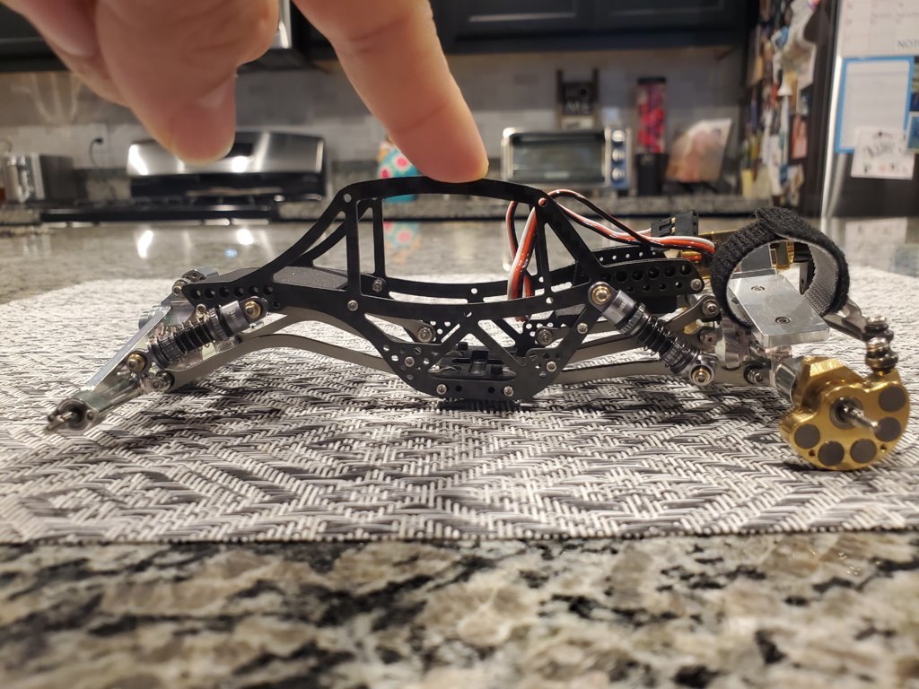

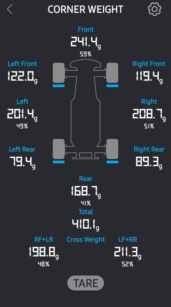

    Just received my steering servo today. Charging up a battery currently to get some initial testing. Will report back. This is my current weight without body on

    Ooooh shit, those are sexy numbers.
    Got a damn near 60/40 and great left/right numbers too.
    That's the Nacho chassis right?
