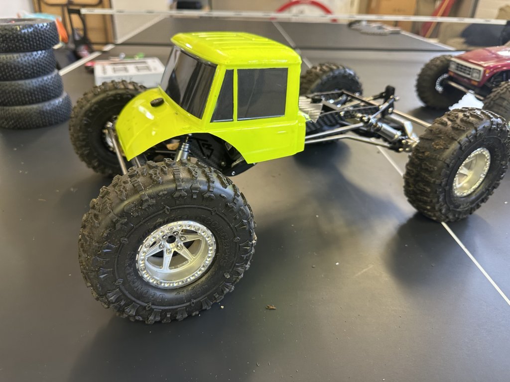

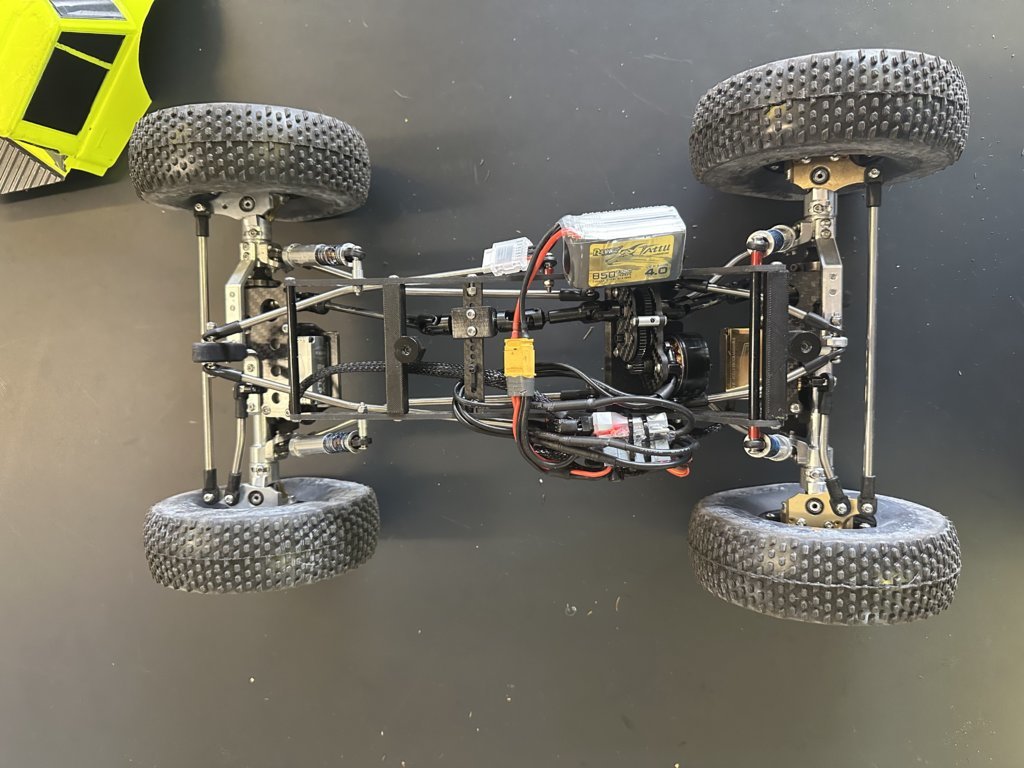

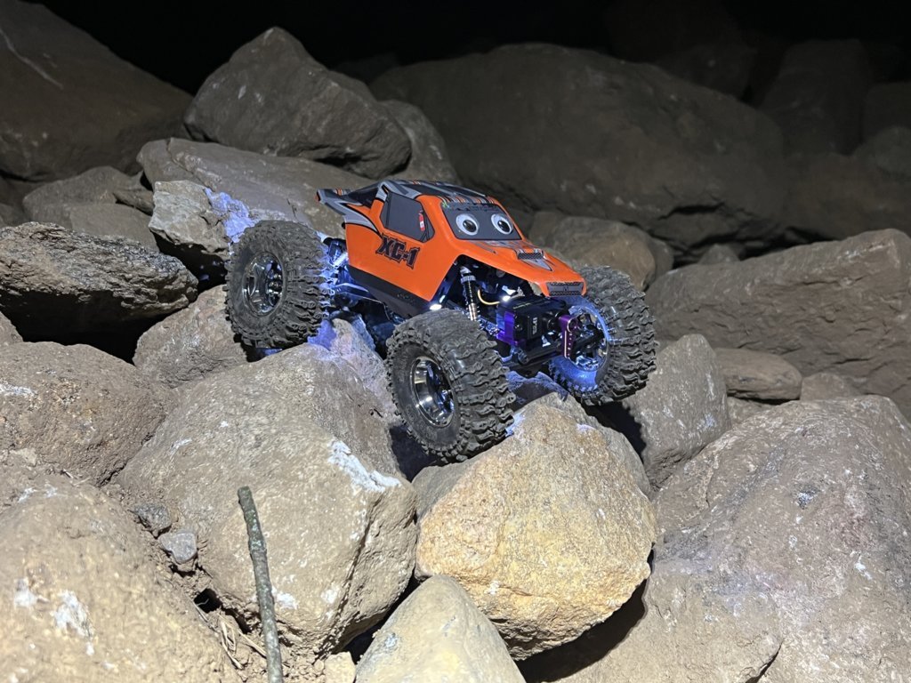

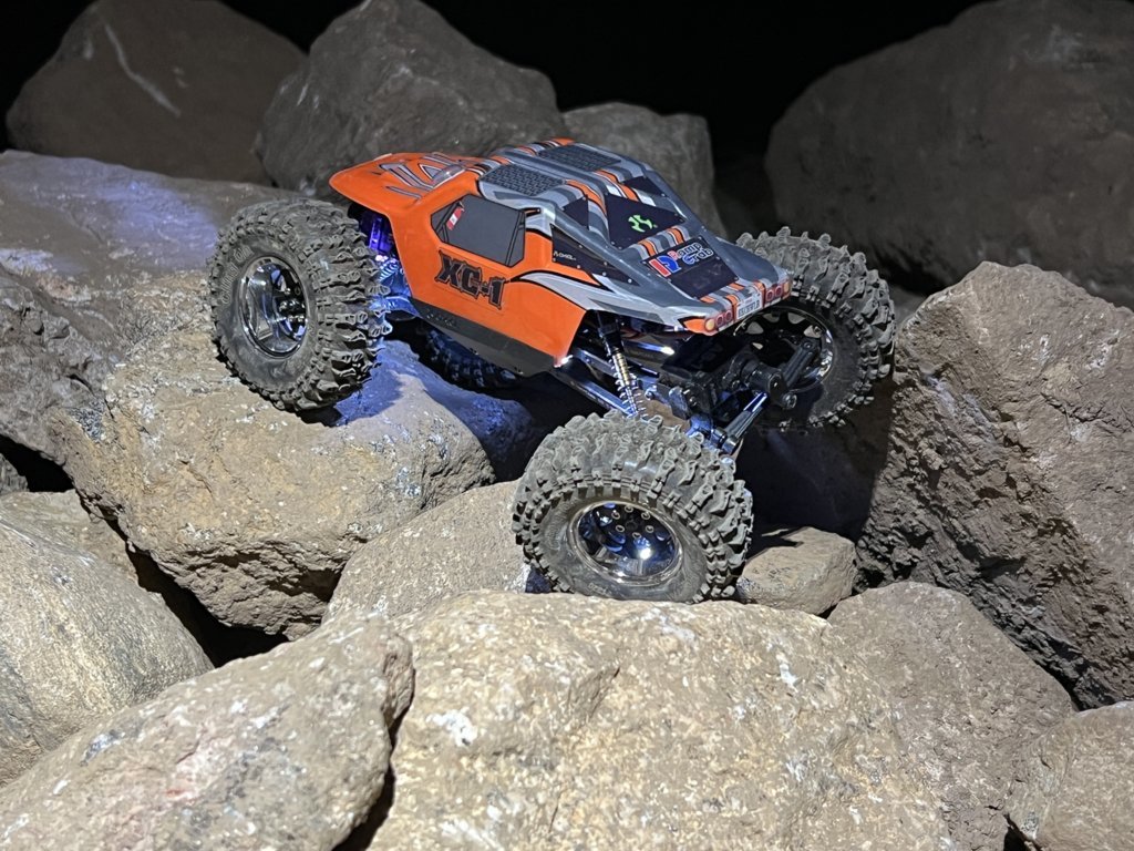

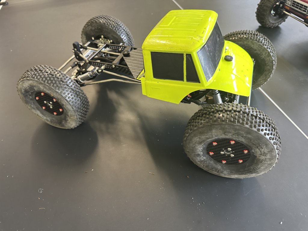

    Got home from vacation to some new links and chassis rails. Got my Poizd T3 built up played around with it a bit today at the northwest model hobby expo on their indoor course and I’m really happy with how it turned out.

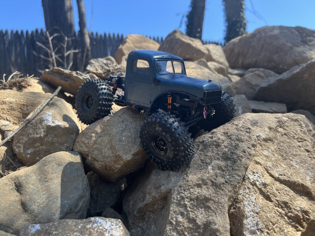

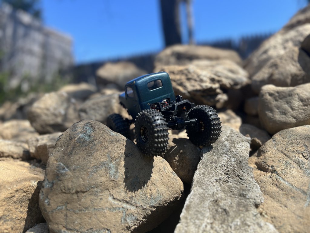

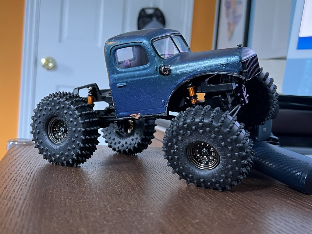

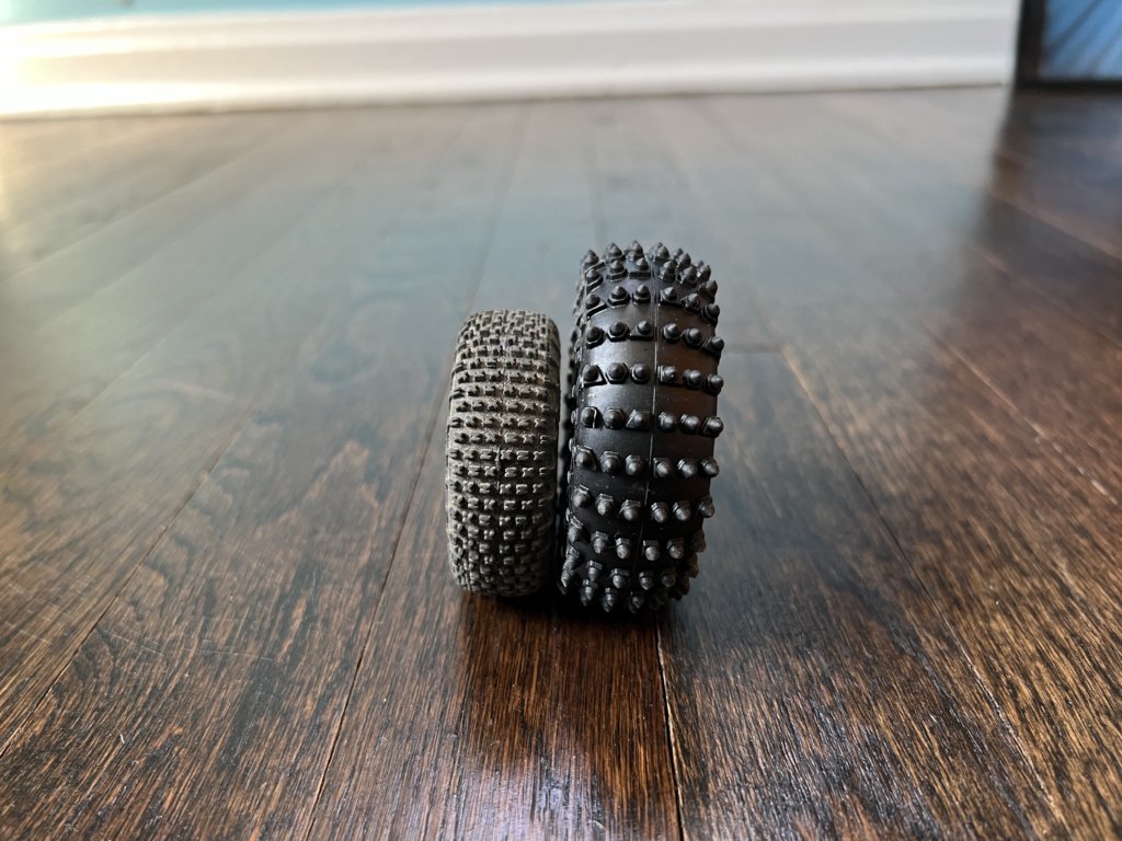

    60mm Injora HXH Pins vs 72mm DJCrawler tires
    Put them on my FCX24 Power Wagon which has portals but was still begging for more ground clearance (and since it has an enormous amount of body clearance it meant no trimming of the body to install them). Tires came with the dual foams and first impression is they actually work quite well. I admittedly didn't love the way they look at first but mounted and on the rig it looks absolutely hilarious and I love it. Monster/Mega Truck type vibe. Indoors it walked up and over things that were just unbelievable. Can't wait to get it outside and on the course once the rain stops.

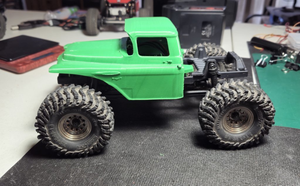

    I may have got a friend hooked on this. :devil: He ran my old FHS Power Wagon chassis all weekend while camping. He expressed interest in buying it, so I printed up an Apache cab for it.

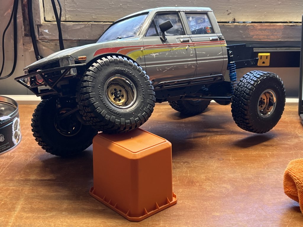

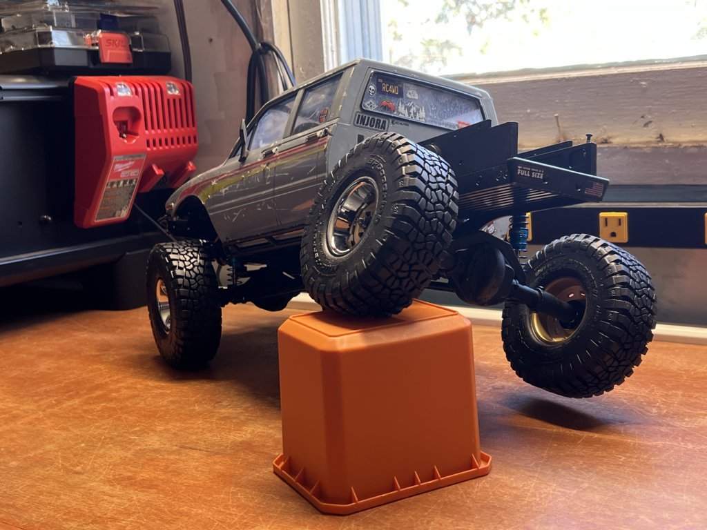

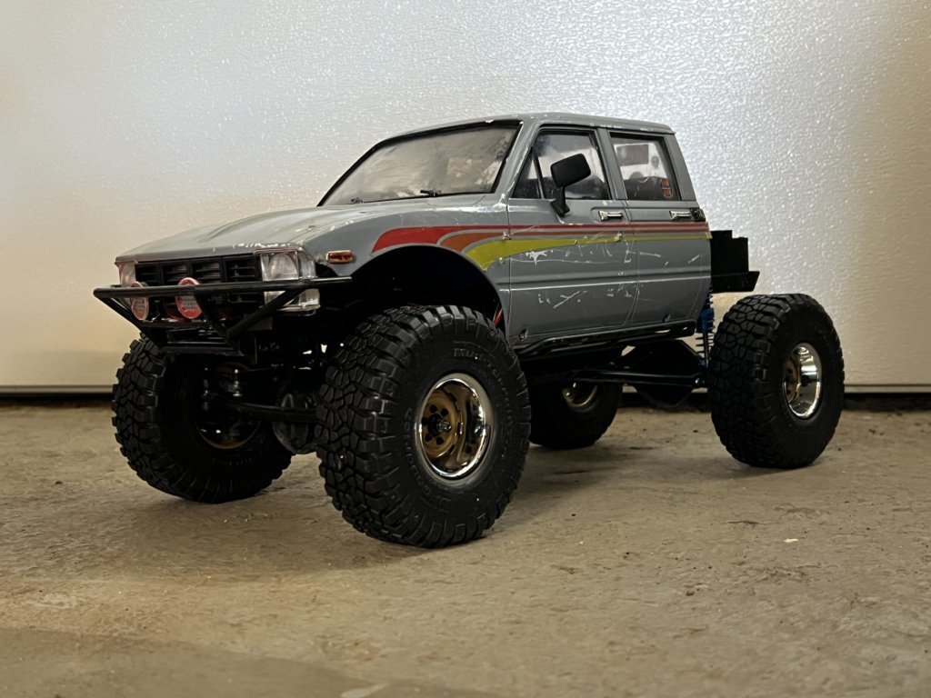

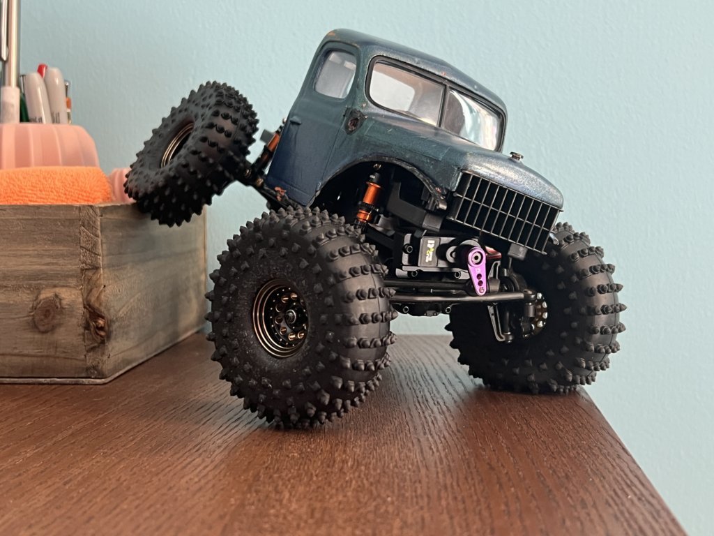

    FCX24 on the new monster tires is a hoot. Just climbs right over everything.
    Also got the C2X buttoned up. New shocks, wheels, tires, and lights from RC4WD, and I slapped the wide tube rock sliders back on for a more traditional/scale look. Now just to get it on the rocks...

    @Roody nice rig! Hard body's on scale rigs are so cool. Bringing back some fond memories of years gone by. Thanks to all you guys for this thread.:thumbsup:

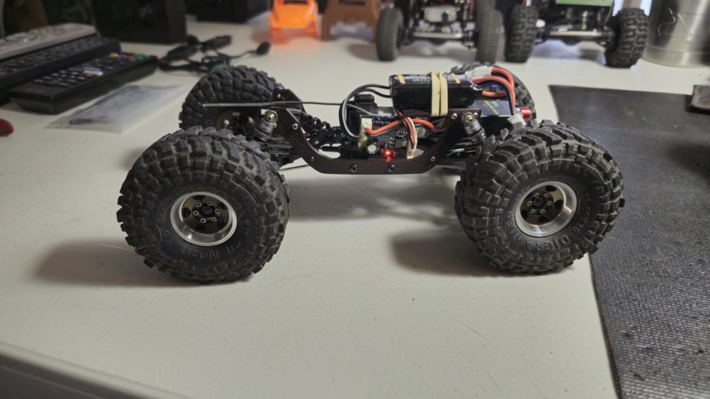

    After running the homemade crawler last weekend, realized it might be a lineslayer if a few tweaks were done. :D
    Re-printed the frame. Shortened it 10mm, 5 off each end and removed the rear tray.
    Material if CF infused in Marsala and total weight of the printed parts is 9.7g.
    Gave it some more shape and looks less block-like now.
    Shortened the WB 13mm, 8 in front and 5 in the rear. Pulling in the front end brought it closer to the motor which helped with the balance in the front.
    De-cased the RX/ESC and it fit perfect on the side of the motor, still between the rails.
    Back on the 68mm tires which were originally bought for the project. Siped all the lugs on them, improvement so far, may do some trimming.
    Not sure about a body. Might reprint the top tray into an actual enclosed battery holder, and incorporate some kind of "look" into it instead of a body and keep it slim. The plastic gears are still alive, but do click when bound, so best to keep it light.

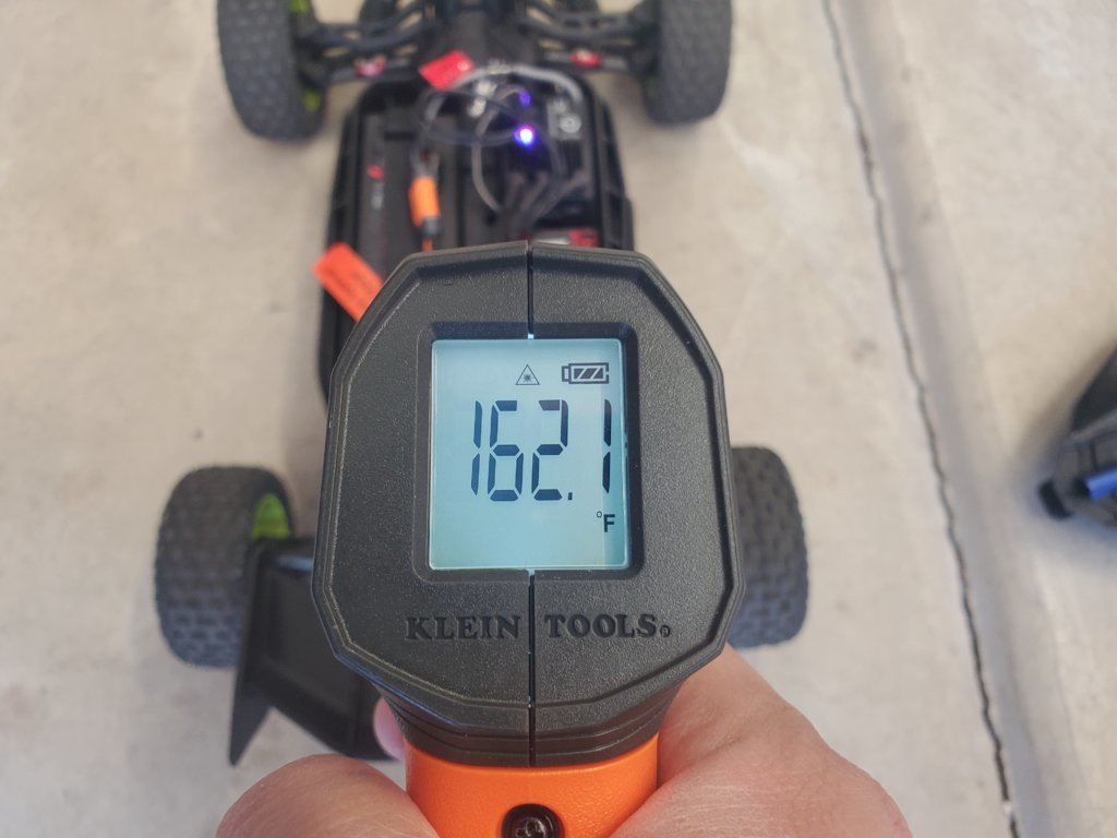

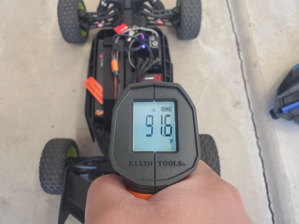

    Hot day today, and running the Grom non-stop got the motor pretty warm
    But within minutes, that new fan really helped to cool it down

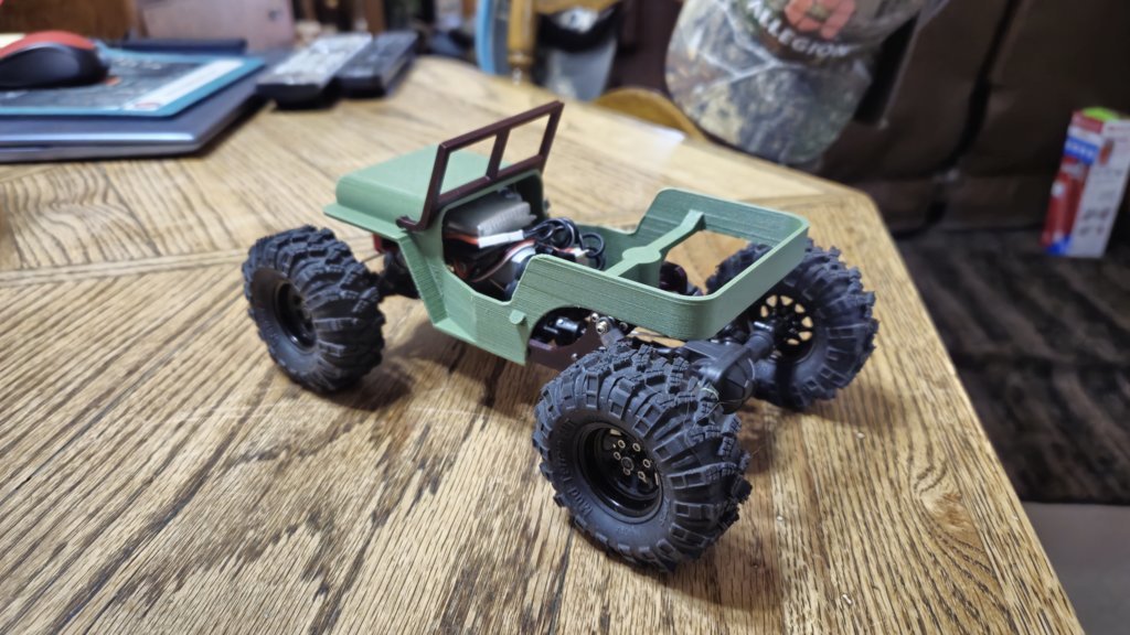

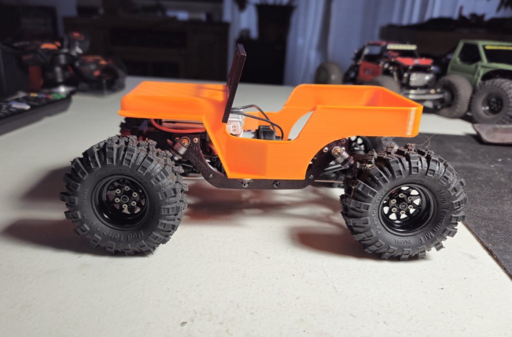

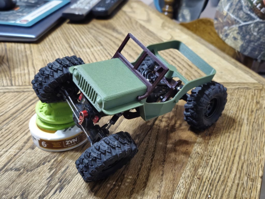

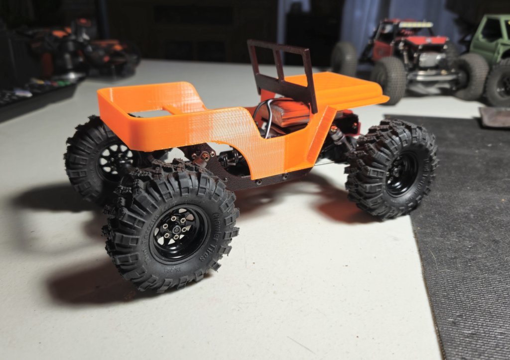

    There are no decent files for flat fender jeeps, so I scratched built a shell. 5 iterations to get this. One more to go to fine tune it.
    I want to raise the rear fender 2mm and lower the front fenders 2mm, and that should get the look. The fender lines should be about the same level.

    I think it's done. Got the fuel tank filler, grill, folding wind shield. Might do a rollbar .
    9 slots for the flatties.
    tires just barely touch at full flex, dropped it as low as possible.

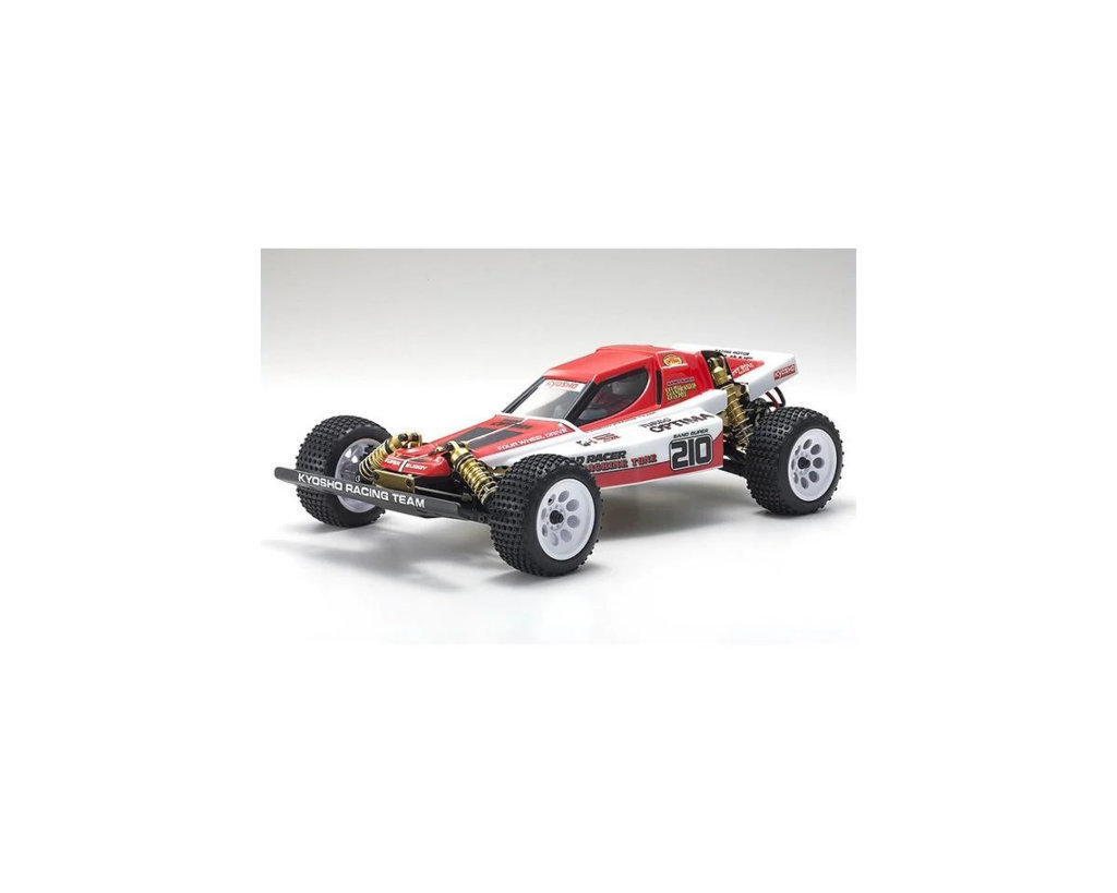

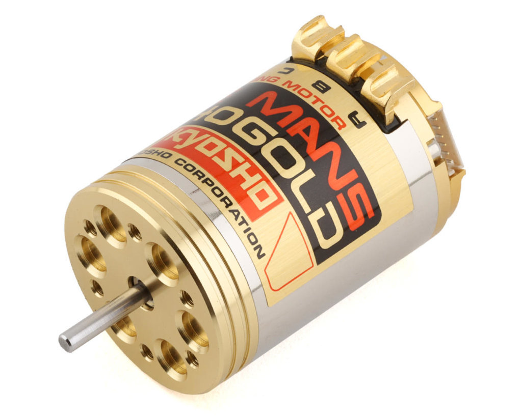

    Stole this and the proper motor off of marketplace recently as well.
