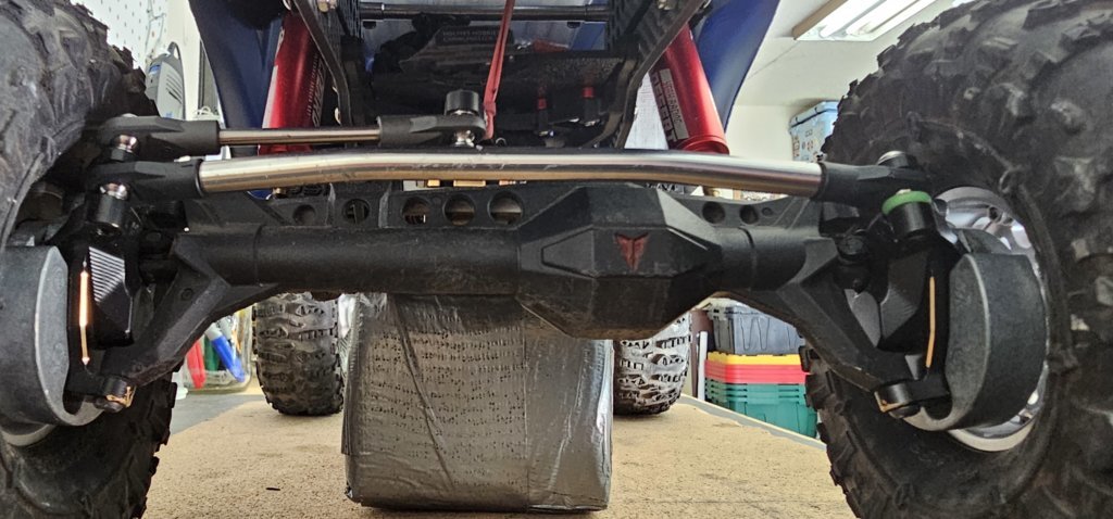

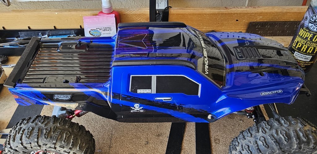

    I changed my wiring, again. Then went and beat on the new body just to be sure it doesn't rub.

    What axles are those?

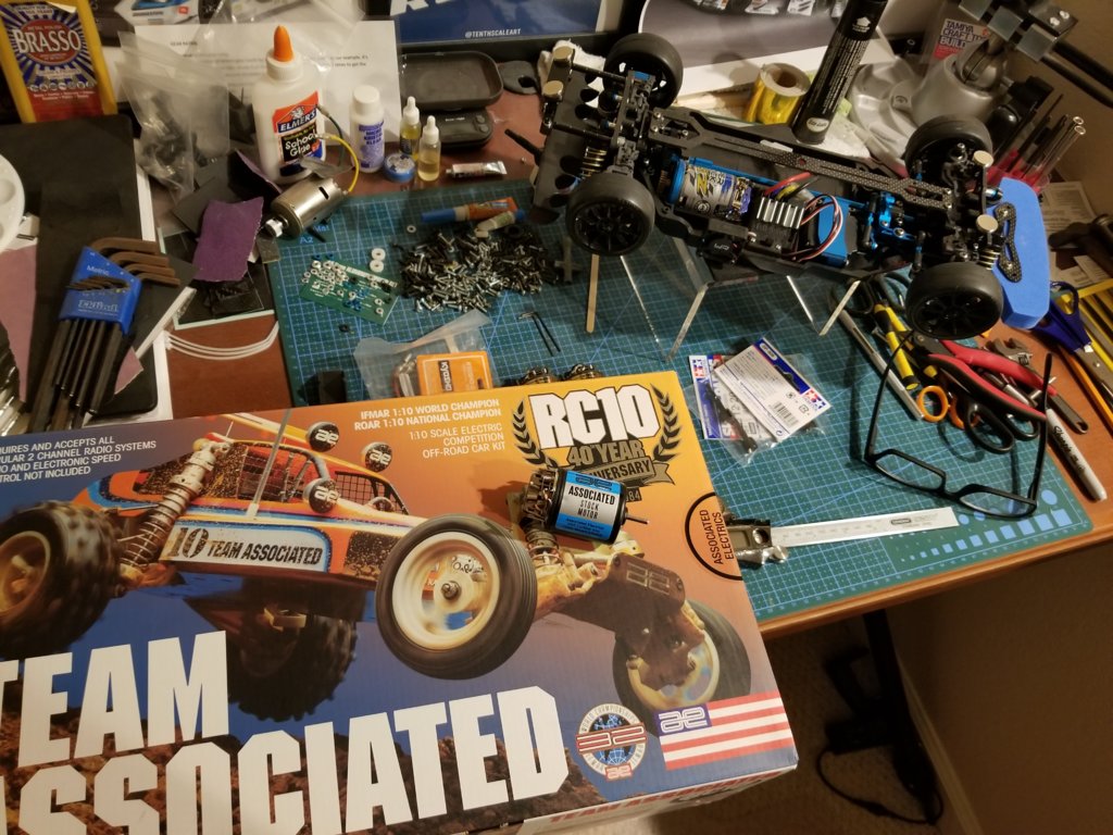

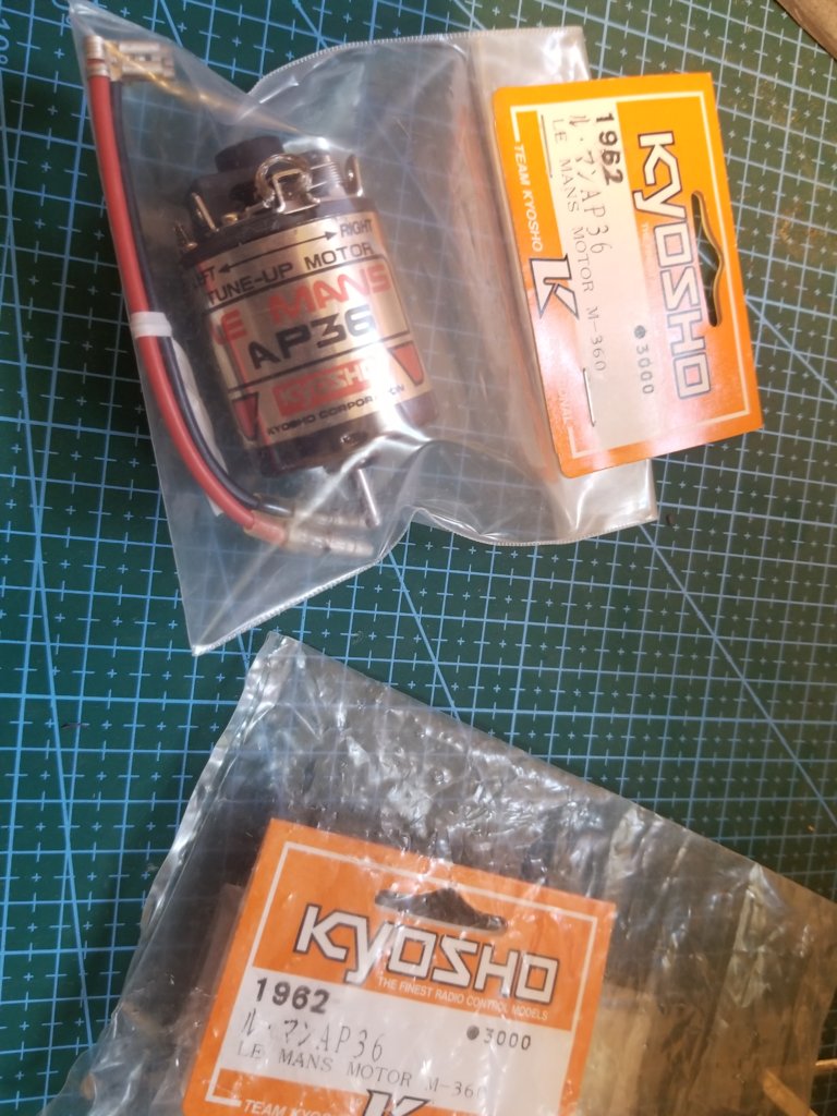

    Hey thank you! The boxes can be tough. I've had to watch a bunch of you tube videos on techniques other nerds use. Paint color/sheen matching is nearly impossible. It's good for the OCD and ADHD.
    There are some absolutely crazy restorations on youtube. Guys doing action figure packaging from the 1960's and stuff. Lots of Star wars of course...
    the reallyold ones are amazing too. Old metal cars and things like that.

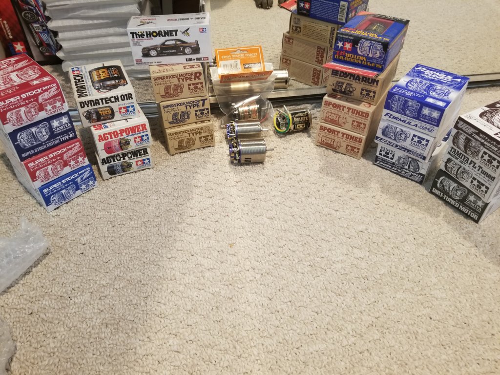

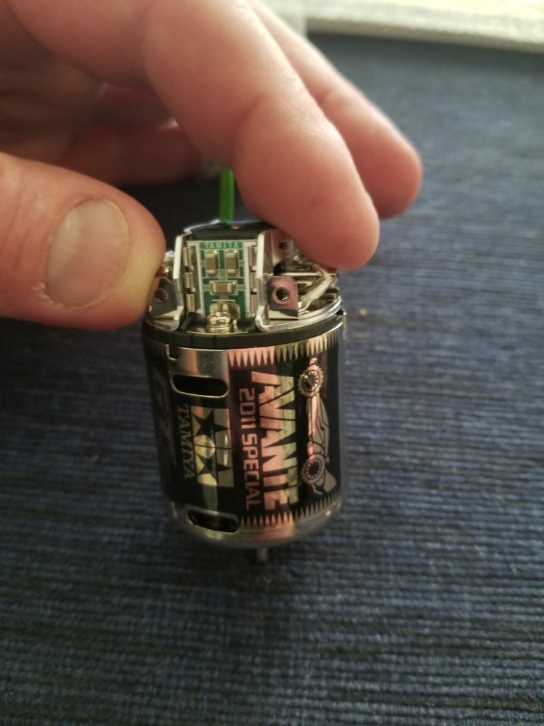

    There are a couple of Chameleons floating around ebay right now. If I could find a way to make reproduction motor labels, I could go down a very black hole of motor restomodding. The labels were always so rad! And I feel you on the tools and stuff. Some of the old heat sinked ESC's were just awesome looking. Novak and KO Propo especially. Oh, and Tamiya CPR units are just amazing.
    This arrived last night for an Egress build I am doing. Its a good kind of hoarding.

    Woah thats a beautiful setup! Adjustable timing and compact cap board.
    Thinking back to my mid 00's TLT crawler "pede" transmission build days. My "trail motor" in it was a Chameleon 19t spec can, with an epic 27turn armature. Thost Chameleon cans just seemed to have the perfect amount of timing built in and strong magnets for tons of efficient running. Id run soft brushes in all my stuff to get long life outta the arms. I think I have that trail motor combo somewhere... you are gonna make me go dig and go down memory lane.

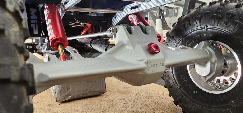

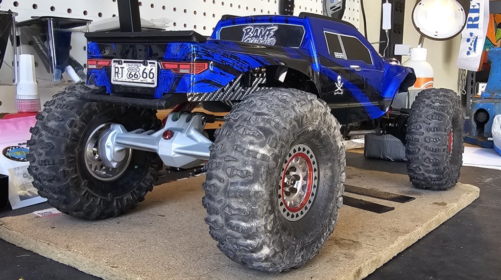

    Those are the Vanquish F10p axles. The front one comes with the VRD Carbon and I think the new Stance has the same hardened gears now, I think.
    The rear is just the clear aluminum axle housing with the VRD Carbon kit internal parts. I'm saving my pennies for a clear F10p aluminum front housing.
    Here's some sexy for ya.

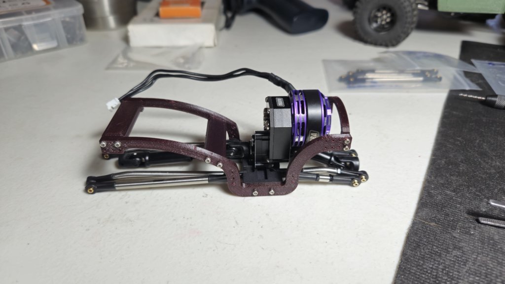

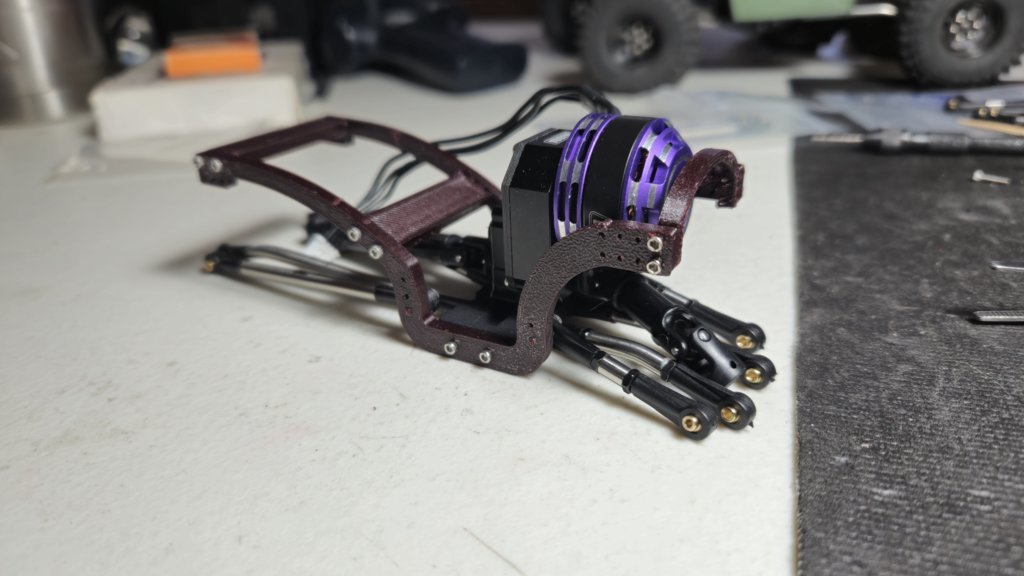

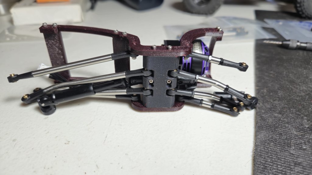

    Getting some use from the leftover Mazz Designs 15 degree skid. It's printed flat, so now it's a 0 degree skid. :p
    Extended Deadbolt front with Gladiator rears.
    Gonna "borrow" parts (axles, electronics) from the UTB that doesn't see much use.
    It's a work in progress. First iteration of the frame, pretty sure it will change a dozen times.

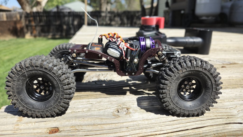

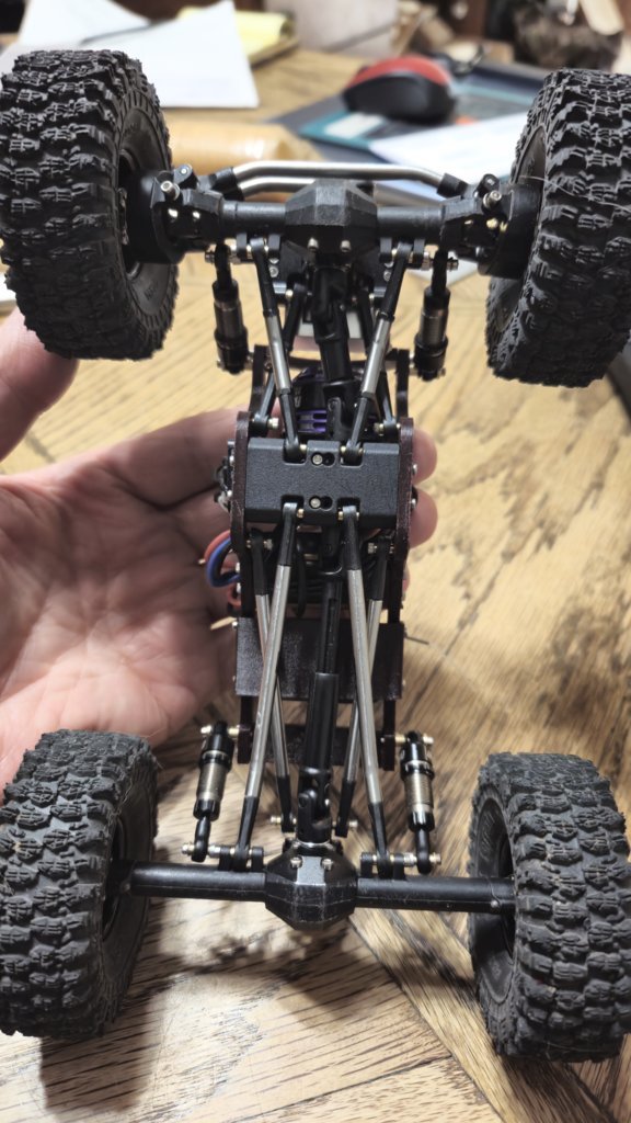

    The short front and long rear seems to work out well. All the weight is forward, practically on top of the axle. This one is just a bit more top heavy than the Cheat Code, mainly because the motor sits upright instead of tilted forward, side by side there is about a 10mm height difference right there, but the rest is about the same.
    Rear driveshaft is right at the end, but "hanging" in there :D. Ordered a new set and that's all this has needed.
    Set the RX between the frame rails and attached the ESC to the side of the transmission.
    I thought for sure i'd be tweaking the hell out of this, but it works pretty damn good.

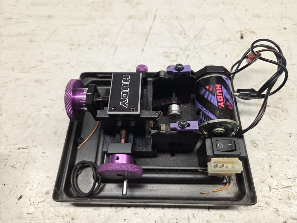

    Looked in my box o rc stuff and realized about a year ago I cleaned house and tossed the stuff that couldnt make a whole motor.... which included the chamelon cans (the end bells i had were toast) :(:(

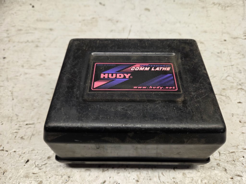

    I also got things mixed up though with lathe things. So back in the early 2000's my HUDY comm lathe got me and many others turned onto "lathe motors" for our 1/10th scale crawlers, due to the high turn count 540 sized brushed motors that spun slow and made tons of torque. Integy lathe motors were the king in this realm (and i still have one 55T integy lathe motor used for countless hours in a crawler) and why I mixed up Integy and the actual OG Hudy comm lath I have.
    Pulled the Hudy lathe out and reminisced of the golden days of my life. From what I can put together this is a "Hudy Tech Comm Lathe - Modified - HSG" with V block guides (just put a drop of oil to lube for the lathe process). I also remember modifying a spare computer power supply with a manual on off switch for 5v power to run this lathe (hence the 4pin molex connector) on the power switch. This lil lathe has ZERO slop and stupid precise, like stated previously a QUALITY unit something that I wont ever get rid of even if it never gets used. Its been used to machine countless armatures in its heyday.
