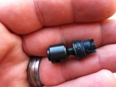

    Too much lock tight and got threw to the joint. It is sticking. Easy way to loosen up the lock tight?!!!

    Are those metal parts, (I'm assuming)? Try some heat, from a pencil torch.

    Yup metal. Cv joint on my dingo kit.

    Will a lighter work?

    acetone will make loc-tite brittle. after that you should be able to move the joint around to knock off the excess.

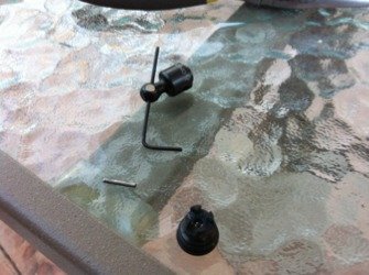

    Thanks buddy. It is working like a champ

    One pin out. Now number two

    Got it. Now easiest way to clean off the residue loktite

    Haahaahaahaa. Wasn't paying attn. a whole bunch came out

    Burry picture. Not sure if you can see the blue

    Did it!!!! Woohoo
