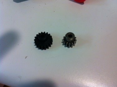

    I think all you have to do is change out the pinion gear with the other one that came with it, throw in a 3S, and you're good to go. Just stick to speed runs.

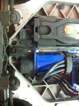

    Is it in the black next to motor?

    Yes. Do you know how to set the mesh properly after you change it out?

    Well the easiest way is to cut some notebook paper into a strip about 4 inches long, so you can hold it, and about a 1/4" wide. Stick it between the spur and pinion gear and push the mesh together firmly. Not super tight like trying to squish it but snug. Then tighten the motor bolts back up. Should be a little play in the gears. Not a lot, but enough to allow for expansion and so they don't strip.

    After a few times you can do it by feel but it's a good way to do it. Make sure the motor bolts are tight. Would take a pic for you but at my gfriends right now.

    Big thing is just make sure it's lined up straight, and after you tighten it rock the spur (big) gear back and forth. It should move just a little bit.

    Dam they don't give u much to work with

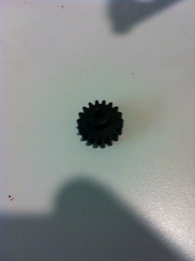

    Thanks!!
    I think I just managed stupid fast even on a 2s. I had it in the air at full throttle. Jesus Christ.
    I need a 3s
