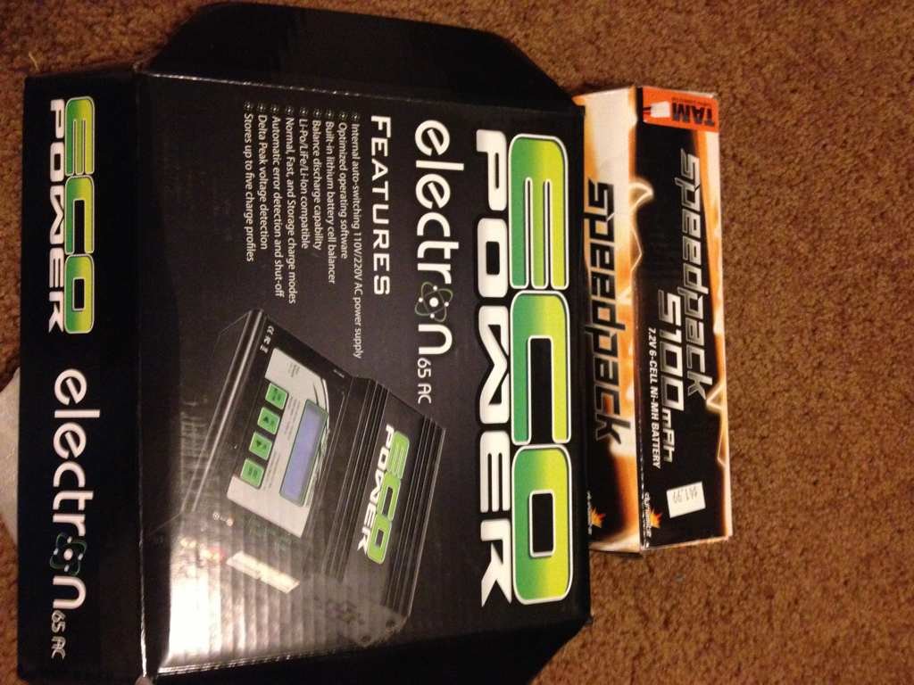

    7e6ymusy_0e04ad3ef83b43c79a28d3d56e1280f32e0de2eb.jpgsorry that it's sideways. But I have a question. I have a 6cell battery and this charger for it...I set it up to charge a NiMH...what do I set up for the charging options? For the amps?? For the volts? So much to choose from.
    What am I doing wrong..the sc10 only runs for like a min and it's super slow as well.

    If you have lipo cutoff turned on, assuming your sc10 esc has that function, and run a nimh battery, it will run great for a second then go dead like you are describing.
    Nimh batteries are designed to drain fully where lipos are not. Lipos can only be drained down to around 3.2-3.3 volts per cell. Lipo cutoff kills the power to your truck at these levels so your battery is not damaged. So if lipo cutoff is on while running a nimh pack, your esc will cut power even though your nimh still has usable power left. Make sense?

    makes sense. so then im guessing i set up the wrong charging options then and it doesn't have a full charge?

    It actually has nothing to do with your charging options. More so the difference between lipo and nimh operating voltages. Even if your nimh has a full charge, with lipo cutoff on it will still cut power soon after you start running it.

    it did for a second and now its back to being slow.

    Hmmm. I would try recharging your pack to make sure it's topped off since nimh packs fade. I charge my nimh packs at 5 amps by the way. But make sure lipo cutoff is OFF if you are using nimh batteries. Also, my stock slash esc had a "training mode" where the power was cut to 50%. I'm not sure if yours has that but it could. I'll look around for you.

    thanks man. ill look into it too. still need to read over the manual and what not. im re charging it now to see if that makes a difference.
