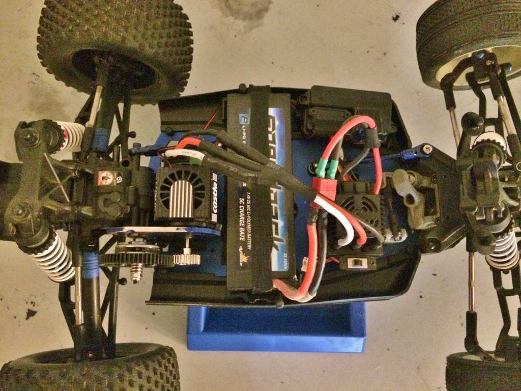

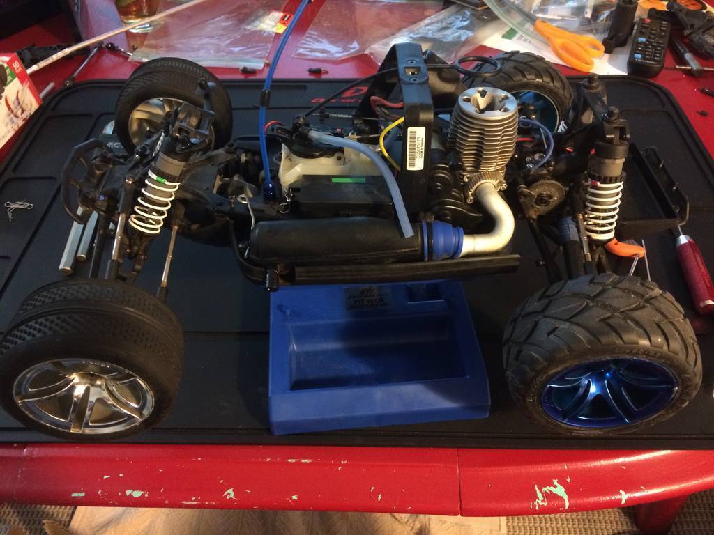

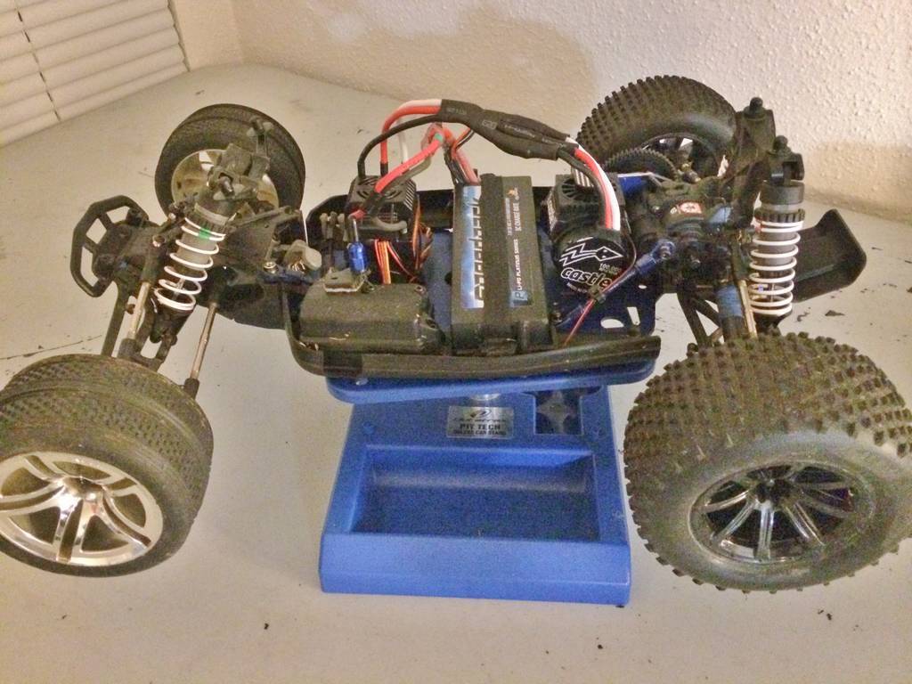

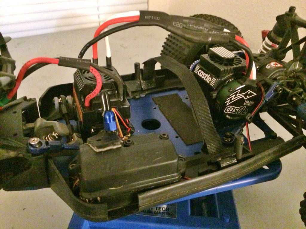

    Parts list/modifications for a nitro to electric jato conversion:
    -E-Xaxx motor plate (modified) $10
    -Jato single speed transmission conversion $10
    -Helion Dominus SC battery tray $5
    -Velcro battery strap $4
    -Helion Dominus SC 90* servo mounts $8
    -Traxxas Slash waterproof receiver box $12
    -Frame reinforcements $6
    -New spur and pinion gears $10
    -Spectrum 2ch receiver for existing transmitter $30
    -Castle Creations Brushless motor/esc $120
    -Misc. (deans plug, heat shrink, and other consumables) $5
    TOTAL:$220*
    I already had a number of these parts laying around, so i paid more along the lines of the $150+ range. There's also the initial cost of the truck, but i got this one from my brother. Tossed $100 his way for it, since he hasn't used it in a few years.
    So all in all, i'm in this thing just a hair over $250.
    still going to buy some new tires and little things to get it where i want it, but $250 for a well running vehicle is better than i thought. especially since nothing RTR for $250 is going to be able to stay with this thing on the track.
    Pictars!
    Sorry about them being fuzzy. camera was acting up in the low light.
    Before
    After
    Rear transmission to fram brace
    Front end frame brace

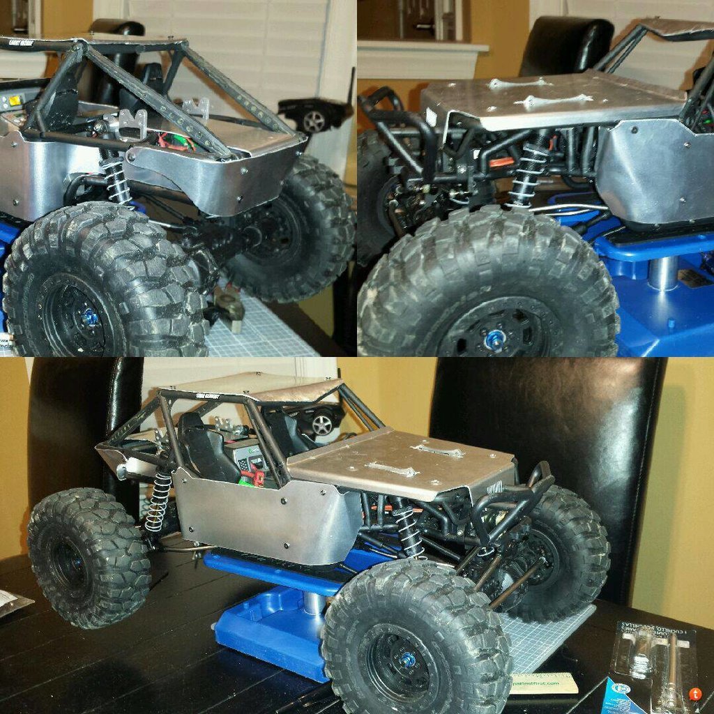

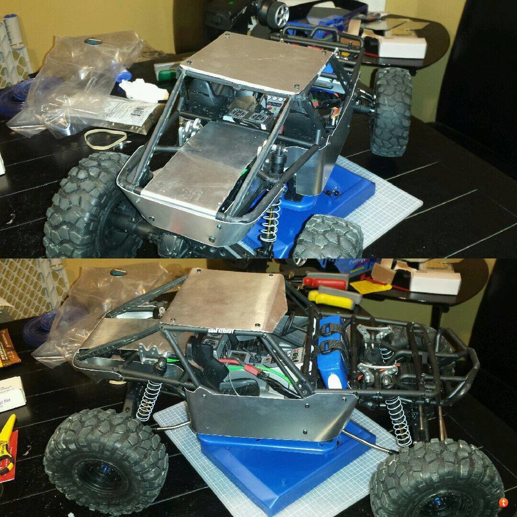

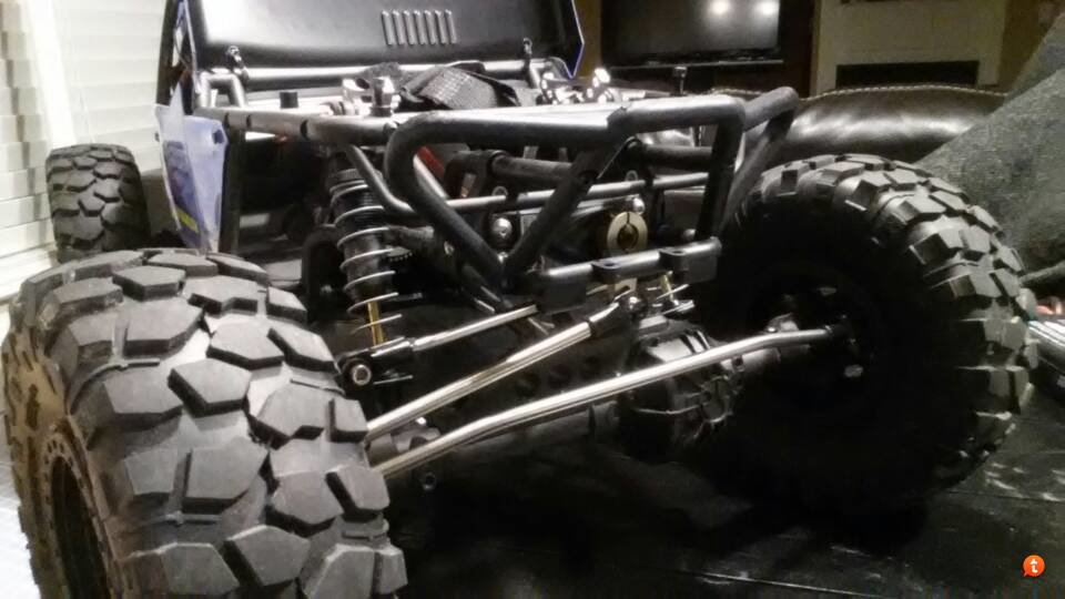

    Got the Wraith running again...along with a new paint job...and my buddy just bought the new Poison Spyder version yesterday
    :cool:
    good day in the woods today playing around...got around an 1:10 out of both on 1 pack each

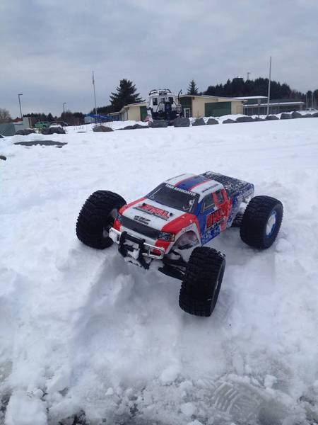

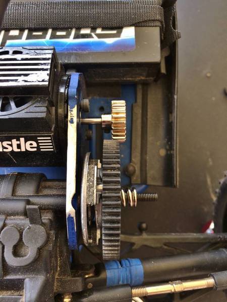

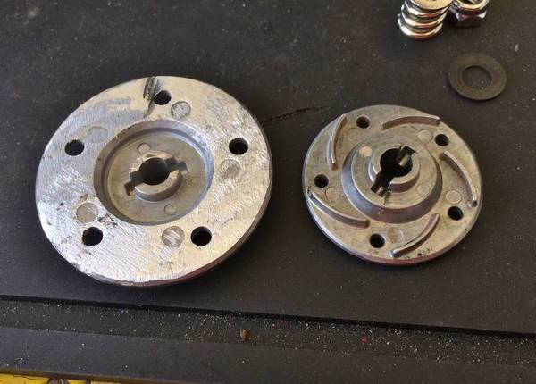

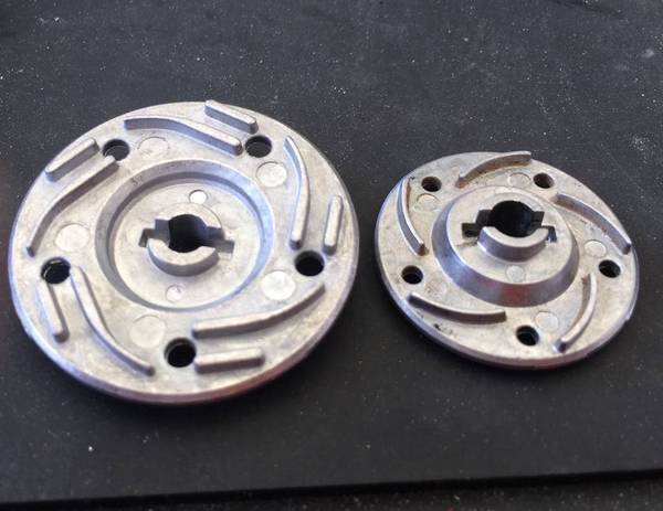

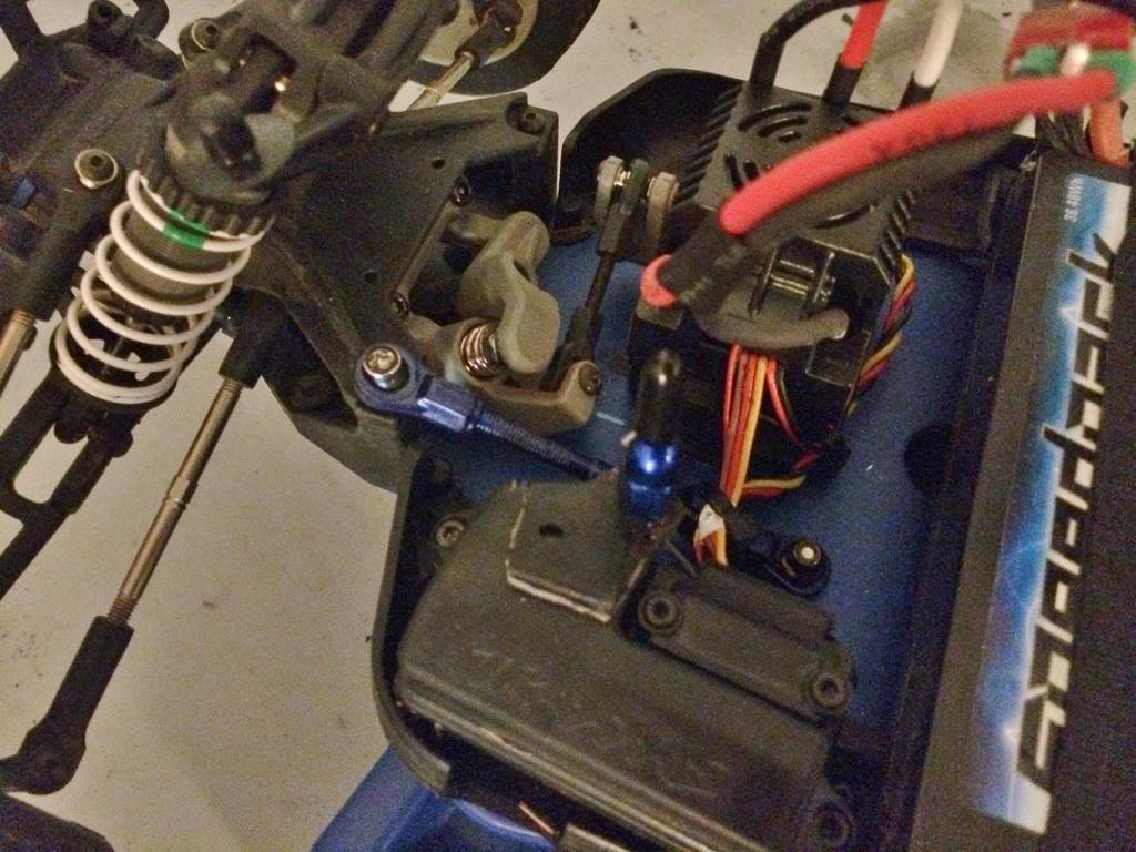

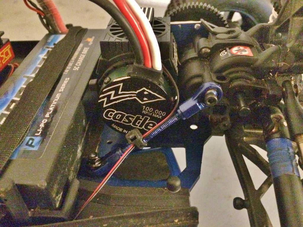

    Had a great day at the track with the E-Jato.
    while it obviously couldn't keep up with the 4x4 trucks/buggies, there wasn't a 2wd out there that kept up with it.
    new body, wheels, and tires on it since the last pictures.

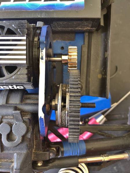

    did do a little trackside modding though. wasn't happy with how far the stock slipper clutch sat from the gearbox. it caused the pinion gear to be on the very tip of the motor shaft, and I still couldn't get perfect alignment.
    picked up a revo slipper kit from the shop that the track is attached to. as you'll notice in the pictures, the revo clutch plate (left), is recessed, relative to the jato clutch (right). had to dremel off the cooling fins to that is would clear the transmission, but after that, it fit on perfectly, and brought everything closer to the transmission.
    off set gear mesh with jato clutch
    clutches side by side
    with the fins ground off of the revo clutch
    revo clutch mounted. you can see how much it moved it inwards, allowing me to move the pinion in on the motor shaft.
