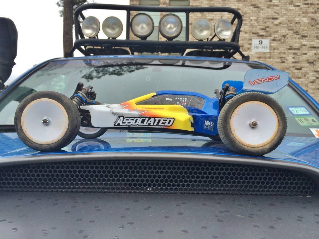

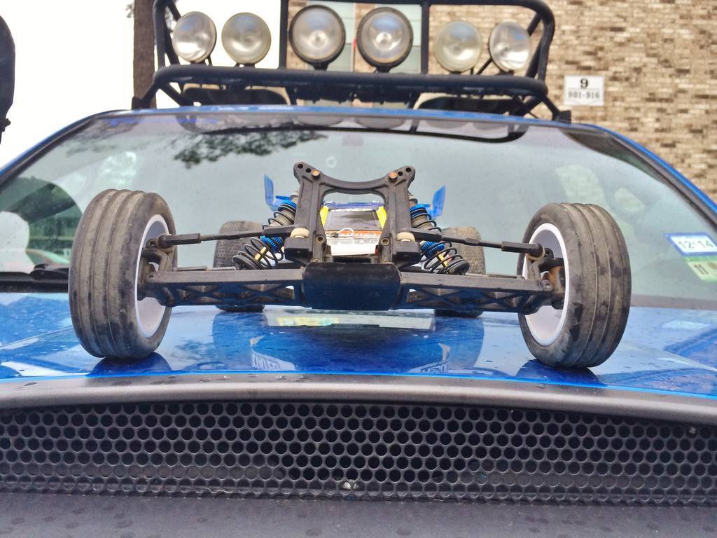

    After running on and off for 7 hours straight yesterday, I feel like the springs are decently broken in/settled. front is just about perfect, but it appears that the black 1.90 lb rear springs are a little soft. Valving a oil wt seem to be stop on.
    got some rear end sag.
    front is still sitting nice and level with the white springs.

    Set ride height via the chassis and not the angle of arms or cvd's. Measure the front right before the kick up and the rear right in front of the arm mounts. Front should be at about 24mm and rear should be at about 23mm. If you haven't already pick up a ride height gage

    I was basing my ride height being too low by the dogbones angling up, as opposed to being horizontal or angled down. the picture just offered a better visual. I don't have a ride height gauge yet, but I can measure the it with the vernire calipers for now. i'll pick up a gauge.
