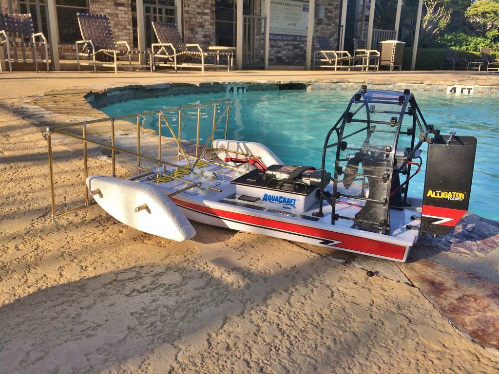

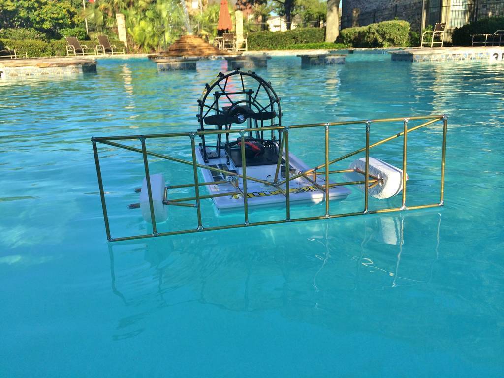

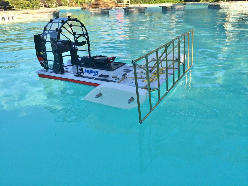

    test run with the push bar went pretty well. bottom of the bar is at the perfect height, just kissing the water sitting still. should be low enough to push the boat without ramping up over it, but high enough to not get tangled in any weeds or debris. only issue I saw is that the bow tends to dip pretty good when you slow down and the wake catches up and raises the stern. going to see how it handles with the new weight distribution of the brushless system coming in, and adjust after that.
    pontoons are held on with fuel hose slid over the tube

    Thats pretty cool

    Thanks. may ad some fuel hose to the buseness end of it if i find that it scratches the hull when i bush a flipped boat into shore. the factory paint on the revolt doesn't seem to be the most durable.

    This may actually be a situation where I'd suggest plasti dip. ..it'd keep it from scratching your other hull

    hmmm, wonder how well it'd adhere to brass. i'd probably use the real plastidip for this, not the spray stuff. only downside is that it takes some effort if i ever want to alter it.

    It pretty much just sticks to itself. If you get the liquid form of the dip you could pour it out into a flat container and dip the entire front of the push bar. Just make sure you dip all the way around the bar and you'll be good to go.
    The instructions are pretty specific on how quickly you submerge the object, so pay attention to your speed.

    Yeah, I've used the original stuff before. It's the spray that I stay away from. I think weight would be my only concern. The advantage of more silicone hose is that I can just use small sections, keeping it Extremely light. Hopefully it just won't scratch to begin with. Fingers crossed.
