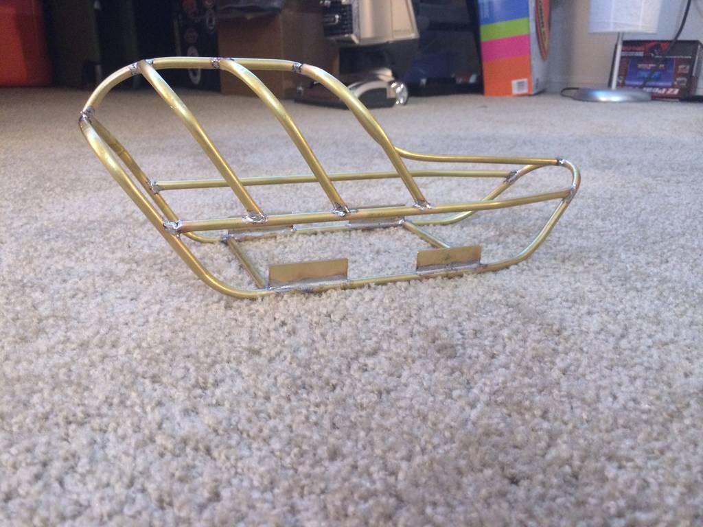

    Got the basic shape worked out last night. I used a much larger tube, so even being less than half way done, it's already pretty rigid. there will not need to be the amount of tubing as the one in the picture because of this, but there will be a lot more bracing than in this picture. initial mock-up has my geometry right where i want it. hoping to mount the rear shocks directly to the cage. front shocks will need some serious hoops.

    looks awesome! what are you using to bend it? and is that just solder holding the joints together?

    yep, non-lead solder with some good flux. same way i built the push bar for the air boat, jsut heavier duty material. i'm using a brake line bender for the tighter bends, and just bending it around different size cylinders (spray paint cans, mason jars, etc) for the larger diameter bends.

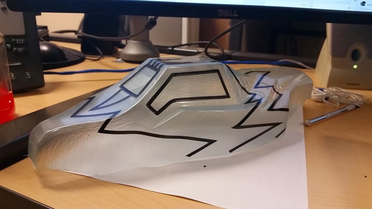

    painting this proline body for a friend.
    i'll post a pic of it when its done.
