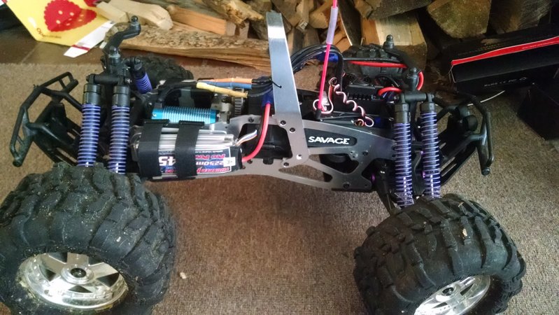

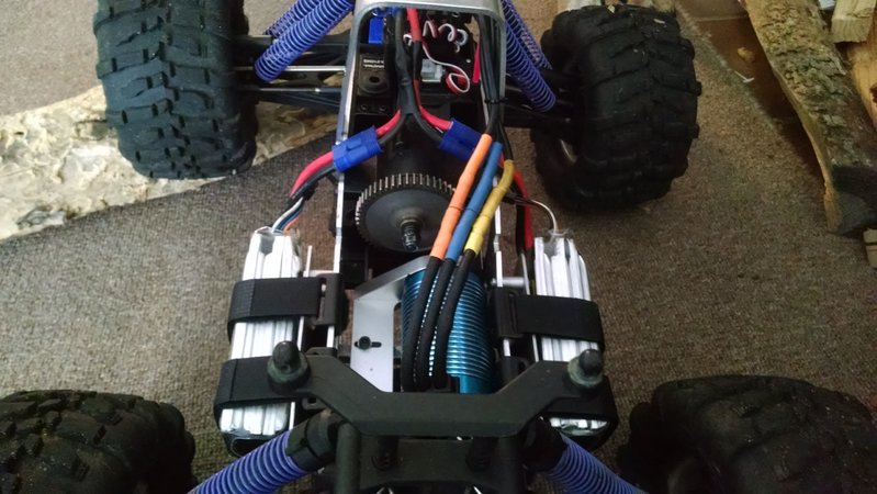

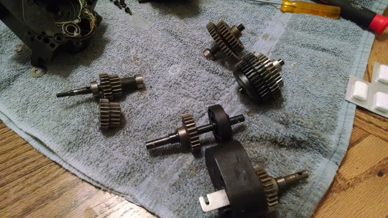

    Finished up the brushless conversion last night.

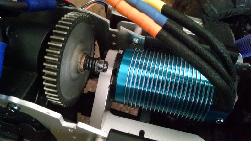

    Replacing the gear in the two speed tranny with the Flux gearset. So it's now a single speed with no one way bearing so the esc can take over braking duty as well.
    I still have a 3 speed tranny, I may mess around with that another day.
    The LCG mount and a 2350KV brushless.
    Currently using 13/51. Will be changing to 15/43 for a bit more speed

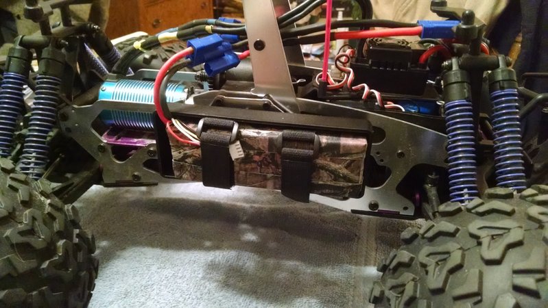

    The kit came with plastic battery trays and aluminum mounts. I had already made my own mounts because I'm using 3S 2250 65C lipo's, so will use them for now. I will be using 4S power in the near future.

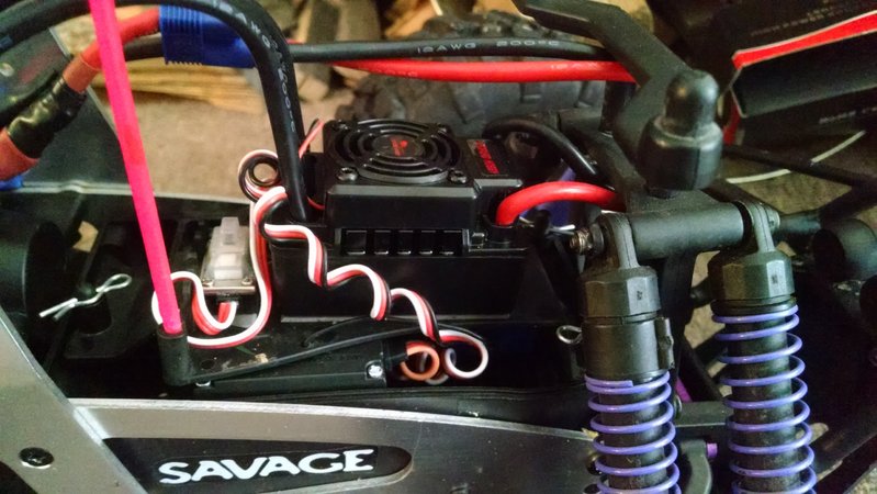

    Not the best ESC, has a little cogging at low speeds but who drives a Savage at slow speeds anyway...I'll run it until I smoke it.
    Shakedown/Snow run.
    https://www.youtube.com/watch?v=0FKd8tIoEFU
    Happy with the conversion.

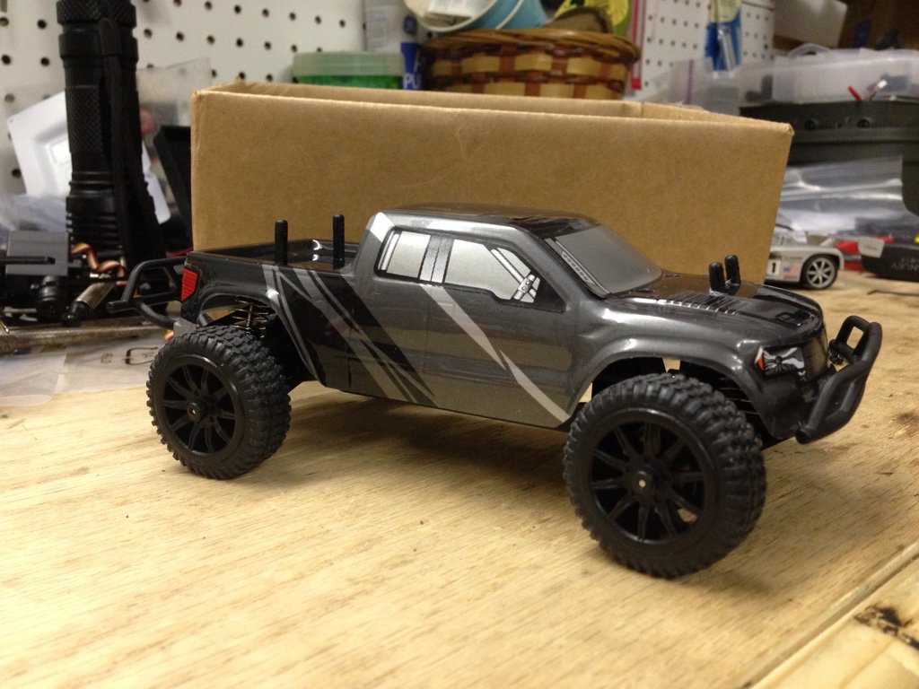

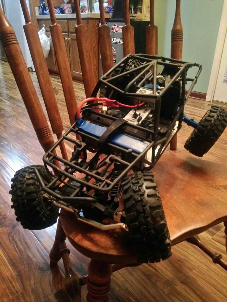

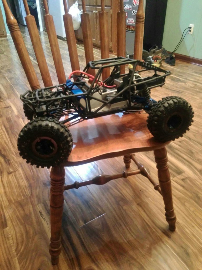

    Starting a little build.
    Losi 1/24 Micro Rally/SCT. I'm starting with a f150 styled body and am on the look out for something else. I just need a motor and servo to get it running.

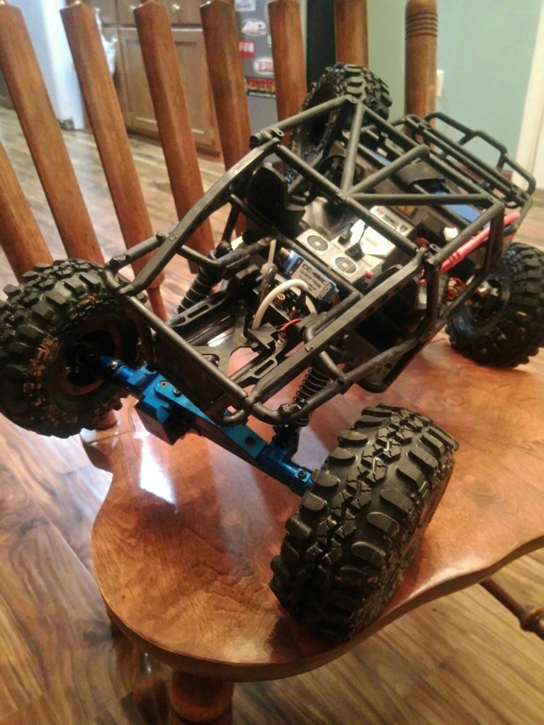

    Just got back into rc , picked up a wraith a month and a half ago... put a Holmes 35 torque master in it and a sidewinder 3 with a hightec hs 7955tg servo and a couple other goodies on it...

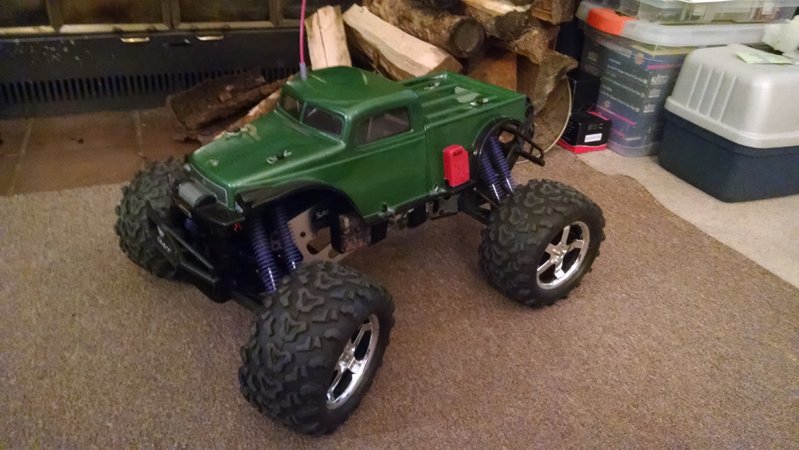

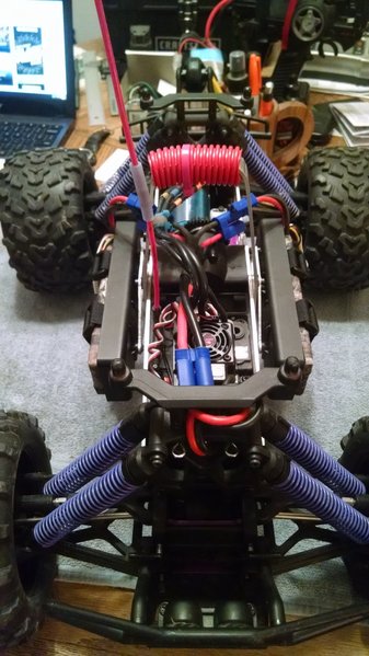

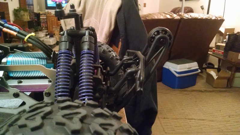

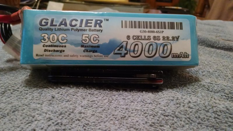

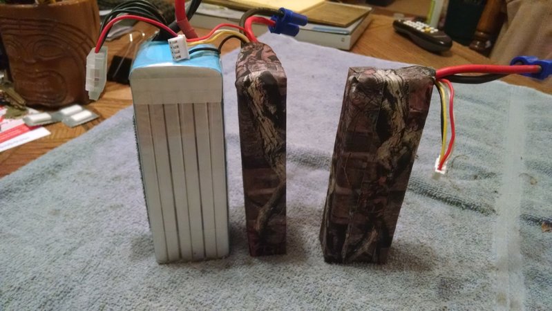

    My little 2500mah packs were not up to the task of full throttle punch outs and the run time was a bit short. But they are also several years old.
    I have a few of these sticks of dynamite for a helicopter, and thought I would re-purpose one for the Savage.
    So I split a pack in half, and now have a pair of 3S 4000mah packs that are capable of 120 amp continuous discharge.
    And installed the battery trays that came with the kit from Kershaw Designs.
    And a wheelie bar to help keep the rubber side down.
    :D

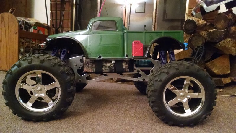

    Dog, camper.
    And I re-purposed the Dodge Power Wagon body that came with my AX10 but was really too big for rock crawler duty. Fits pretty good too.

    Looks awesome! That must rip with those batteries.
