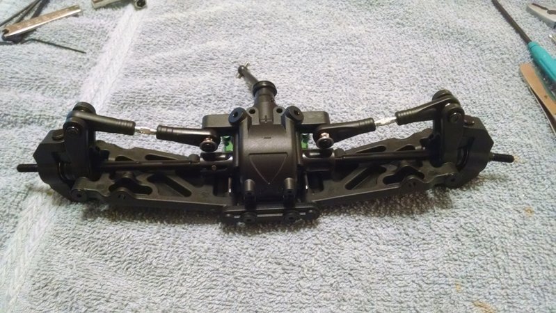

    Front diff and gears.
    The instructions called for 500K to 1000K weight diff oil..
    I started with 500K and ended up scooping it out as it just locked up the gears.
    I used 125K silicone oil in the end and it turns a bit easier now.
    and the IFS assembly several steps later.

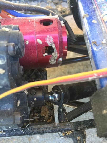

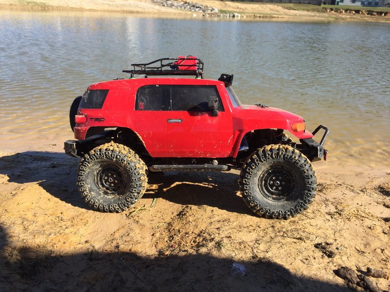

    Did a little wheelin' this morning. Grenaded front driveshaft pin after about 30 minutes so back to the workbench she goes.
