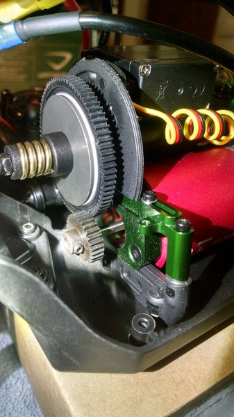

    I picked up a 6 pack of pinion gears.
    Before I left, I checked to see just how much mesh adjustment I had left, and it wasn't much. I can go way bigger on pinion and prolly do 3 second 1/4 miles.:D
    the pic shows the 28t, inverted, with the motor adjustment as tight as it will go, as a reference to how much smaller I could go.
    But to go smaller there wasn't much left. I was thinking a 20t pinion might be the limit.
    The pack I got had 15, 17, 19, 21, 23, and 25.
    the 21 fit, and I mean perfect with the adjustment maxed, no room for a 20t.
    It's perfect imo for top end, good speed and does wheelies easily.
    Low end is still too fast, but it's better. I still think there is room for improvement.
    I picked up an Orange receiver to stick in the Savage. If I'm able to dial down the take off speed via expo, then that tells me the bl/esc combo in the TH is gonna be replaced with something better. :cool:

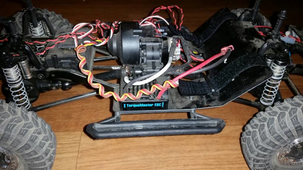

    I'll talk you out of it.... Traxxas makes garbage that doesn't break. Those vehicles are for bashing and doing back flips. Get the axial rigs and enjoy them for a long time until you want to start upgrading things that you don't need.
    Yes, sensored brushless at low voltage is more stable at low rpm than the opposite. If you want to crawl, you need to go brushed. You can buy a 65 turn brushed motor and run it on 6 cell and it will have good low end control. They don't make 540 brushed motors for 6 cell, but it would be stable
    My wife let me buy what I wanted last year and I got a Holmes BRXL wp and 45 turn torque master pro. I run it on 2 and 3 cell packs. It's slow, but scale trucks don't use wheel speed to get over things, they use driving skill
    It's a mess but it isn't done yet... It's only been 12 months
