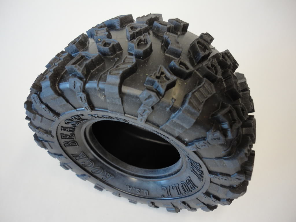

    I just need to find a set of good aluminum wheels wide enough to use these.

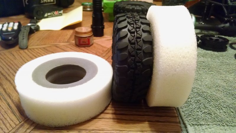

    This is what the kit came with, the foams were already in the tire so I never really looked at them until now. They look huge. Tire is stiff with them mounted.
    I'm thinking of cutting half of the outer ring out, test first, then maybe do the star pattern.

    That's the competition foam setup, also meant for the not-so-heavy rigs. The outer foam is softer and lets the tire grab rocks better. The inner foam keeps it from collapsing. Note that the outer foam is NOT waterproof, whereas the inner foam is.
    One piece foams (also from CI) are meant for heavier rigs or trail rigs as they don't have that softer outer layer.
    Personally, I wouldn't cut the foams in any way. If anything, try running without the outer foam to see if you like it.

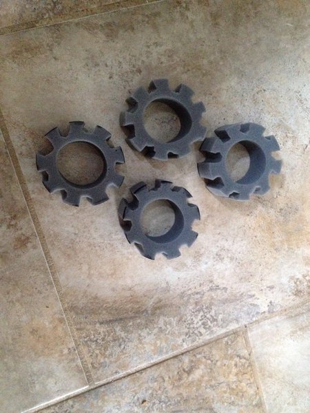

    I meant for the cheaper foams. Here's how I cut my 2.2 Mudslingers.

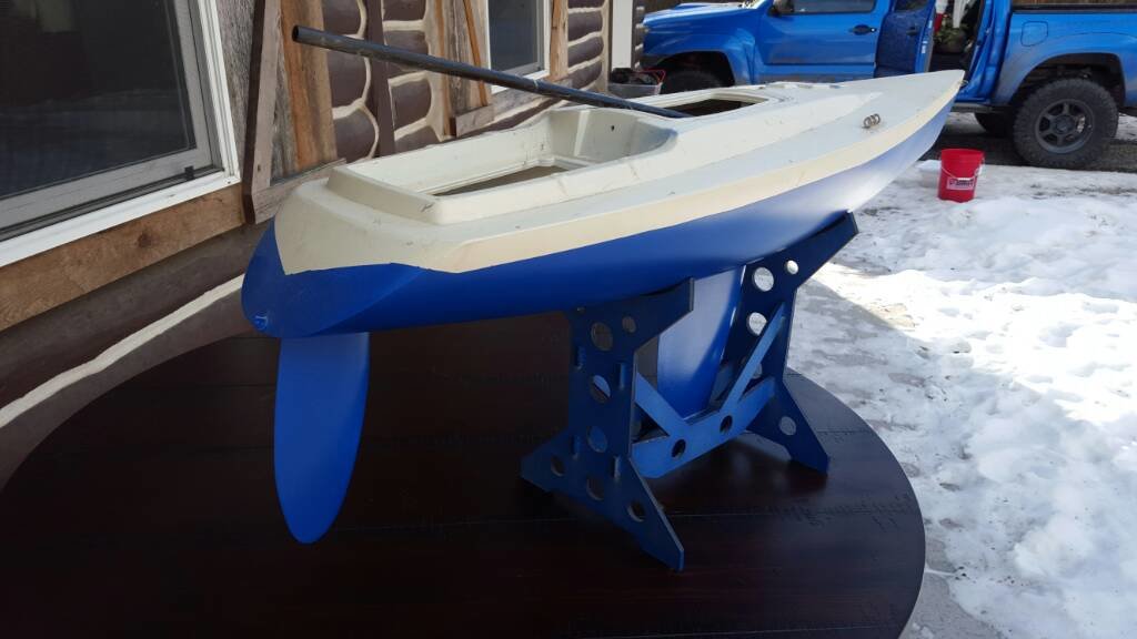

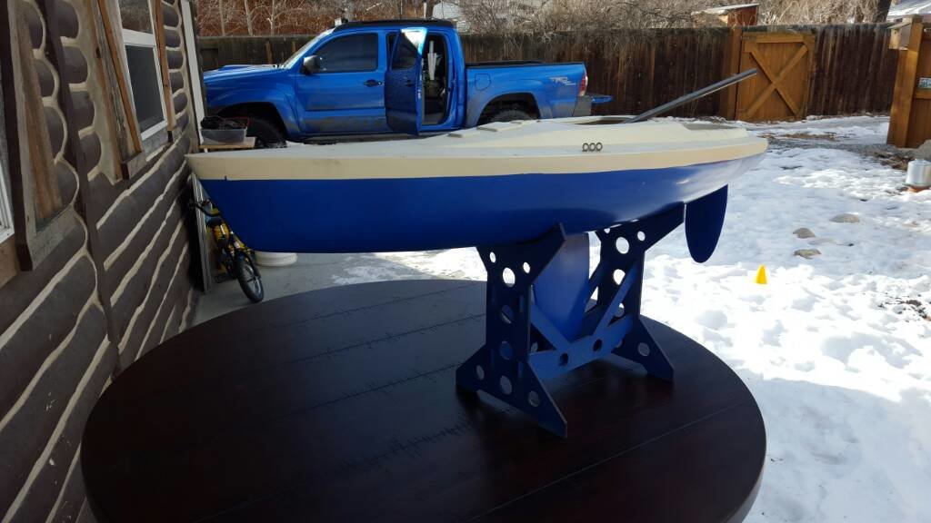

    yay, someone else into sailboats!
    I'm overhauling mine this winter. they had a fairly intense summer.
