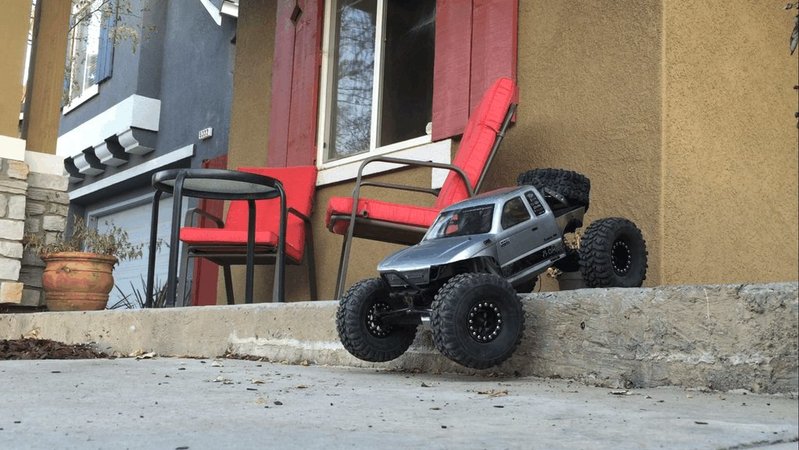

    I don't run it in full on basher mode. I'm looking for a nice range of crawl, but not necessarily full on rock crawler slow, with enough speed to require a bit of throttle back before flipping it in a turn. :p
    It currently has a 2300KV brushless, non sensored setup, with a 21t pinion on 2s. The 21T is the smallest I can go, I have no more room for tooth mesh. 28T is the recommended size. I have all the sizes in between too to experiment with. The current setup barely produces any measurable heat after a 15 minute run, tearing up and down the street.
    The high end is about right for me, the low end is close, has some cogging when trying to get over obstacles even in low range. I'm thinking the main problem is clearly not being sensored. Would like enough leeway to have some choices for pinion sizes to dial it in. The 2300 size sensored might be what I'm looking for with a slightly larger pinion?
    Or can the 3100 be ran with a larger pinion and still be dialed down (programmed) for slow speed..
    I know, lot's of noob questions.
    I'm seeing these brushless crawler motors branded as 13.5, 19.5, 21.5, etc... From my limited understanding in the brushless world the higher number means slower rpm? Is that correct?

    The cogging you're seeing at crawling speeds is definitely caused by a sensorless setup, you want sensored brushless for racing, crawling, etc. If you're happy with the 2300kV speeds right now, then you could be right that the 2300kV Roc is the right motor for you. It'll still be plenty fast, especially if you run it on a 3S.
    A 3100 Roc has very good low speed torque and resolution, so basically you'd control it with the throttle. You can always reduce your throttle dual rate (don't use expo), which would give you less top speed but more throttle movement over the speed range that remains (if that makes sense).
    The brushless motors like 13.5 and 21.5 refer to the number of turns of wire in the stator and actually can be measured in kV as well, it's just that kV ratings vary from manufacturer to manufacturer so "turns" is the formal term used to talk about motor speed ratings. A 21.5 is slower than a 13.5, so the 21.5 will have a lower kV rating.

    after researching sensored brushless until my eyeballs bled, I've decided to increase the size of the spur gear.:anonymous:
    Waterproof is kind of important to me as I run in the snow. I'm sure a sensored system could be waterproofed just fine. but damn they are expensive to get a good setup. Seems overkill for a guy just screwing around, but will prolly happen eventually anyway. Maybe even today. Both my lhs carry Tekin and Novak products.
    My video actually showed me a thing or two...
    My skills do not warrant added speed.
    The cogging /low speed issue might be alleviated with lower gearing.
    So Losi makes spurs that bolt right on, the TH has 78t stock and can go as high as 90t.
    This may open up some more gearing/performance options.
    I can always drop a 3s pack in it too if I need to spin the rubber off the wheels. :thumbsup:
    So I'll try this first as it's cheap and easy and a kevlar spur gear isn't a bad thing to have.
