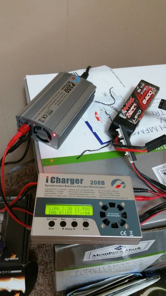

    Got my new charger and power supply in today!! Love it.. even tho it took me awhile to get some what use to it. Just time consuming to get settings set up for each battery.
