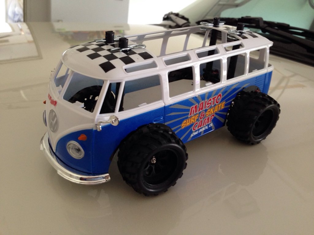

    I started putting a VW Samba body onto a Losi Micro Rally.

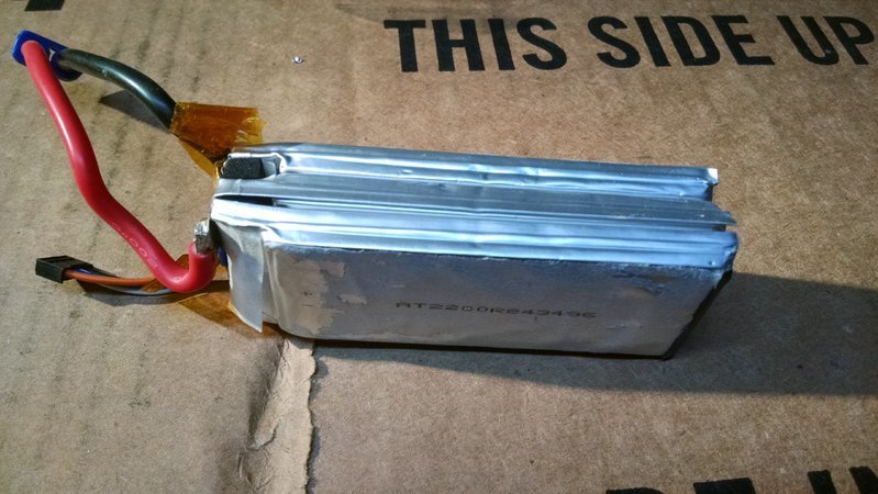

    Split a couple 3s packs to 2s packs today for my friends SCX10.
    Thought I would take some pics for those who haven't done this. I suppose like most who have been in the hobby for awhile, you acquire lots of lipo packs and sometime's it's cheaper to re-purpose a few than to buy new.
    This can be dangerous and you run the risk of burning down your house or bodily harm so use caution and keep safety utmost in your mind. Your table surface MUST be non-conductive to avoid an accidental short.
    Do this at your own risk if you choose to try it.
    I've done several packs and am quite comfortable with it now, the first pack I did was truly terrifying.
    Packs must be in storage charge before beginning.
    A high watt iron is a must, you want the solder joints to take place immediately to avoid heat transfer to the pack and damaging it. I use a 140 watt Weller.
    I have several older Thunder Power packs that still charge well but are too heavy for flight so they will be used for ground power

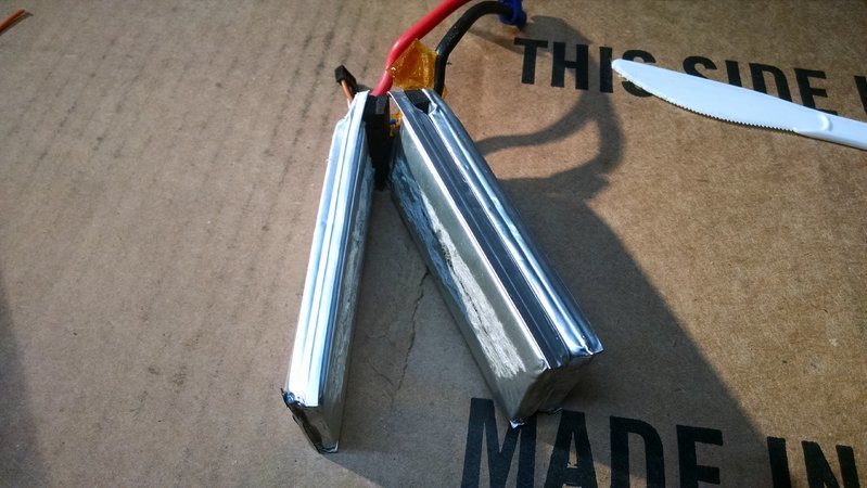

    Gently remove the plastic covering
    I use a plastic butter knife to separate the pack. Do not pierce the foil, if you do that, the cell is done, and it may get smoky. Patience is key here, do not rush it. Avoid pulling the packs apart, do not disrupt the foil surface any more than necessary.

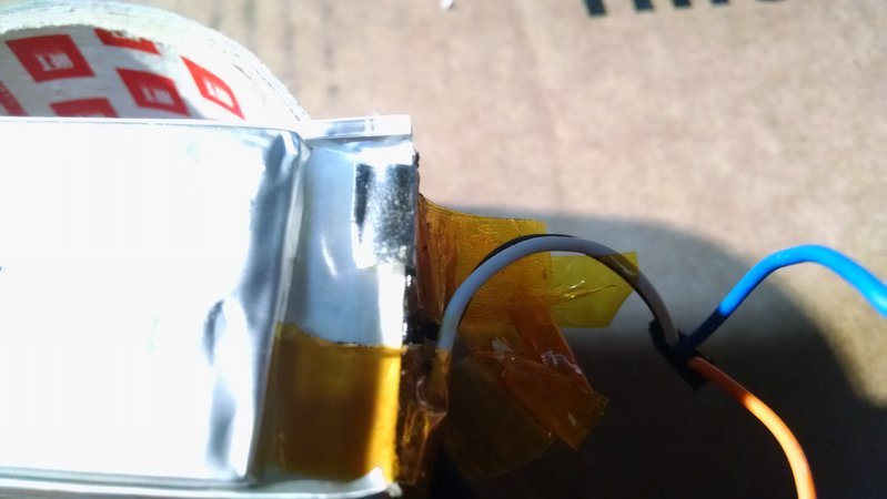

    I have removed the Positive lead and two of the balance wires, preparing to separate the metal tabs from the two cells.
    I just use tiny metal shears, and VERY CAREFULLY snip the tabs apart, DO NOT SHORT THE TABS, sparks and fire will most likely result.
    Safely insulate the tabs on the unused cell and label it so you know what it is for future use. This is the main reason for having the pack at storage charge before starting, as this cell will be sitting for a bit until needed for another project.

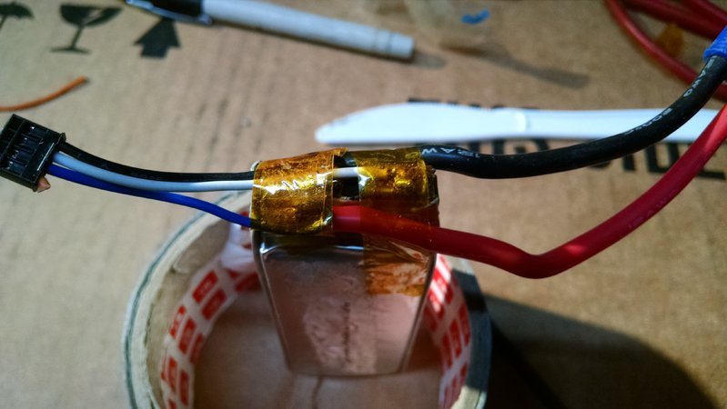

    Now to solder the positive lead and one of the balance wires back to the tab. You will have to rough up the surface for the solder to stick, I use a small jewelry file. DON'T SHORT THE TABS! Can't stress this enough.
    Positive lead.
    Balance wire
    Taped off contacts and unused balance wire snipped off. There are diagrams on the internet for balance tap wiring if you are unsure what to clip. TP packs are easy as they use the same tap for both 3s and 2s. If using another brand you will need the right balance plug or an understanding on how to use a 3s tap as a 2s tap, blah, blah, blah.

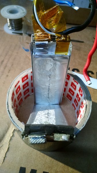

    And complete, two 2s packs and two single cells for extra/repair or if I find another balance tap I can make another pack. Brings up a point, when your lipo's crap out, save the balance wires and the power leads before you dispose of the pack.
    This is a pack I made several months ago, I wrap them with Gorilla Duct Tape as it's thick and gives a nice protective cushion. You can also use large heat shrink.
    Don't forget to label it. When finished I always give them a full charge and then bring them to storage charge to cycle them and make sure all is well.
