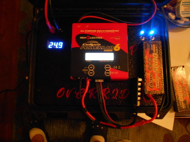

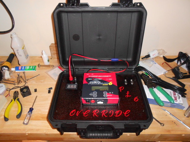

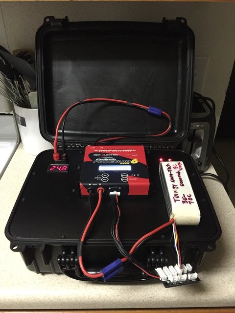

    This is my personal charging station, I built this back around 2011 and it still is running strong today. The dual power supply setup will crank out 1100 watts and 46amps at 25v which is more than enough to max out the PL6 I use.

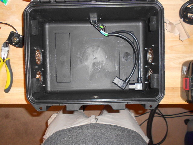

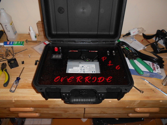

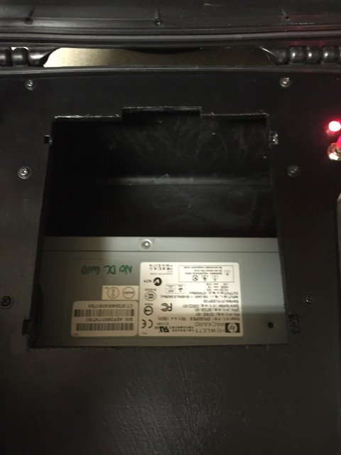

    This is a build I did for my buddy, it was done as a cheap build as he is kind of a cheap a** and doesn't like spending money. So I sourced out the case used and used a lot of spare parts I had laying around to help keep the cost down for him. I think it still turned out nice, other than the fact he wouldn't let me jazz up his deck for him like I did mine. I do actually like the case I used on his better, it was a much cheaper alternative than my Pelican Case and has more storage room to boot!
    There are con's to using this case though...A) I had to flush mount the deck, which I wasn't keen of. I like how on the pelican case you can recess it a bit. B) Since I couldn't recess the deck the charger would not allow the lid to close without dropping it down further into the deck. This presented a problem as the chargers are not "secured" but more of pressure fitted in by adding some velcro to the sides allowing for a snug fit. Due to this issue I had to notch out the deck for the expansion connectors on the side of the charger and add some small pieces of wood for it to sit on. C) The plastic seems to be of cheaper quality than the pelicans and don't take well to routing with a dremel. You may notice the out of place plastic where the power plugs in, this was due to the dremel hitting a soft spot in the plastic and taking off where ever it wanted before I could pull it away.
