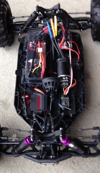

    I got this Exo up and running. I think the 20 tooth is too tall because it'll cog ever so slightly when moving slow. At full throttle this will fly on 2s.
    Front shock towers front and rear. Mismatched shocks for now and the shortest 2.2 tires I have.
    When I get the Yeti towers in next week I'm hoping this will mount up low enough to not expose the chassis.

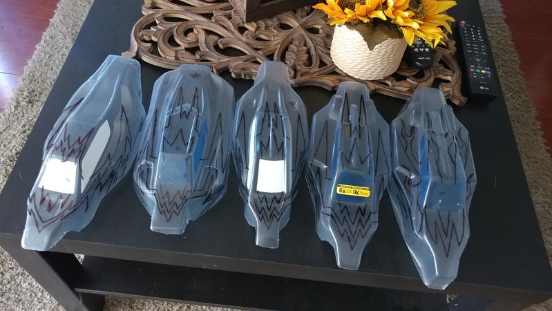

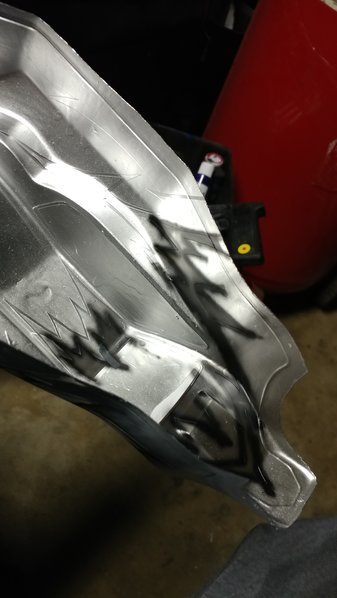

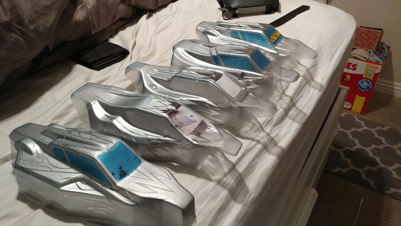

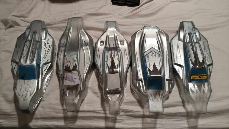

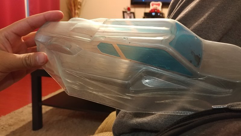

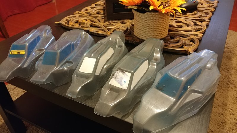

    Figured id post some step by step pictures of these bodies im painting.
    Here are the bodies masked with liquid mask and the designs drawn on the outside.

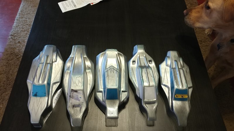

    Here they are with the designs cut out in the mask and the design removed from the outside.

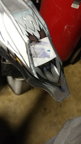

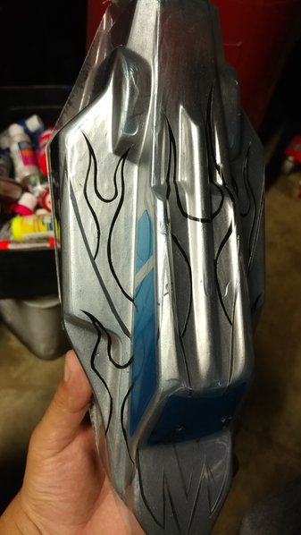

    Here the first section of mask for the pinstriping has been removed.
    And here the first color has been painted on all the bodies.
    Here the second section of mask has been removed for the next color waiting to get painted tomorrow.
    The rest should be done by tomorrow. I'll make sure to get progress pics.

    The rest should be done by tomorrow. I'll make sure to get progress pics.[/QUOTE]

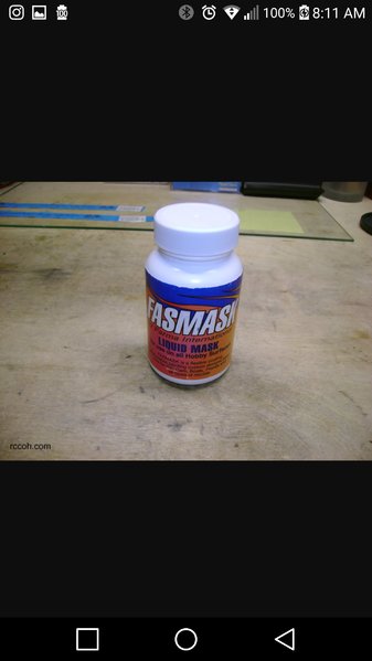

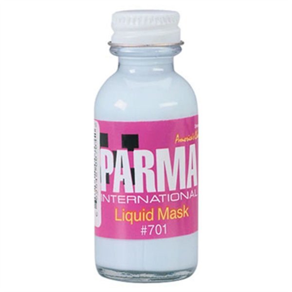

    I've been out of the game for some time now. What brand mask are you using? Seems I used Bob Diveys or Parma. Are those even still around? Do you brush or spray your mask on? How many coats? Be sure to post the finished goods. You're throwing out some nice bodies these days. I remember when you were single colour rattle canning!!! LOL

    Both are still around and i use either or. I brush on about 4-5 coats depending on how much I've thinned it.
    I'll get some finished pictures for sure. And thanks man lol. I've slowed down a bit but i still paint for my friends when they ask for it. The hate of 1 color rattle can jobs and cost of having others paint for me made me learn real quick hahaha.

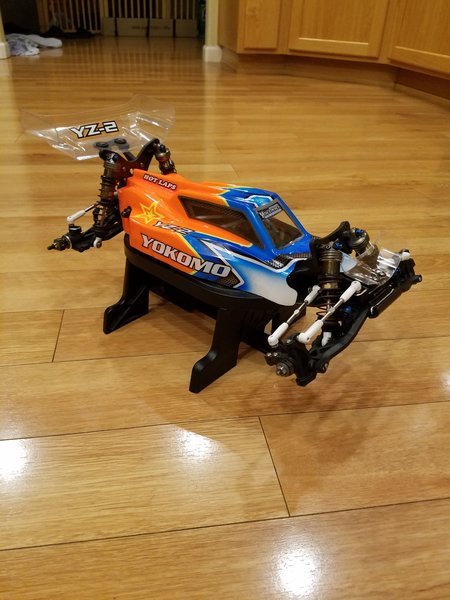

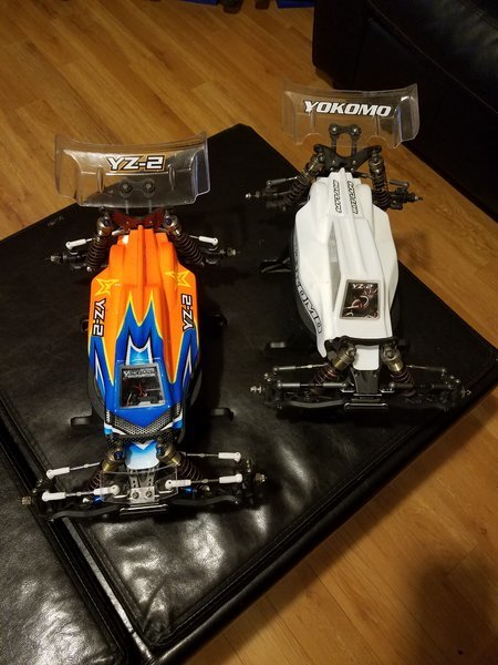

    20161223_013203.jpgHere's a pic of my yz-2 mod buggies that I race.

    I like to see the knife you are using to cut the design. I would like to try this method instead of using tape and paper. Also, can you post a pic of the masking product you used?

    I'd be willing to bet he uses a new #11 exacto blade. You must be careful not to "score" the body when cutting out your mask sections.IMG_5436.jpg
    Most any good hobby should carry liquid mask in their paint section.

    I use a #11 blade. Bob Dively or Parma Fasmask.

    Nice! Got that lee martin paint job. I wanted a yz2 really bad but ended up going with the b6d out of convenience lol

    It's actually one of his old bodies from the original yz2 I even have the little LMR body wing I took it off because I run a front Mount.

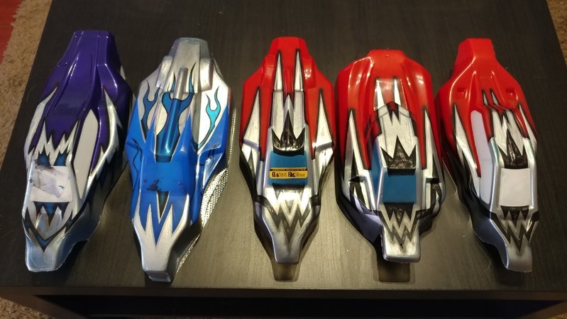

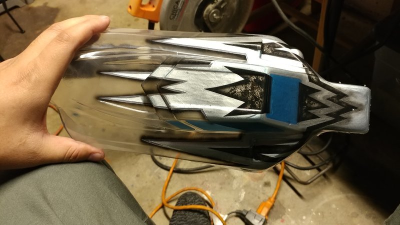

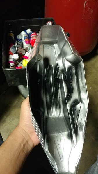

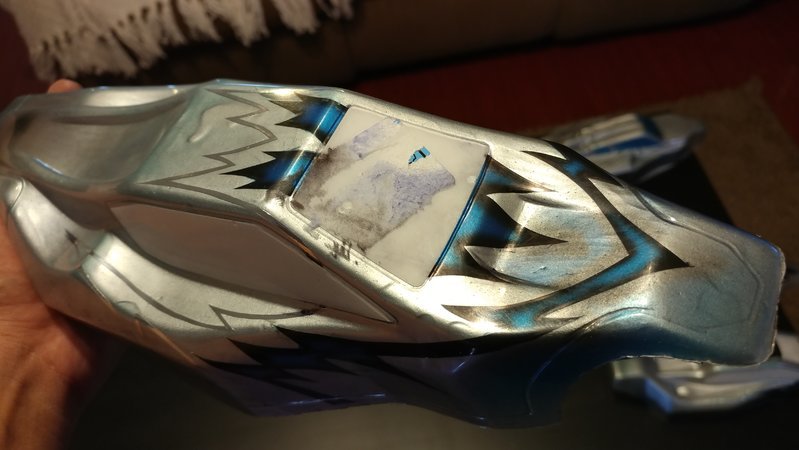

    Some more progress.
    Pulled the second section of pinstriping mask for the second color.
    Then started pulling the larger sections of mask for the darkest colors. Also did some shading for some detail.
    Then started painting the darker colors in the larger sections.
    This is where they sit right now. The lighter colors are next.
