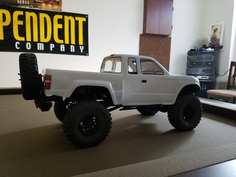

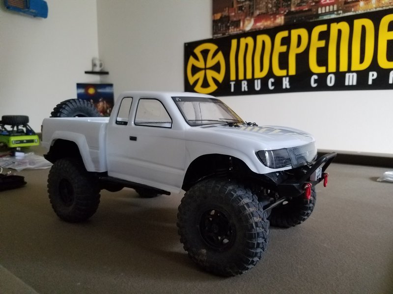

    Trailfinder 2. I have a molded 1st gen 4runner body waited to be finished.

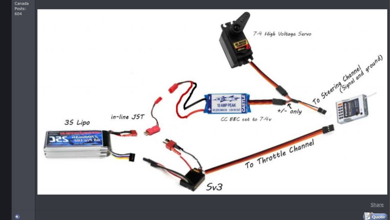

    Can you explain about the BEC? It steps down voltage to the servos so they aren't damaged?

    It's not only for servos. I tie my bec between esc and battery plug and it allows you to set the voltage coming out the other end so it's constant voltage of Your choice. To power servos winches lights etc

    Okay, I've blown five servos I'm wondering if this would help

    Here is how I run mine. Without the Jst plug. No clue why that would be in there. This makes for easy servo swapping and lets you remove and use bec in comething else. Instead of soldering it in
