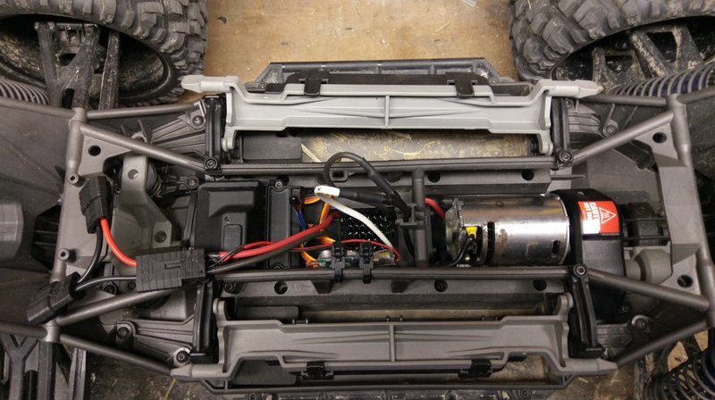

    Well...
    The first brushed X Maxx? I will try to get some more video this weekend.

    "Locked" the diffs with some silly putty this morning. Here is something the X Maxx couldn't do before...

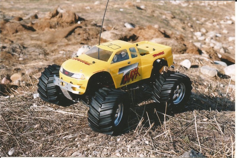

    I have been considering getting back into RC. I got my t-maxx when I was 12 years old in 2000. It has sat for nearly a decade. Here is what it looked like in its prime:Right.jpg Left2.jpg

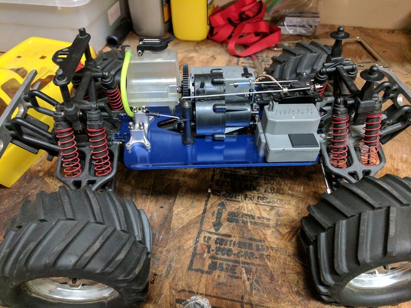

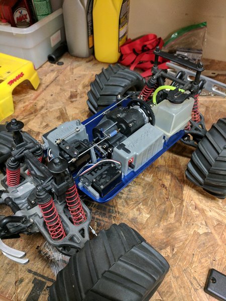

    I dug it back out recently the to find the motor is gummed up and the radio was pretty much toast. The body is thrashed and there are LOTs of worn out parts.
    I have done the following:
    -Tmaxx 2.5 chassis to accept a slide carb motor
    -T-maxx 3.3 bell cranks
    -T-maxx 2.5 driveshafts
    -New brake disk
    -3.3 style slipper clutch upgrade
    -New motor mount and clutch/flywheel assembly
    -Forward only conversion (cheaper than repairing/ modifying reverse with the new bellcranks)
    -A bunch of other part updates that came with the chassis
    Here is how it sits now:
    I still need a motor and a radio. Thinking the Traxxas 3.3 and this radio:
    http://www3.towerhobbies.com/cgi-bin/wti0001p?&I=LXAVSY&P=ML
    Thoughts?? suggestions??
    I am kind of at a point where I could just buy a new Tmaxx 3.3 for the same that it would cost to keep rebuilding this one.
    Is this roller worth selling?? What is it worth?? It would be perfect for somebody that wants a tmaxx with a motor and radio of their choosing. Should that person be me? As you can see, I am conflicted.

    Traxxas 3.3 can be found on eBay for less than $100 New.....that radio is good (anything futaba is usually top notch).....good luck

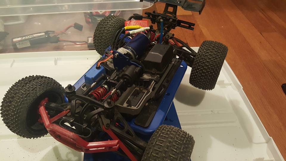

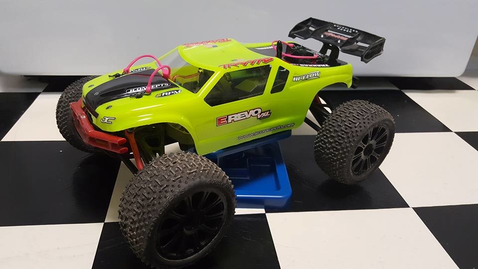

    Finished up my Mini EREVO , this weekend. I'm pretty happy with how it turned out. The thing really flies on the new 3S Lipo. It handles worlds better than stock, as well.

    How is the Revo over Emaxx? Revos came out a year or two after I got out the hobby
  10. Mar 26, 2017 at 1:34 PM
    AJH387
    AJH387 Well-Known Member
    Jul 20, 2016
    #192501
    3,094
    AJ
    Pittsburgh, PA
    '19 TRD OR DCLB
    I'd say it is an upgrade. The handling is better and a bit more versatile. It is more of a Monster Truck / Truggy hybrid, while the Emaxx is 100% monster truck. You can drop the EREVO down a bit, throw on race tires and it'll hold it's own on a track night. The EREVOs do have a bit of a reputation for being expensive to own. I have broken a few things on 6s. Not sure if EMAXXs have the same diff issues that have problems, like the EREVOs. The next time mine need attention, I am thinking of just going with Hot Racing aluminum bulkheads, to eliminate any flexing in the area, to hold everything tighter. But I love the EREVOs, which is why I have a big one and a mini.

    Well it rained all weekend so I didn't get out to the lake to test it, but I did take it out to the alley. It is kinda slow...

    Seems like it should be a bit faster. Are you set for full throttle and LiPo?
  19. Mar 27, 2017 at 5:32 PM
    junaitari
    junaitari Well-Known Member
    May 4, 2015
    #154512
    191
    2015 Magnetic Grey Tacoma Off Road
    Nil
    Lol, it is meant to be slow. Converted to an 18V brushed Dewalt motor geared 11/54.
