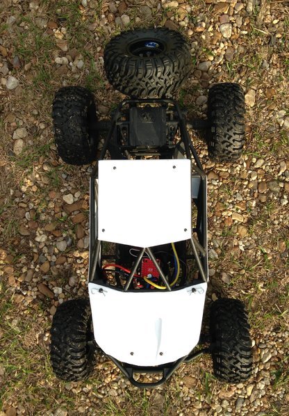

    Paid for another Wraith chassis. This will make #3 when done.

    It should be fine. I put my Rx all the way to the back of the. Artery tray and it helps keep the battery forward and under the body more open. But it can be seen, too. Thinking of removing the housing to free up some space.

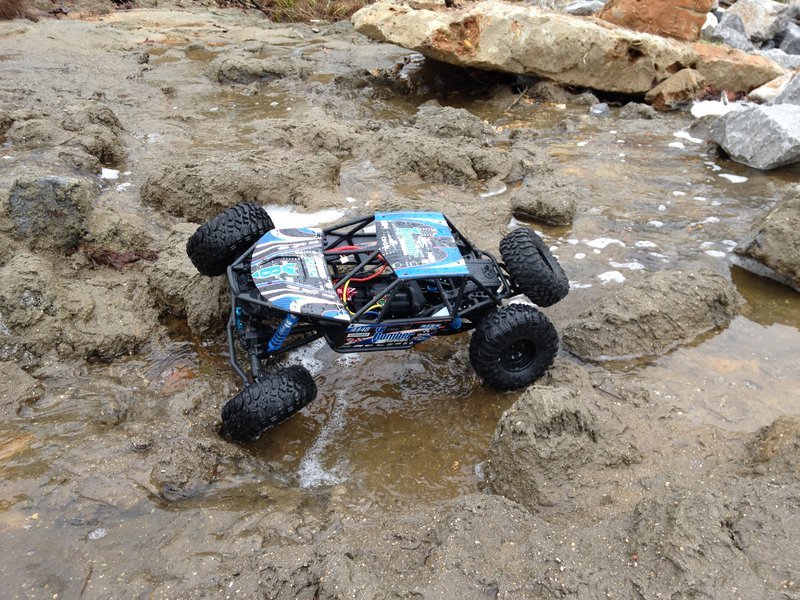

    I put a Yeti sway bar which is too stiff really. HR makes a decently priced adjustable sway bar. Thicker shock oil will make a world of difference, too.
    My first one I had set up like a FOFF and it was brutal on take off and speed on 3s. Ended up having a ticking in the tranny after a few packs through it. So I traded it for a beat up Exo Terra and it's filled that void nicely. It's a rocket and handles well at speed.
    Open front diff and homemade fat pool noodle foams in the tires. They're too firm for crawling but love the loose stuff, leaves, and the likes. It's got a 3670 2650kV motor right now and I'm hoping the 4068 I've got ordered will fit. It should have plenty of TQ even on 2s. I did it up for bashing around walking trails through the woods and stuff.

    Before the gloss white vinyl wrap.
