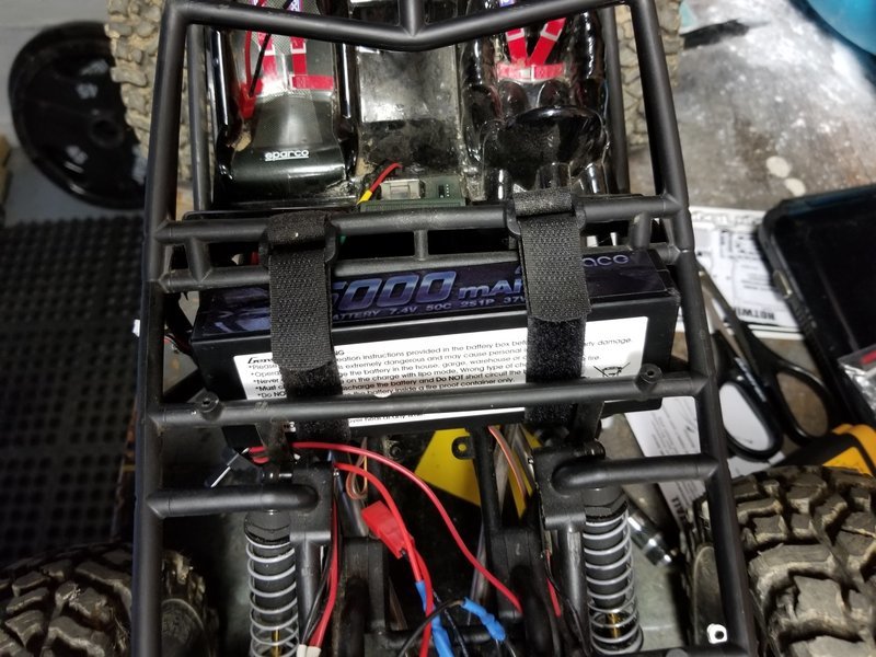

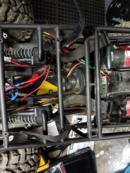

    Battery to the front is pretty easy. I cant remember, but you might have to move the receiver box (I moved mine to the rear), but you can fit the battery right in front of the cabin like this:
    Moving the electronics to the rear was done by purchasing a small electronics project box and cutting a hole in it to run the wires out:

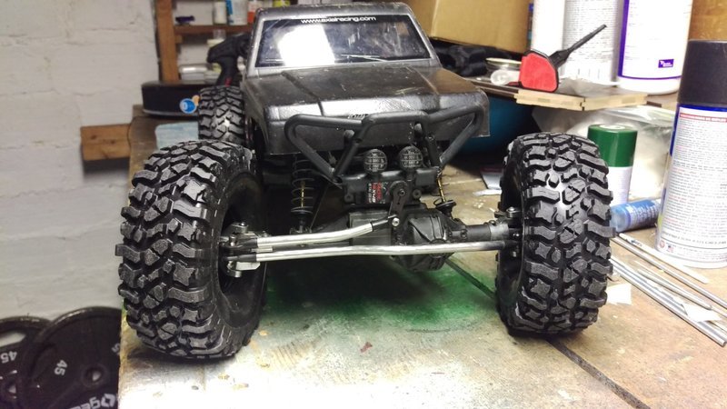

    As for the links, you will get stronger and better links by making your own.
    Traxxas Revo rod ends part# 5347
    8/32 all thread rod
    1/4 x .028 stainless steel tube (can be acquired at tower hobbies)
    Small pipe cutter or Dremel with cutting wheel
    patience
    And you will end up with this - you can also do this for steering and drag links:
