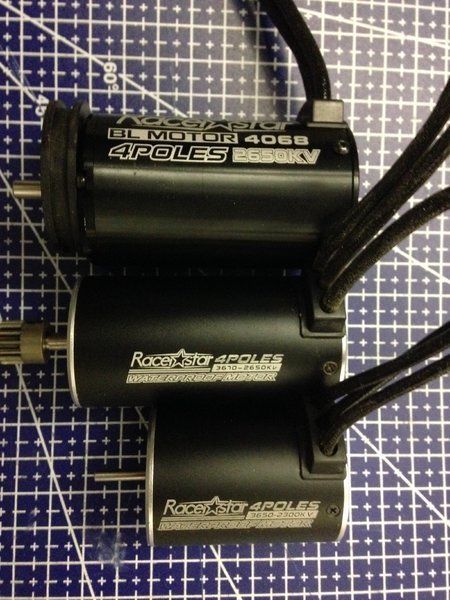

    Finally put this 4068 motor in my Bomber. Lol. It's got plenty of torque now.
    The bottom one is a regular 540 sized can. All cheap Chinese motors but have taken a fair amount of abuse. This brand ESCs are junk for a crawler, but pair the motors with something with a functional drag brake they do fine if geared properly.

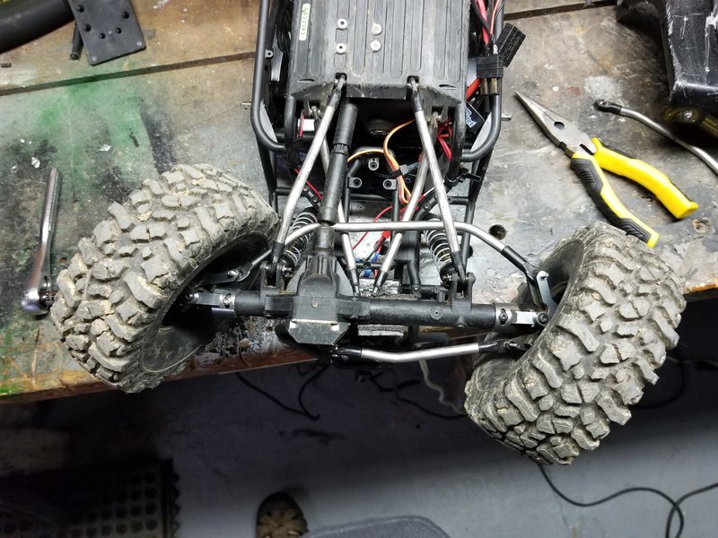

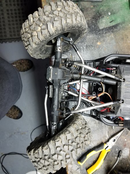

    I decided to try moving the steering link behind the axle yesterday. I think it gave me a bit more steering angle.
