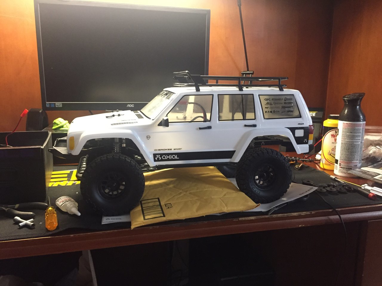

    image.jpg On the other hand, it's finished

    You don't want longer shocks

    How do I get more travel then?

    Longer shocks will do it if you set them up with a droop. IE: softer springs and/or a lift/droop kit set up in a droop configuration. But longer shocks will just increase ride height and raise the center of gravity leading to unnecessary rollovers.
    My Honcho came with 90mm shocks and with stock springs stayed extended fully under the weight of the rig. I swapped to 100mm Wraith shocks and lighter springs to induce a droop that had a lower ride height than the stock shocks/springs had. Rollovers at speed were prevalent but slow crawling ability was increased.

    You don't need it. Iv ran longer. And droop setups. Back to stock length with stiffer springs. You want stuffer springs in the rear also. Same with stiffer foams in the rear. A lot of other people seem to think otherwise and there wrong. It just looks cool with more flex that's all

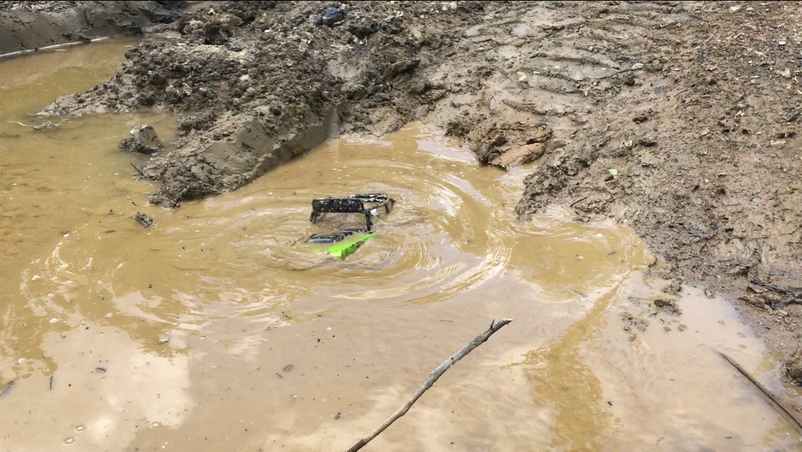

    I ran my bomber through some water. it was fun until the servo gave out and I had to replace it. probably just stay away now. it was also deep enough water though that the car was actually floating

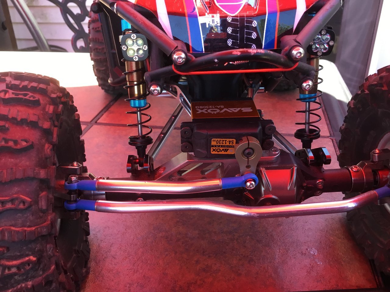

    This has been working well for me. I believe I got it on Amazon for around $70ish? I stripped out the original Tactic servo with all of the upgrades I have.
    More power means more stress/breaks...

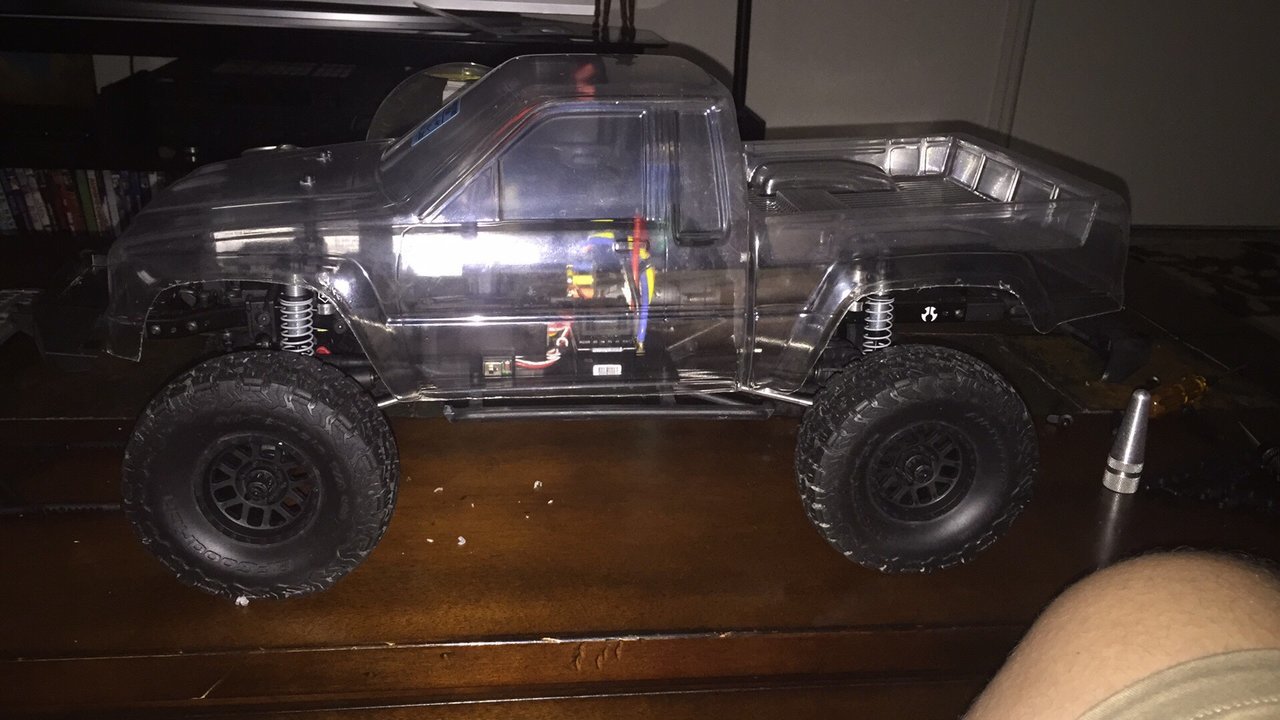

    51CB460A-E165-49A3-9BA5-0DDFEAC9AE8E.jpg Just about finished up trimming the '85 Sr5 shell. Is anyone else running this body in theirs? Curious what bumpers to go with... I can't use the factory ones because this shell has much more ground clearance in the rear, which I'm very happy with.

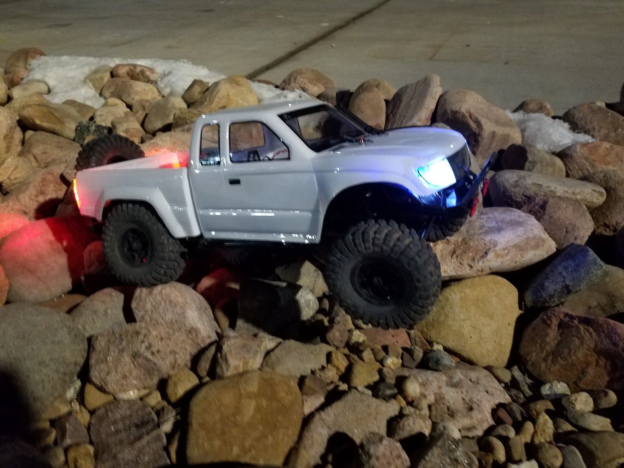

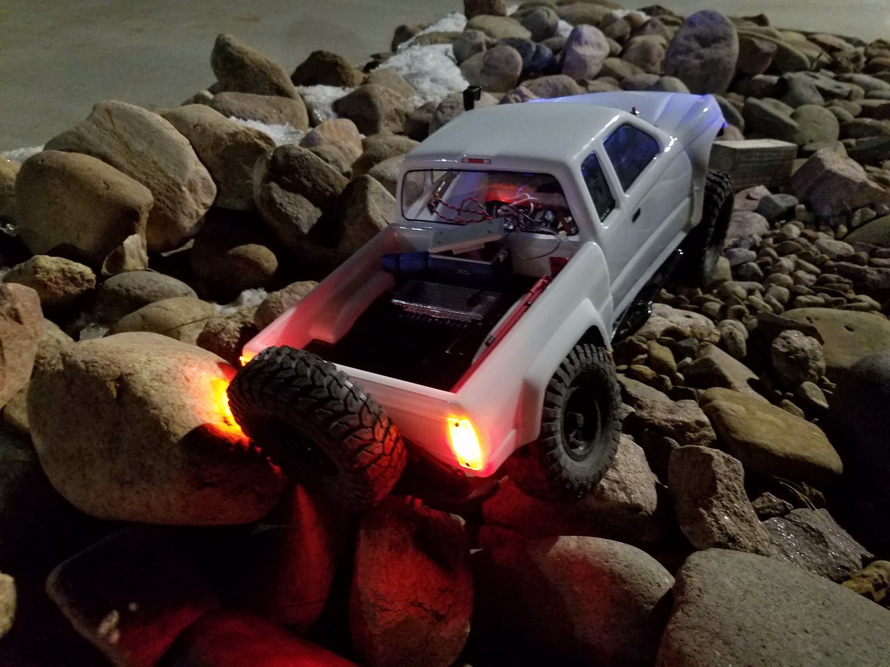

    I'm running the bed section with a Trail Honcho front to give it a more 2nd gen look. I'm actually using the Axial swingout rear bumper, my metal ScaleFab bumpers were too narrow.

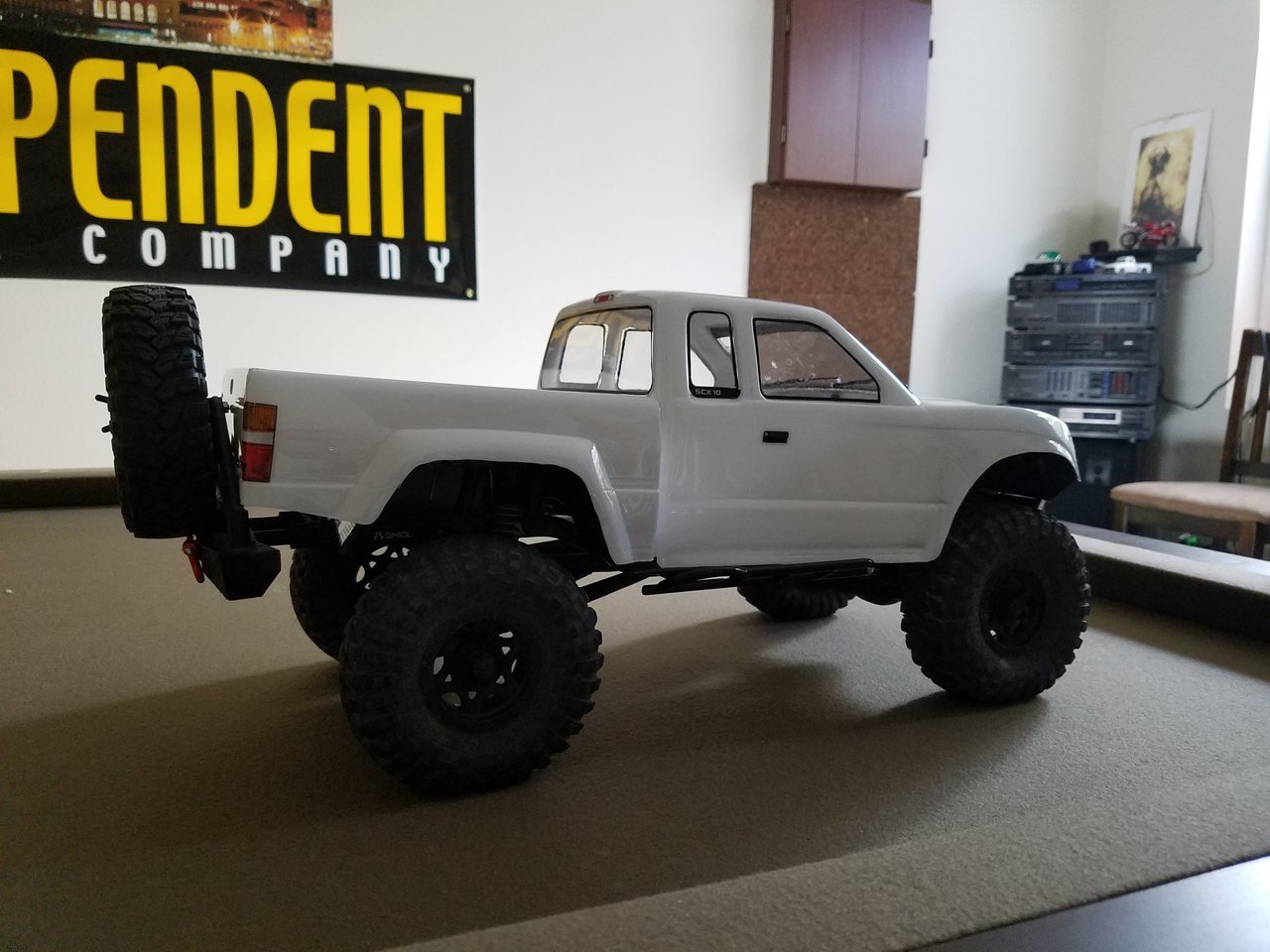

    The Axial swingout isn't the best fit. You can see below I need to extend it out. And it could go up a bit compared to the bed body line.
