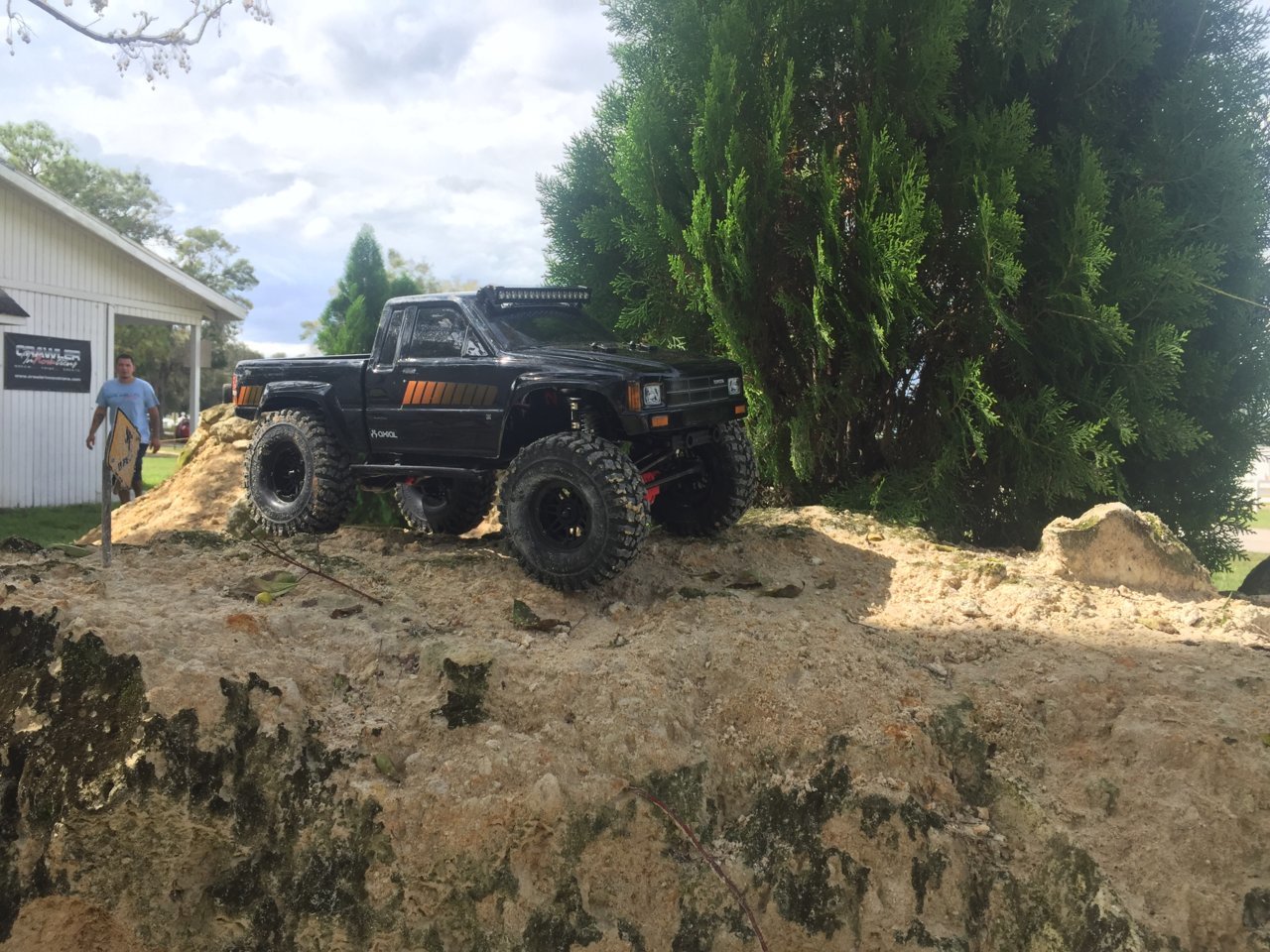

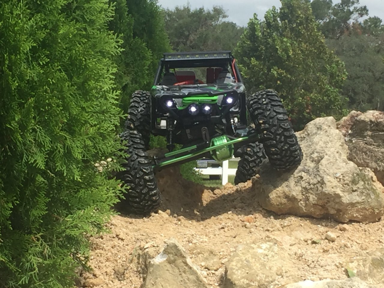

    Any pics? I’ve wanted to take on a hard shelled body instead of Lexan but afraid to do all that work then ruin it crawling or trailing. Here’s my two crawlers - I don’t really touch the SC truck or touring car anymore.

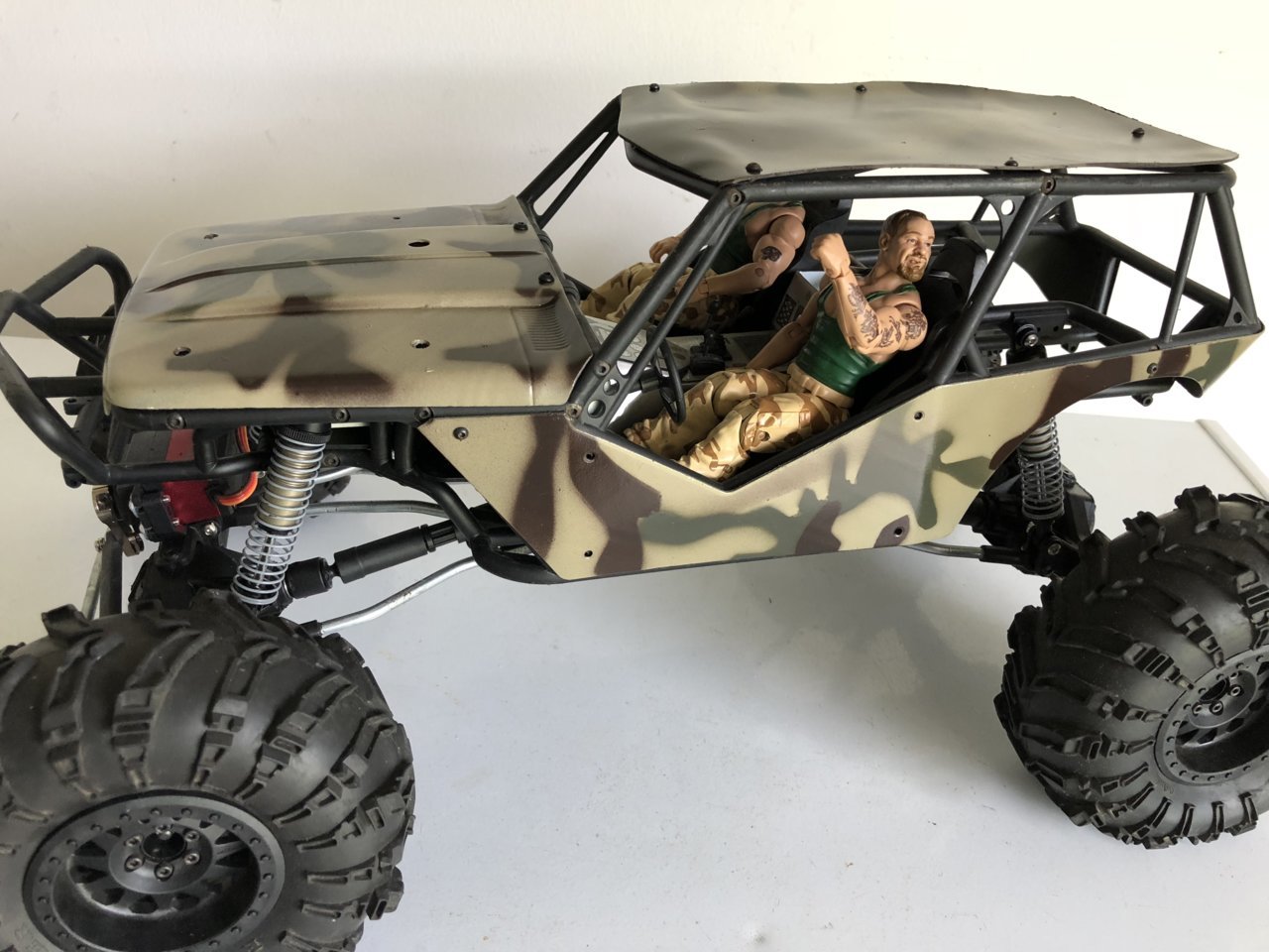

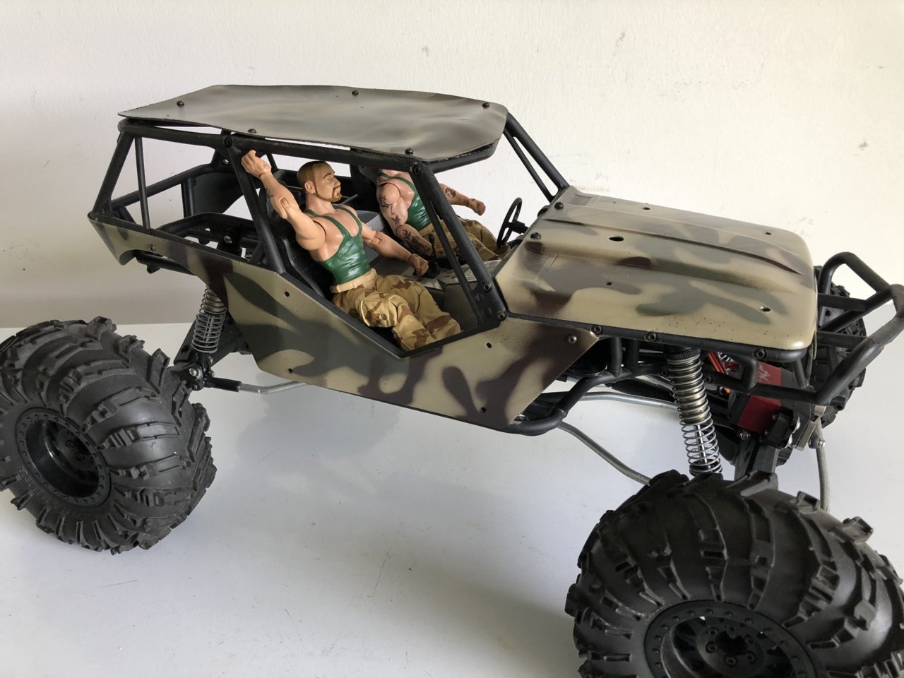

    Is that the Bushwackers driving?

    Hell yeah. No one recognized them out of the last 10 or so people that saw them. Mid South Wrastling at its greatest.

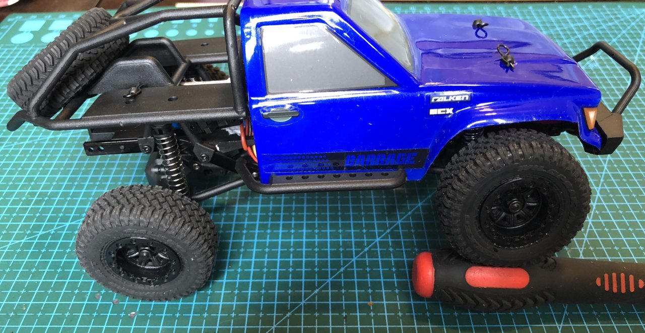

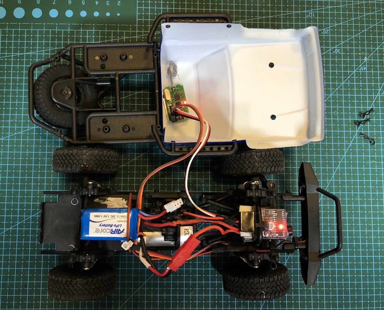

    All this micro talk made me open the box on my 6 month micro crawler. LOL. Sooooo...I finally dove off into my ECX Barrage today. I pulled the stock servo and RX/ESC combo. Replaced them with an MG90 as well as a 10a XYZ ESC. I’m currently using a dehoused Rx from one of my Axial products.
    I also pulled the side trim off of the flat bed while I was at it. Used an O ring to hold the ESC on top of the servo, stuck the Rx to the underside of the cab, and mid mounted the battery. I want the body as low as possible and there just wasn’t enough room for the battery on top of the servo so mid mount was the best I could do right now. I also trimmed the fenders just a little bit to make the lines flow as well remove the sharp corners where the tires make a little contact. The side trim and Rx/ESC was about the same weight as the battery if not more. I can get a weight if anyone cares.
    WHY IS THIS THING SO FAST!?!! It’s ridiculously tall geared and scoots around a little slower than my brushed 1/24 Losi Micro SCT. WTF? I may try putting the HBX(sumo) tranny in soon.
    Also, the outputs for the LEDs on the original Rx looked to be set at 5v. I’ll see what I can scrounge up to make them work again.
