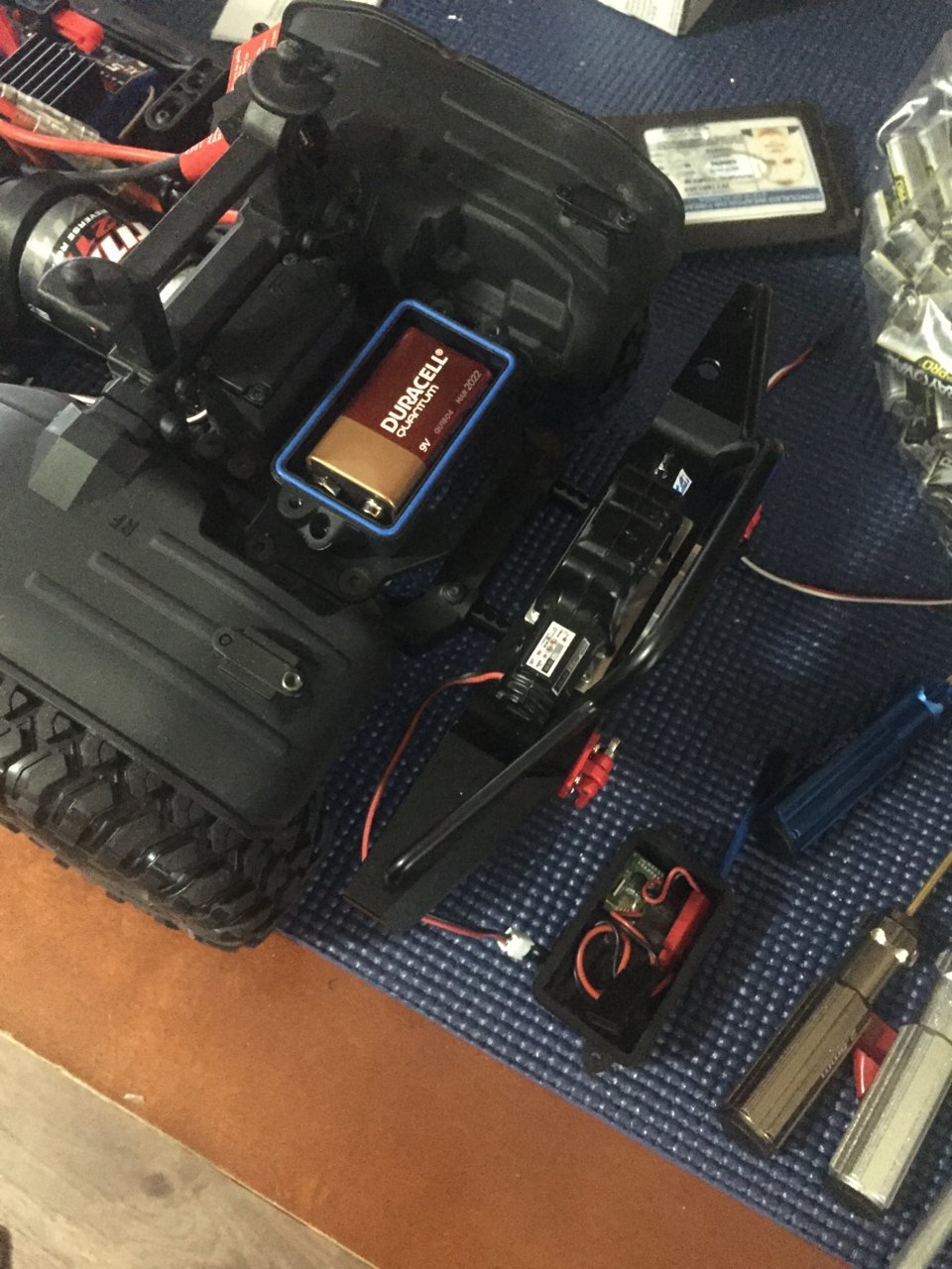

    Is anyone here good at shortening wires? I need a few wires to be shortened down to about an inch long. Will pay what I need to, they aren’t sold how I need them so could really use some help here! 9AE1F50F-7C95-4AC1-BB01-36577EB6D114.jpg

    Just cut the wires. Undo the connector takeout the pins and re install them at your required length Solder them if you like

    I’ve ruined to many wires, lol. I’d rather pay someone to do it.

    I wonder if you could disassemble the winch shorten the wires and resolder the wires to the circuit board?

    Anyone that can solder can shorten those wires. Don't over think it you can do it

    agreed. I am not great at soldering but I can get the job done on stuff like that just find a youtube video that makes sense and practice connecting a few scraps of wire before you do the job at hand.

    My suggestion get a useless circuit board, practice to de solder first. I use a bubble thing to desolder, squeeze and let it go once it gets flowy and it'll take off the old stuff. Then pre solder your wires a little, insert into circuit board and use a little more heat and done. Cut off any excess solder from the wire you put through the circuit. I personally prefer a soldering gun compared to a iron, just personal preference

    I think the best thing about a soldering station is that you can control the heat better than you can with a gun. The temperature remains constant too.
    I use a desoldering pump which is a bit different than a bulb. Does the same thing but easier to use (I think so).
    Soldering is a great skill to have and worth putting the effort into learning. If you have a 2gen, you can fix your temp display for example.
