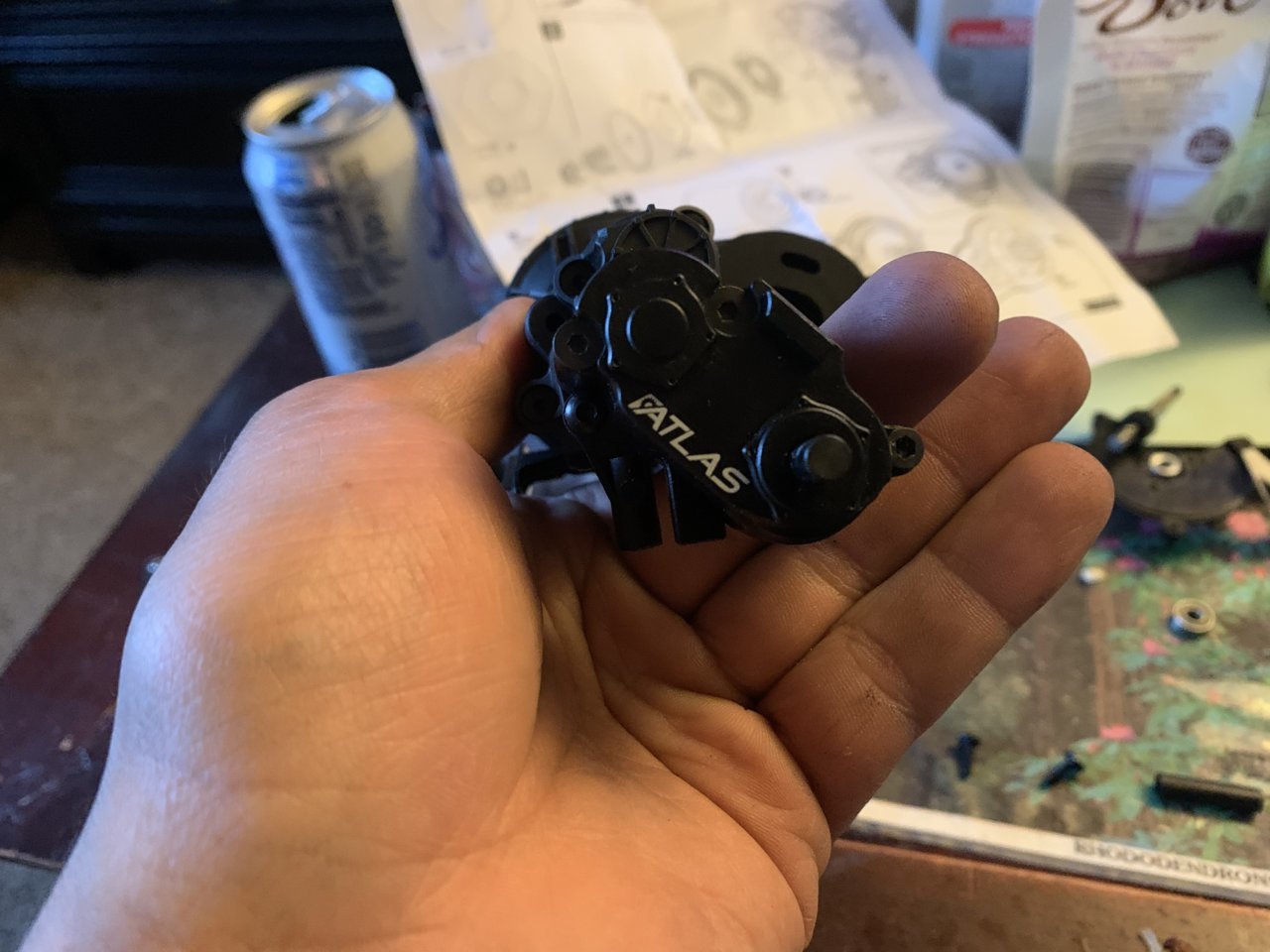

    I have both style axial transmission.kit and rtr. My rtr is all VP internals and never had a failure yet and my kit one has the VP atlas t case on it With metal axial gears. But im yet to test it

    I forgot they made that atlas case for the 10ii. They did a front bulkhead for a yeti too. Maybe with the bomber coming back out they will do something

    I have the other style of the atlas for the 3 gear as well. But it doesn’t work with a rtr 3 gear so it just sits in my basement

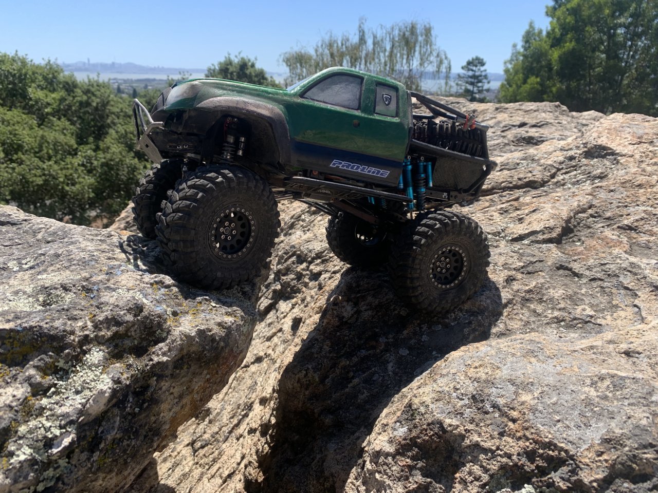

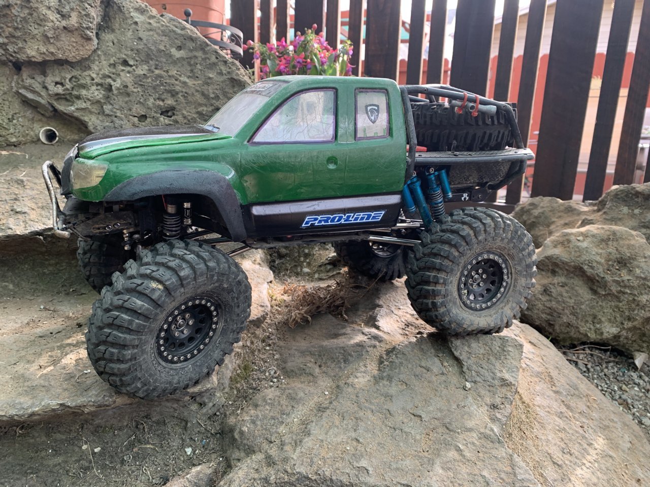

    Decided it was time for a little cosmetic work on the truck

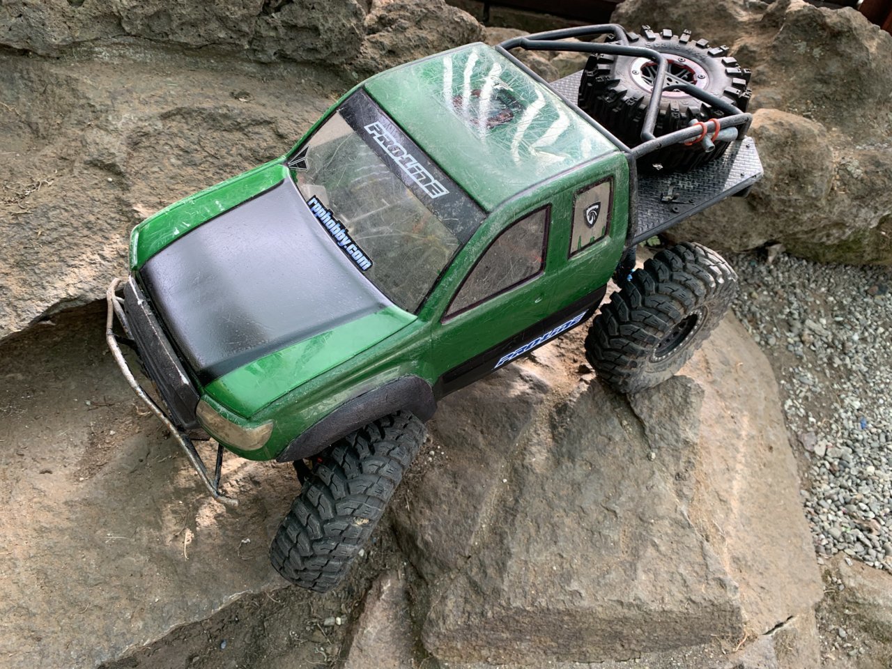

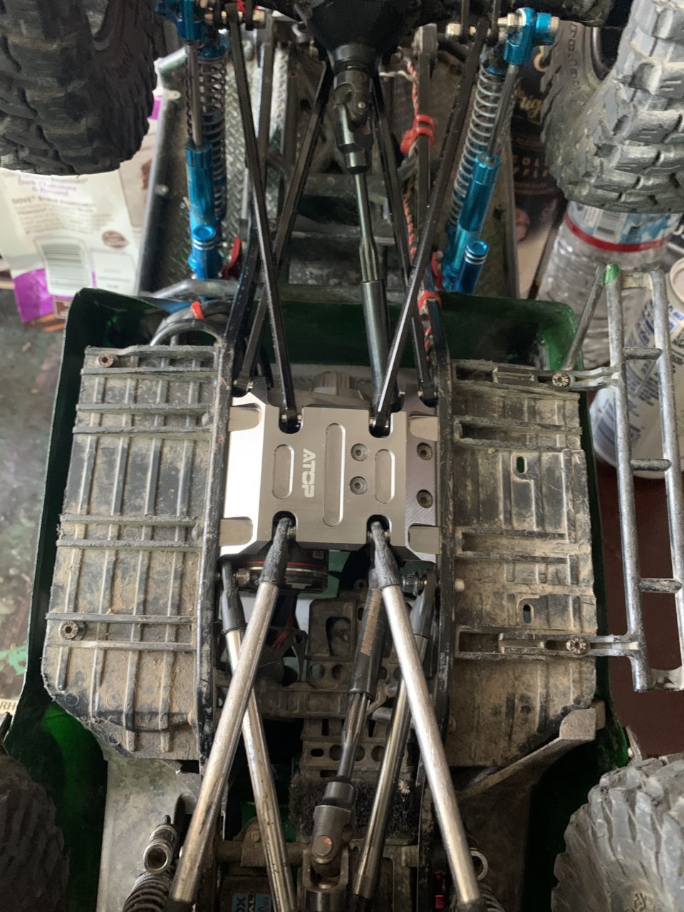

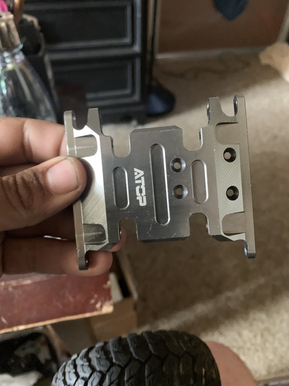

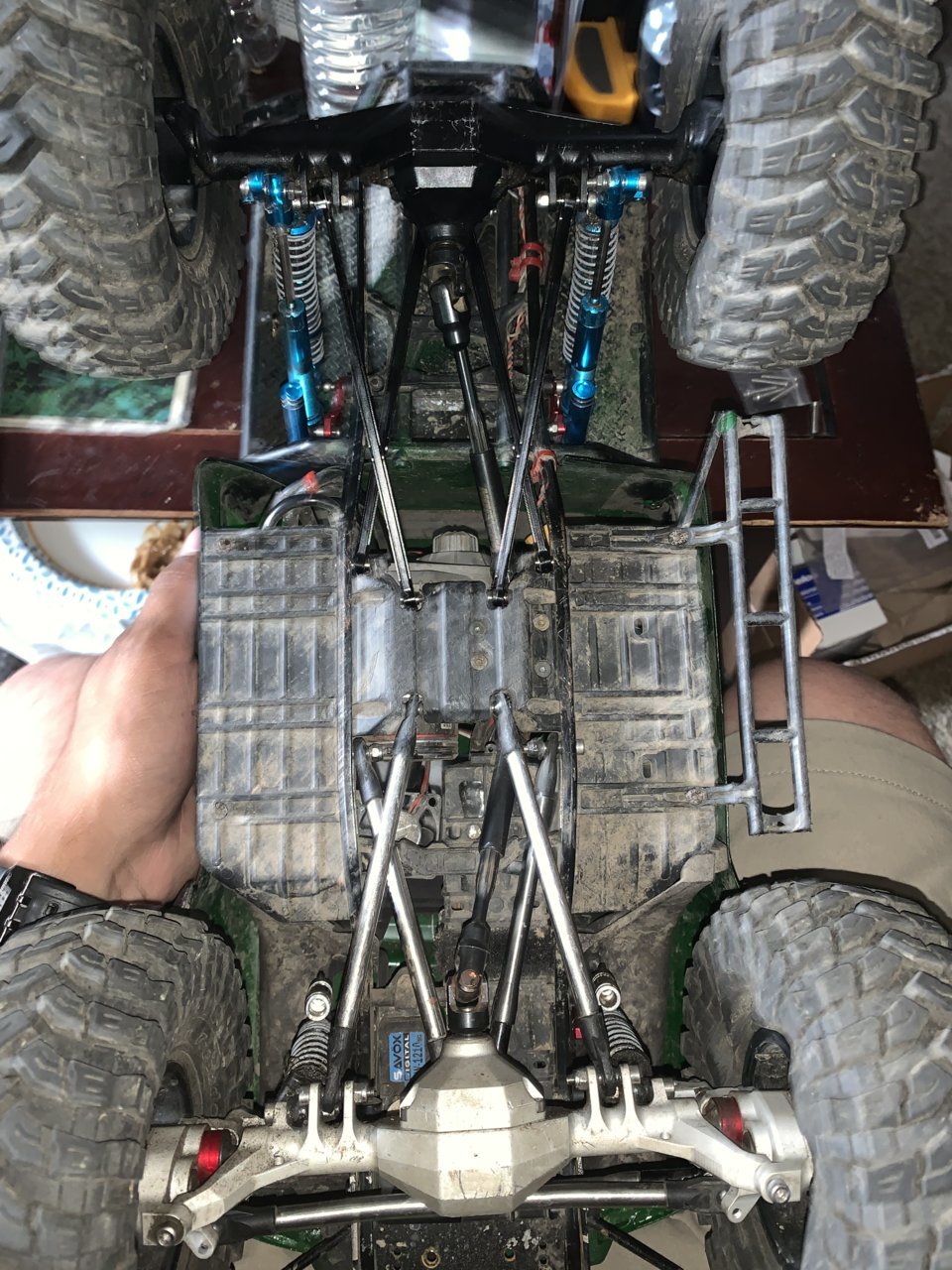

    Put the right skid plate in the IFS truck and replaced the stretched out links in the rear of the honcho. Maybe i should put the old skid in the honcho....

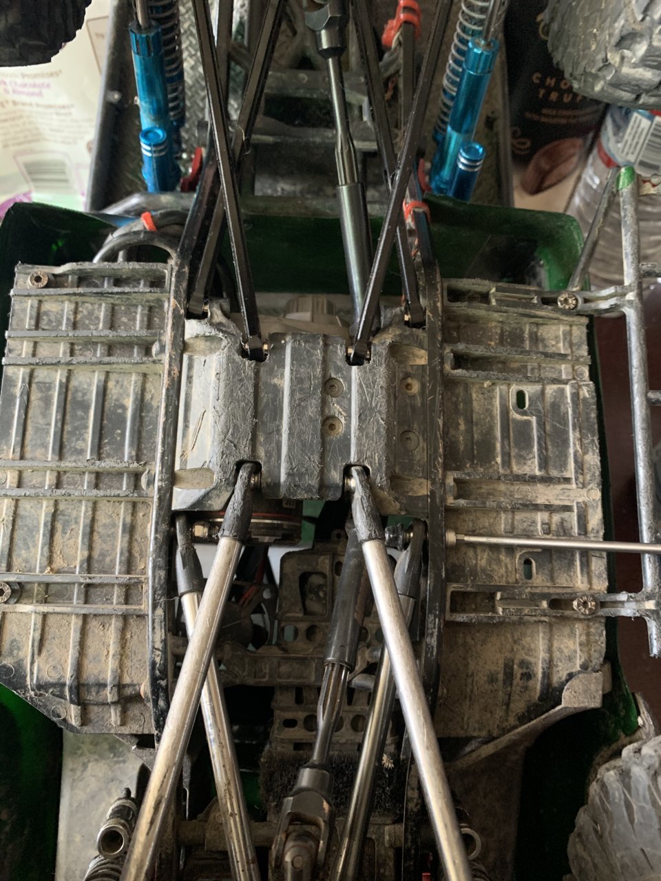

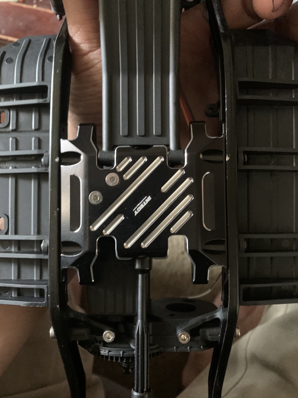

    Decided sense i have it ill put it in the honcho.

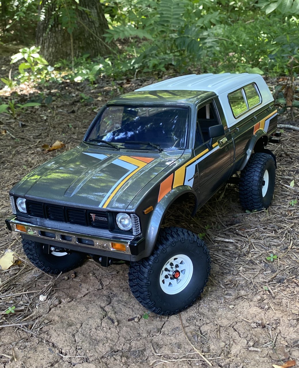

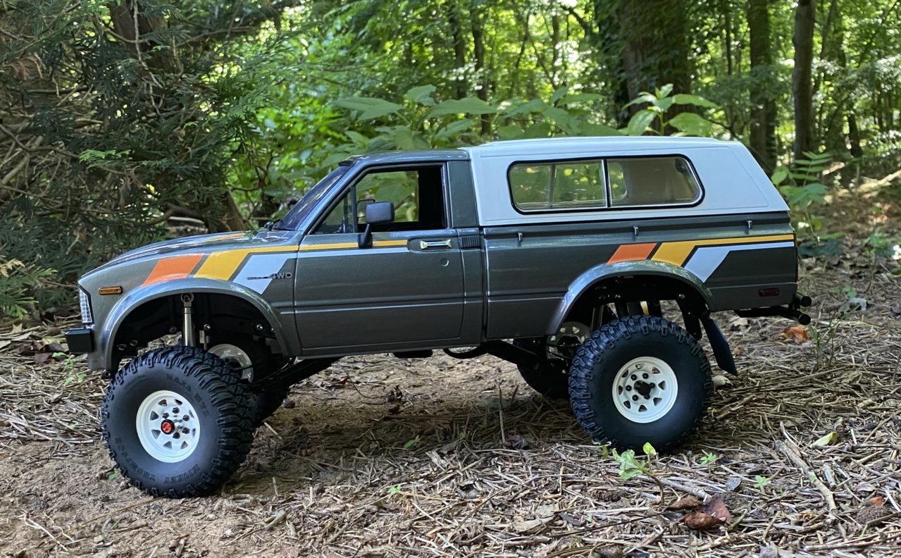

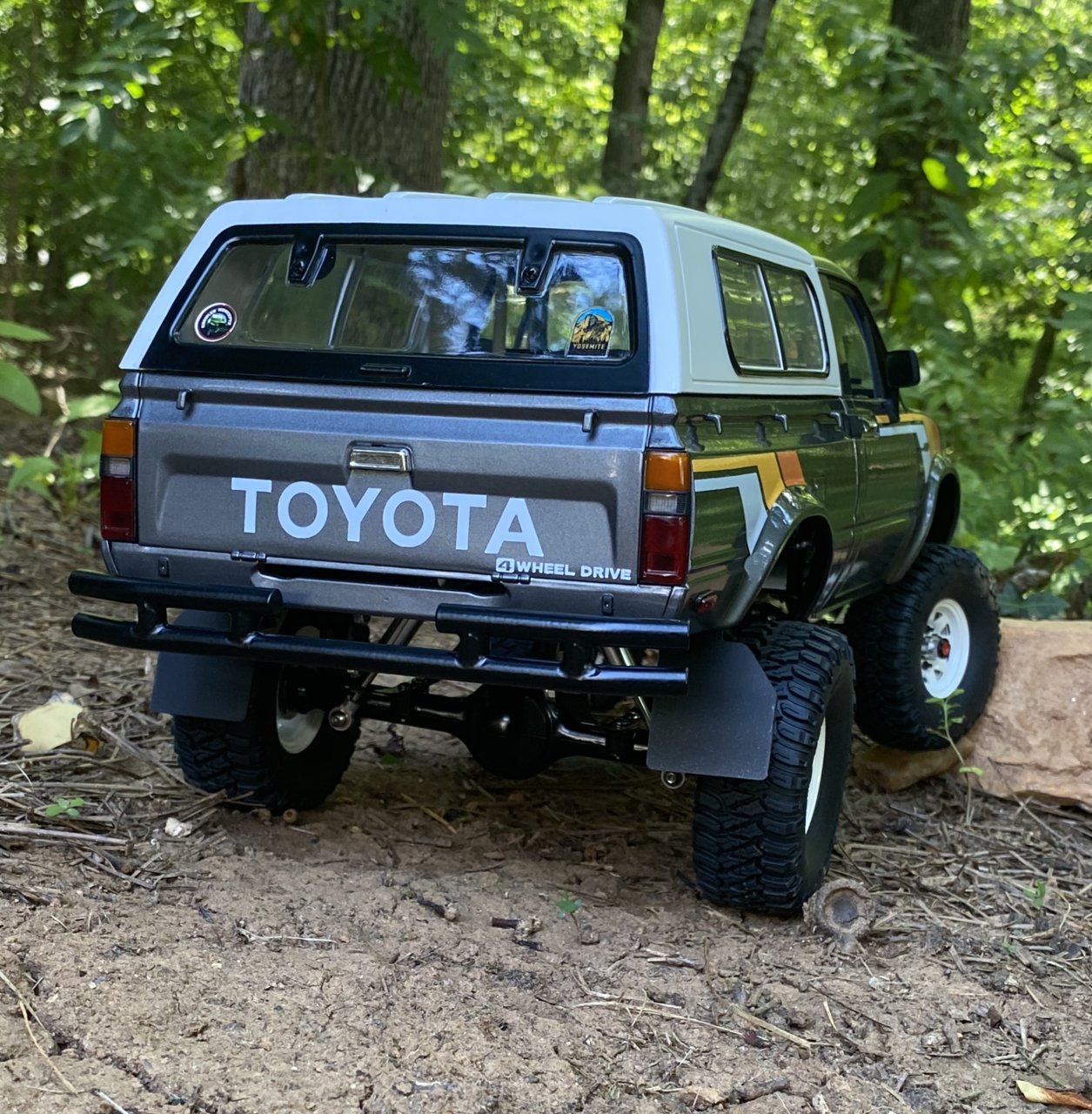

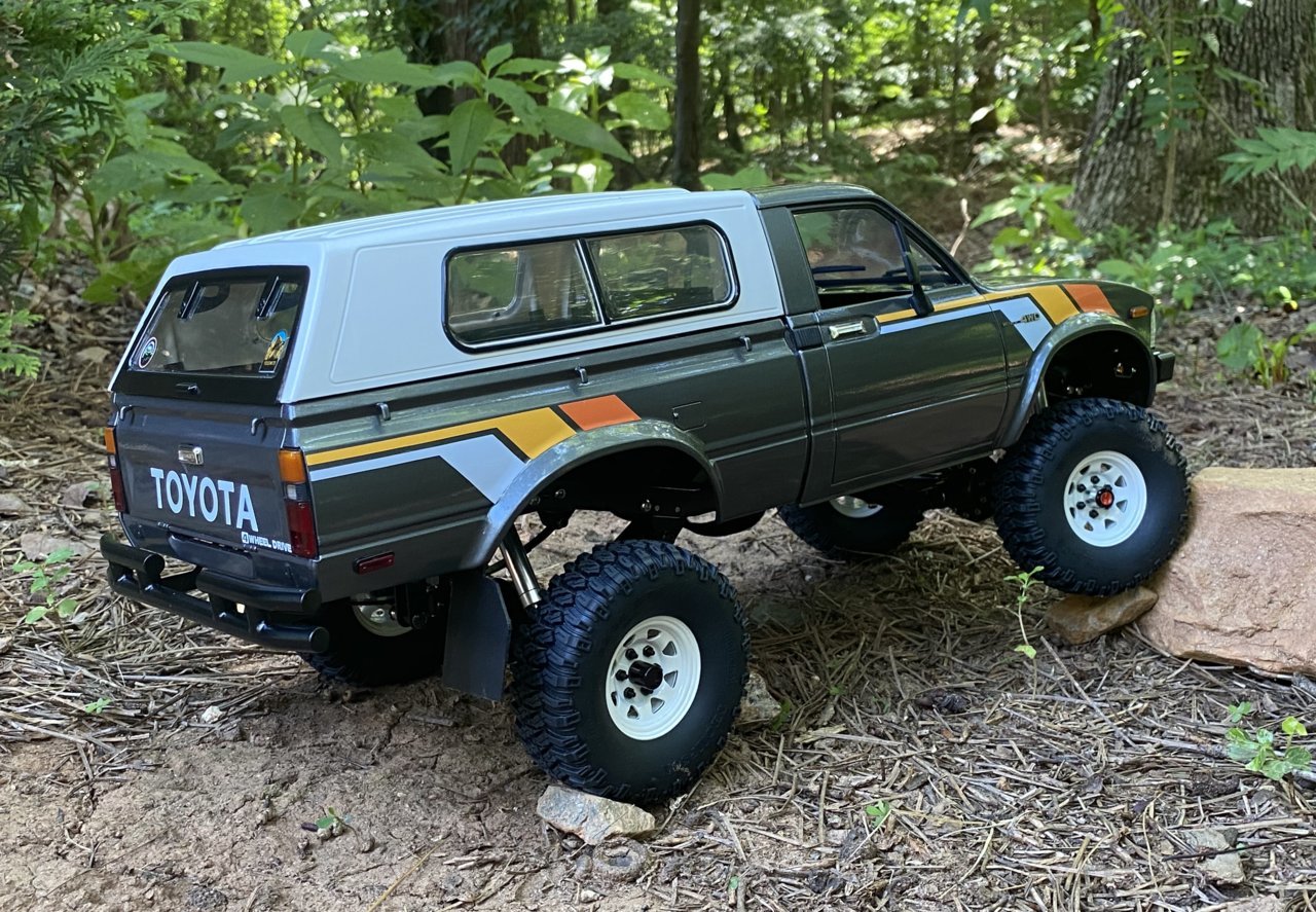

    A bunch of the same stuff everybody else has already done.

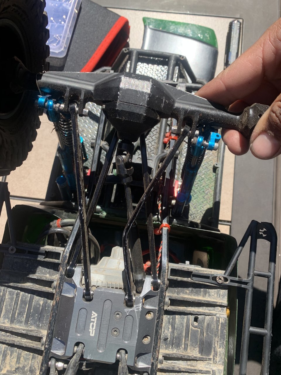

    You need to make some links. Order some stainless 5mm rod, m5 die, and Traxxas end links. Cut the rod to length and chuck it in a cordless drill. Drill it into the die to cut the threads and then screw the rod ends on. Easy peasy.
    Maybe can use 3/16" rod from the building supply and whatever standard die it fits.

    I have the old vanquish links. I just swapped in those cheap ones because they looked kinda cool and i was to lazy to change ends on the vanquish. But i just replaced the bent one with a traxxis ends and vanquish rod.
    I been thinking of making custom ones so i can stretch the wheel base though. I wanna push the front axle out
