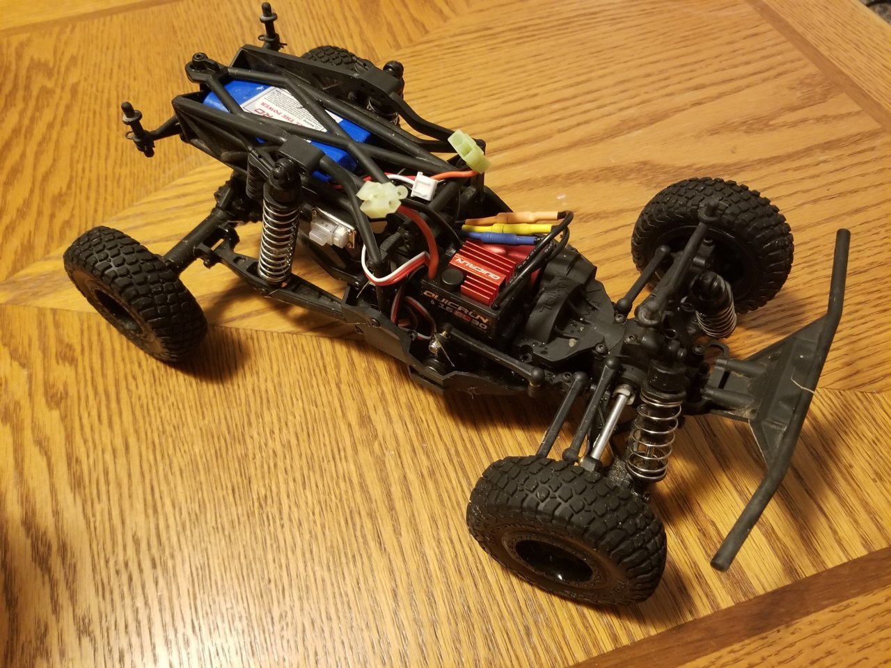

    Well, after 8 months my yeti jr score truck had an electronic failure, so I finally got the chance to go brushless. While I expected it do die early on (hence why it was discontinued), it lasted way longer than I expected. The stock brushed motor was reasonable, but now with a hobbywing 16BL30 esc and 2435 motor it rips. I also picked up a new 7 channel radiolink remote for the crawlers, but it has gyro functions too which is nice for the fast stuff, especially the yeti jr since it didn't have that from the factory. I already have a 3s lipo on the way, but I'm scared to try it with how fast it already is on a 2s. I also get the feeling there will be lots of breakage with the step up in power. I think the yeti jr is going to get really expensive really quick.

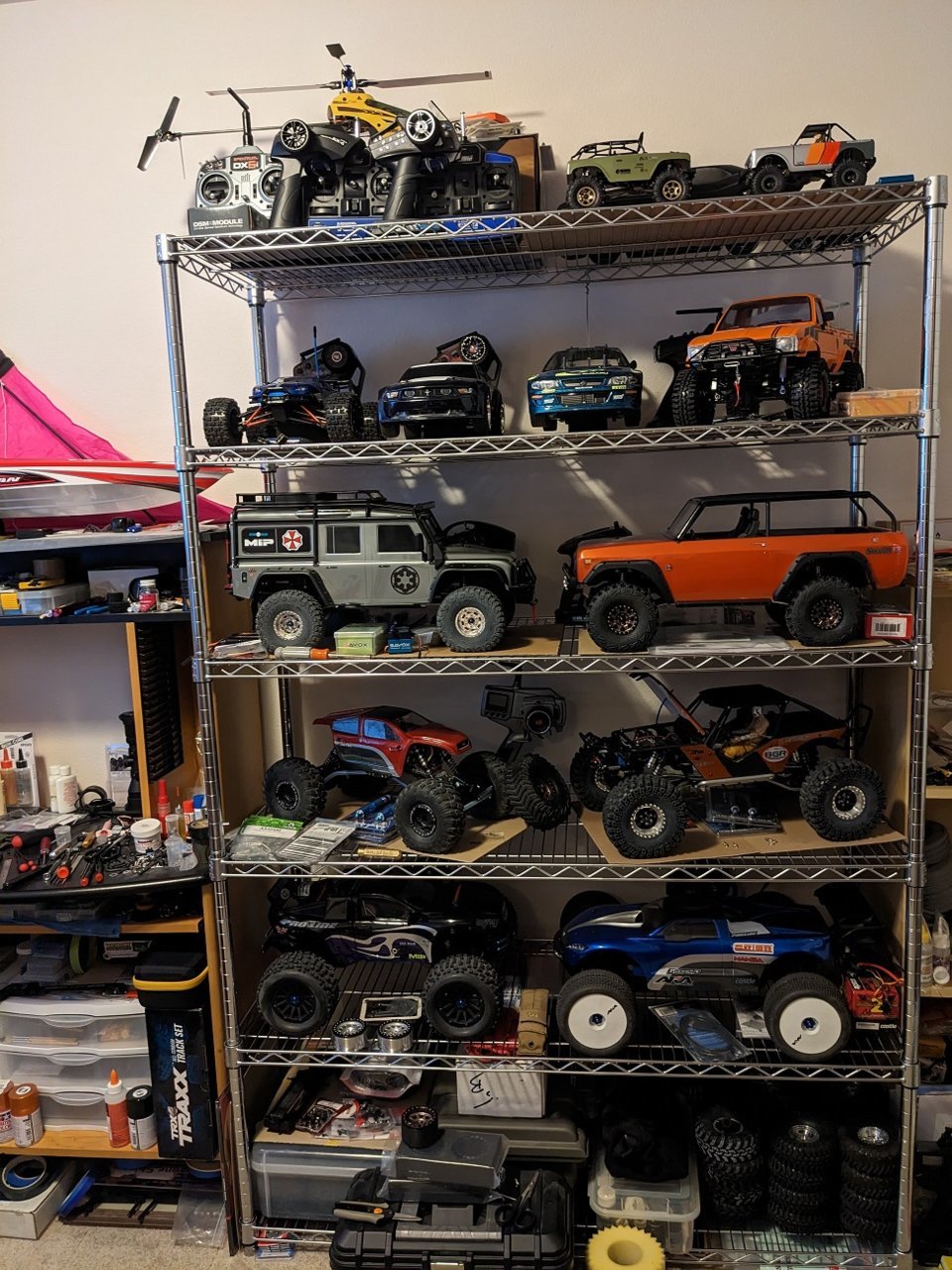

    I might have a small problem...
    I have added at least 6 more since I took these pictures... 2 Rustler 4x4s, another Stampede 4x4, Slash 4x4, 4tec on road car, and the re-release of the Baja 5b Gaser.

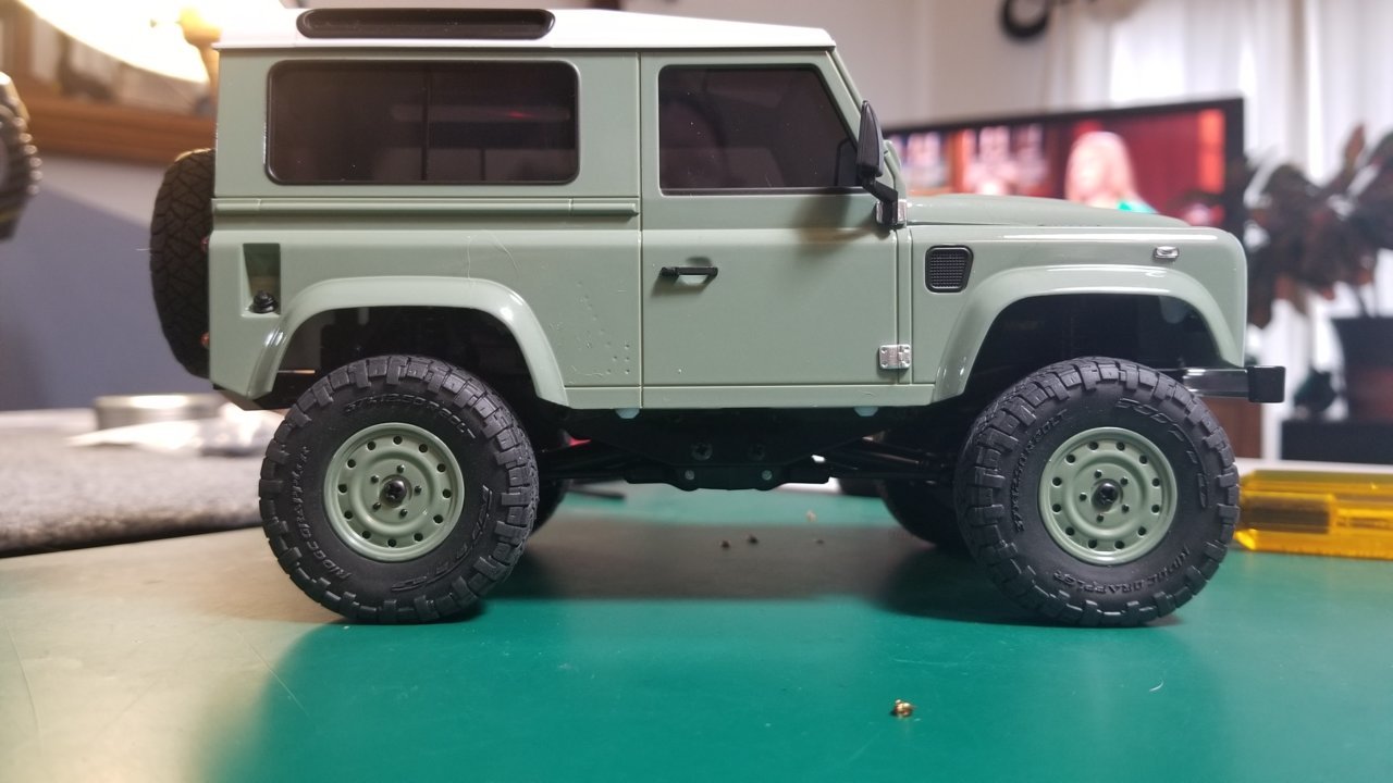

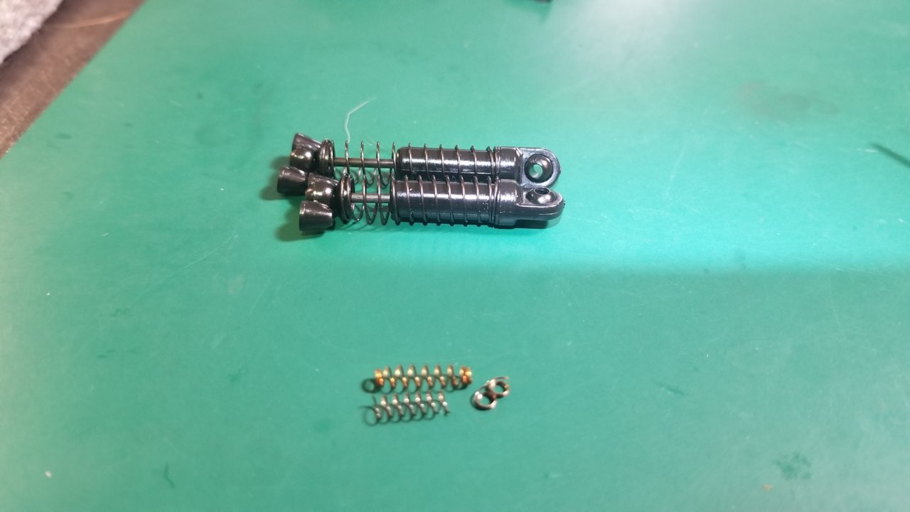

    Was not entirely happy with the Mini Z stock shocks and they way they bounced as well as the overall height, so I installed a tiny spring inside to pull them down but still allow close to full extension.
    The top spring is what is installed in the pic, the trimmed spring is what i installed in the next pic. The extra coils on the ends inhibited the extension quite a bit.
    Trimmed spring installed. Shocks are about 4-5mm shorter at rest and only lost 1mm of full extension.
    the top spring is what was in there and you can see how it collapsed when i pulled on it for testing.
    Overall ride height looks much better, has about 6-7mm of up travel now, links sit close to flat and lost the torque twist on acceleration. a bit less bouncy as well.

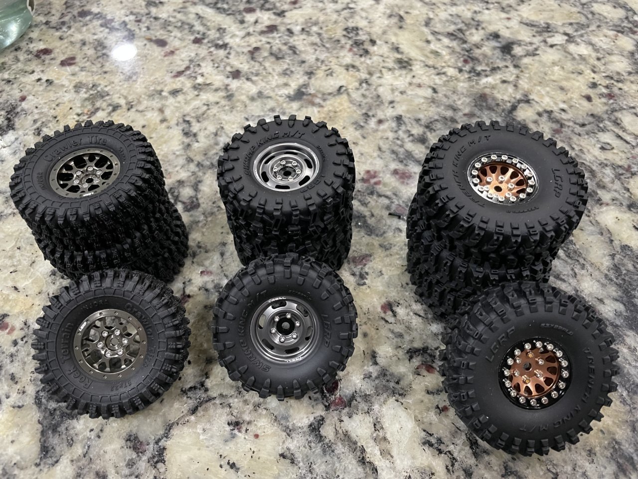

    Fresh set of meats to swap out on the trx4m’s/scx24.
