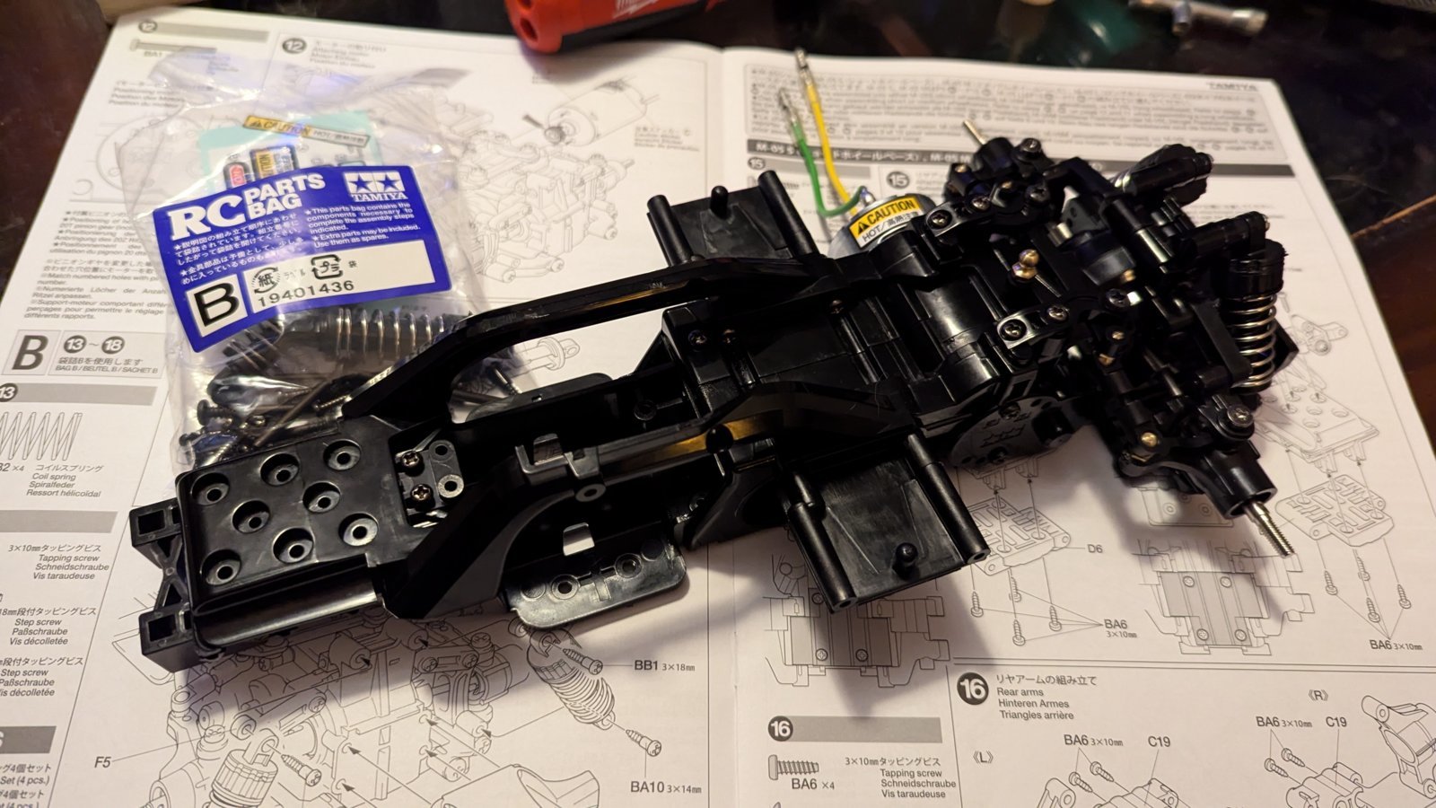

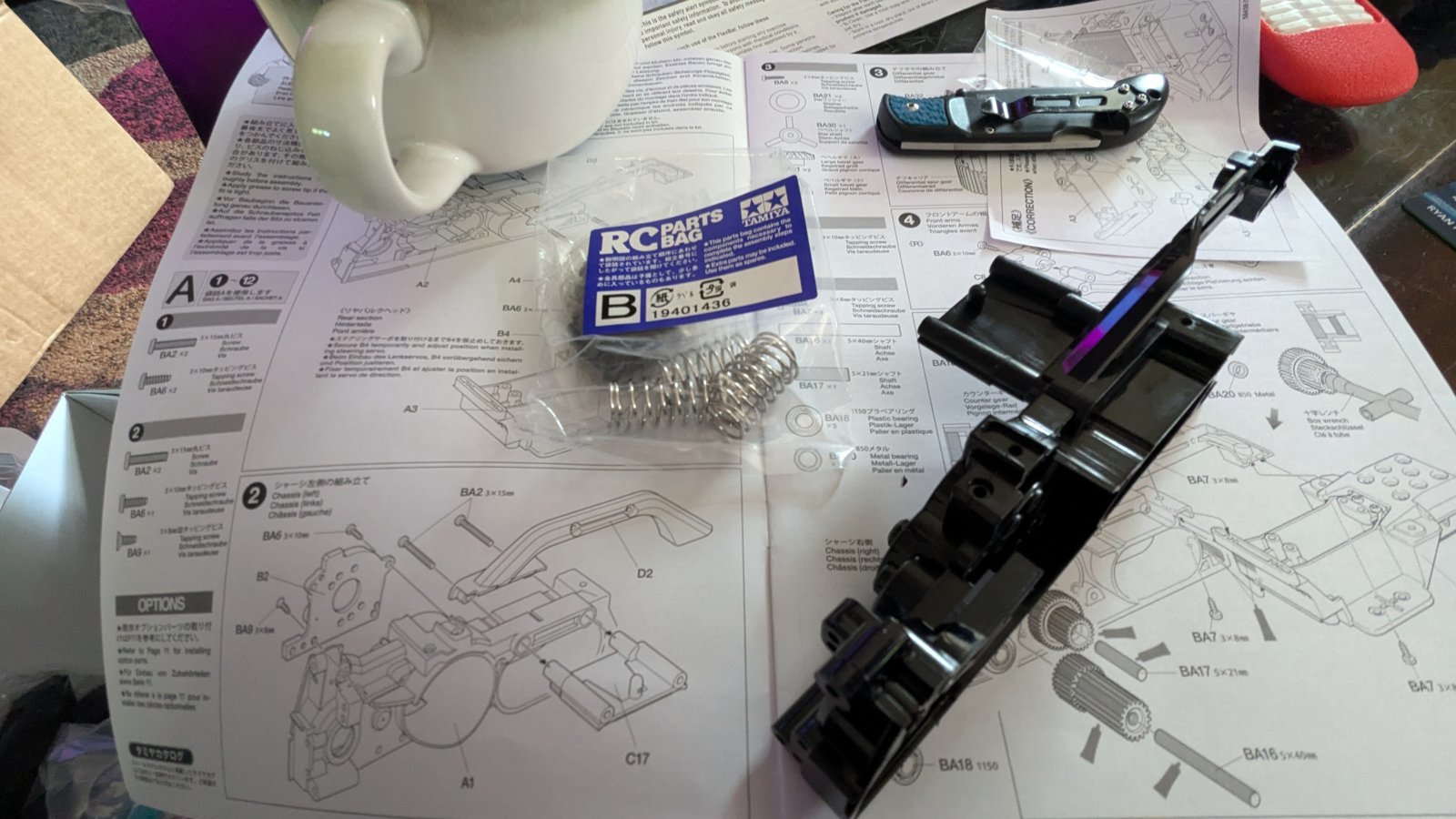

    Old School Tamiya Kits are the BEST!!!! I hate the fact that almost all of the cars in the RC world now come ready to run. They should be like they were back in the olden days when we had to put them together so we knew exactly how to be able to fix it when it did break. We could tear apart a differential, we could fix suspension, we could upgrade the entire ESC unit and battery system. Putting it together was half the fun.

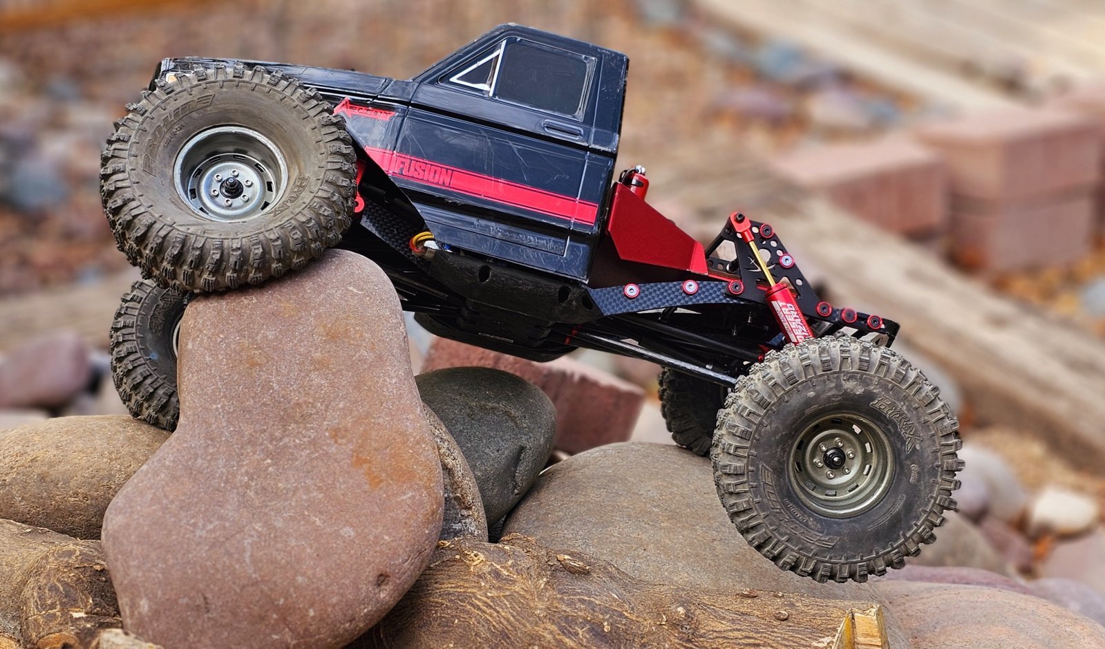

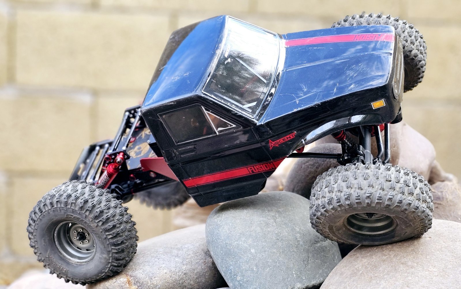

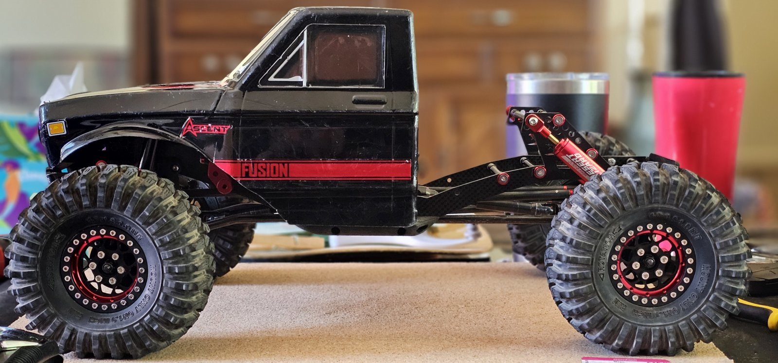

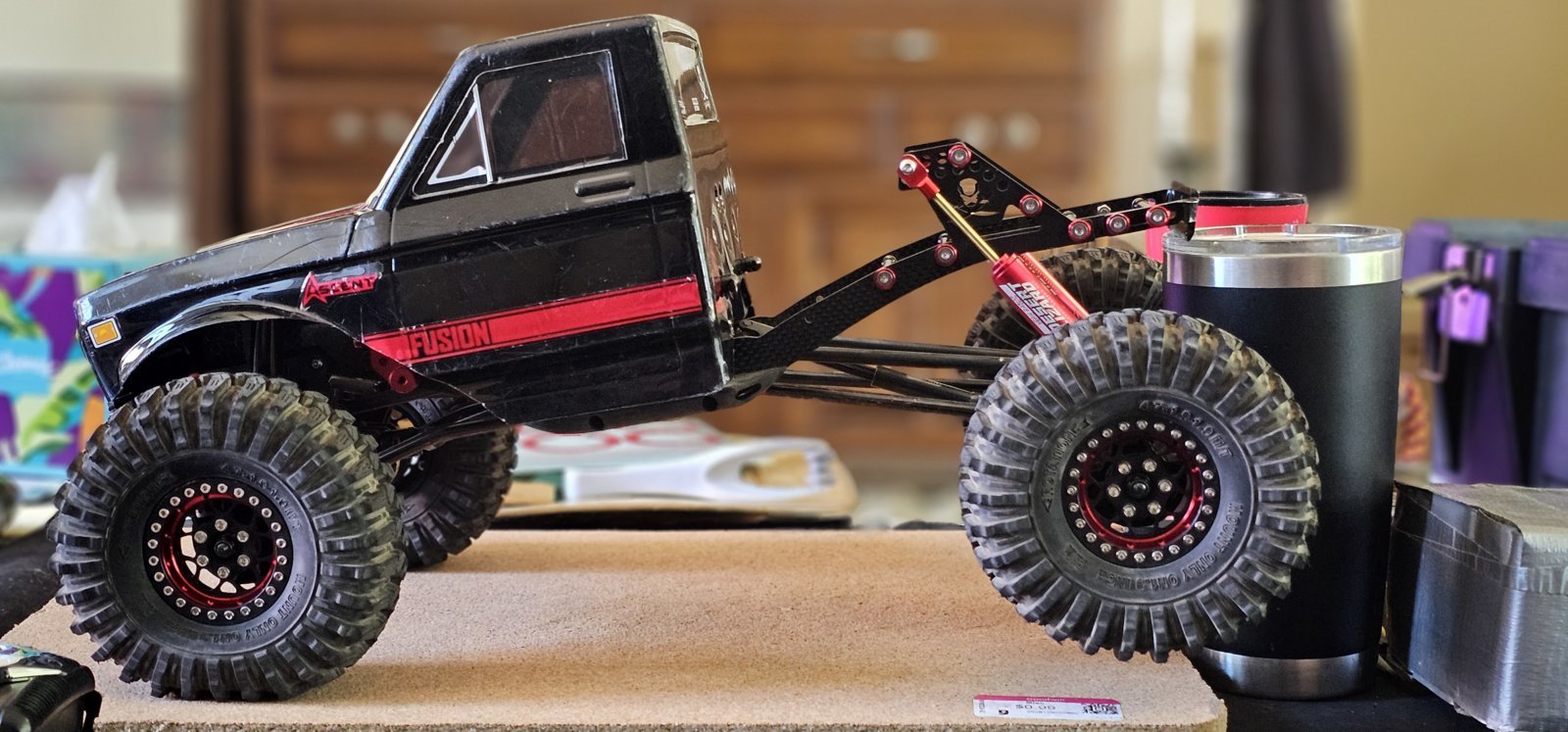

    I'm no expert on shocks but I am retired and have way to much time on my hands. I've had excellent results with a semi-droop set up with Desert Lizard shocks.
    I use soft springs top and bottom on the rear of my Ascent Fusion. I've seen my rear shocks kind carry and not fully extend on side hills. The shocks will fully extend when doing "frame twisters" or whatever they're called in your neck of the woods. I have some 60wt shock oil coming so I can get some of the bounce out of the short top/compression springs. Either way I'm a proponent of semi-droop for my environment.
    One more thing that really calmed my rig down was extending my wheelbase from 313mm to 322mm. It seemed to be top heavy and the articulation was not really optimized. That said that all this is being said right now and subject to change on a whim. :burp:

    Would your shock angle have anything to do with the droop limit in certain scenarios, such as the side-hilling mentioned?

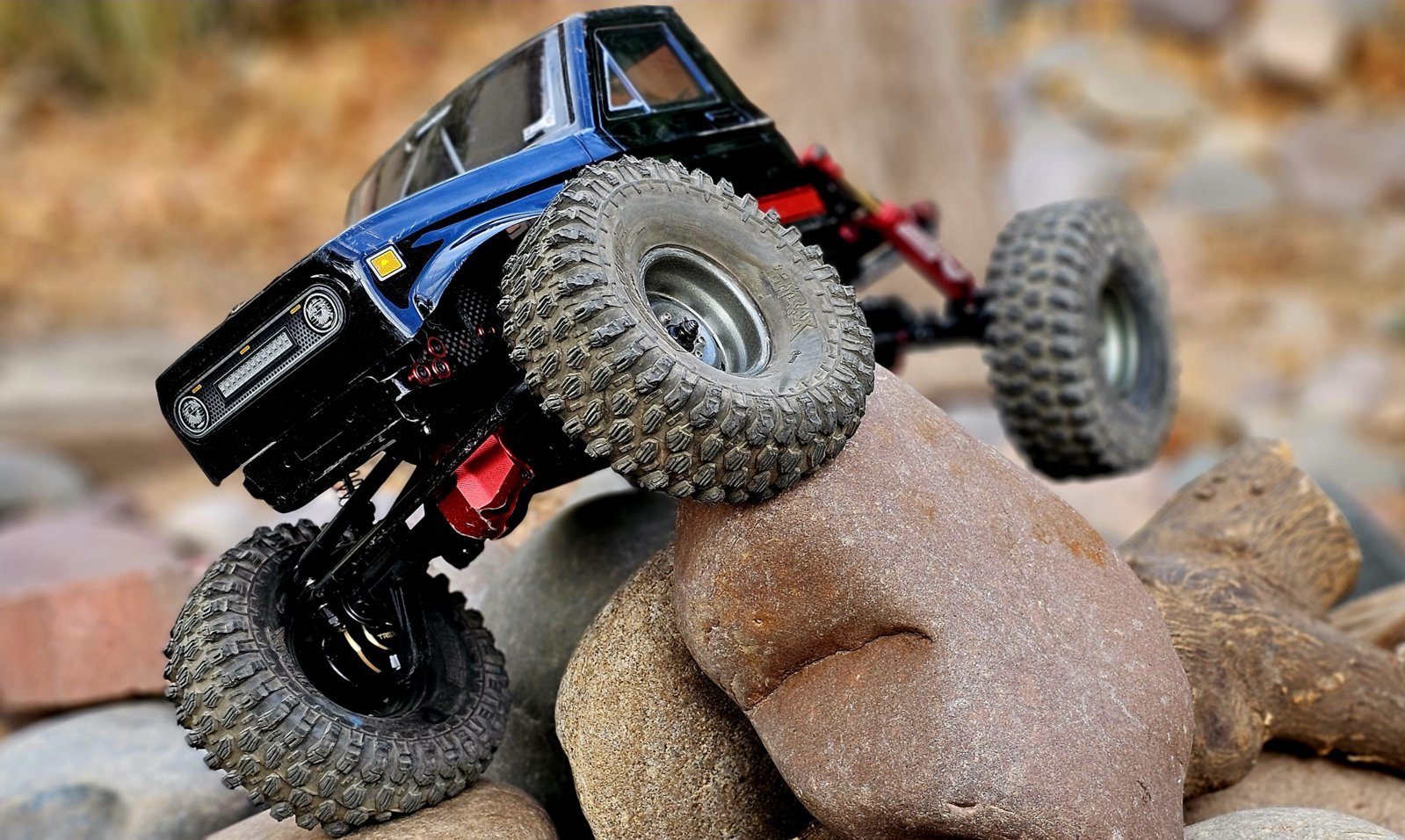

    No, it looks to me to be more of the load on the front shocks and the angle of the front axle that determines whether it does it. Here's a picture where it doesn't extend fully.
    Edit; Upon looking closer at these pictures maybe you're right? It is a pretty steep angle on the front. I feel the longer spring is definitely pulling the weight down as best it can. Maybe I'll try some medium springs on there and see if it pulls down more. I have the time. :thumbsup:
