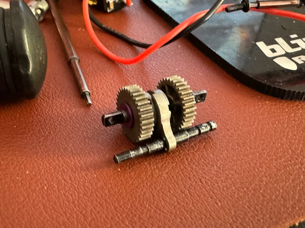

    What's the issue with it? I swapped the metal gears into mine and it wouldn't go into first gear. The shift fork wasn't pushing the selector into the first gear mechanism far enough, so I put a shim under the 1st gear gear and it works fine now:
    (sorry for the blurry picture)

    Sounds like a similar issue but it doesn't go into either gear and/or gets lost in-between them. Seems like something just doesn't line up. How thick was the shim? I've read a bunch about the FMS metal gears being too thick but never too thin

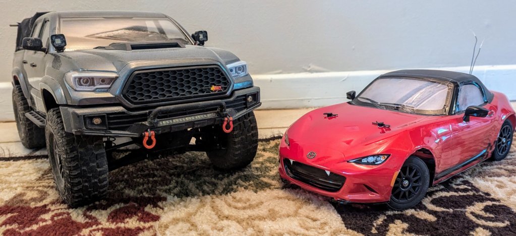

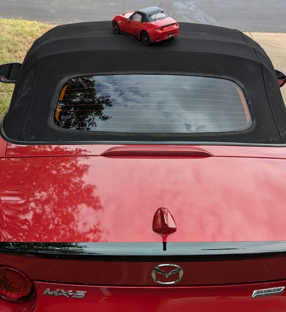

    Well, shoot.
    Everything you could do wrong when trimming, painting, and decaling a shell, I did wrong. :anonymous::anonymous::anonymous:
    After painting, stripping, painting again, and still doing bad, I think I salvaged it enough to be passable. That is at least until I decide to buy a spare shell and new paint.
    Still, this thing is a laugh riot. I was not happy that it only fits a FWD chassis, but it still skids and does donuts if I want it to. I'm happy with its handling for something I put zero upgrades in.

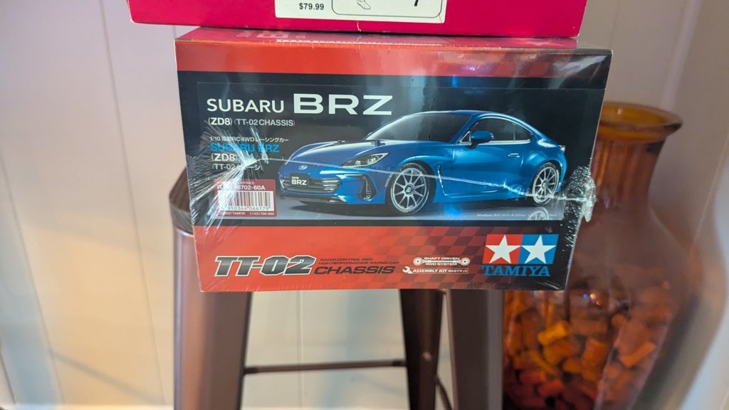

    Next up in my goofy "miniaturize the garage" project: The wife's car proved to be more difficult to find. It exists, but the kit has been out of production for a few years. I did find a blank shell on eBay, so that will be the next build. It's getting mated to the 4wd chassis in this BRZ kit.
    Hafaday, Roody, Bikinaz and 1 other person like this.

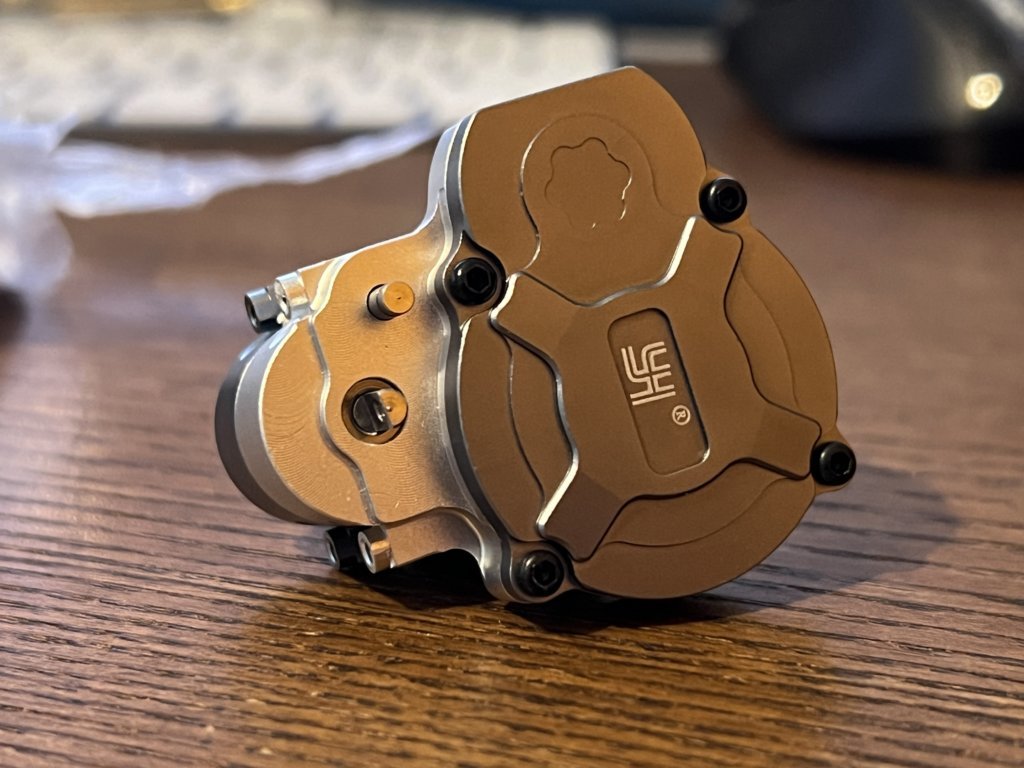

    Here’s the FCX24 replacement gearbox. Feels nice and heavy, just need to put the Injora motor into it and should be ready for install into the chassis. Even came with the metal shift arm. Updates to come…

    Looking good! There are a LOT of other m-scale chassis you can put that Miata body on. FYI, the traditional Tamiya m-scale chassis with odd numbers are FWD and even are RWD. You can get an M-06 or the newer M-08 and have a a RWD platform if you'd like. If you want to go with a low-cost RWD chassis, MST has a few m-scale platforms including a drift chassis. There are numerous AWD chassis out there, too. I'm building my Miata replica on a 3Racing Sakura m-scale AWD chassis.

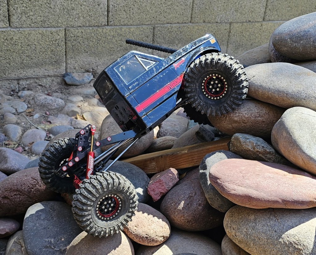

    Finally got my rod ends to go with my new rear links. I'm sitting at 321mm for my wheelbase. :)
