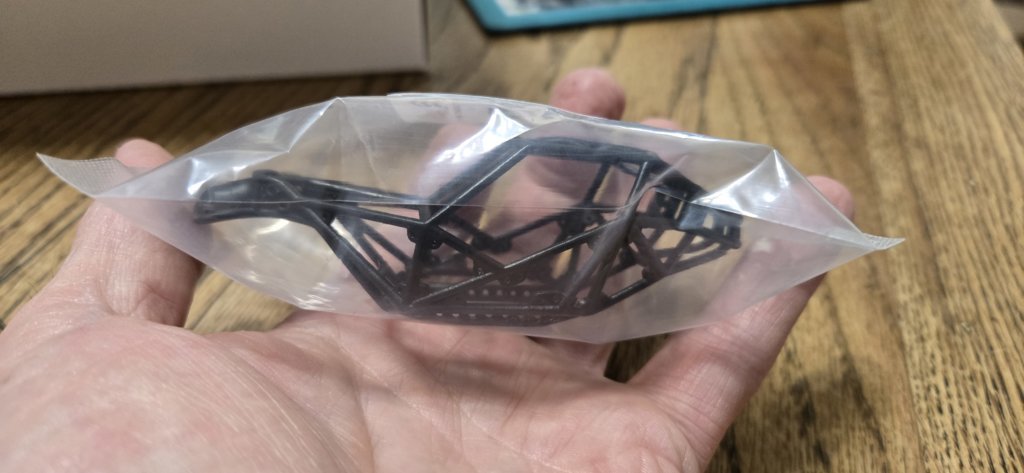

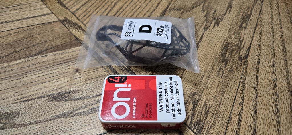

    Holy Chit it's tiny!
    Better size reference

    Rock bouncer build?

    Yep. But with a 300 rpm motor, so maybe more of a crawler. Motors range from 150rpm to 3000rpm, with 500 to 1000 being the sweet spot. None of those are in stock anywhere.

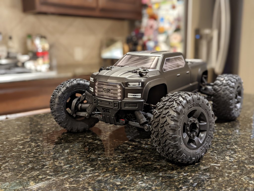

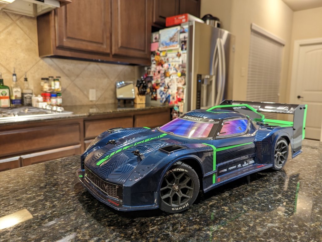

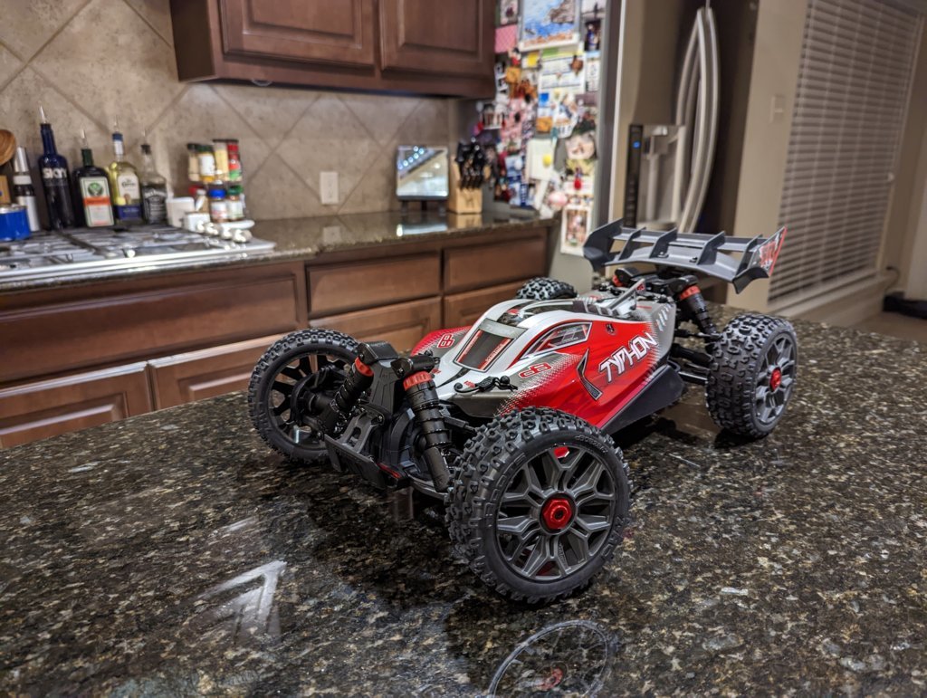

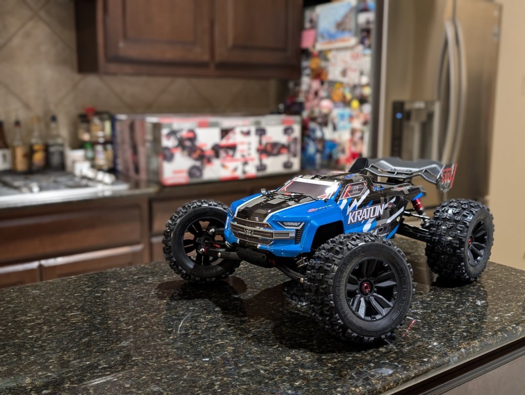

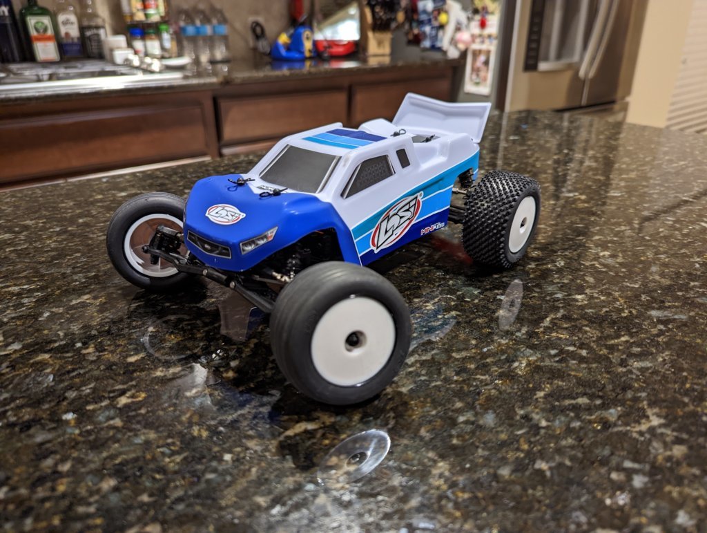

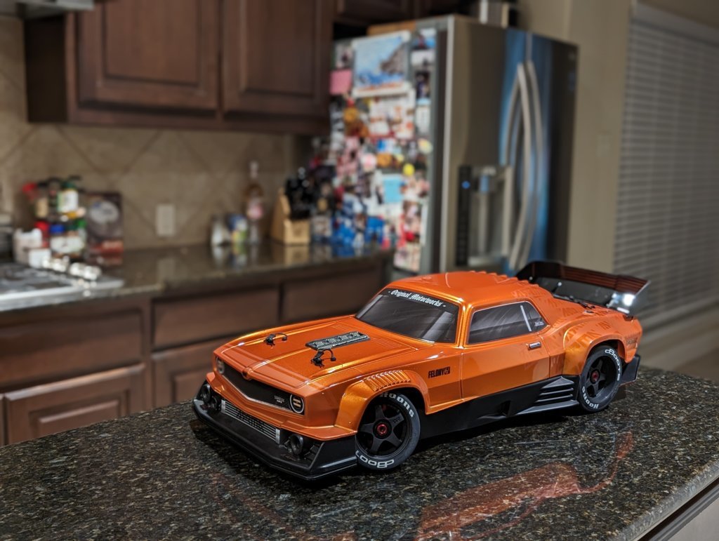

    In. I don't have time to mess around with them all the time but I have a few. Mainly arrma stuff.
    6s kraton
    6s felony
    2x 3s vendettas (one was on sale cheaper than replacement parts cost)
    3s big rock
    3s typhon
    Losi mini-t brushless
    There's a sale on the 6s big rock and fire team and I'm tempted but running out of space

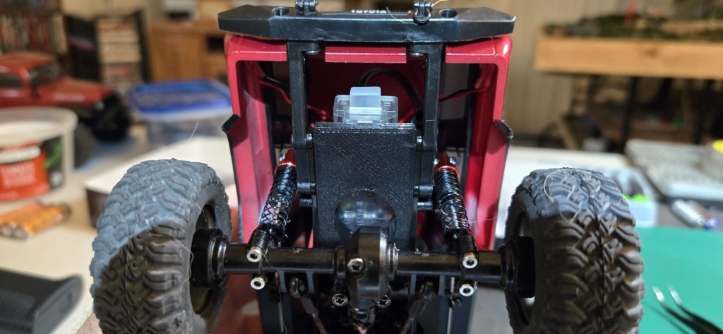

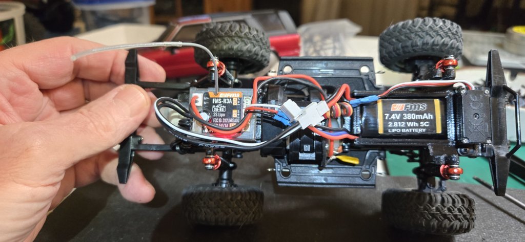

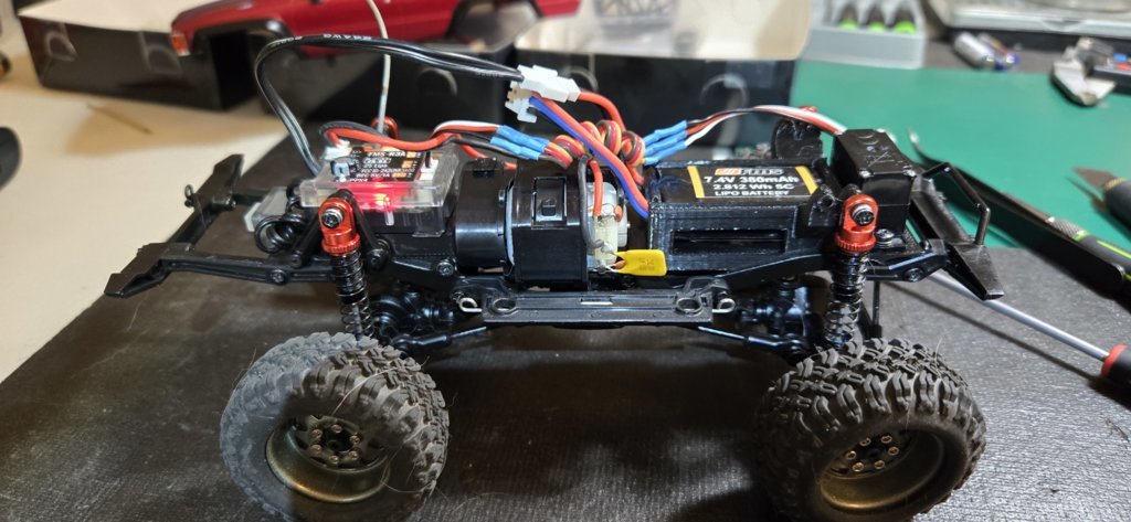

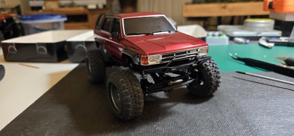

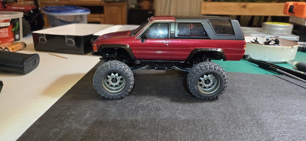

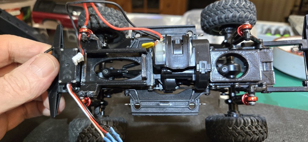

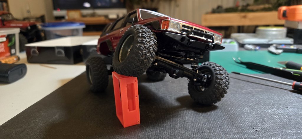

    Brought out the scale and that changed everything. Apologies for the pic heavy post.
    battery is up front now and receiver in the rear. 9 gram difference.
    RX plate.
    Actually used less material in both.
    Wiring is a mess. Had to lengthen the servo harness.
    Moving the RX to the rear not only lightened it but gave more room for the antenna and the wires aren't smushed under the hood.
    Rear has more spring now, raised the front top shock mount 1.5mm to drop the front down the same. Between both, it leveled it out a little bit.
    on/off switch clipped into the RX plate tucked up between the frame rails, easily accessible.
    Light rewiring is next on the list.

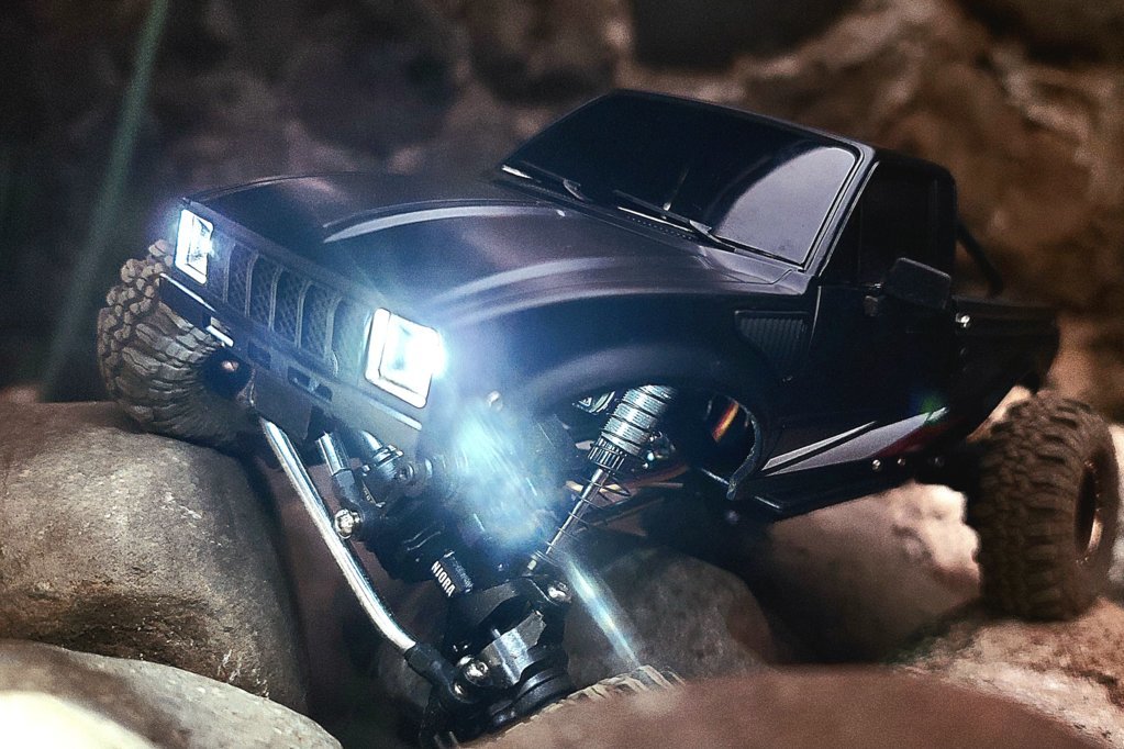

    I put the lights that came with my ir60 on today lol, also took it out on its maiden voyage with all its new mods. Thing keeps getting better! Such a blast

    WT Micro used to make Kyosho 0.7 wheels that worked with RC4wd's (I had SCS Ray 10's) - the scale looked better but the performance is kind of lacking in 0.7.
    The Kyosho super swampers actually perform half decent.
    Edit: Also it was just ramblings from me. Not any critique on the build at all - looks sick! Reminds me of the giant tire snow wheelers.

    lol, I went down that rabbit hole when I bought the thing. There are not a lot of choices for rubber for these.
    I think it now looks like every high school kids 80's 4-runner. So fairly legit. :D
