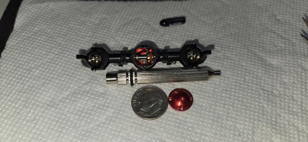

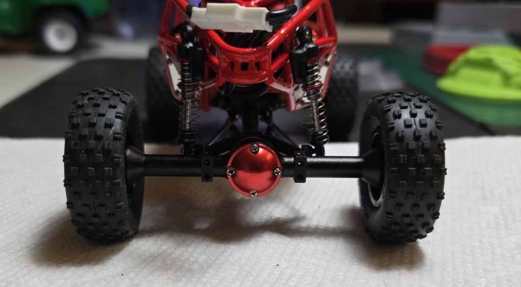

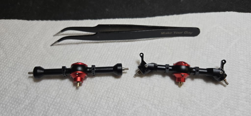

    Deathbysnusnu
    Deathbysnusnu Work is just a daily detour to happy hour.
    Oct 4, 2013
    #113825
    17,101
    Brett
    Fort Crawlins, CO
    Vintage Tundra
    Dog, camper.
    These weren't supposed to be here until Monday. :dancingbacon:
    Half the cost is obviously packaging. Makes the unboxing kind of breathtaking though.
    I weighed them against the stockers, just an additional 2 grams per axle. These are also 5mm wider.
    Added grease to the diff. Nice to be able to open it in place. Doubt it will ever get changed.
    The install was not a straight bolt on affair. I had the lengthen the top links 4mm and shorten the bottoms by 2mm. Doesn't sound like much, but the top short links are now only about 3 threads in. You can see the extra thread showing. I need 4 of those links, 5mm longer.
    Took this just before toe in adjustment.
    Servo sits a little more forward now, drag link moves to the back of the arm and sits level with the tie rod, which no longer needs the cool little bend in it. I ended up shimming it back 1mm for better clearance. Has a pair of adjustable width arms to hold the servo. You can just see my washer shims, smallest I could find.
    The diffs are 2mm larger in diameter, so lost a mm of clearance. :p
    Was able to get the diff angle correct. The wheel base stayed the same, even shortening the top links. If I can get longer ones, I'll be able to lengthen it a few mm's.
    Driveshafts won't be here until Monday, beadlocks are coming from Chinese Ebay, so maybe in a couple weeks.

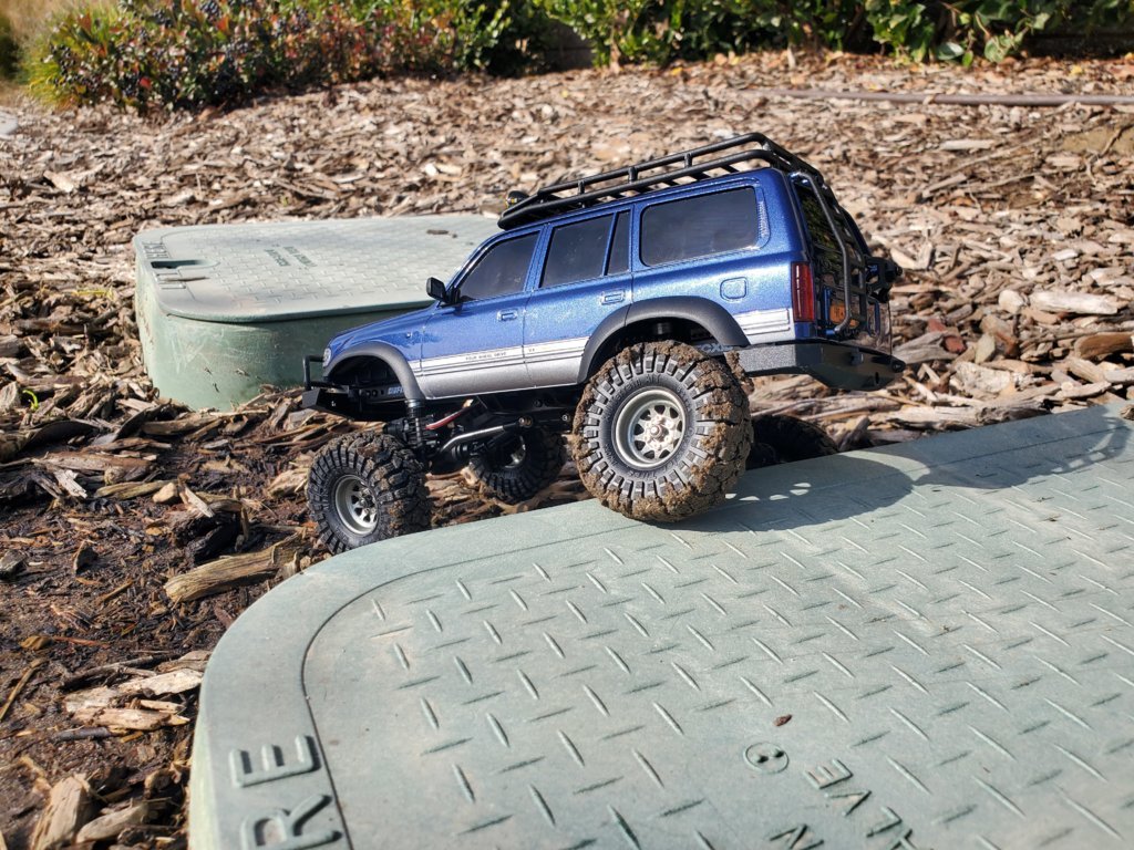

    PhoS
    PhoS Proffauxssional
    Apr 8, 2020
    #324146
    1,272
    PNW
    08 FJ Cruiser
    Contains MSG
    Here we go! It's smaller than I expected. I think it'll be perfect for romping in the yard though. Things are nicely designed and beefy all around. The factory alignment could use some work but overall I'm impressed. I'll go through it today and double check stuff before the packs get here tomorrow. Then she's gettin dirty. :bikewhoops:
